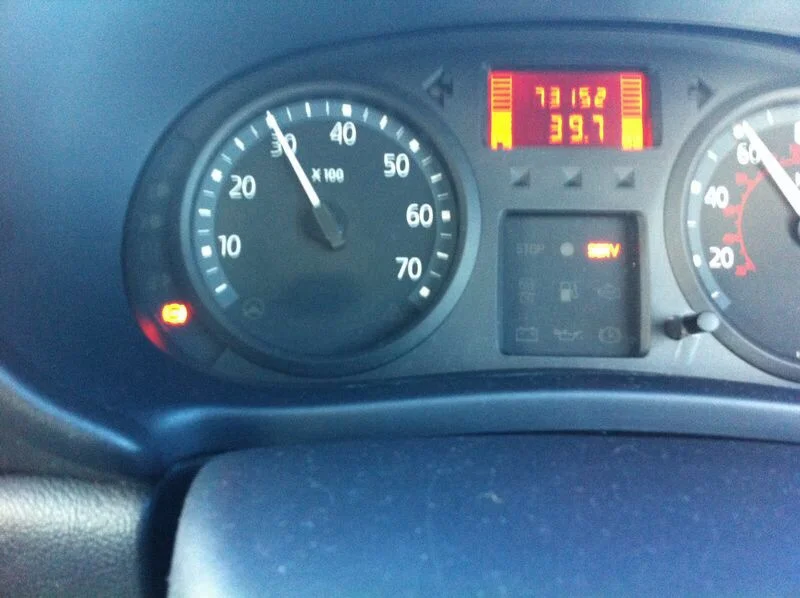

Abs and Serv light after garage work on brakes !

This has happened, can anyone confirm if this will be related to the work done at the garage?

possible the garaged damaged the abs ring on the drum whilst removing the drum or the sensor when fitting/adjusting the shoes.
would phone the garage and get it back in for them to check/fix the problem if its down to them damaging a part.

Cheers guys. Light has gone off now but something caused it to come on in the first place, il see if it returns over the next couple of days.
