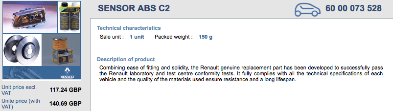

I assume this is the driver's / off-side on a Clio? Is the connector male or female on the ABS sensors, as both types seem to be available?
I Think Euro Car Parts can supply ATE Sensors cheaper.
Clio 182 Trophy Drivers Side ABS Sensor
Thanks.
Eurocarparts also do The correct Bosch parts for around £60 each at the rear, so will probably go down that route.
I'd advise going to Renault only for abs sensors. Went to a few different places for a front sensor all giving me the wrong ones
Thanks for advice, will look into it.
Haven't had a play with the big connector yet but will take a closer look when I get a chance and before I buy a sensor.
Update - fitted an ATE brand rear right ABS sensor supplied by Eurocarparts (even has the correct Renault part number printed on it but is less than half the price of an OE item!) and the issue seems to have resolved itself for the time being, with no more dash lights.
