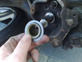

Did you make sure the special spacer washer went back on between the stub axle and wheel bearing/disc assembly
If you've fitted the rear spacer correctly check the ABS connectors making sure you haven't pulled one, also check the connector by the passenger A-frame underneath the car. If still no joy check the rear rings are seated properly and give the sensors a spray with contact cleaner. Also did you get the Renault OE part or a blueprint from the likes of ECP as most of these don't work.

So the rear spacers where refitted from the old discs as MTEC don't supply these with their rear discs last time I purchased a set. Oh and I meant blueprint rear ABS sensors not discs don't work :smile:

Yes the old spacers from old discs, however I did buy the discs and bearings from them.

Strange one then, only thing I can think as Bash mentioned above is maybe the spacer went on the wrong way around but I've done this before and it just crunched when tightening it back up and shattered the ring. And just to add those snap-on diagnostic readers aren't very good on the older Renaults, if you cant get to the bottom of it find someone local with Renault CLIP tool to plug it in for you and see what it comes up with. I ended up changing the NSR sensor at a cost of £129 based on snap-on data and it turned out to be the bloody ABS pump, lol.

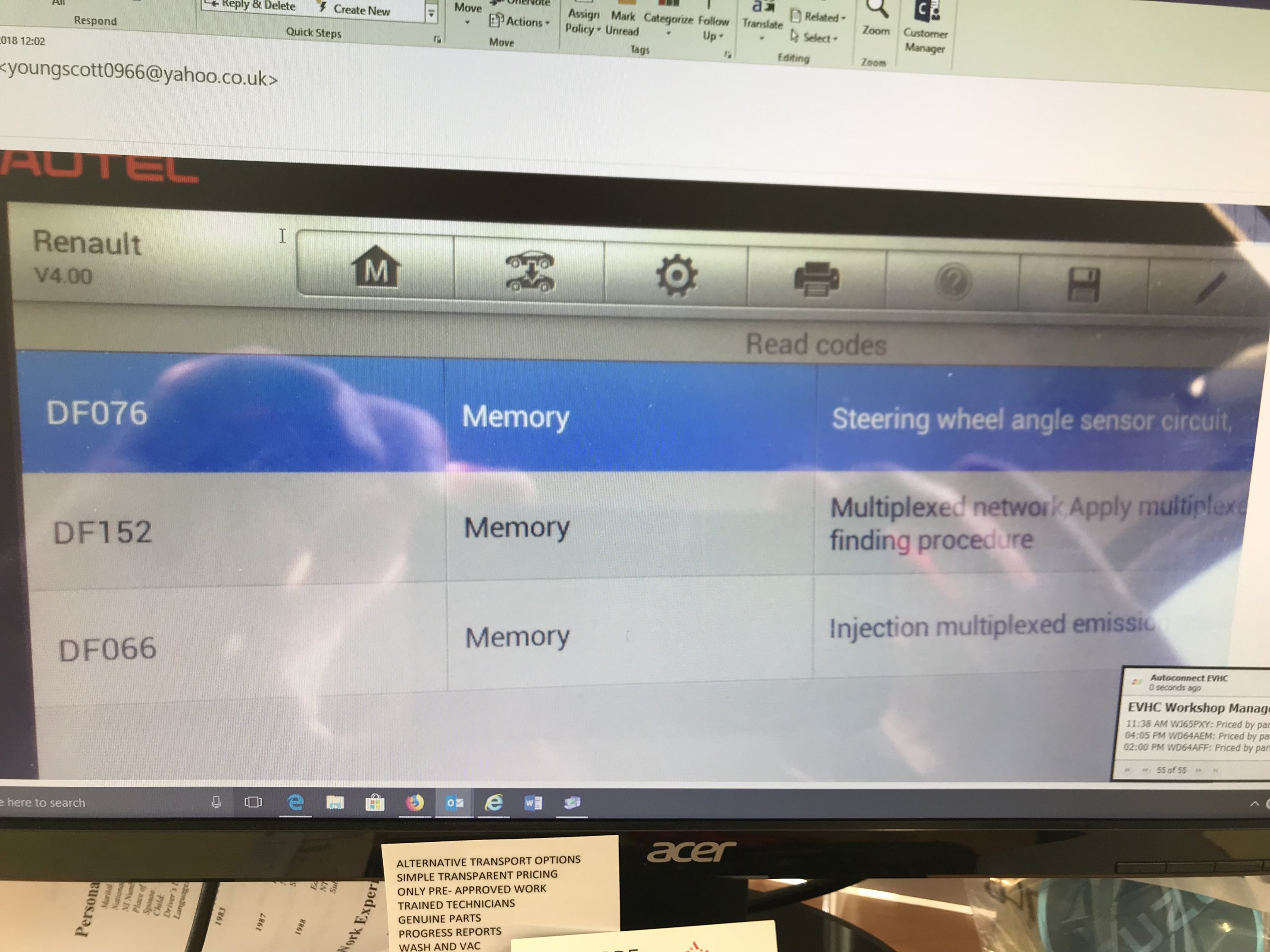

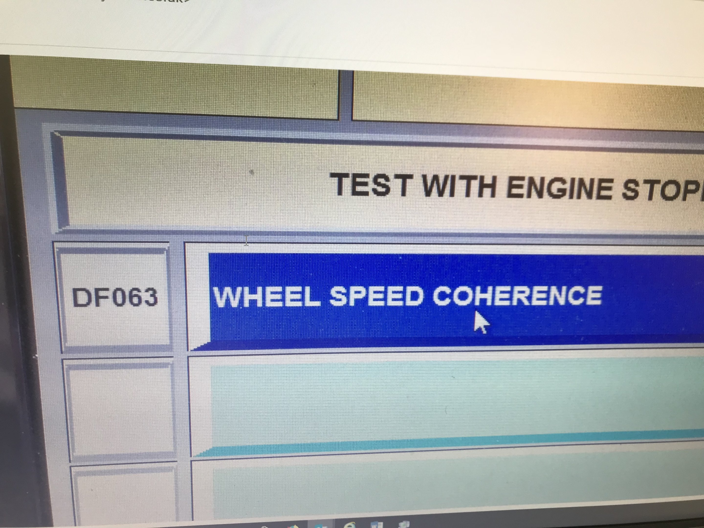

So after putting the old girl on the clip machine. The codes for df076 steering wheel angle sensor came up. This was deleted. And DF063 wheel speed coherence came up.
Now could this be to do with a change of springs?? And is there a fix for it.
Any help now is greatly appreciated, starting to get a bit frustrated.

Would you think not using a Renault part would do that?
On the machine the readings showed
The fronts at 62km/h
Both rears at 71km/h
So there is a difference of 6-7km/h. I bought both front and rear pads and discs from MTECH!! You would think that they should be able to match. The only thing I can do is change the rears back to standard Renault ones see if that works??

I've used front discs from MTECH without issue but it seems exactly the same issue as the article mate which is the rears, so yeah change them back and see if it disappears, I'm guessing it will.

Sorry for not updating. Have the rear in bits for the week as have taken the discs off so many times needed some new wagers as the old ones disintegrated.
Eventually put it back together on Wednesday. Cleared the codes and the lights have stayed off.
Unbelivable!! Don’t know if anyone else has had this issue with the rears??
