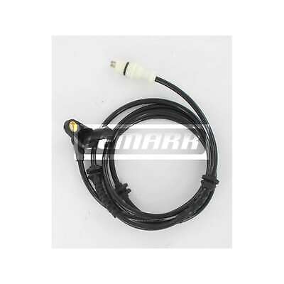

Anyone have any horror stories relating to this eBay ABS sensor? It's listed as 'genuine', but eBay is eBay. Seems Reno doesn't stock the part anymore :(
Did you find a sensor that fitted?
  RB 182 FF
I did find sensors, they're harder to source than most parts and I kept reading that Bosch parts might not fit, despite having the correct part number. My parts are coming from Autodoc in Germany, so should arrive in a few days. I'll update here with the results...
