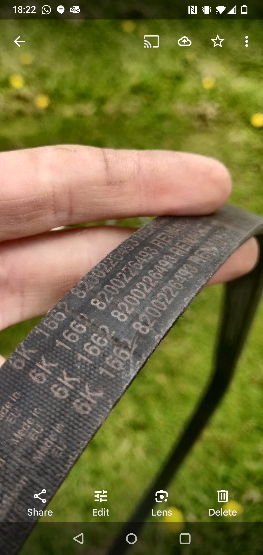

Fitted a new ContiTech belt this time (instead of Renault) and it only solved the bleddy thing didn't it! No more horse!
Inspected the smooth side of the Renault belt and it does have a subtle bump near where the writing is. Hadn't noticed that before as I'd only inspected the ribbed side!
Wild that little bump made it sound like a horse though. 😂
