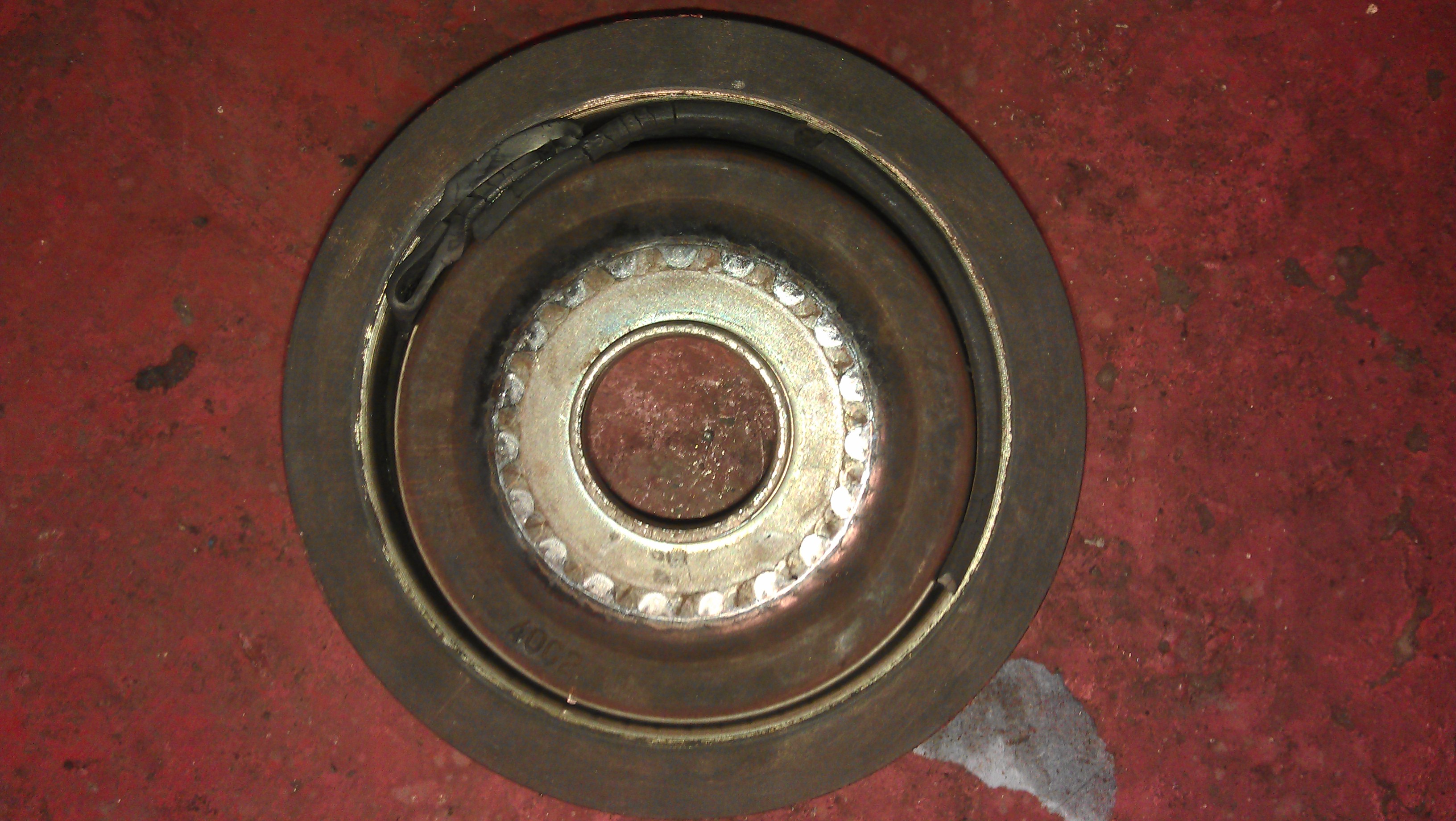

Maybe?
I had a look at that thread and imagined that crank pulley must have wobbled alot, mine is just a slight wobble and he didnt mention anything about a bearing noise from the ac?
