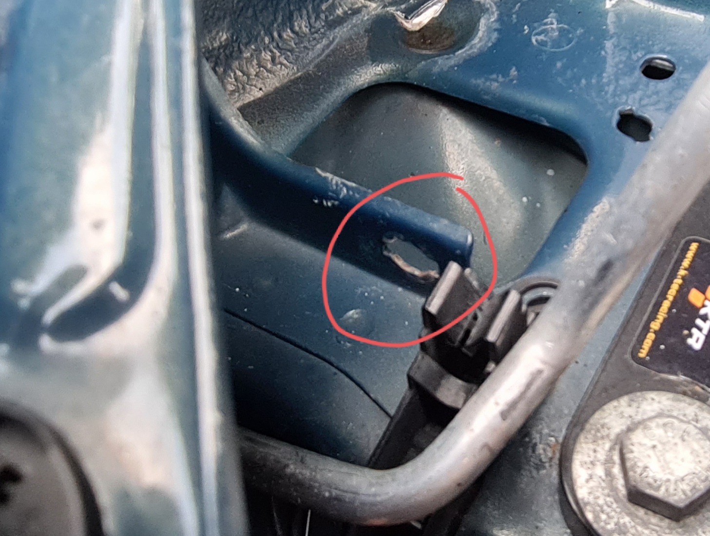

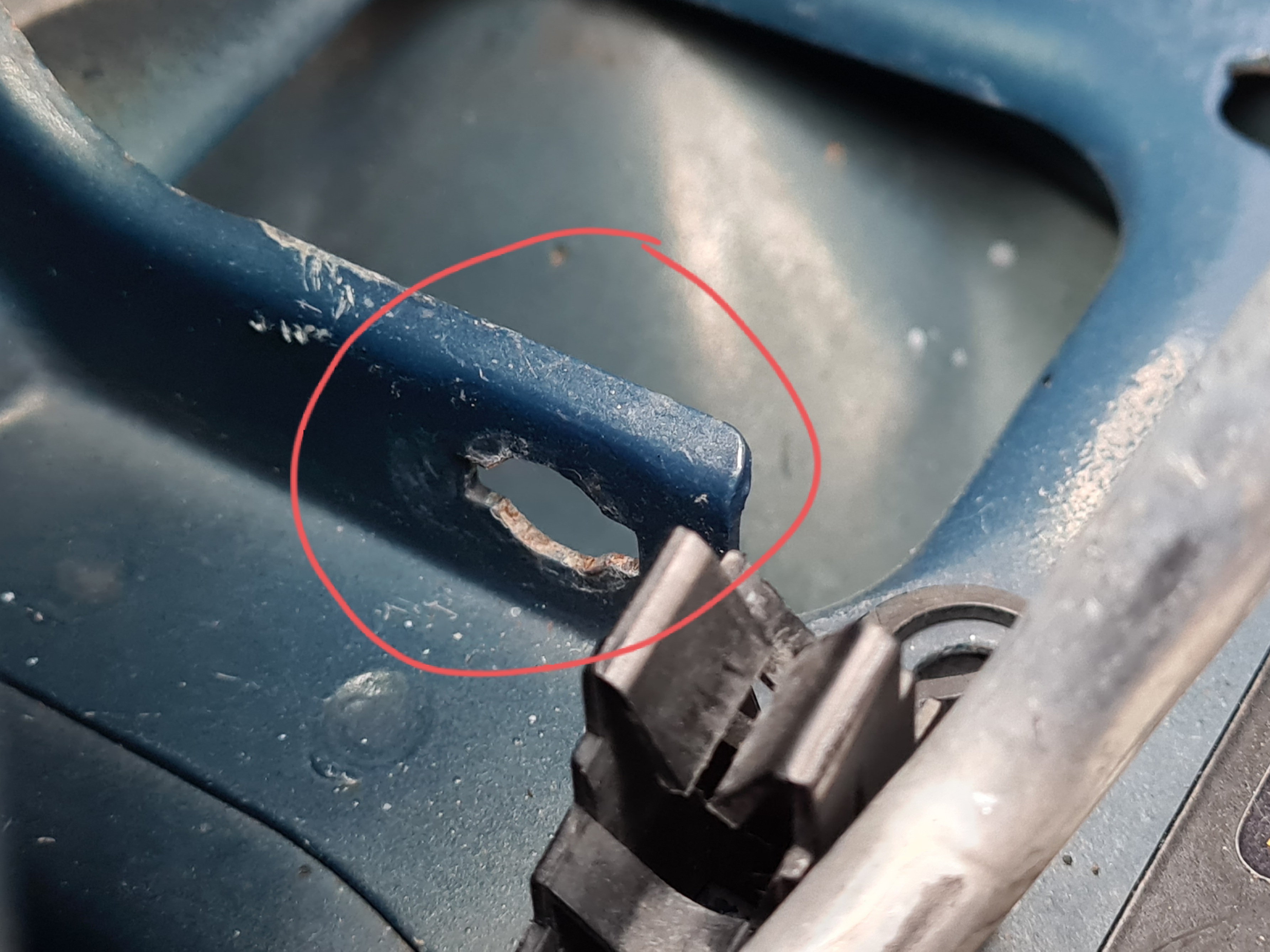

I'm trying to find the two clips that are stuck in the bodywork to bolt the ac pipes onto, anyone know what they're called and where to get them from?
Alternatively I could just use some bolts and washers or chimney nuts but if the originals are cheap and easy to get I might as well get them.

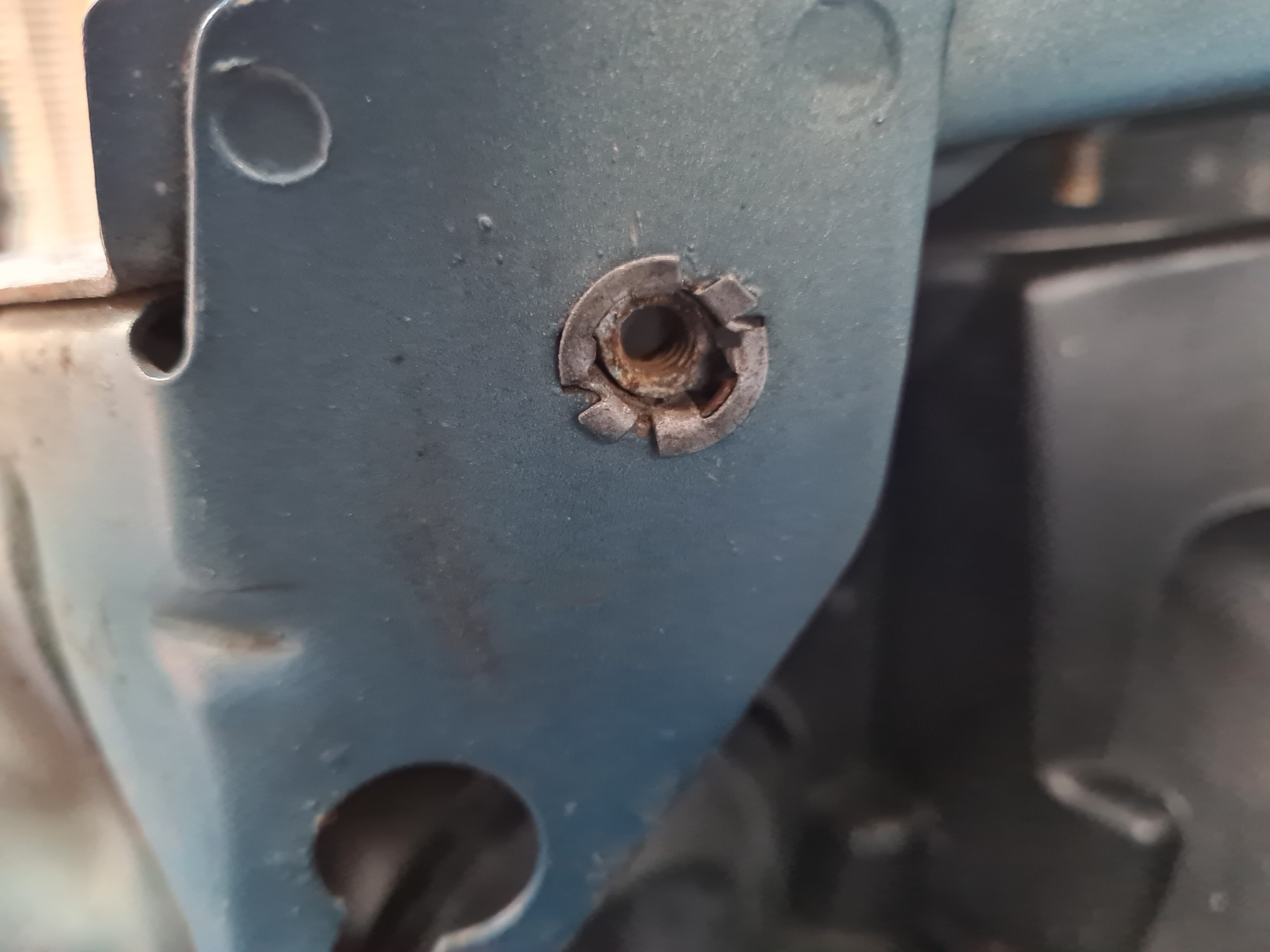

That would be a neat solution as well,but probably won't work on the hole further in the engine bay unless an angled rivnut tool works as well as one of those straight ones?
Yeah be fine as long as you don't get steel rivnuts. They take a fair bit of force compared to the aluminium and others.
