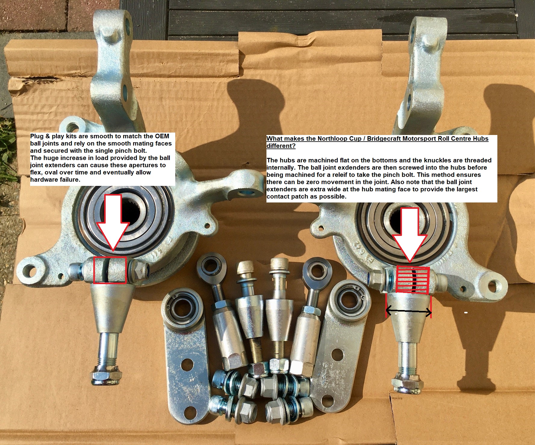

The issue with the plug and play kits is the ball joint extenders use the same mechanical fit/features as the OEM ball joints. This relies on the strength of the knuckle as designed for the OE ball joints and load. The increased leverage provided by the aftermarket extenders puts significant stress on these areas and over time the OEM knuckles begin to oval and eventually allow hardware failure.
The Noothloop/Bridgecraft setup is the only setup that i know of that not only machines the bottoms of the hubs perfectly flay, but then threads the bottom knuckle so the ball joint extender is not only threaded in, but then machined for a relief once fitted and further clamped tight by the pinch bolt. This is probably the strongest non-welded connection possible and has no way for either component to move. I have seen images of rally accidents where the corners of the cars have been ripped off and the RCK still not fail.

For anyone else reading this, i toshed this together on paint (fortunately my engineering skills exceed my PC skills) to show what makes a NLC/BCM hubs different.
This isn't a dig at the plug & play kits out there, some of them are beautifully finished with very high quality materials and components. They provide a very easy to fit solution. This purely illustrates the difference between the two.

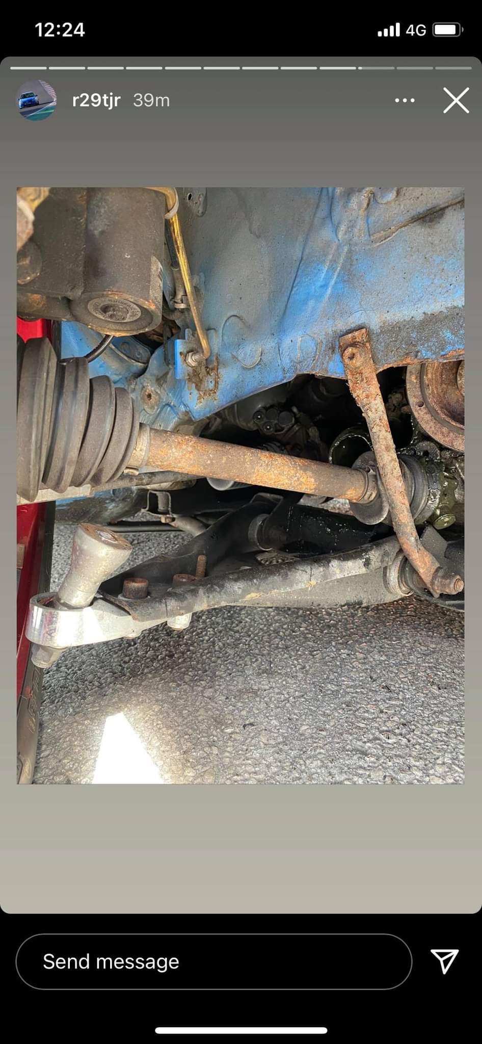

Another 'plug and play' kit failure yesterday on a lads car at Oulton 😔
So this is my car...
Firstly in ProAm's defence the part that broke was a known fault and sometime ago I was sent a replacement part FOC and was communicated with advising to change. This morning I then received an unprompted phone call from them to discuss etc, which in my opinion says a lot about a company/individuals (in a good way).
I DIDN'T CHANGE THE PART as the car had done limited mileage and like a lot of people time was an issue. It just one of those things IMO and I don't see how they can be held accountable when they had already issues a potential fix prior to the issue causing me a problem.

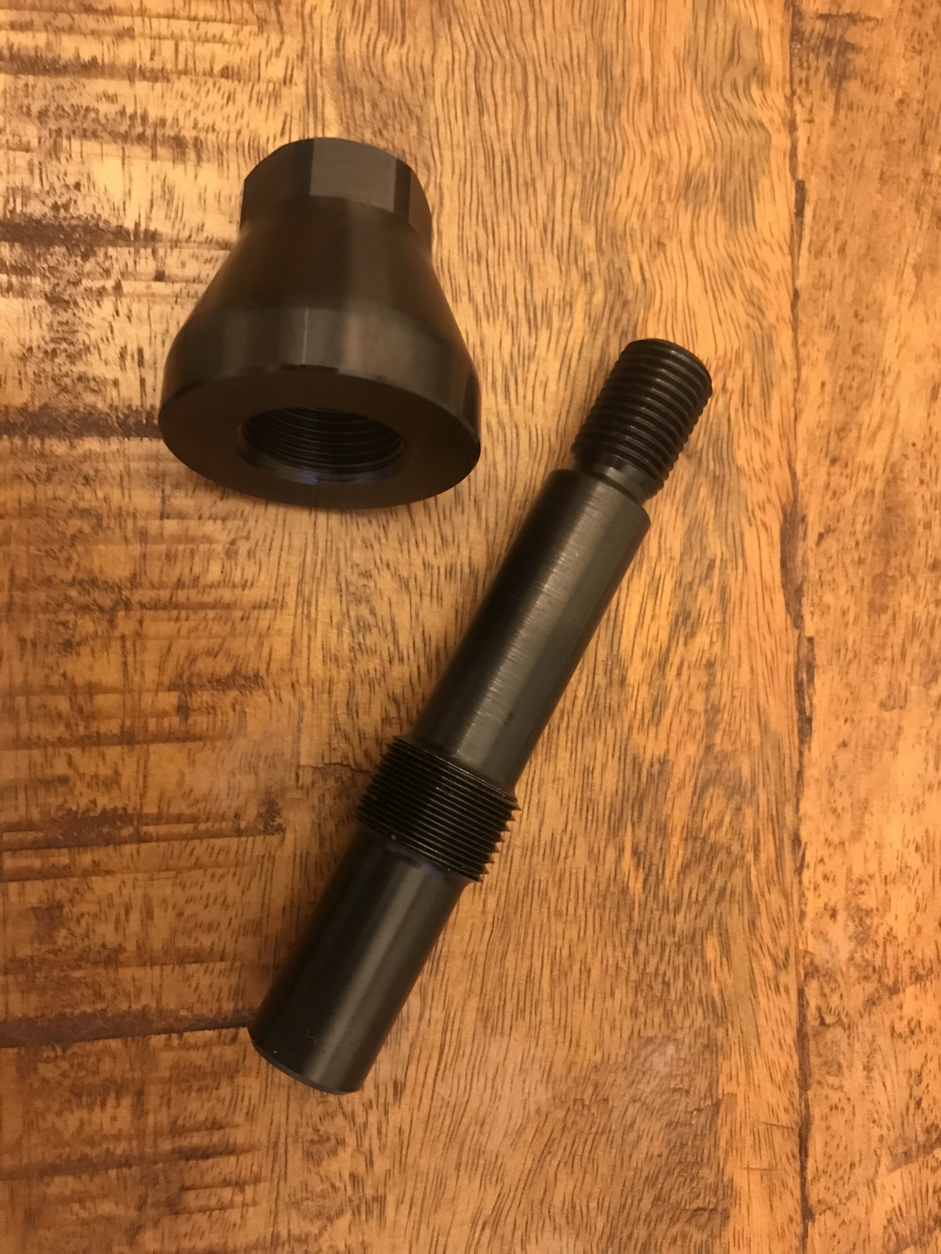

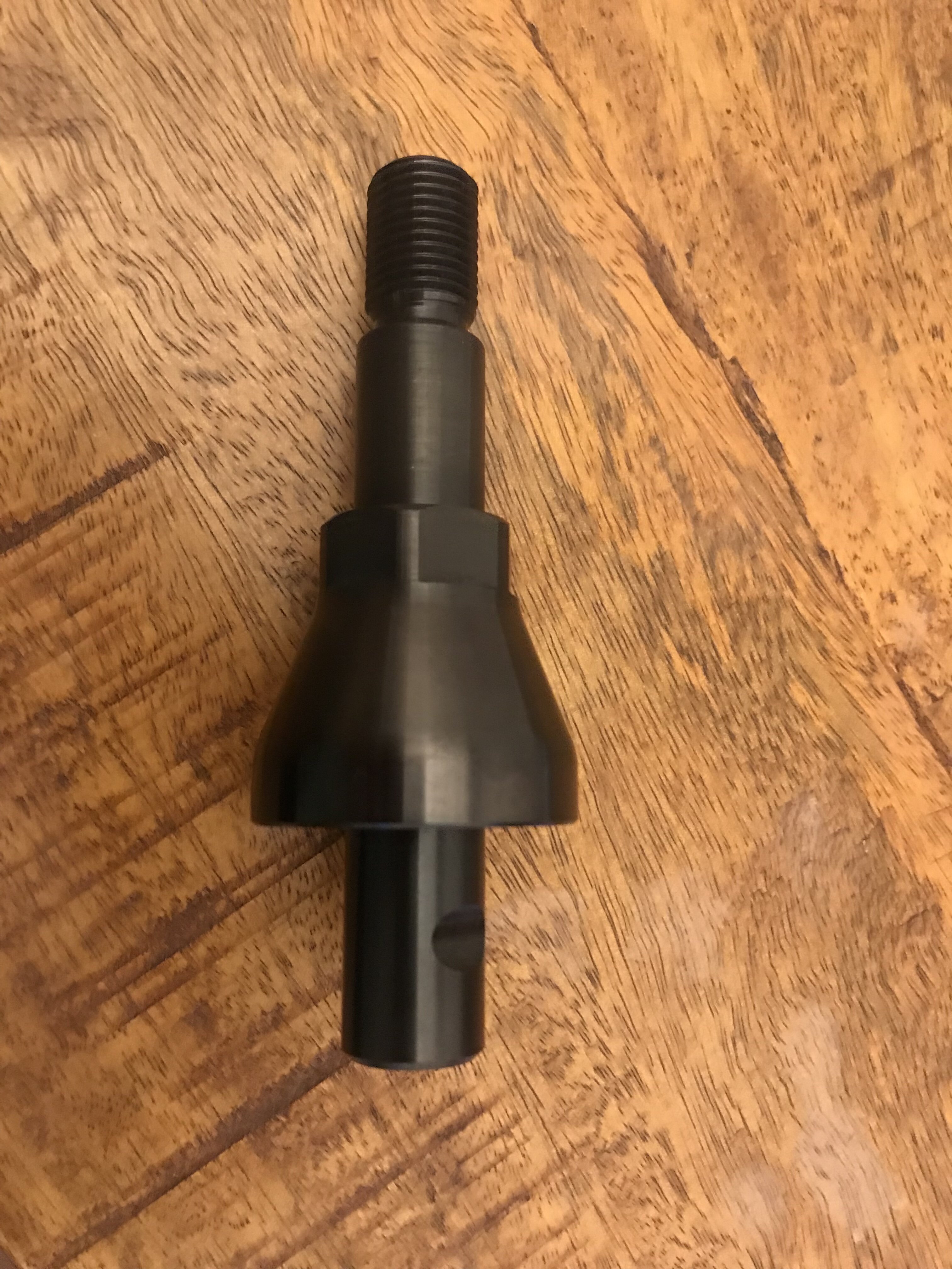

Tomotek
What's different on v3?
As part of our general development we’ve been continually looking at things we can improve on the kits.. we’ve taken everything we learnt from the first two iterations and have revised the concept to a 2 piece design, integrating a locking nut with the spacer.. This allows the spacer to be preloaded again the hub lower surface, taking up any tolerance differences between customer hubs.. Also with the two piece design the main pin has a uniform section with no large changes in diameter, thus improving the loading capacity.. We have been running this V3 all season to get some miles on it and it’s pretty solid.. Bench tests have shown a good uplift too.
(Had no issues with v2 pins since people swapped I might add, but things can always be developed and made better 👍🏻)
