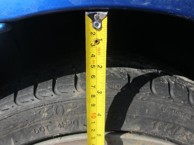

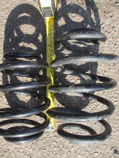

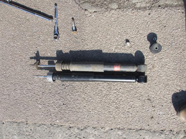

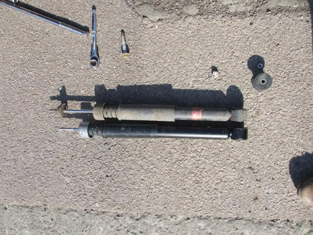

When I got home, I decided that the first thing to do would be to check the rear suspension, what I found was that the shocks on the back are listed as for every variant of this shape Clio apart from the 172!
I spoke to Adam at Renault Wolverhampton and ordered some new rears, a single front as the previous owner replaced one last summer and a set of Cooksport springs.

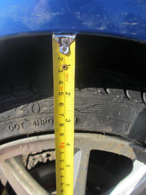

The rear always looked high, 5" from rim to arch
The shocks felt knackered

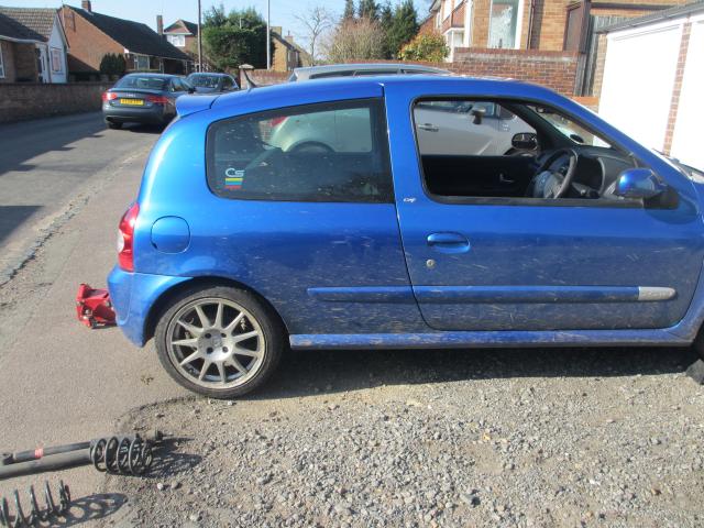

And the springs were huge!

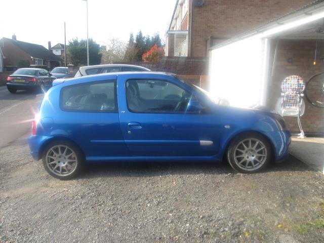

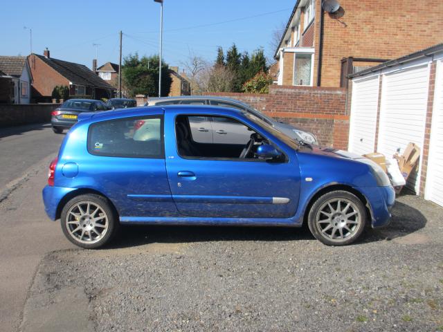

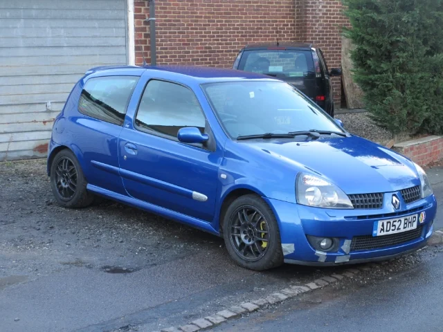

Afterwards, the car was far lower
And now looks like a Clio 172 rather than a 4x4
Next is to change the front strut and springs, and get some new tyres :)

Haha I can't believe none of this was sighted under my ownership. It went to Fred, dan & Sjm and a Renault technician haha. It did always feel squirmy at the back.
blame the blowing gasket on my poor mechanical skills.
I do miss it though for no good reason.
Good to see it dirty though!!

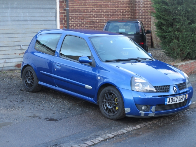

  172 Turbo

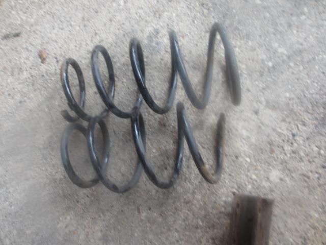

So I finally got round to fitting the front Cooksport springs today and to replace the remaining original front shock as one was replaced by banther when he owned it last summer.
Found the front springs to be a weird mix! One a KYB and the other looking like it came from a scrapyard with odd paint markings on it, oh and the front left spring was snapped!
Looks far better now, apart from the terrible picture!

Nice one Keith, you might persuade me to passenger with you again now lol.. Escaped with my life last time, was hilarious though :D Car looks miles better..

That was bad, flol at the previous owner only replacing one shock.
Good that you've got it sorted, bet it drives like a different car now.

Meh - just to get it through MOT.
Full refresh was already on the cards. Snapped spring wasnt picked up though!! masekwm if you PM me your address I have a full set of Cup springs you can have for free.
IIRC you might want to get the handbrake cables sorted at some point. It was picked up as an advisory.

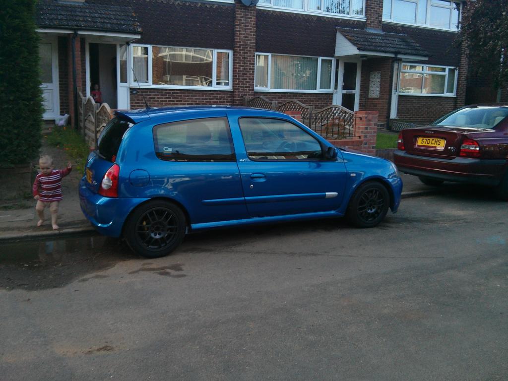

  172 Turbo
Now with 15s, RSRs, new top mounts and poly dog bone.
half way through the cat gasket, one bolt refuses to budge :(

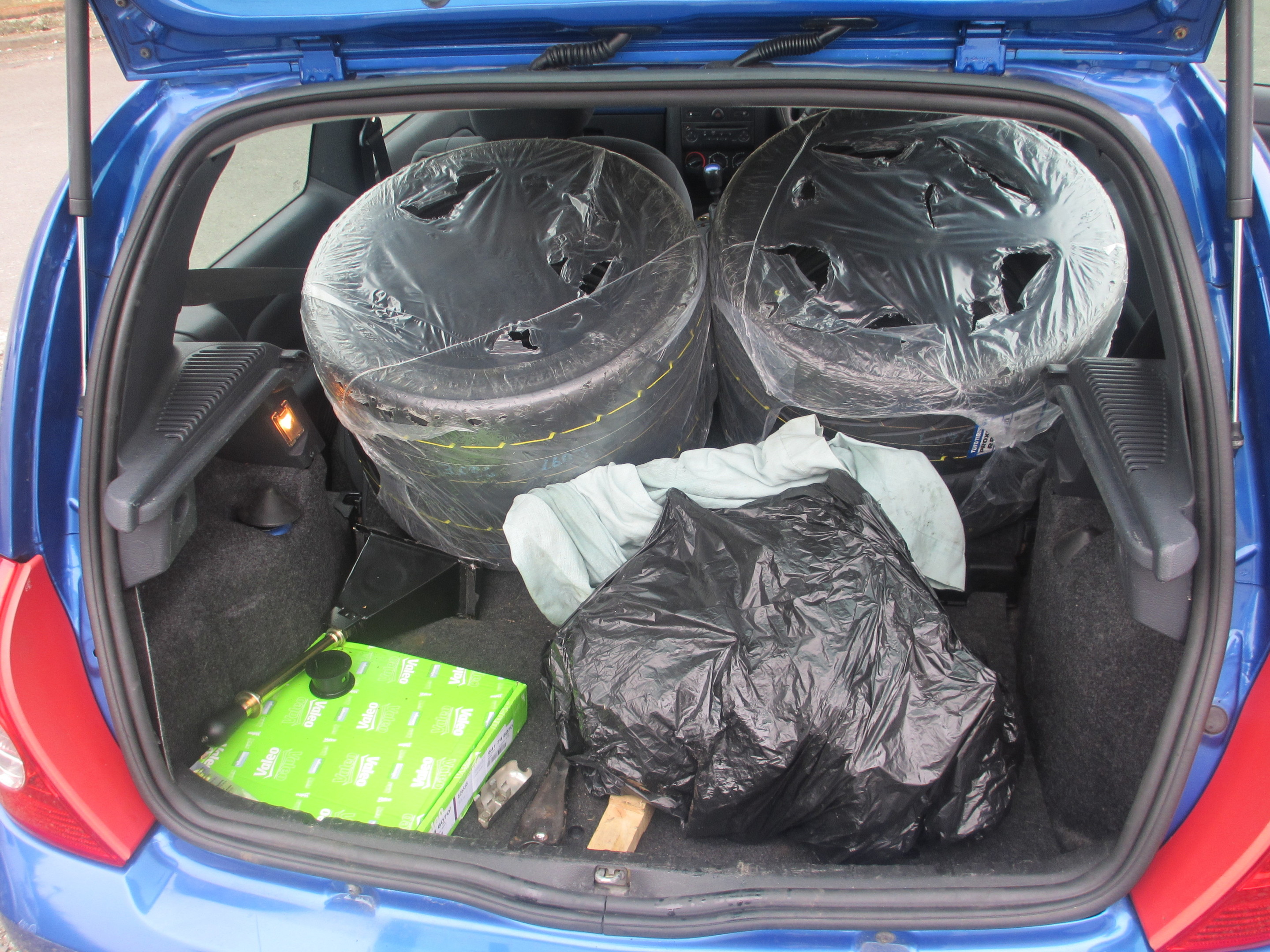

My pretty worn RSRs are also coming off for some lovely new Toyo 888s.

Thought about fitting it all myself, got some quotes from the Specialists and decided it was best to send it off to Beaniesport as they are local and could fit it in this week. I remember the other jobs taking so long and I've been really enjoying the car lately.

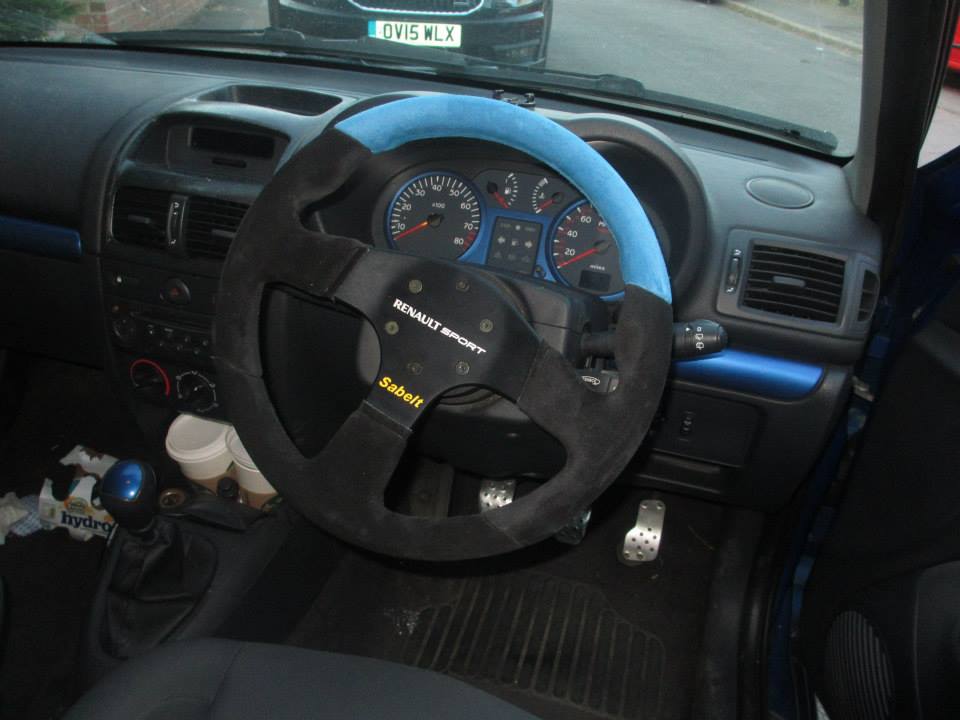

Tonight, I had a bit of free time so got round to replacing the steering wheel, on track at Blyton the old one was melting in my hands, it was awful so...

I love the shifter & wheel, they've changed the car for the better, two rather expensive parts but they transform the car.
