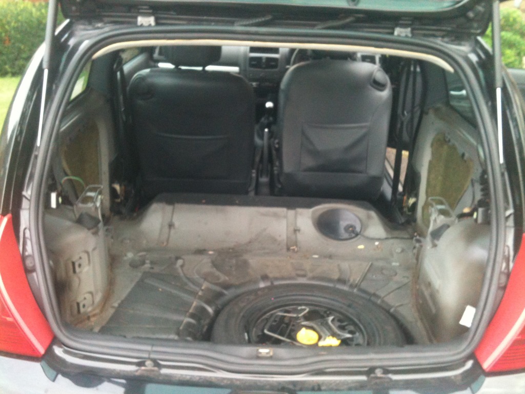

Everything went really well until I got to the isofix bar this morning. After swearing and sweating, I finally got it out but the central seat bracket was not moving, thanks to Raz and a grinder, the back looks like this:
He really got me (and a bolt) out of a hole, cheers matey. Might polish the interior tomorrow.

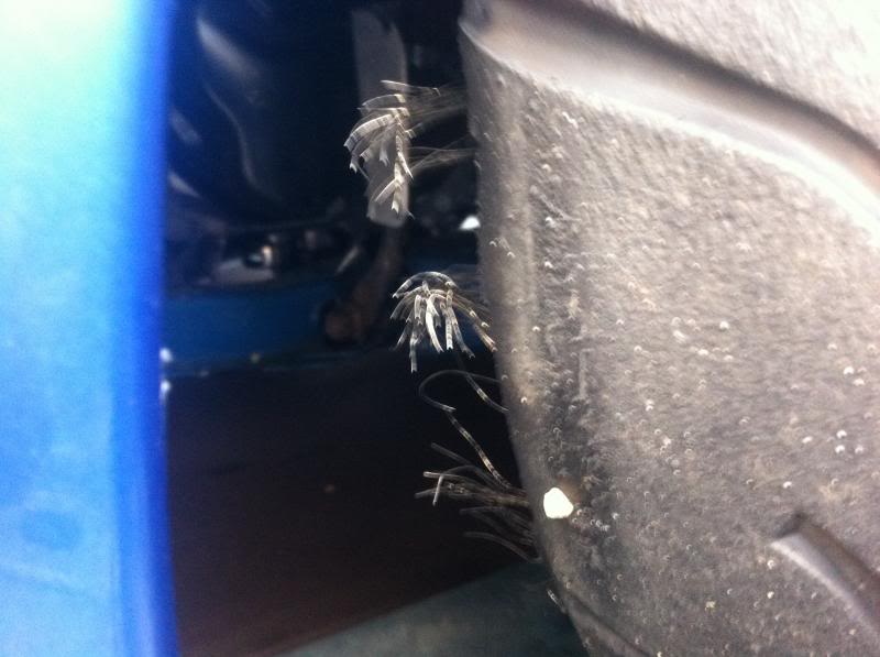

Poor tyre :( they aren't much anyway luckily

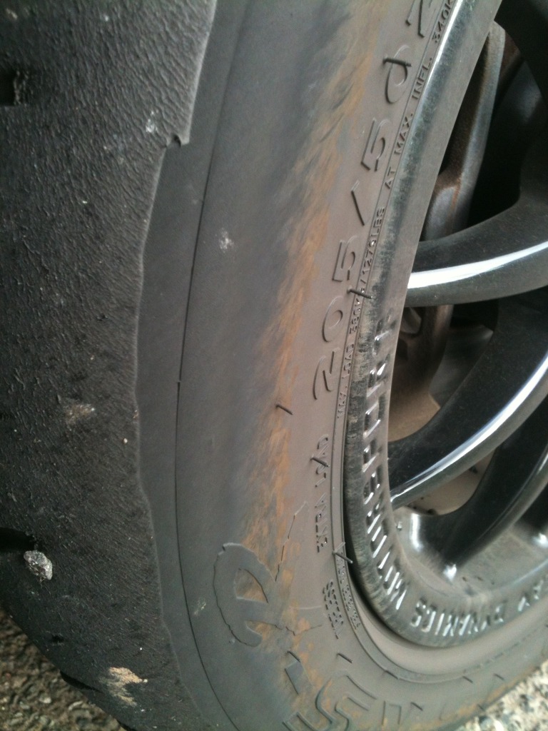

This is my two passengers tyres after 2 mixed weather session'd days with 4 degrees camber on Eibach sportlines, the shoulders just melt.

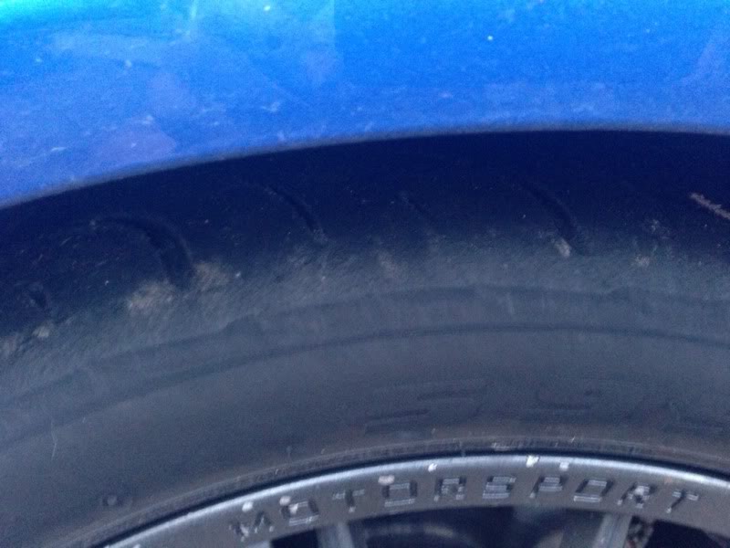

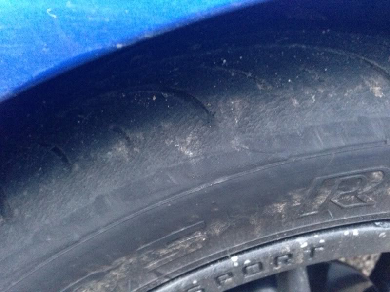

Oops Dave lol, seems like they don't like low pressures either. Nicely concave on further inspection but it's hard to say for definite as they've had road use too, but I did pump them back up for that. I guess it's what you get for cheaper tyres, they have gone on the inside too. Four hard track days isn't bad really though. Still squeeze another out of the offside front.
  WRX
I've got myself thinking about RSR pressures now. Have to check OS in the morning for central wear, to see if they were overinflated on the road, or if it was just excess initial heat on track. If so have to consider starting at even lower next time.
