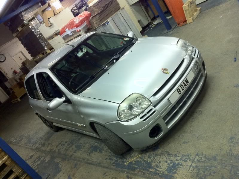

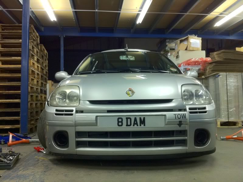

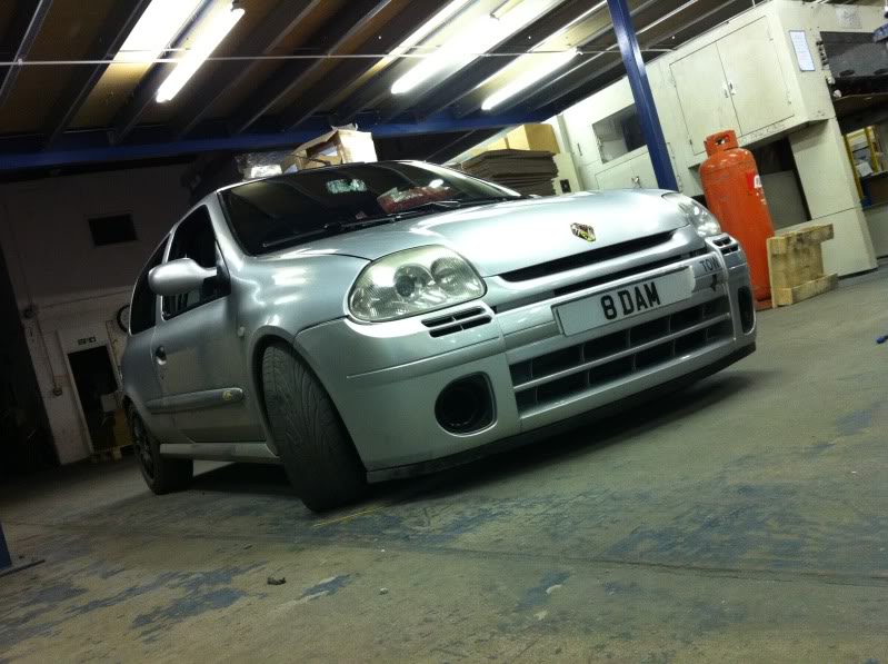

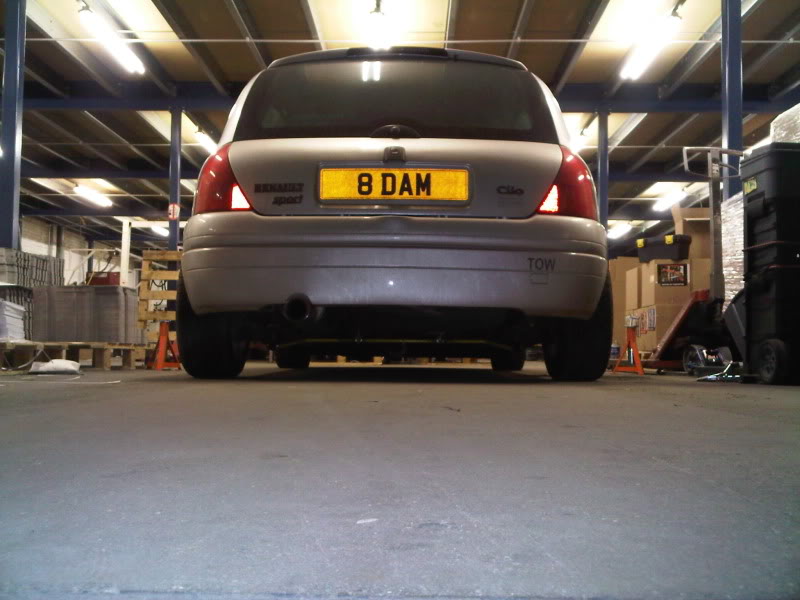

since the last update it now has a fully flocked dash (top,bottom,steering cowl and centre section)
dished omp wrc steering wheel
gaz coilovers
and camber!!!
will get pics up soom but heres a couple of crappy phone ones

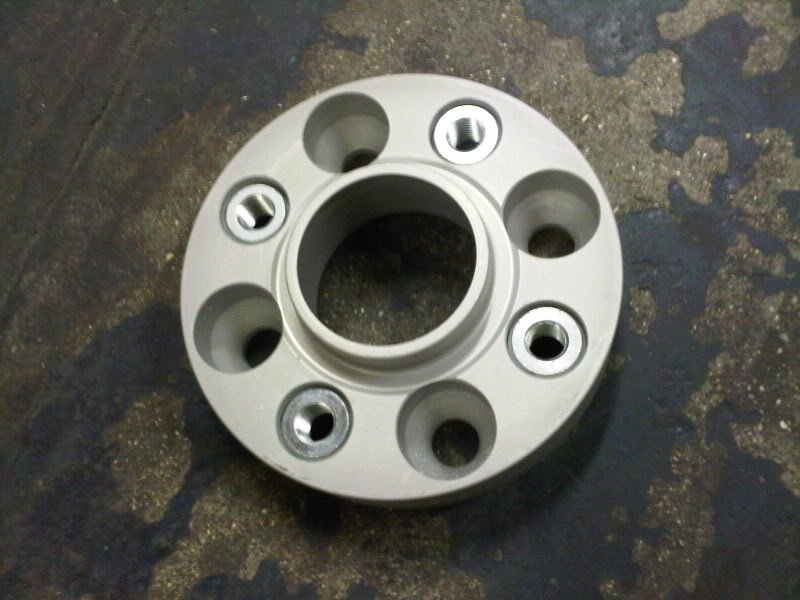

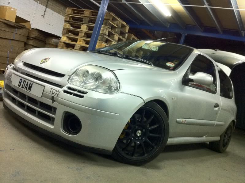

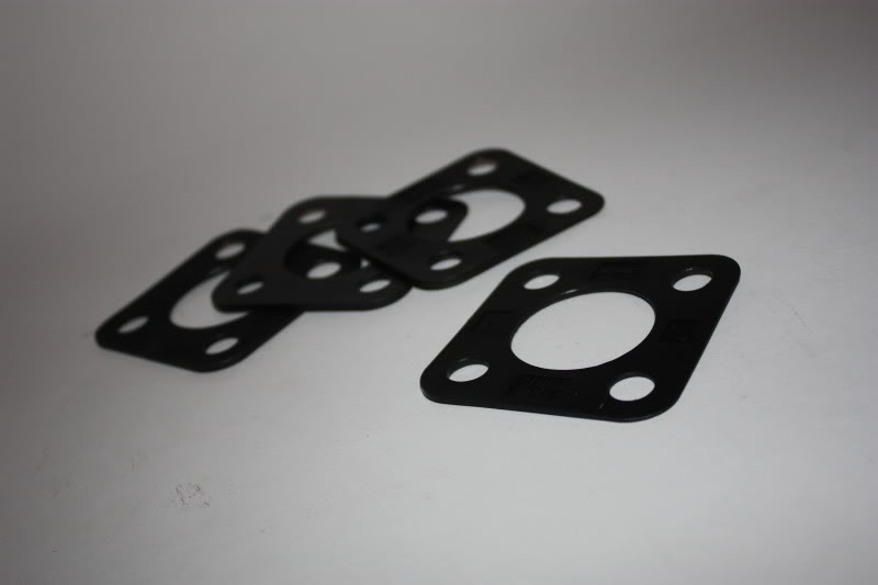

30MM each side on the front and 25mm on the rear each side so total track widening of 60mm front and 50mm rear.
i have since had to remove the rear due to them rubbing but a bit of camber should solve this hense i have these sitting on my desk -

looks awesome! mine needs spaced badly! will do it once my coils are on! :D

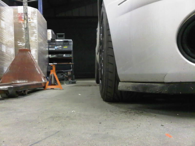

only drove it about 2 miles since fitting them and it seems soooooooooo much better proper point and go! its so flat around the corners now as well, but i suppose the coilovers and arb help this

i found the 20mm rubbing on the rears slightly, with-3 degrees of camber. using 15mm now at the rear

its hard to compare, as wheel off set will change everything as will how low the car is and lots of other things, tyre stretch ect.....
and tbh i think if my arches were slightly rolled or i had a we bit of stretch it wouldn't have rubbed, saying that my lensos are smaller and have stretch so im pretty sure 25mm will be ok i may even need 30mm rear as well.
but what a difference a bit more track width makes! car seems to grip so much better.

Thanks for the info mate, I think i'll go for 30mm each side at the front. My wheels are et37 and i have the 182 cup packed hubs so i'll be even wider then you are i think :)

to let you know i get slight rub on FULL lock but i thing that might be my brake ducts i need to have a proper look tomorow

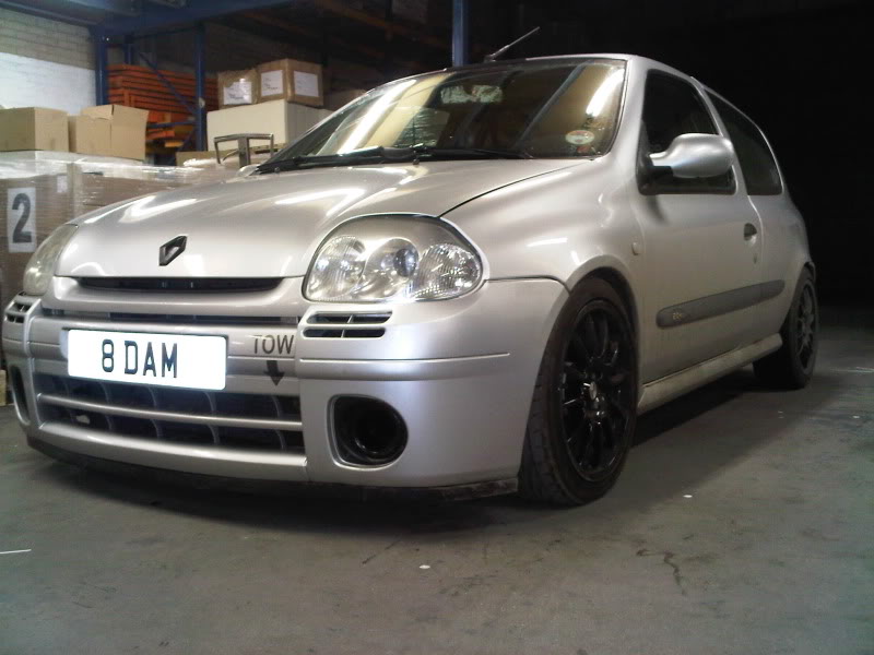

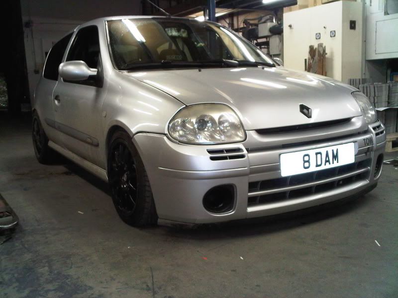

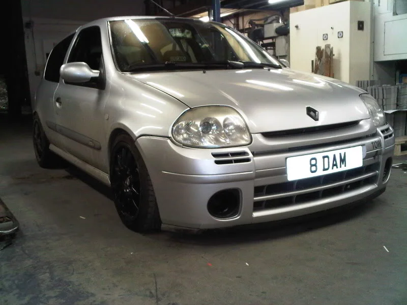

so not allot has happened, but tonight i got some bits dont that needed doing plus a couple of extra things
first i needed to raise my seat abit so i got some spacers off ebay and done that.
i then needed to relocate my fuel cut off switch as since putting the coilovers on every time i go over a bump it cuts out:mad: so drilled a new hole in the bay and done that.
next up was to find why some of my bulbs glew the other night ( speedo front lights and some rear lights) turned out to be some loose plug under the fuse box strange but atleast its sorted!!
then my attention turned to trying to get me front bumper to fit a bit more flush i ended up using a cable tie and loosening the support bar underneath, which has brought it in a bit better.

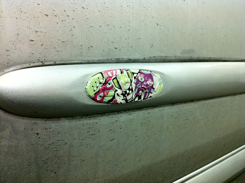

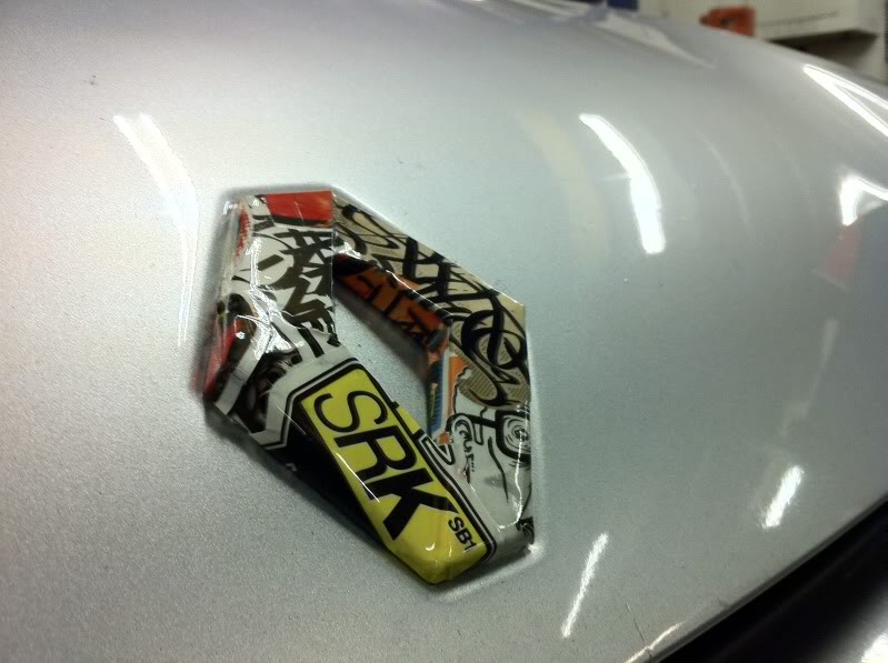

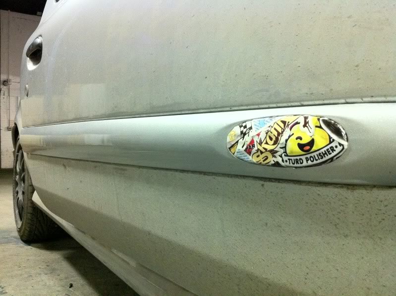

last job was to start fitting some bits iv bin doing over the last couple of weeks, iv got colour coded ph1 bump strips, sticker bombed badges wing mirrors bullets ...
anyway heres some quick crappy pics to get an idea.....
