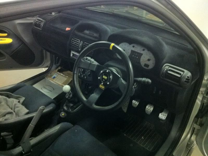

i also have carbon door cards ready to go on but i need the handle holes cut out, whats the best way to do this and are they any guides for where the hole should be, or will it be a case of just lining it up and hoping for the best??

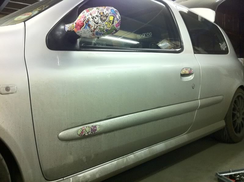

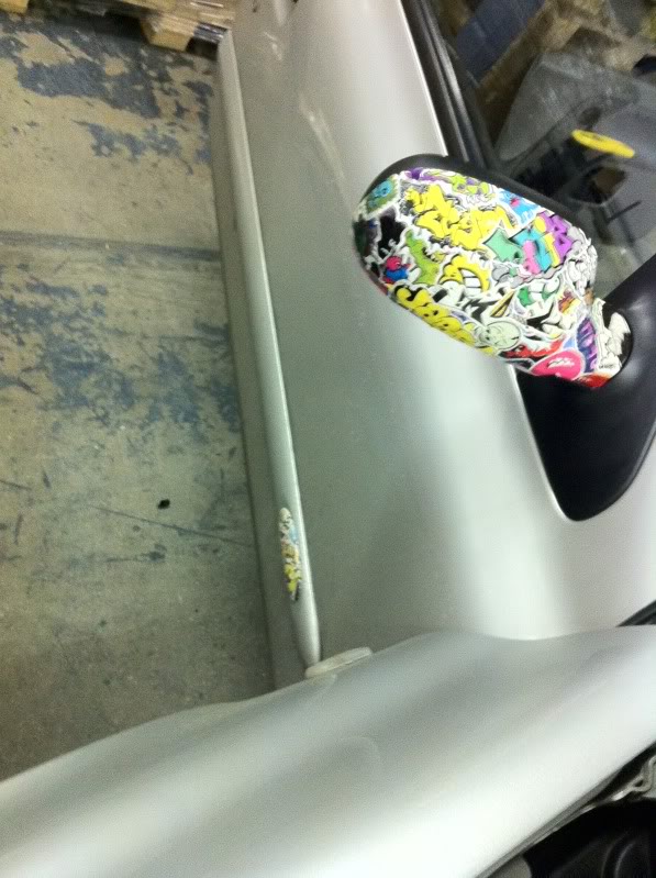

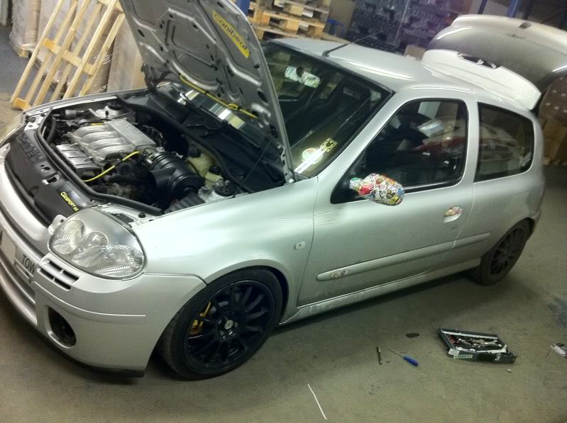

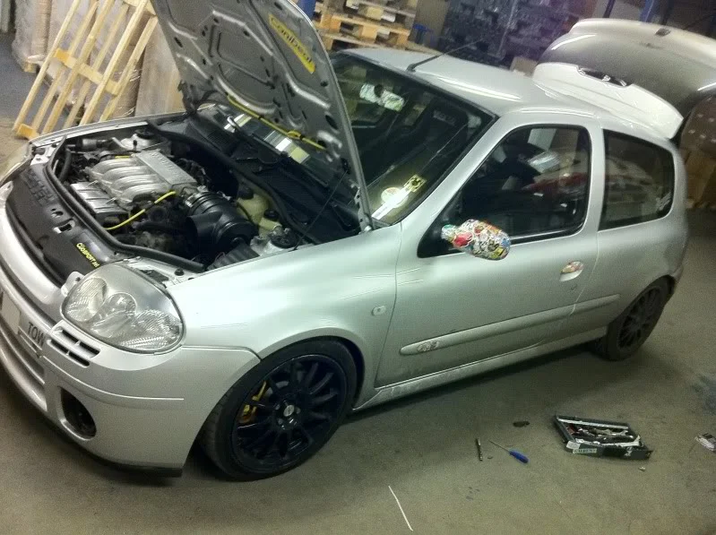

Like the sticker bombing btw, makes a change to see it on something track focused.
Oh, and please tell me it's seeing a track?
yes its deffo seeing brands this year (missus got me £100 voucher for xmas towards it)
er i dunna gimme £15 for them they come with bolts but there the delta mics which have bad press but mehhh ? up to you?
and yea as for sticker bombing i couldnt decide on a colour combo and i wanted it to be a bit different from the normal scene jobbys or the normal track slags so its going to be a mix of both. interior= track inspired. exterior = static drop, scene, hella flush, street core based ect....lol (still a very long way to go yet though!

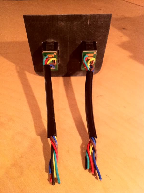

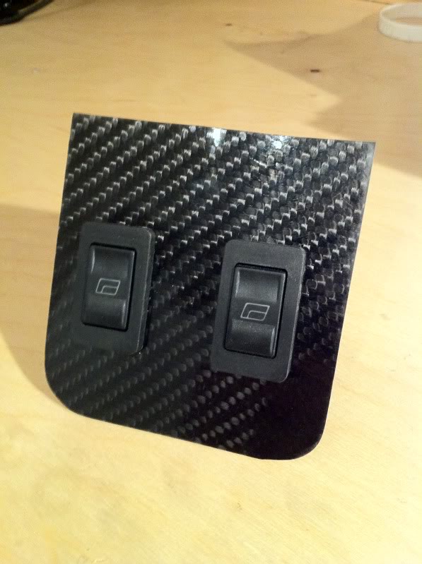

just knocked this up ready for when i put the c/f door cards on i just need some were to locate the mirror adjuster now??
btw this is going were the little compartment is on the centre console

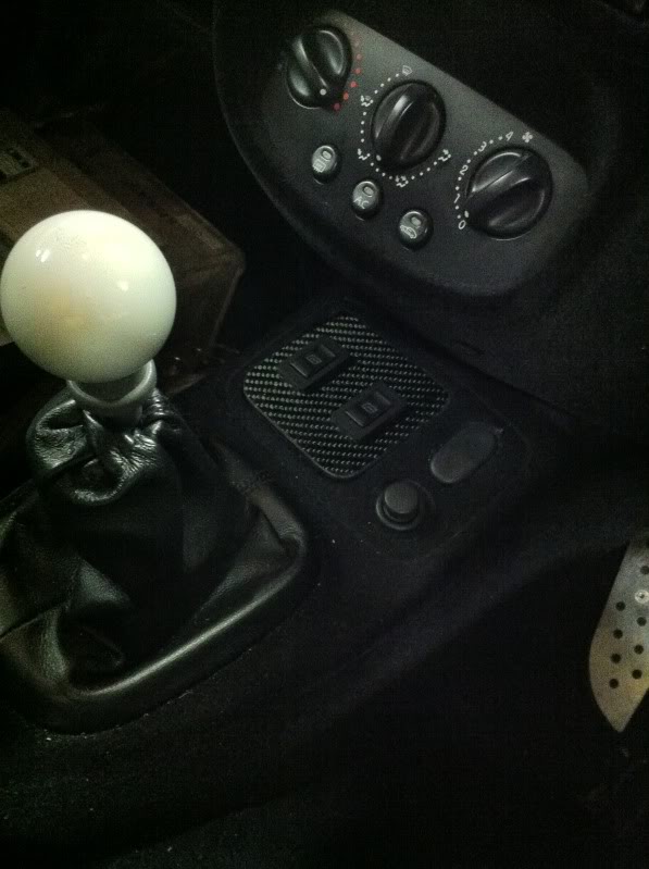

trial fitted the new window switches (needs a little sanding but im happy with the way it looks

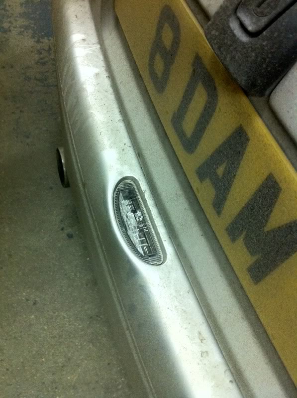

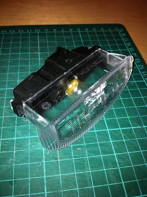

new rear number plat bulb lens other one was a manky yellow colour

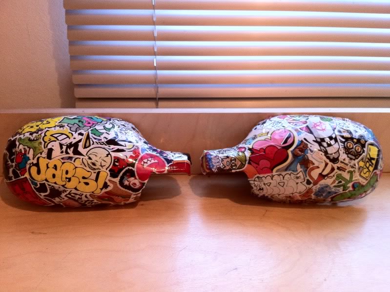

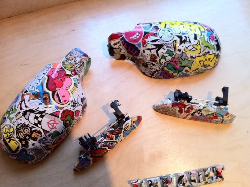

fitted the new wing mirror covers and the door handles really happy with the way these look cant wait to clean the car now

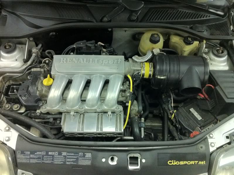

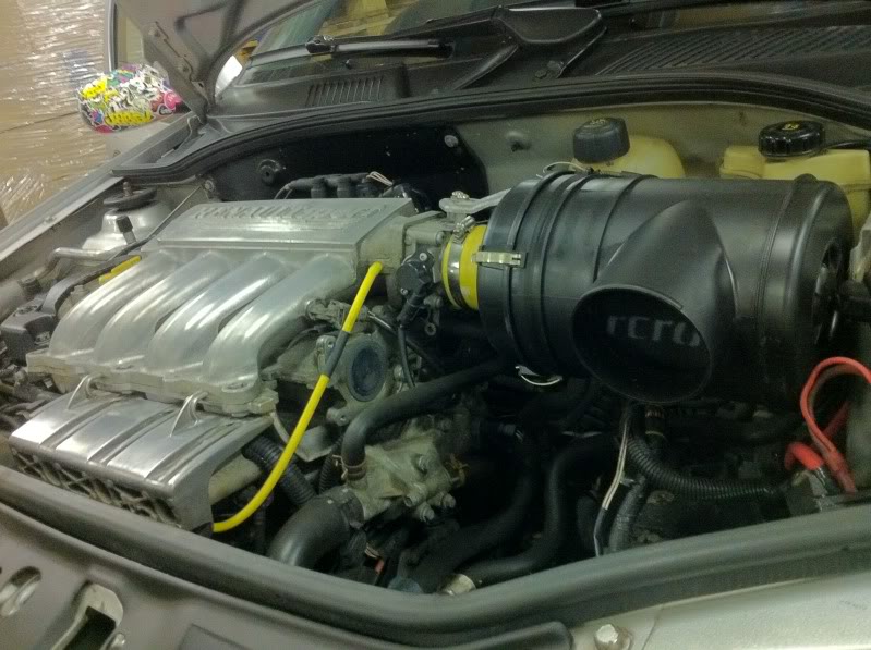

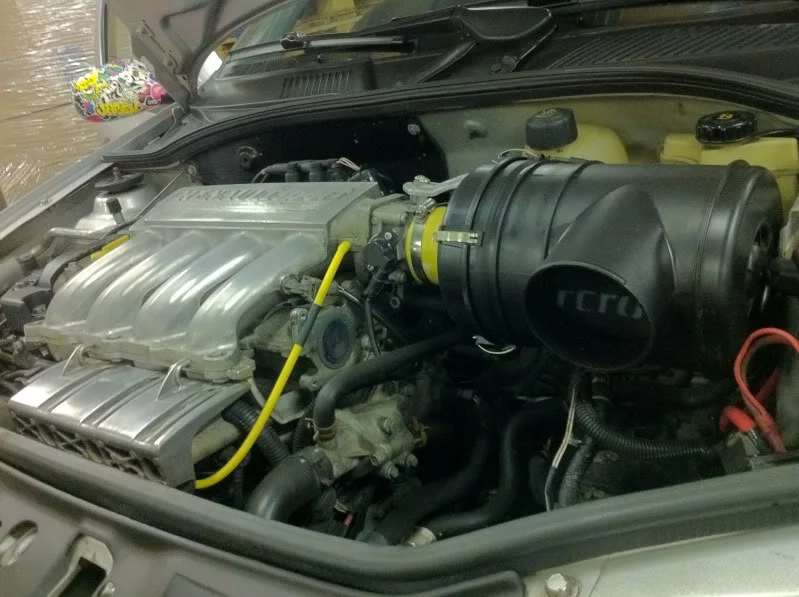

and finaly fitted the new v6 airbox complete with pipercross filter again really happy with it

Adam, you have harnesses right? Can you reach those window switches when driving?
They looks great btw :)
sticker tart! ;) that the sticker bomb book off ebay? ive been getting a bit sticker happy with mine too... lol! car is looking awesome though! :approve:
Yea u can get it off amazon as well, I'm planning a little more bombing on the interior soon too!

that look cool that little switch panel!

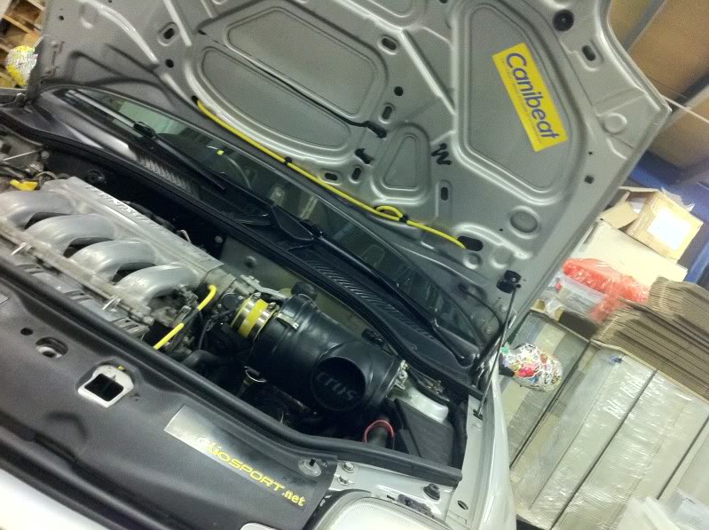

that yellow hose that comes off the little breather thing..... where have you run the pipe too?

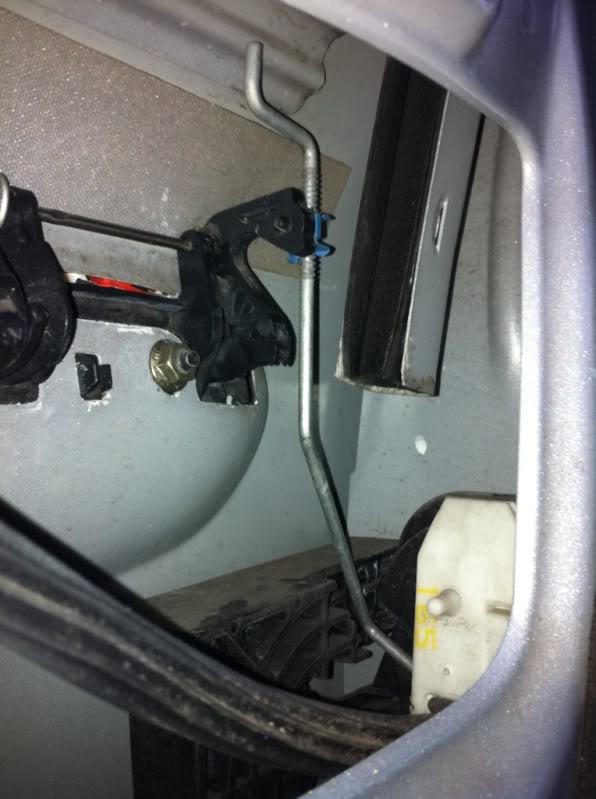

Not sure if anyone can help but since swapping over my door handles they don't always open properly? I'm not sure if it's to do with the central locking or the way I have put the handles back on does this look set correctly as I know thers a fair bit of adjustment
It normally just needs adjusting on that thing mate, clip it out and in again in a different place.
Really should have looked where it was clipped before an clipped it into the same place, but its obviously too late for that now. (lol)
LOVE the windows switches btw, proper tidy job.
Lol yea should have really marked it out it wa scratched were it been anyway but still now workin ??? mIght just play around with it
Just trial and error it.
It's just a case of how high it pulls the catch to open the door.
To a degree you can get a rough idea by disconnecting the rod and then pulling it until it clicks to open the door, then you check the amount of travel in the handle, i.e where it is at the top of this travel, then you can jus connect it accordingly.

cheers iv sorted the drivers side i just need to do p/s

right i am sorting out the carbon door cards as i type but where can i get the spacers from for the door handle OR what other thing have people done? thanks
i know there expensive but im not sure hoooow expensive, if i can look at one i might be able to make something similar. or see what others have done to get around having a gap?
