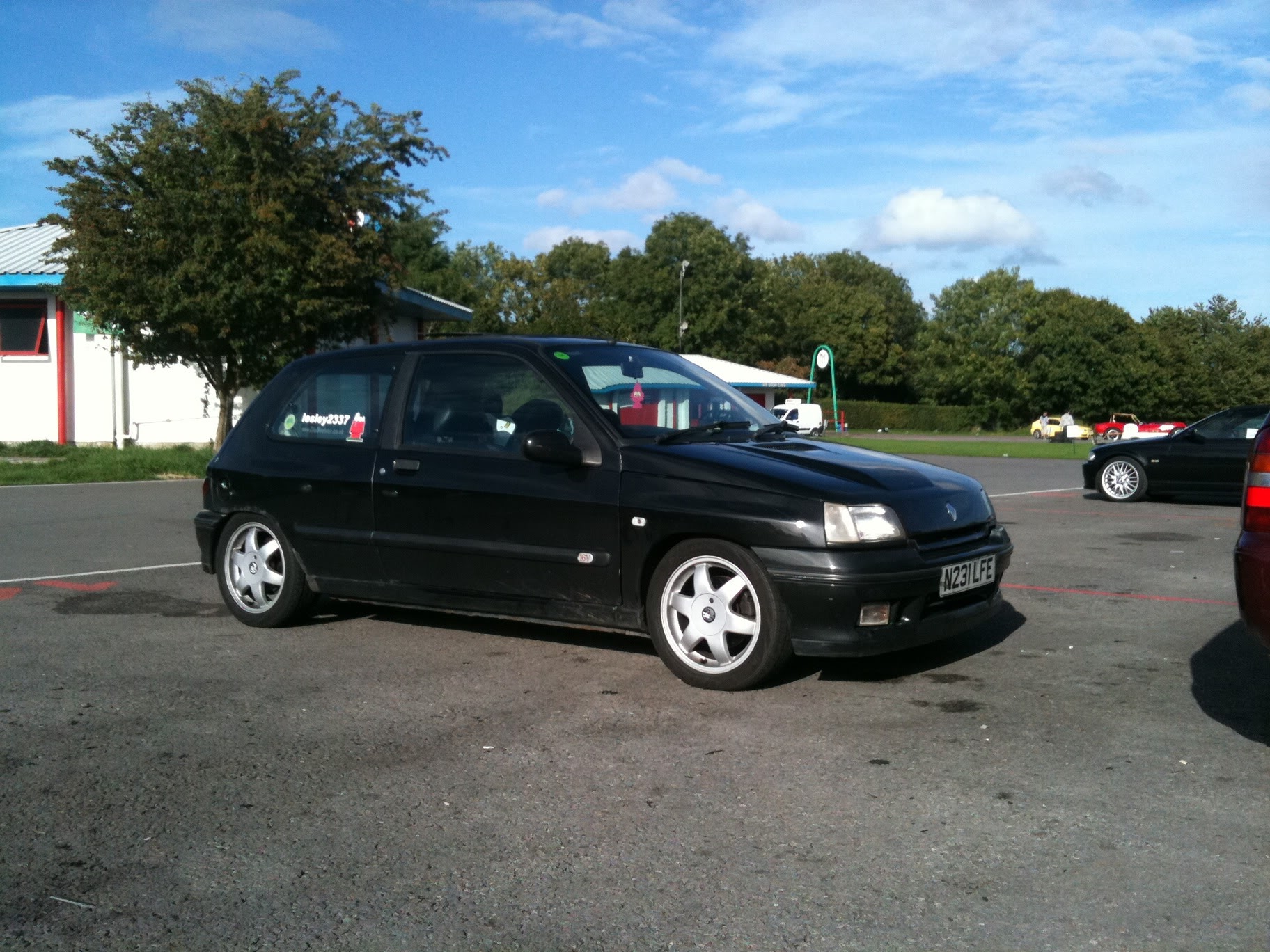

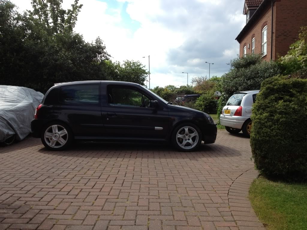

Im always messing around with different rims on our cars as like you my mrs just likes having stuff thats not the same as everyone elses, this is my mrs old mk1 on vauxhall cesaro wheels, and this is some scooby wheels I am using at the moment for mocking up some adaptors as she has seen some scooby rims she likes the look of (not actually these ones, but I had these handy to use for the templates)
What center bore are your rims?
On the cesaros even though they are 4*100 I had to make adaptors due to the spigot size being smaller than the renault and as we have several sets (wets dries etc) I didnt want to bore the wheel itself, plus I was correcting the offset too.
