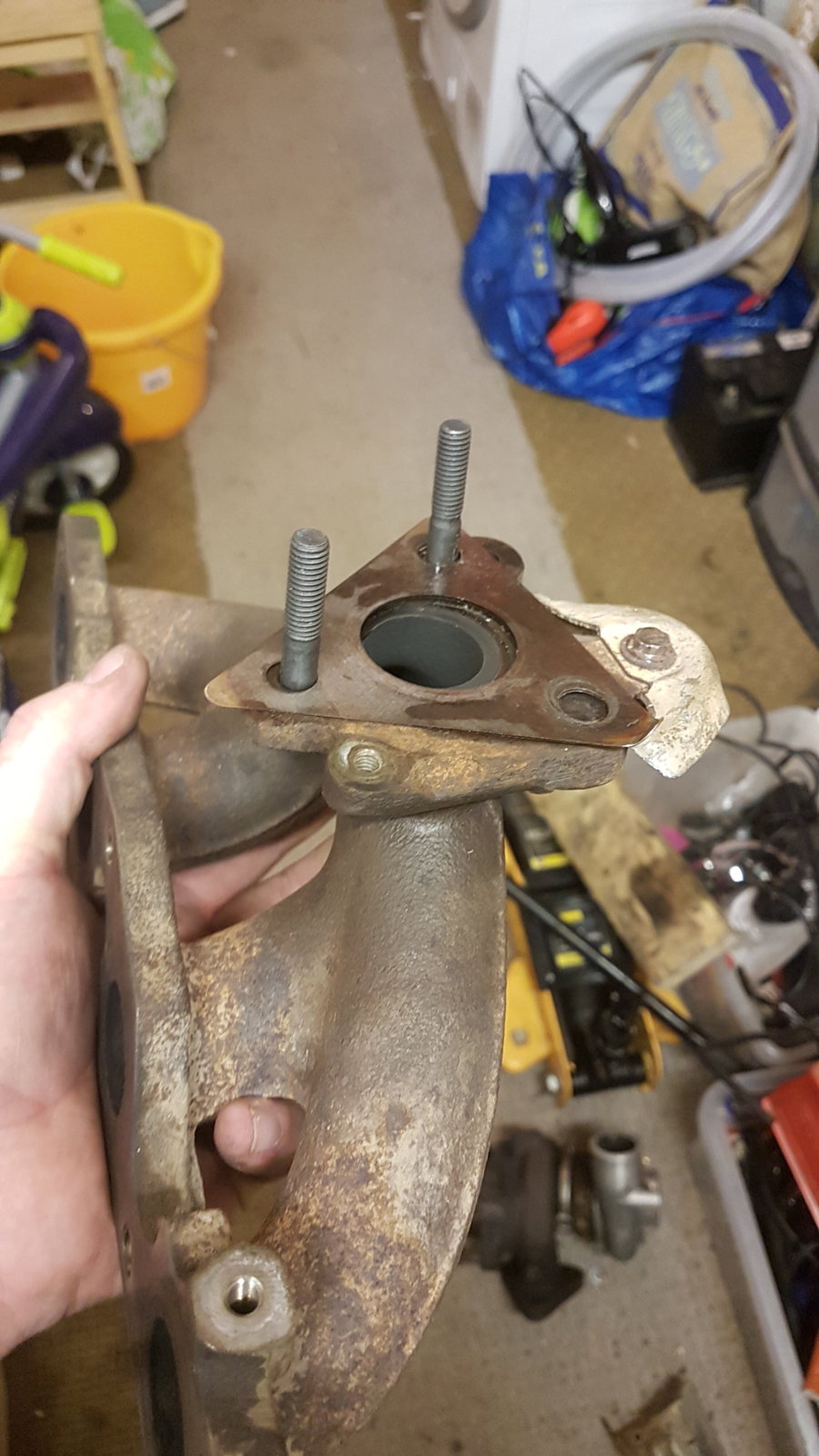

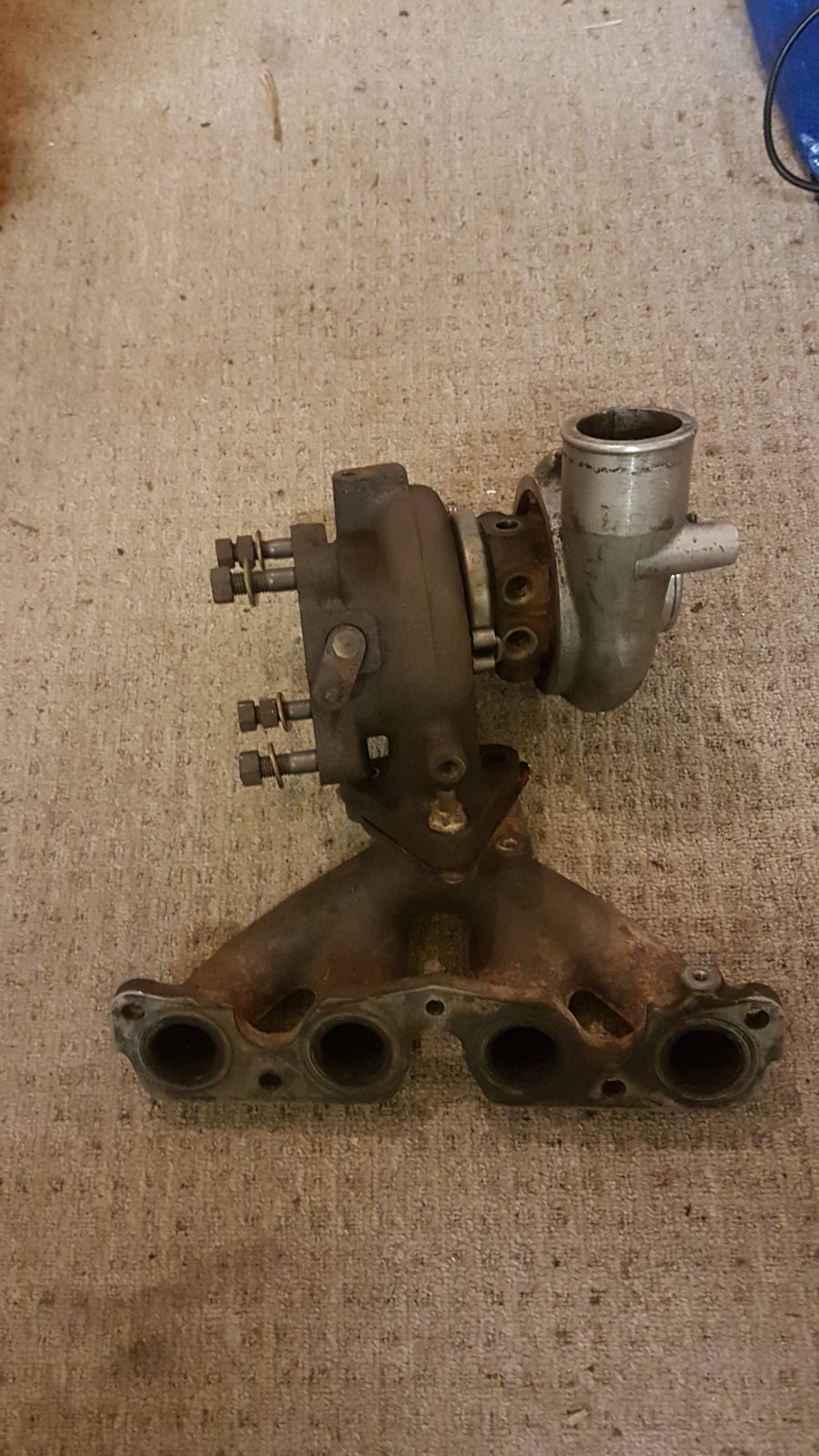

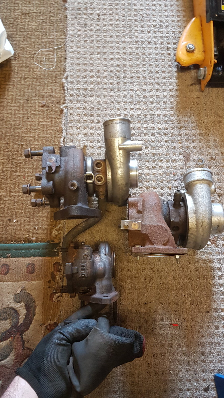

This is what im currently working on when i get a spare 5 min, Modified standard manifold holding a tf035 turbo (like a small td04 that the starlet guys like to use) the pic of turbos show the original housing at the bottom, and old school T2 of a Renault 5 GT Turbo and then the tf035 at the top.

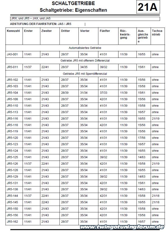

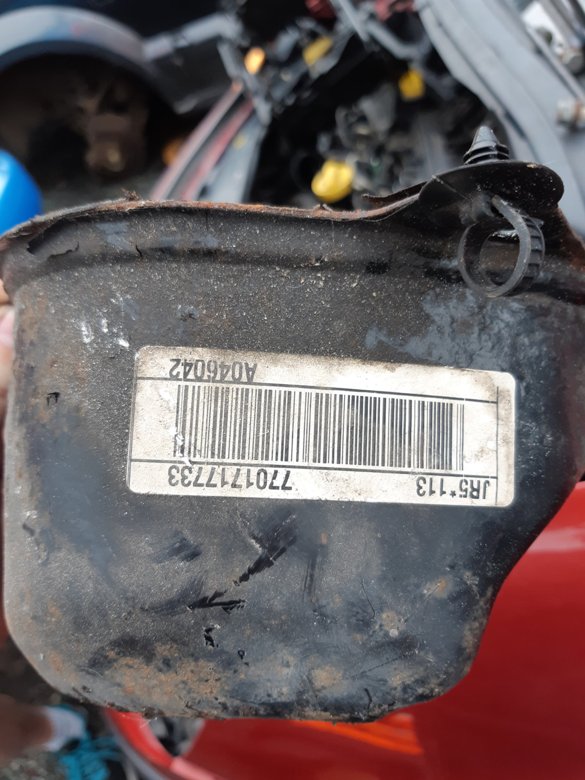

I cant find the ratios for the 120. Could be tempted if you fancied pulling the 5 gear cogs off and posting them to me and scrapping the rest? i want a longer 5th for the JH gearbox, not a JC.
JA3 JA5 JH3 and JR5 all seem to share parts
Adey.
Easy peasy job, thats why only want the 5th lol. In fact ive done a 5th gear replacement a santpod car park before lol. No bother i look around locally first as its a 3 hour each way trip on a good day (y) and postage on a box aint going to be cheap.
YorkshireKyle
Not all gingers stink of piss. But I do.
Aye but I'm lazy and I can put £10 on there being something else you'd need from the box ? ? Postage would be about £30-40 so yeah, about the same price as the box haha

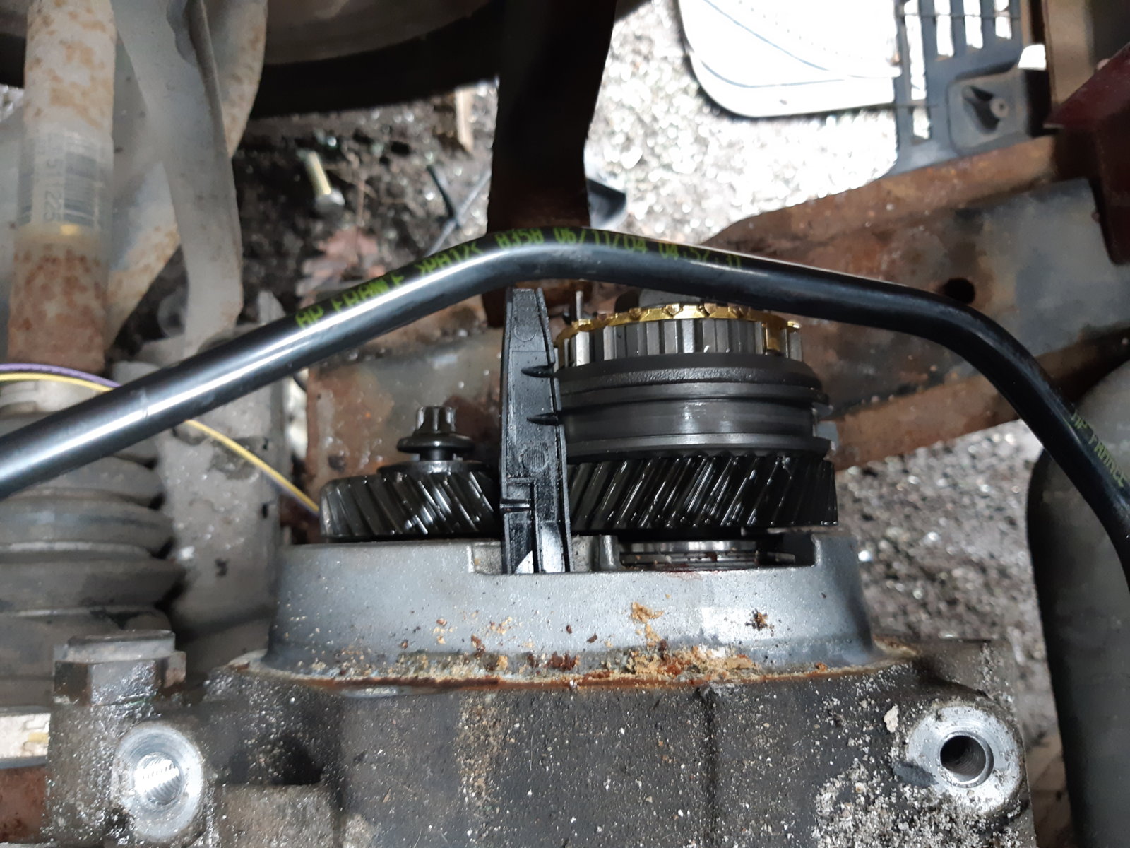

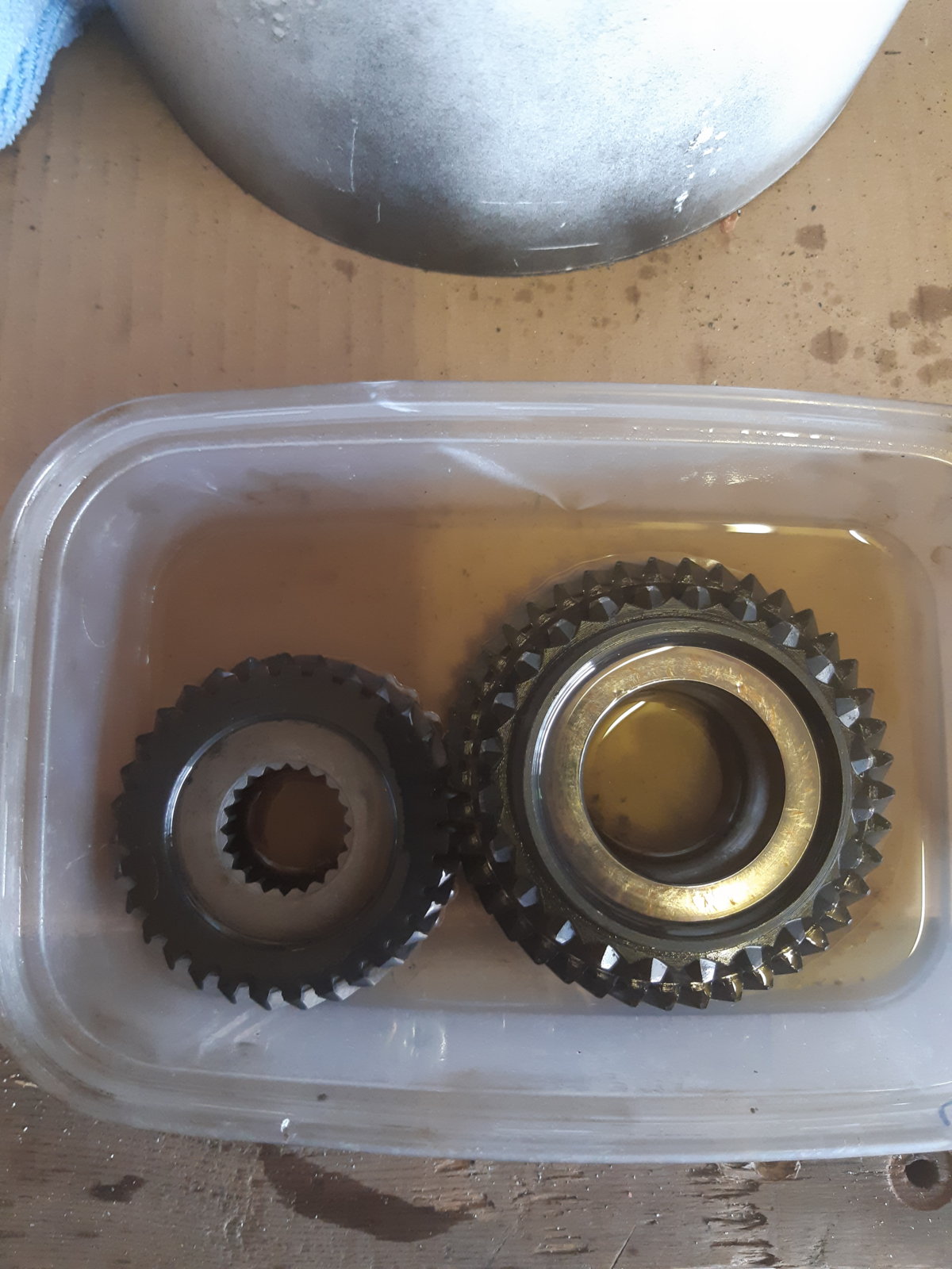

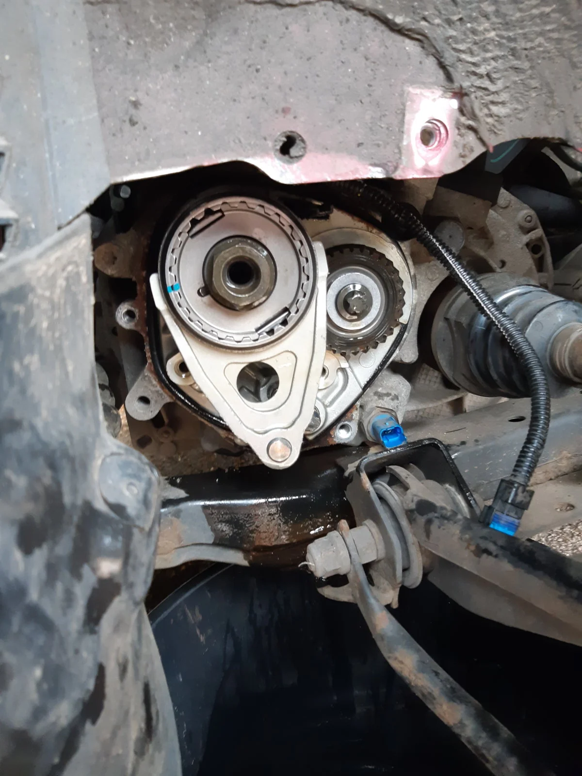

Scrap yard haul today for a 41/31 5th
lgearset. Pulled from a modus that we didnt have the locking wheel nut key from so had to do everything from the top.
Got home and set about fitting it to the twingo. TBH it wont be a massive difference at all but should drop the rpm a little in the motorway cruising spot.

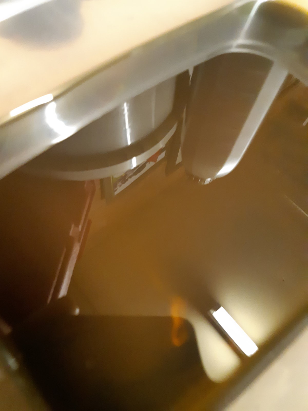

Downside, I'm not sure if the gearbox oil has ever been swapped out, it wasnt pretty and I'm not sure it will last long tbh. I noticed a bit of end float on one of the shafts too. Ahh well, see how she holds up.
Adey.

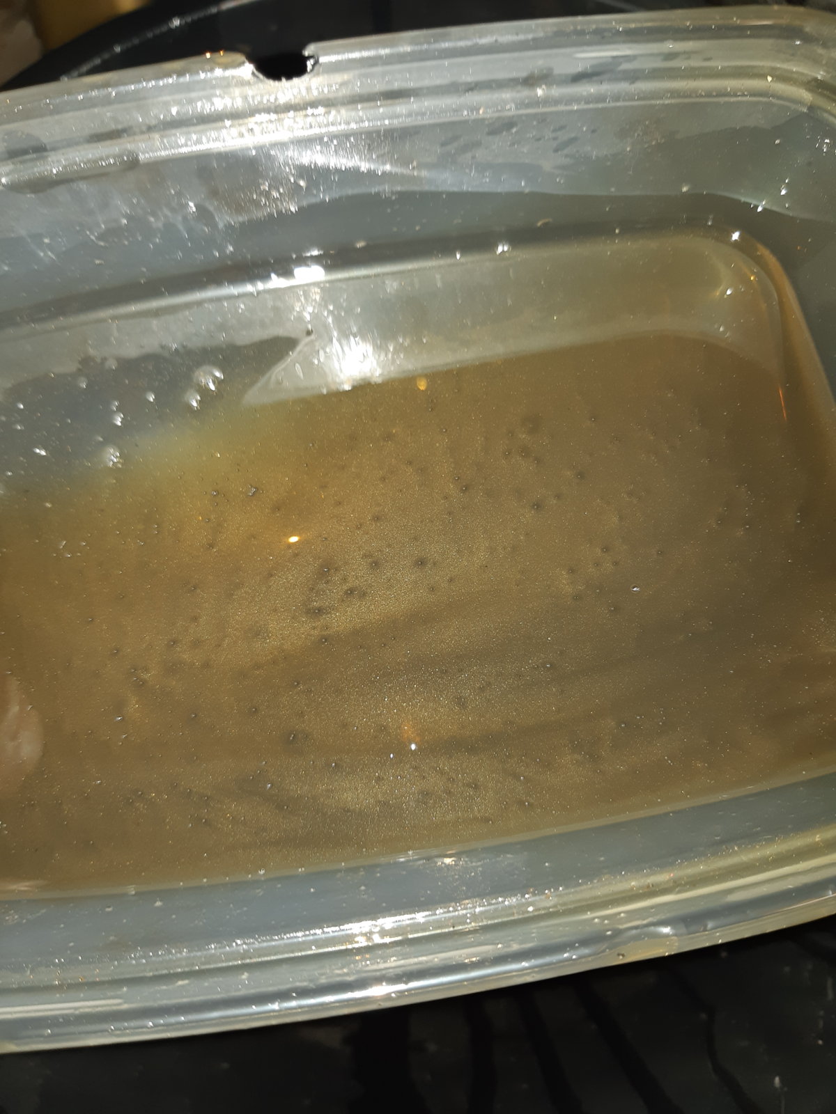

So I'm a little happier at the suspected gearbox condition. Rather than look at the oil I caught in a bucket after I removed the end cap I pulled some from the drain plug into a clean container. Looks loads better, I ran a magnet through it to see if it would find anything but picked up nothing. Filled it back up but I'll drop it again at the next service.

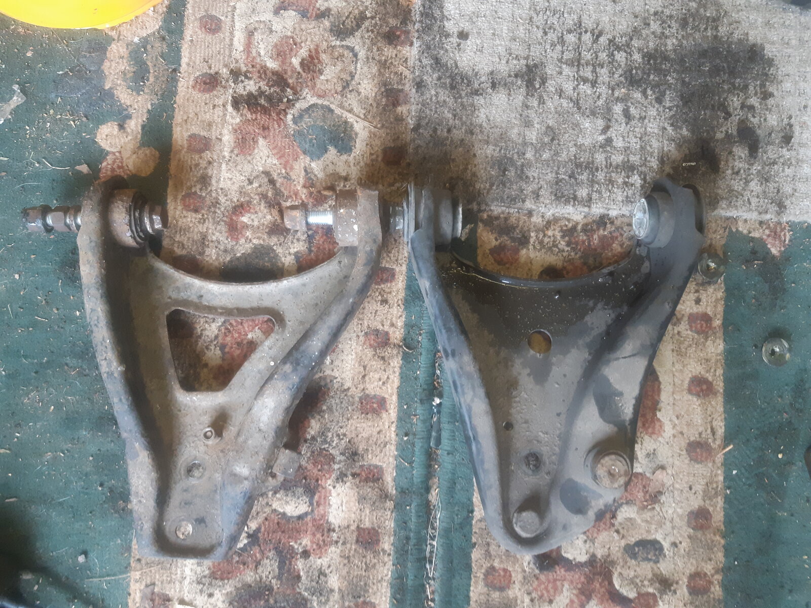

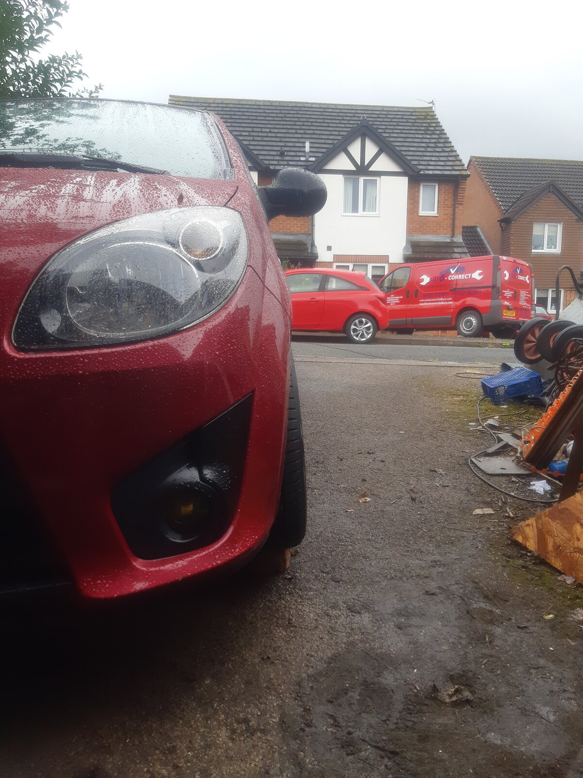

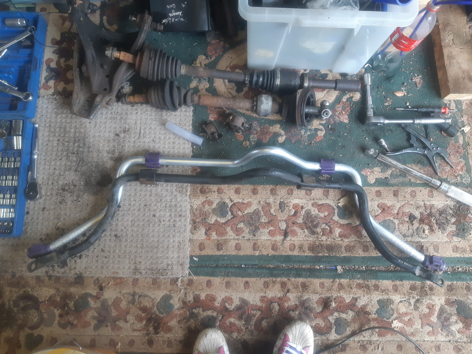

Front wishbone and arb upgrades with added stiffness and extra caster. Basically the twingo has the povo spec clio style arb though its the same width as the 172 item and the wishbones are near enough the same size, just a slightly different shape and angle of mounting the lower ball joint. The Arb looks to be 1mm larger on the 172. I collected some parts off a friend and went ahead and fitted them up on the twingo. Jobs not finished yet as the inner arb clamps are a dick to do on the drive.
Copied from Truborenault.co.uk

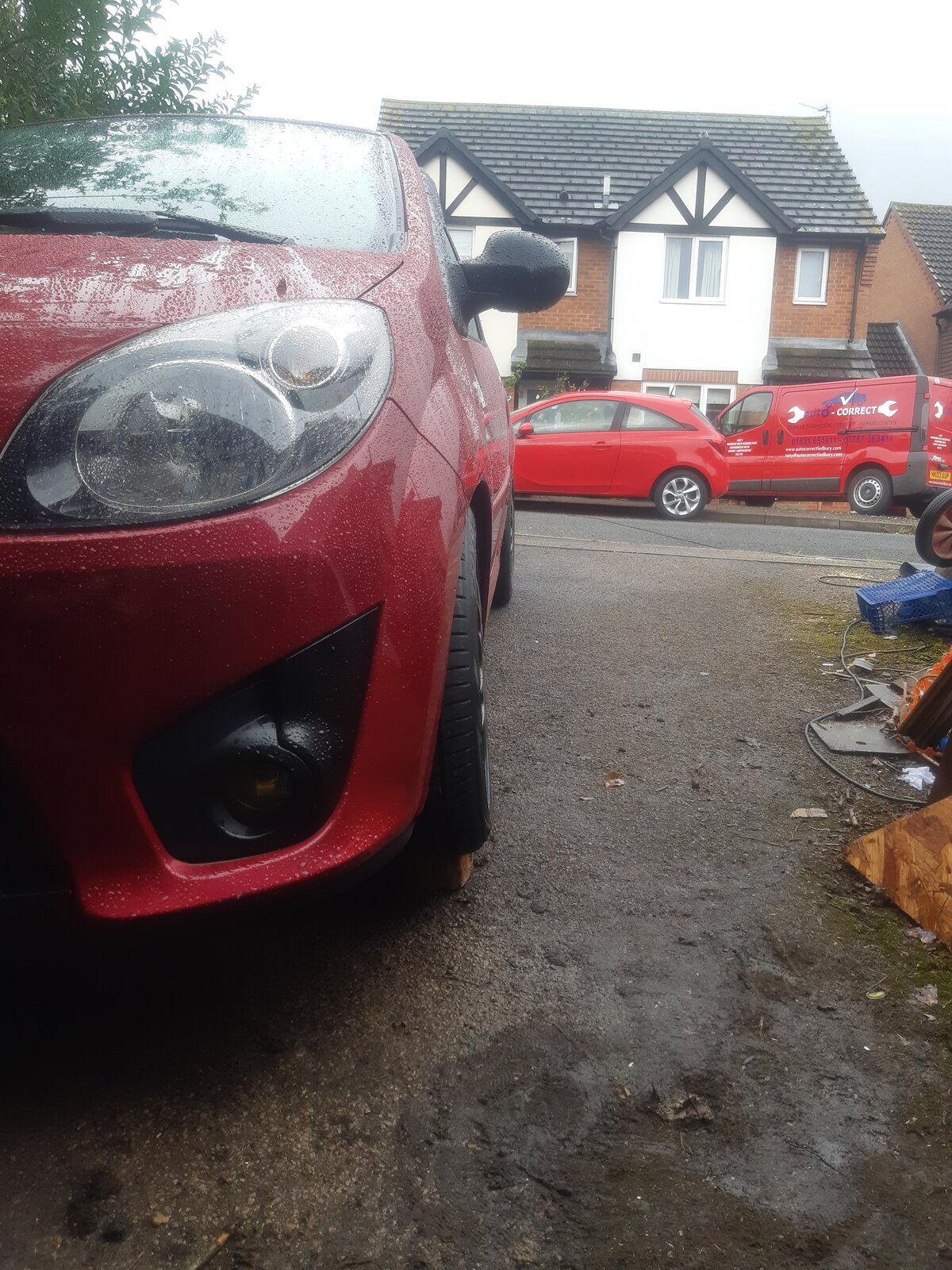

What a s**t day. 1.5 hours ish to swap out the twingo arb and wishbones in the rain. 5 hours trying to get the inner arb Bush clamps back on. One is there loose the other doesn't have a bolt in
the wishbones are very similar upon removal though the 172 items look to give a chunk of extra caster and possibly some extra width. wheel looks to.be about 10 to 15mm further forward. All needs aligning properly once I get the arb clamps sorted. I'm yet to drive it under it's own power yet but all seems ok so far. Once done it should aid handling a little.
Need to measure up the rear next, would be nice to be able to upgrade to a stiffer rear end with disks instead of drums. The twingo gt has the same rear track width listed as a 172 anyway so hopefully the beam will swap in easily.

Rear beam is the same as 172. Go to a breaker and pull the rear end out of a 1.6 16v later Clio with rear discs as the ABS sensors need to be different to work with the car, that will bolt straight on and then you can buy a whiteline rear arb too 👀 😂

im assuming the 172/182 rear has a stiffer roll bar than the 1.6 stuff, hmm ill see what i can find down the scrap yard.
Yeah but the stubs from the 1.6 bolt on to a 172 rear beam haha
Calipers and carriers are all the same and so are the discs. Its just the roll bar thickness is bigger in the 172. If you wanted the best get a 182 rear beam as the later ones have stiffener fins down under the spring pads
