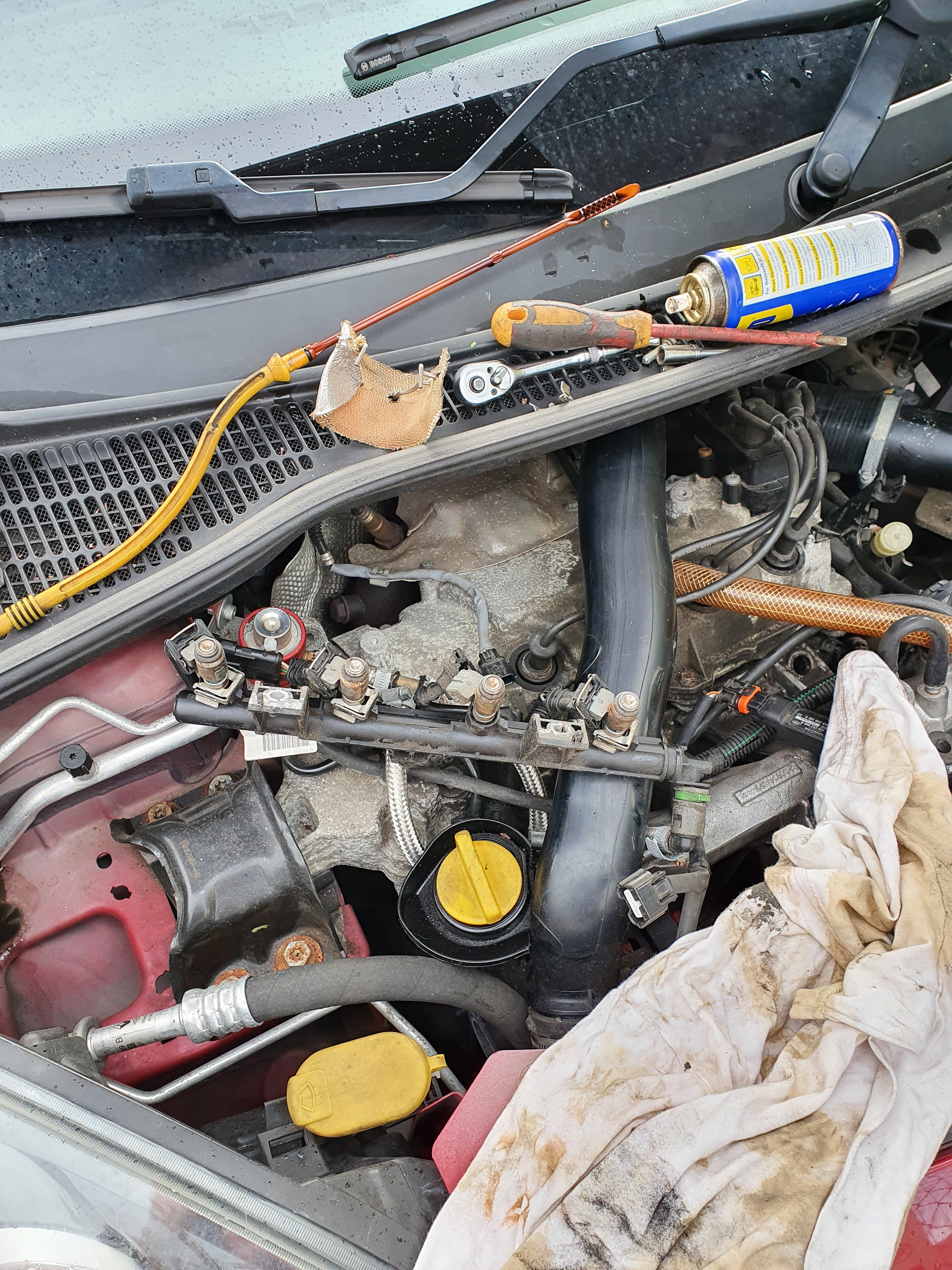

So first day of new ownership and a few very minor things to sort. Secure the battery in the boot, easy and quick 👍🏻 identify and replace duff injector causing the eml and lumpy idle. Whilst the rail was out I decided to pop the multimeter on all of them, all well below par, so with the 4 injectors tarby gave me and 2 I had left in my stash I managed to find 4 matched to refit. All seems good now so just need to give it an eyeball and book a test.

So passed its MOT, then i got stuck in the mother of all downpours, stuck in floods, the wee twingo did its best to keep me safe and dry (ish). Ended up having to get a hotel for the night. Ive never s**t myself so much, water kissing the wingmirrors! She is very wet and running on 3 now. Hopefully its just an injector again....... Ive tested it with the multimeter and im getting totally open on number 3 so fingers crossed its just that. Oh and i lost my number plate in the flood water. Fun times.
Adey.
not at all. 5 hours to do a 20min journey and freezing my tits off as I pushed some stranded cars out of floods in my shorts 🤦🏻‍♂️night in a travelodge was crap too as it was so noisy in the town center.
yeah MOT was all good with a couple of "minors" 😉😁

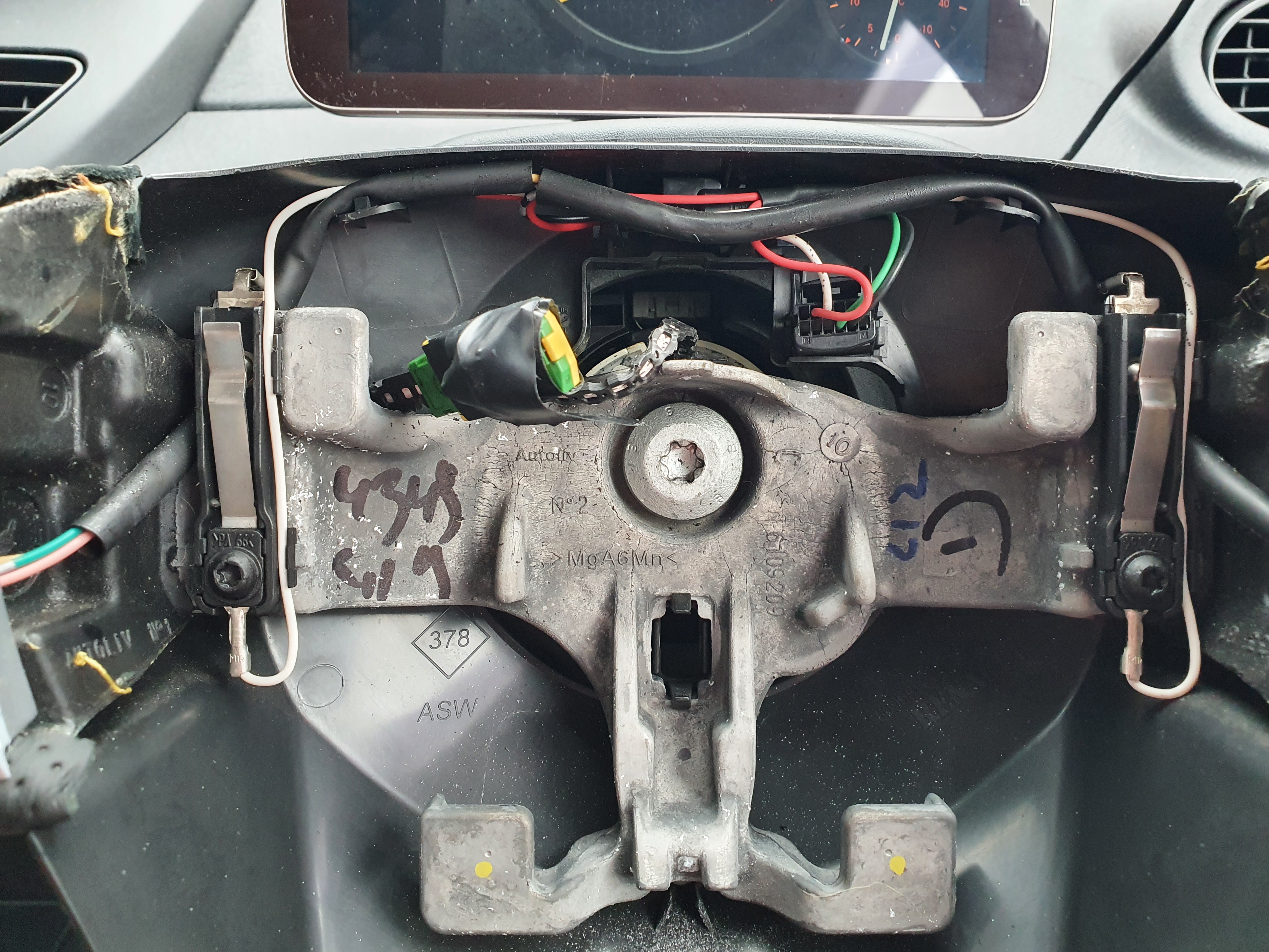

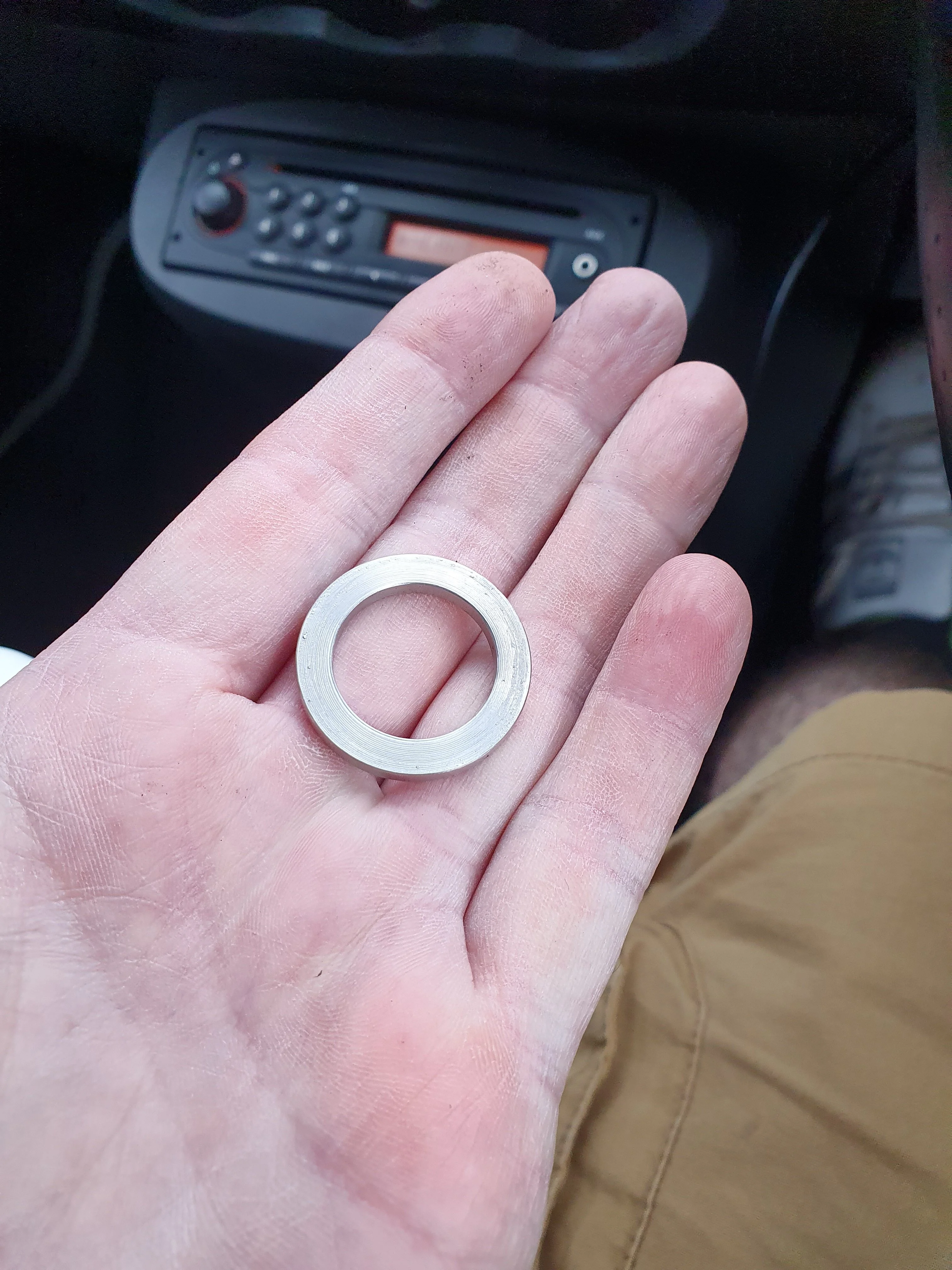

Such a little part but a big difference even though I'd already rubbed some of the cowling away for clearance. Now its smooth as silk when steering. I'll need to sort the indicator self correct but I'll wait till I find and fit a cruise squib for that.

Looks good that, how are you planning on adding cruise control is it just pulling the loom and wiring it in?
yeah basically, ive dug out the wiring diagrams and i will need to add a cruise squib and a few switches plus the wiring. Ill get the connectors and things I need from a scrappy once we can get out abit more. Looks to be about 4 wires to the ecu to get it working.
  Boosted Twingo RS133
Seems an easy jobby for such a reward might even give it a go in my RS when youve got it working!
But ill let you do all the hard work :ROFLMAO:
Adey.
Are you sure yours isn't already pre wired for it? Some are and its just a case of adding the switches. Mine isn't so needs extra wiring. Check behind the panel on the right of the column to see if you have a spare plug floating about 👍🏻

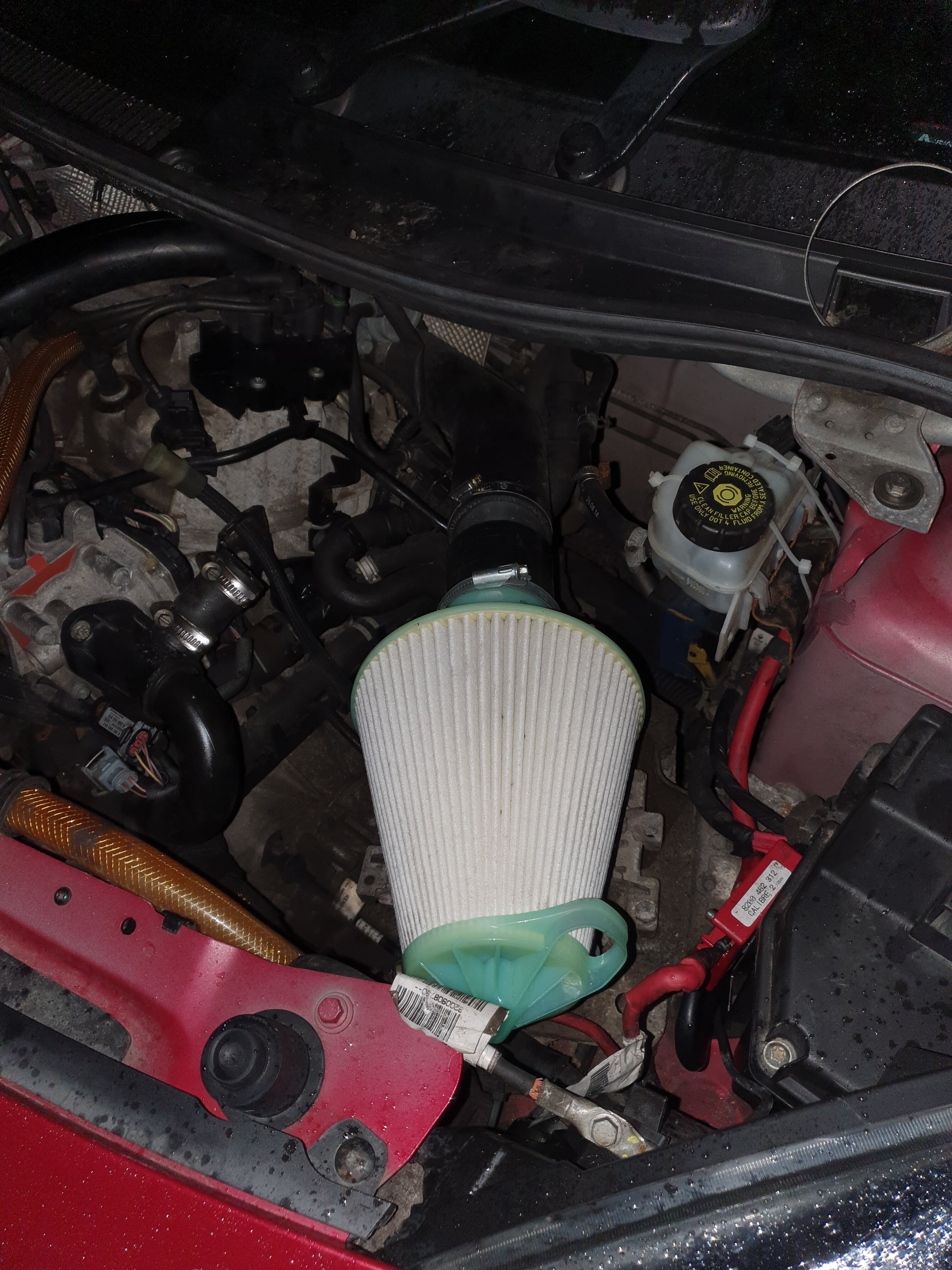

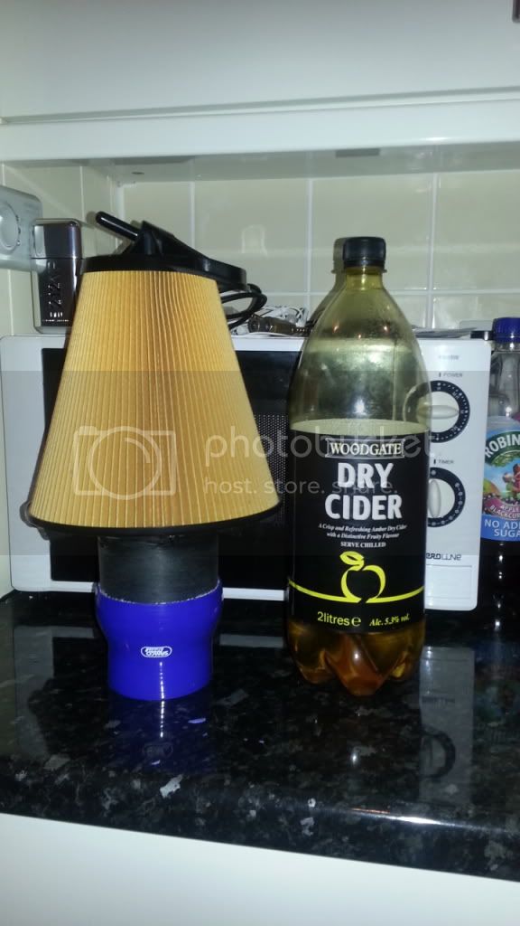

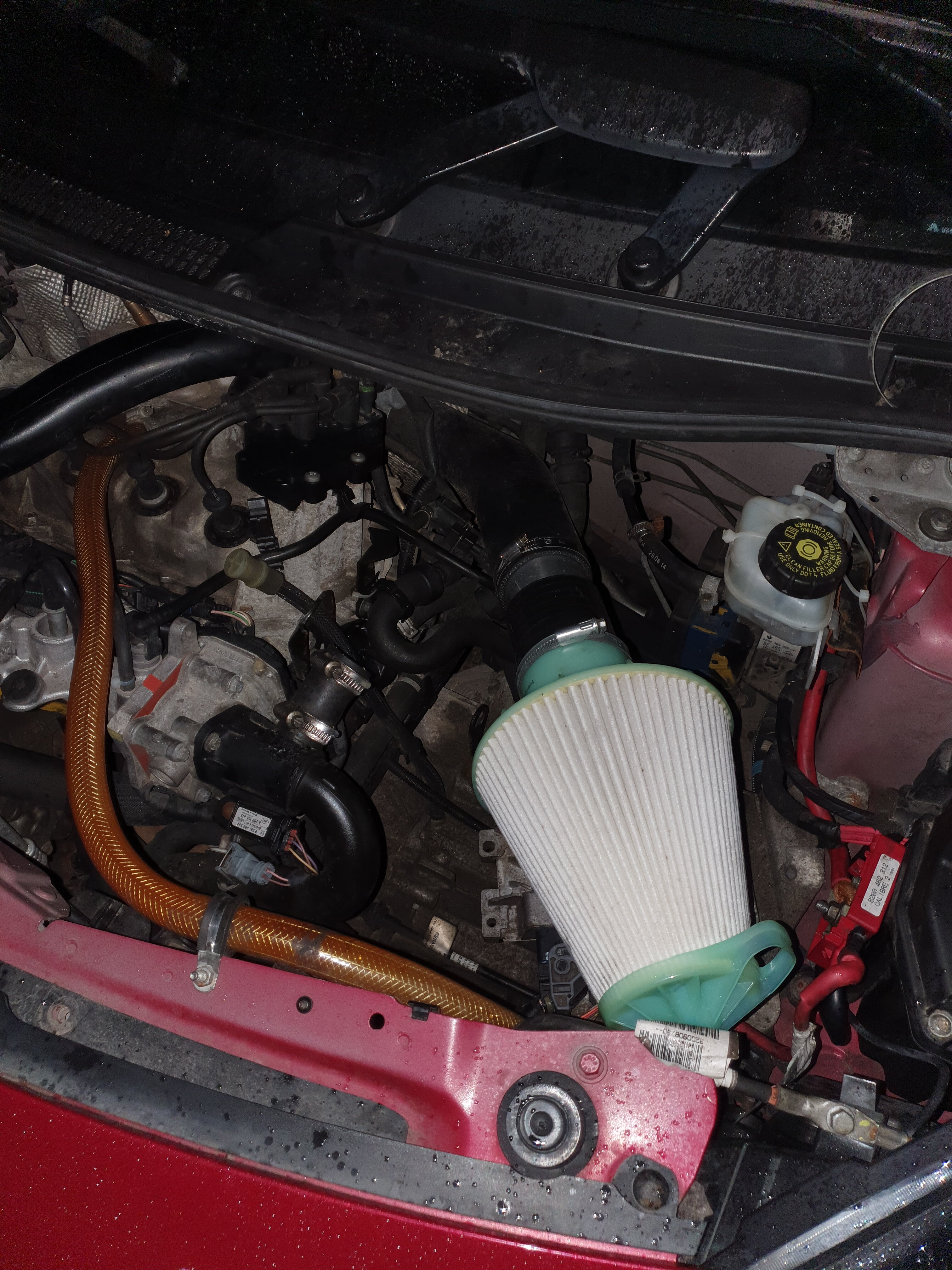

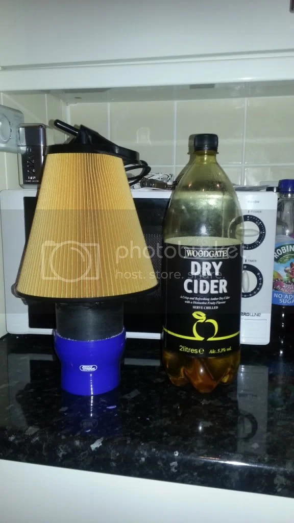

Slowly working through some bits on the Twingo, a cruise squib has been ordered but I've heard nothing else on that since ordering 🤷🏻‍♂️ On the engine side my old ramair filter was battered and bruised, so I decided to slap on the tried and tested (on hondas and vw 1.8t) s2000 cone filter. f**k me it dwarfs the engine 😅 good for a factory 240bhp so plenty big enough for the Twingo 😁 makes the old ramair filter look tiny. Found a pic on the internet for a size comparison.

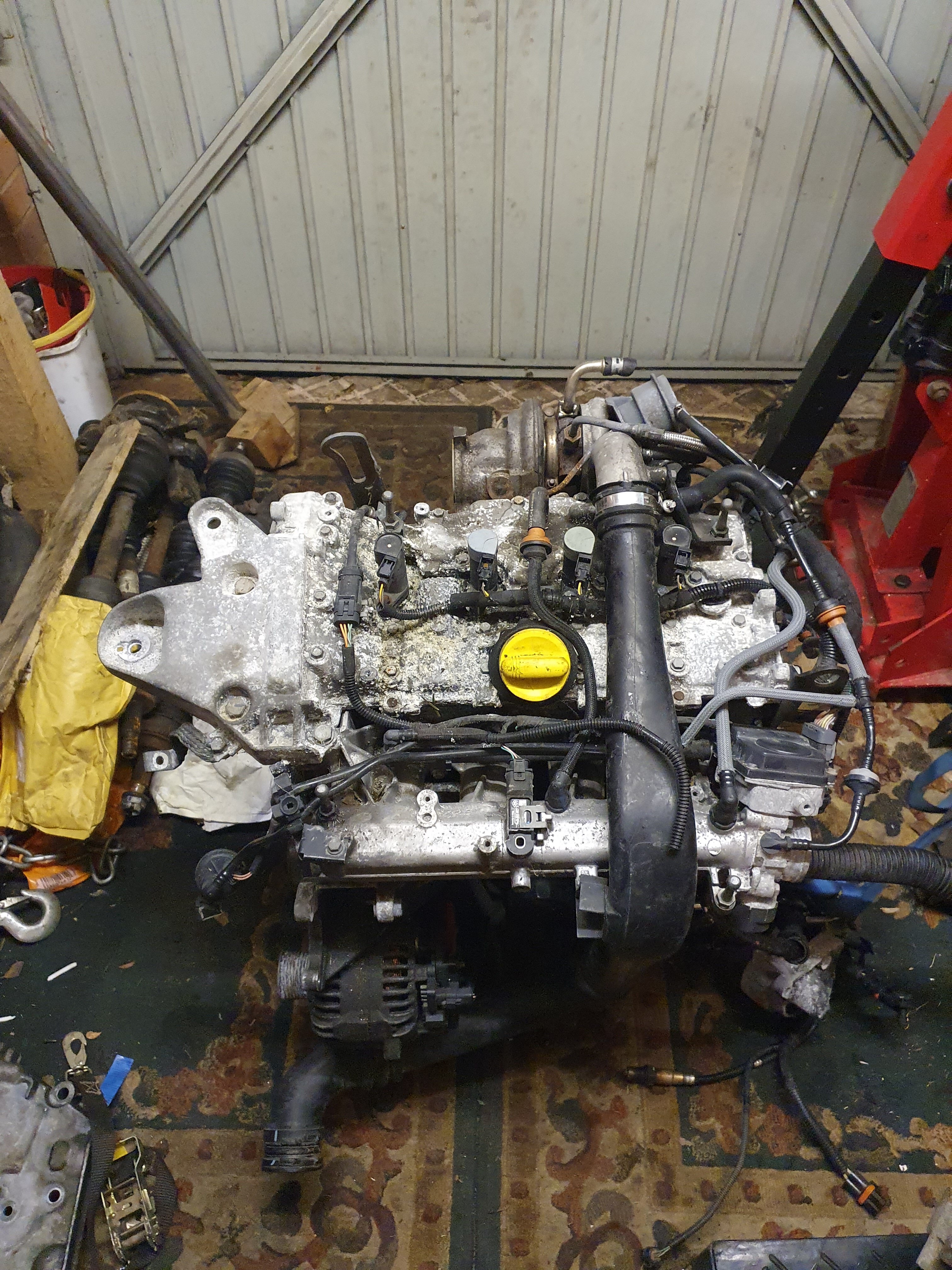

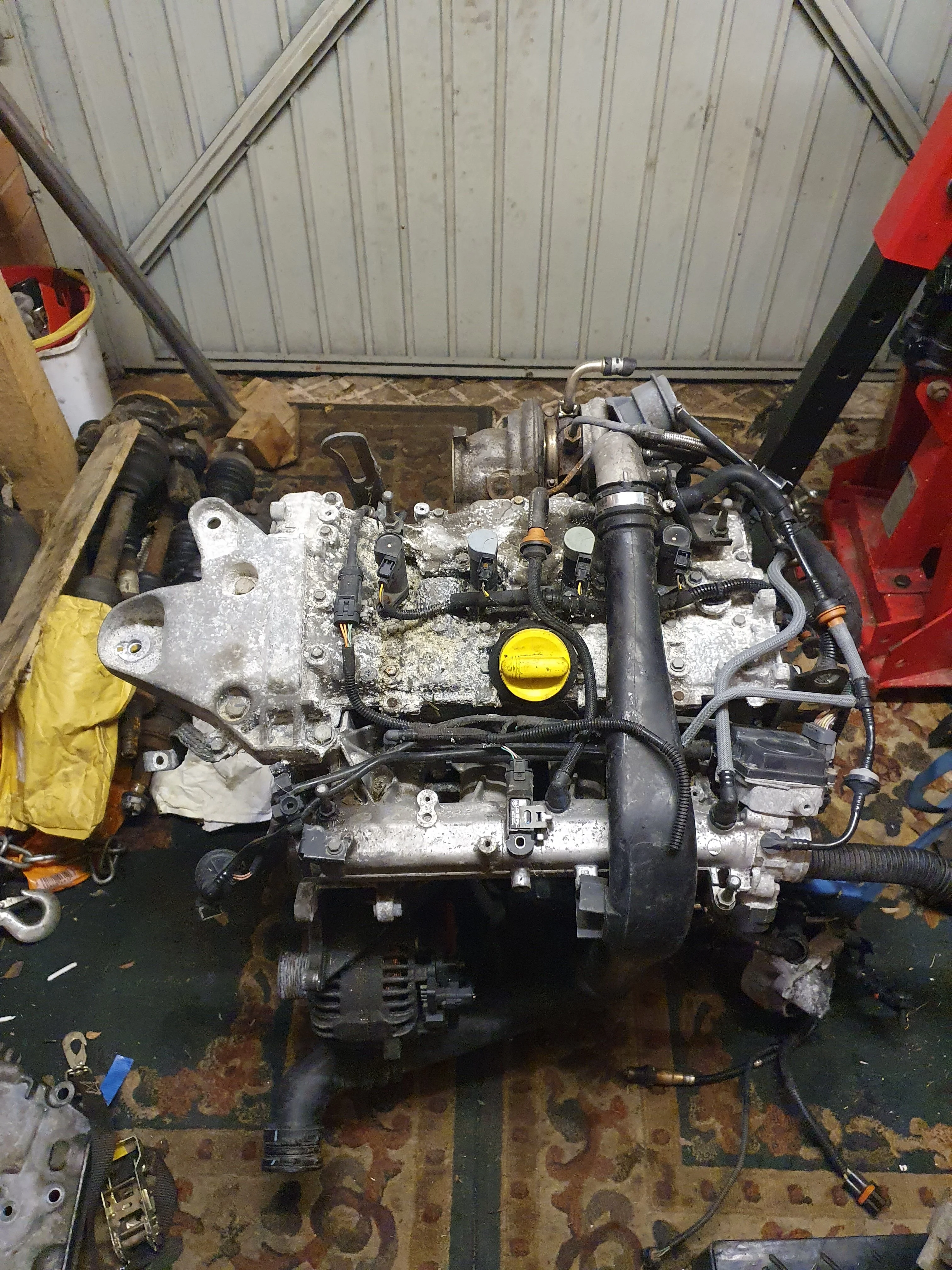

So if the dopes engine build/gearbox swap was Project Lockdown 1, that would make this silly idea the Project Lockdown 3??
Take one perfectly fine and useable twingo and make it unusable.
Buy an unseen but so say good condition and near complete F4R784 which is a Laguna GT205 engine and then try and figure out the cheapest and easiest way to make it fit. Most of it I think I have sorted/planned now. Not looking for mega power, a nice useable 225 to 250bhp would be nice to try and keep the pikey build from exploding. The light chassis should make it quite fun to use. The engine spins by hand so ill give it a cursory look over, but should be fine for the twingo and being from a laguna im going with its not been beat on as if it was in a meg (y) from what I can find the cams maybe slightly different? but the turbo is defo a 14t and it has the same injectors as a 225 👍🏻
