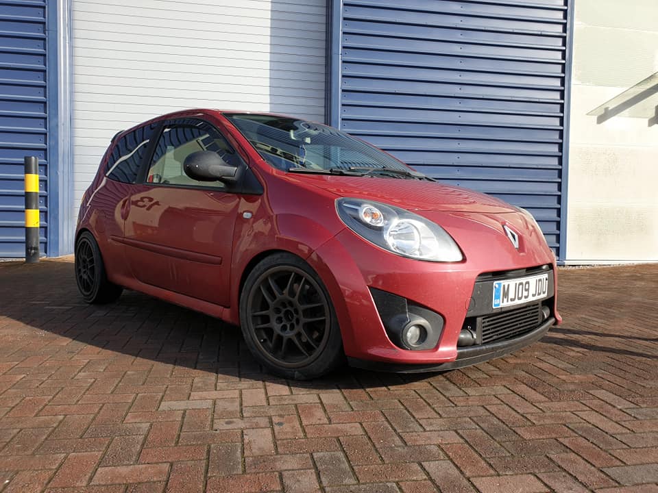

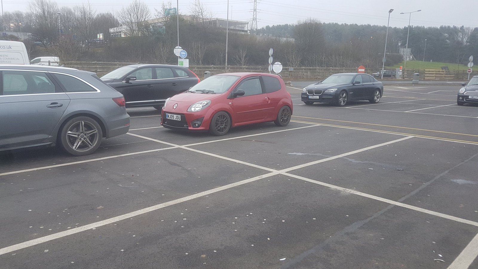

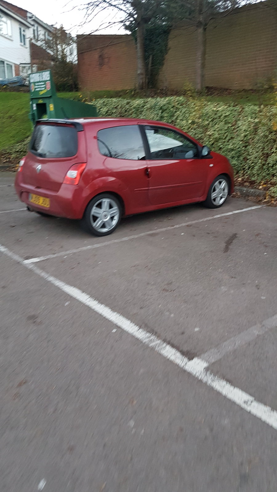

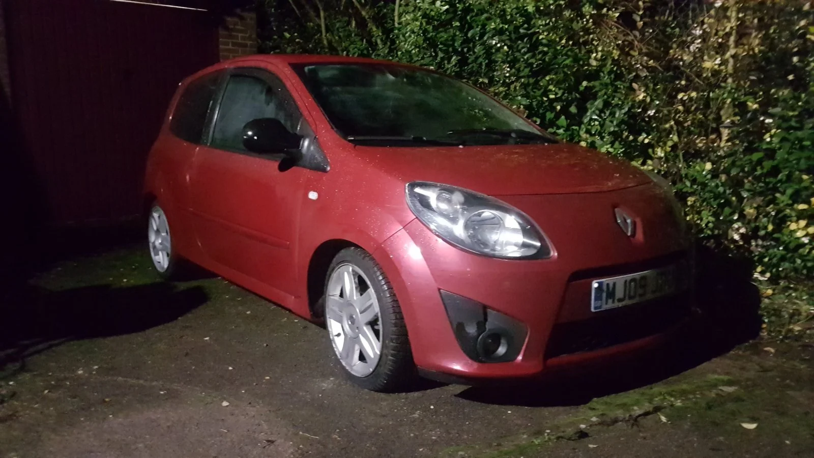

Its a 2009 twingo gt in a metalic red colour. Purchased/exchanged as a modern eco warrior daily. Not sure what will happen with it yet, defo needs some wheels and new tires though.

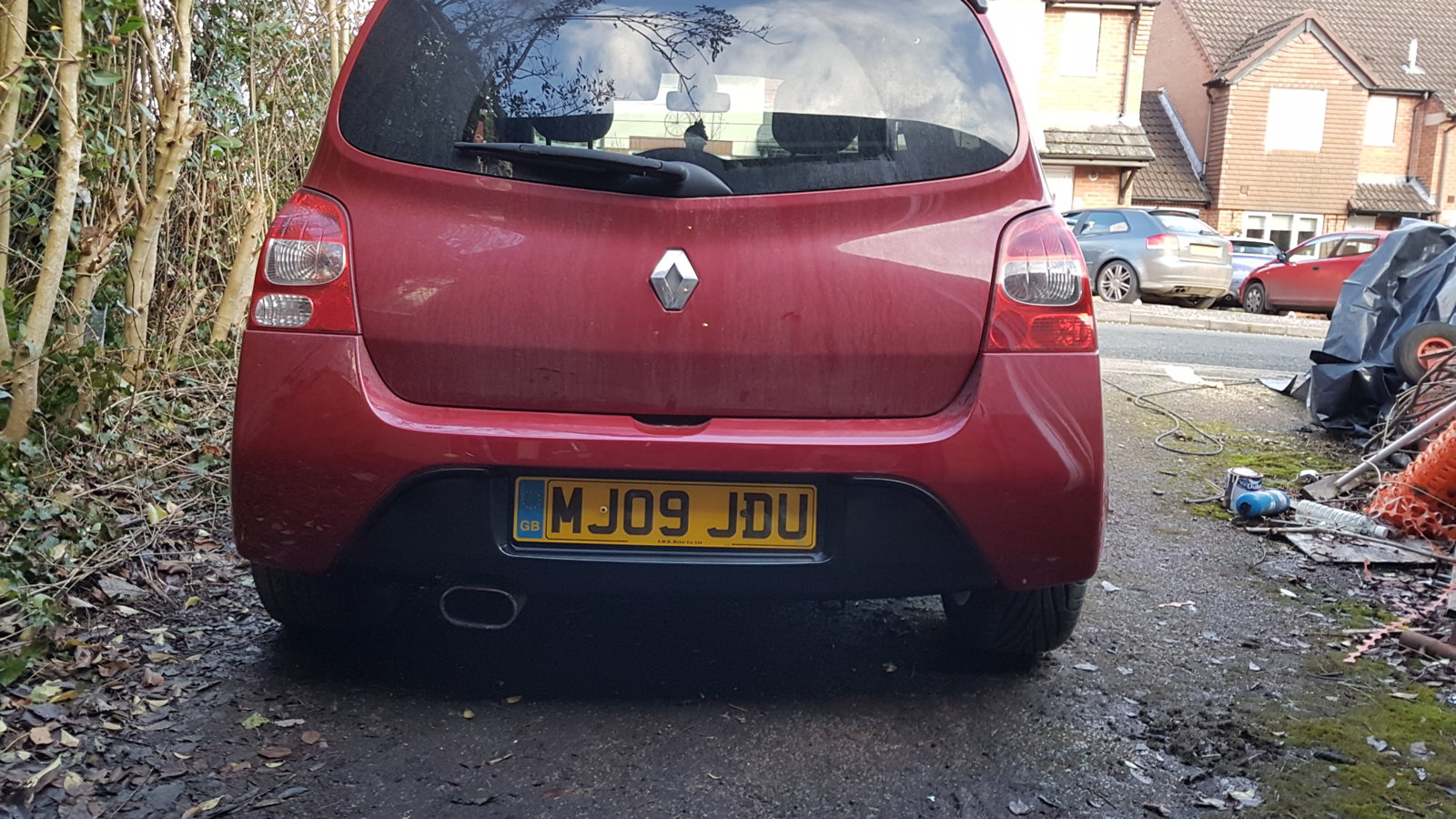

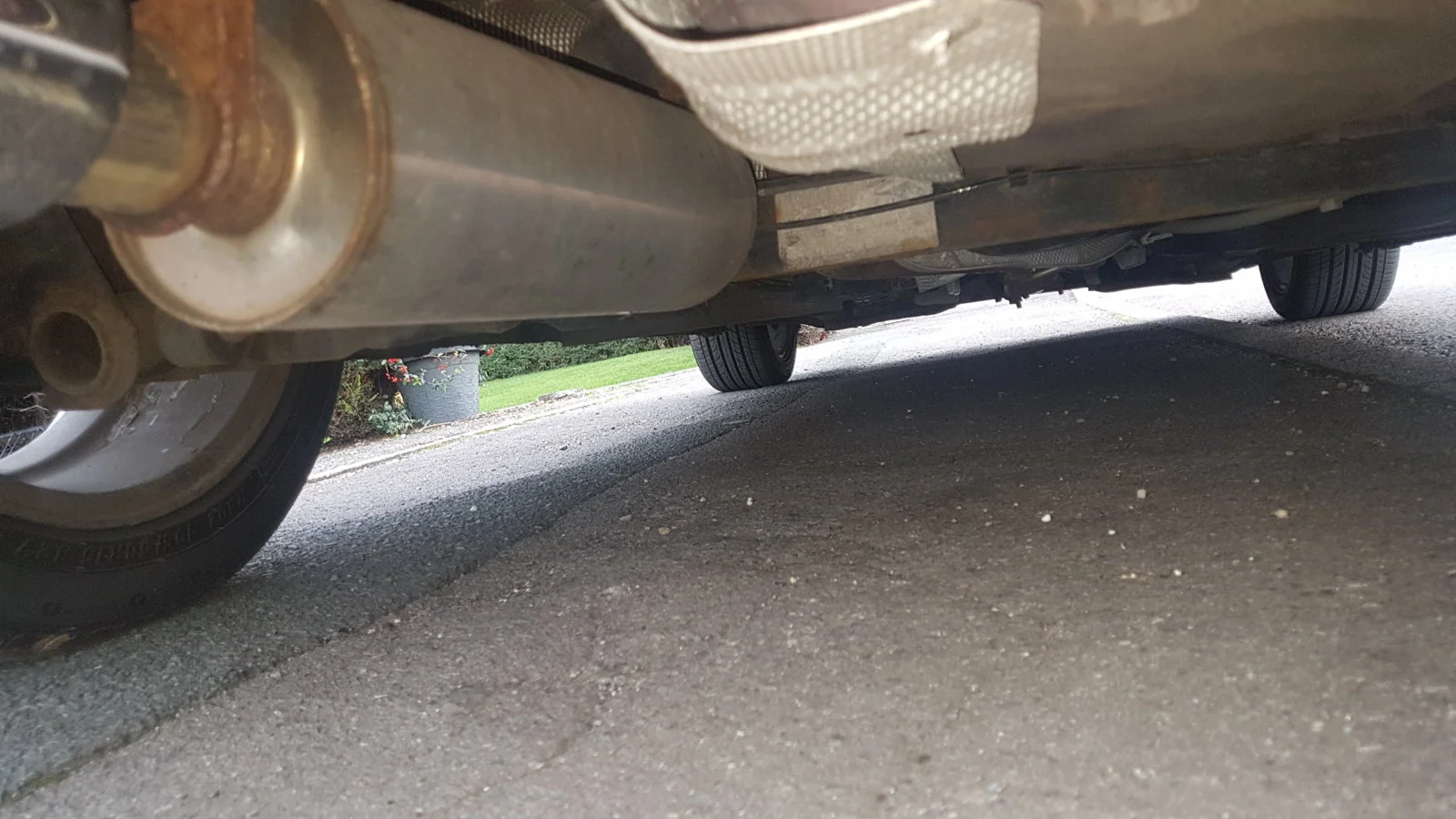

She has what looks to be a ktec exhaust system fitted and it isnt too intrusive at all, some lowering springs and some hideous wheels with no name tires fitted for that damp roundabout drift sesh everyone loves......Drives well to be fair and seems to run on fresh air. The little 1.1/1.2 (depending where you read) 1149cc turbo looks to be boosting at around 8psi giving a factory 100ps (99hp) or 104bhp on overboost. I can see a little ecu reflash happening in the future maybe with a decat and bigger injectors.
So i have a slight plan of action for the twin-go-slow. a few areas need sorting for me, the suspension and wheels (so coilovers needed) brakes (either 285mm txi brakes or some sort of hub swap for 172 items) and the engine.... fmic, proper downpipe, air filter, bigger injectors, bigger fuel pump and then remap) that on the engine will probably push the limits of most of it but should see a solid 140/150bhp according to the web, theres also the possibility of further with a hybrid turbo and an uprated clutch. hopefully i will still have it and its still usable for next years national day (y)
wheels should be sorted this weekend, i have a set of clio 172 16inch wheels on the way, ill prob swap out for 15s at a later date. not sure how they will look yet though as ive not seen a twingo on them.

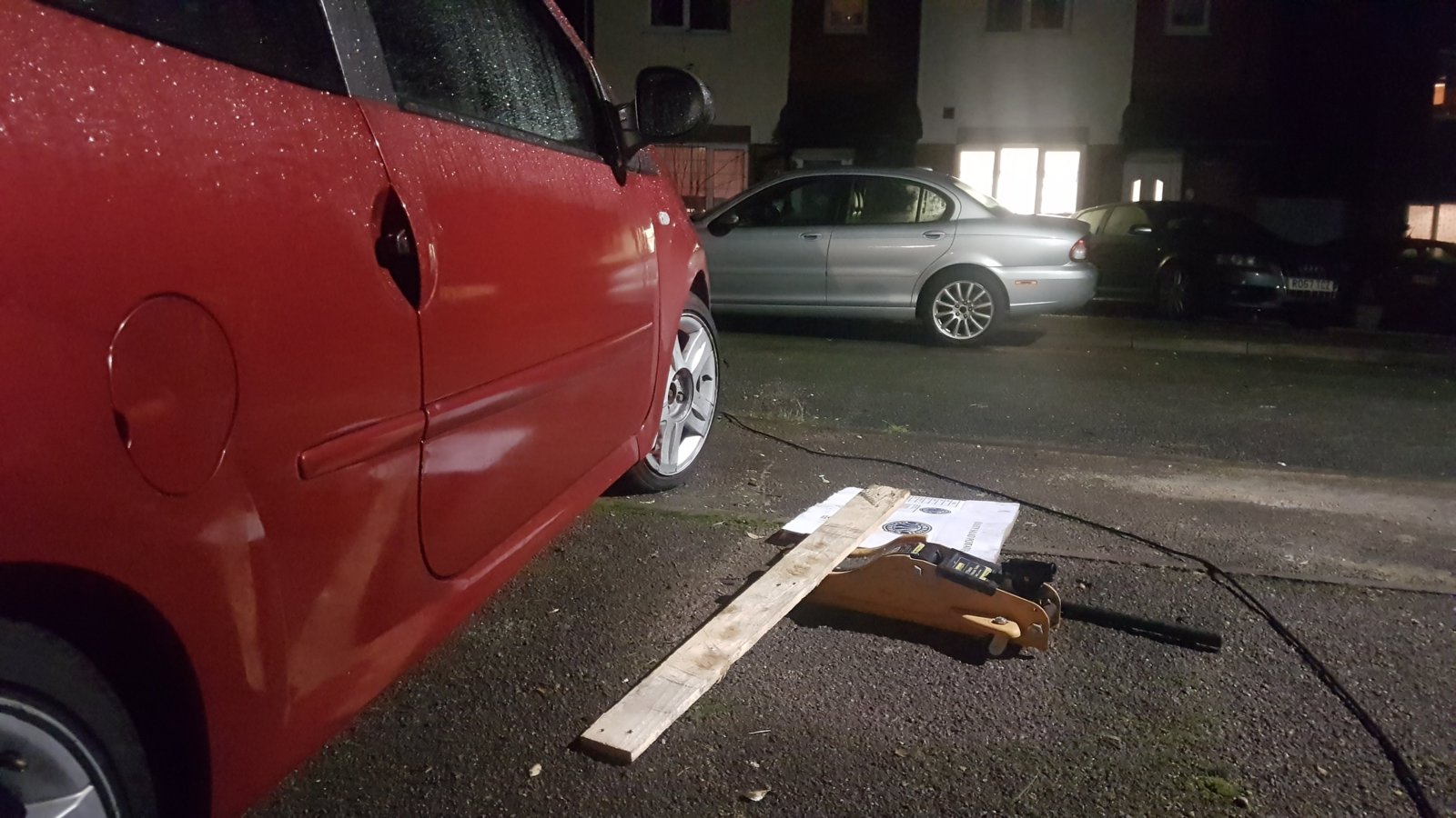

sooo my car was really s**t on some no name tires, felt scary at 15mph on wet corners..... turns out the previous owner fit the directional tires on the wrong way round! anyway, this eve i threw on the 172 sport wheels. i think they suit it though need to be pushed out 20 to 25mm to fill the arches a little better. looks like a baby flamer clio.

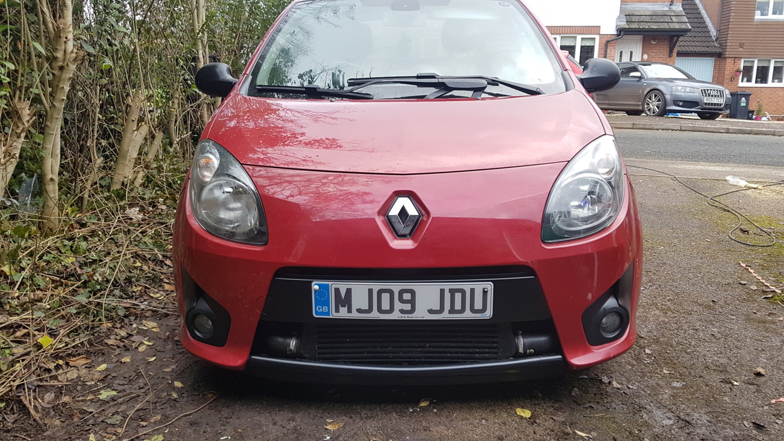

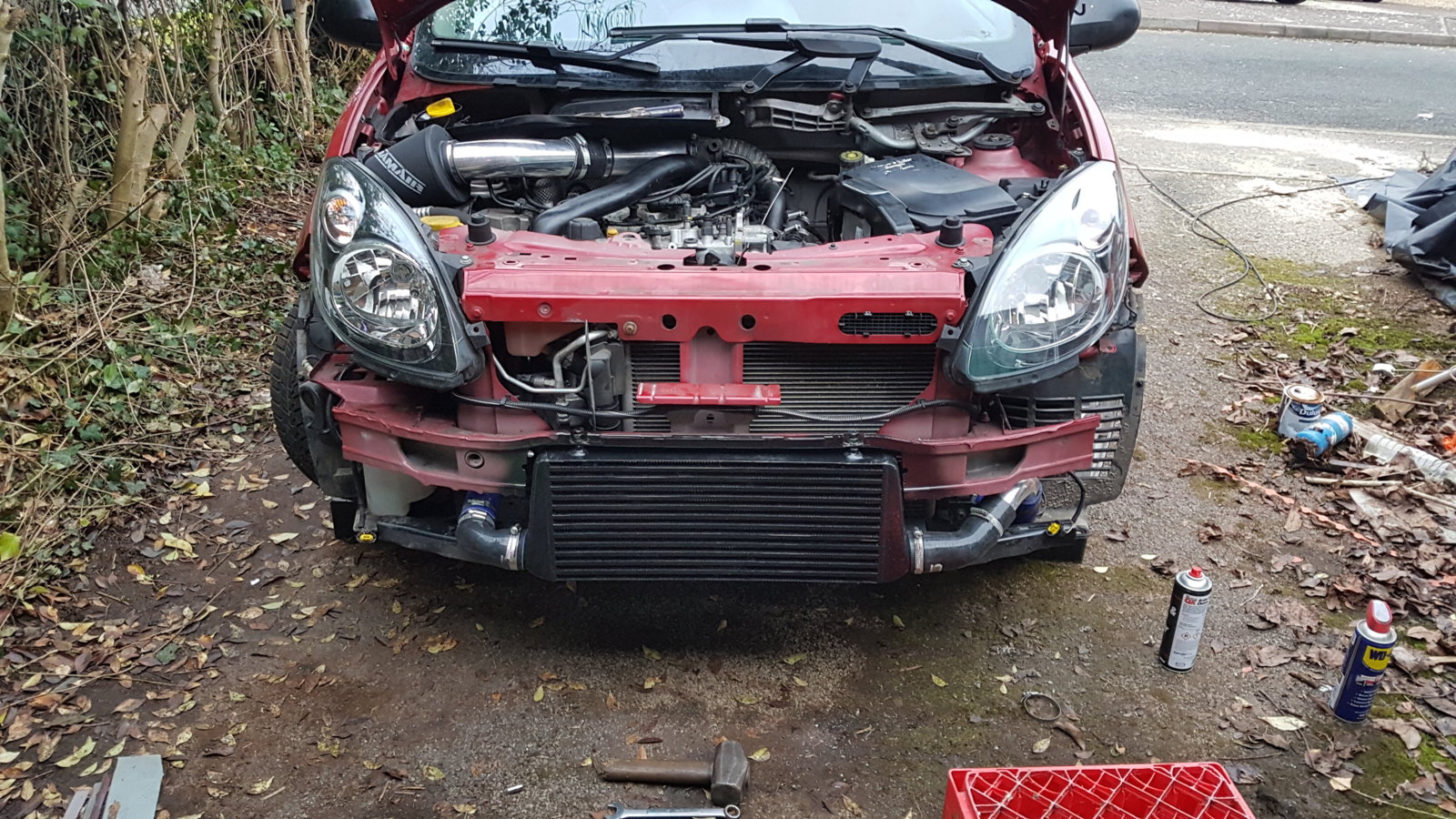

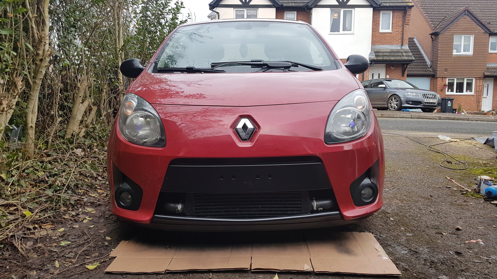

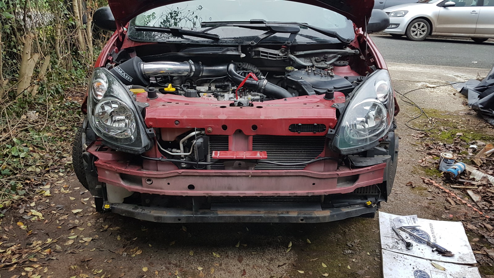

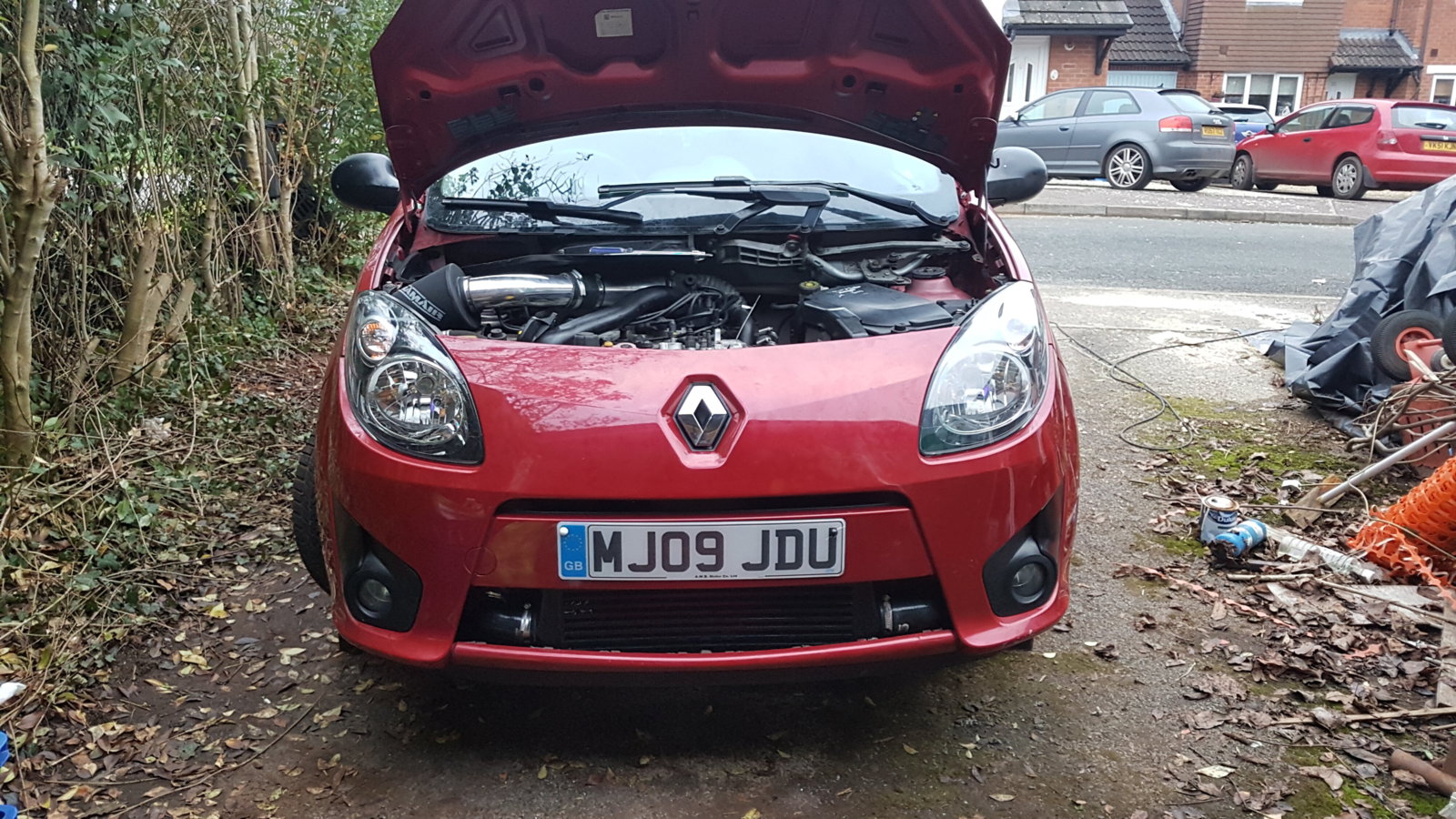

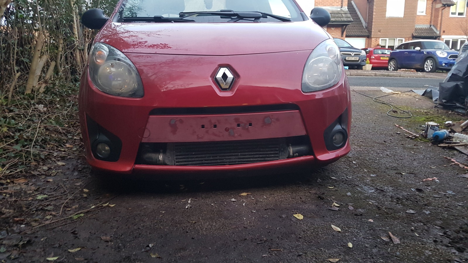

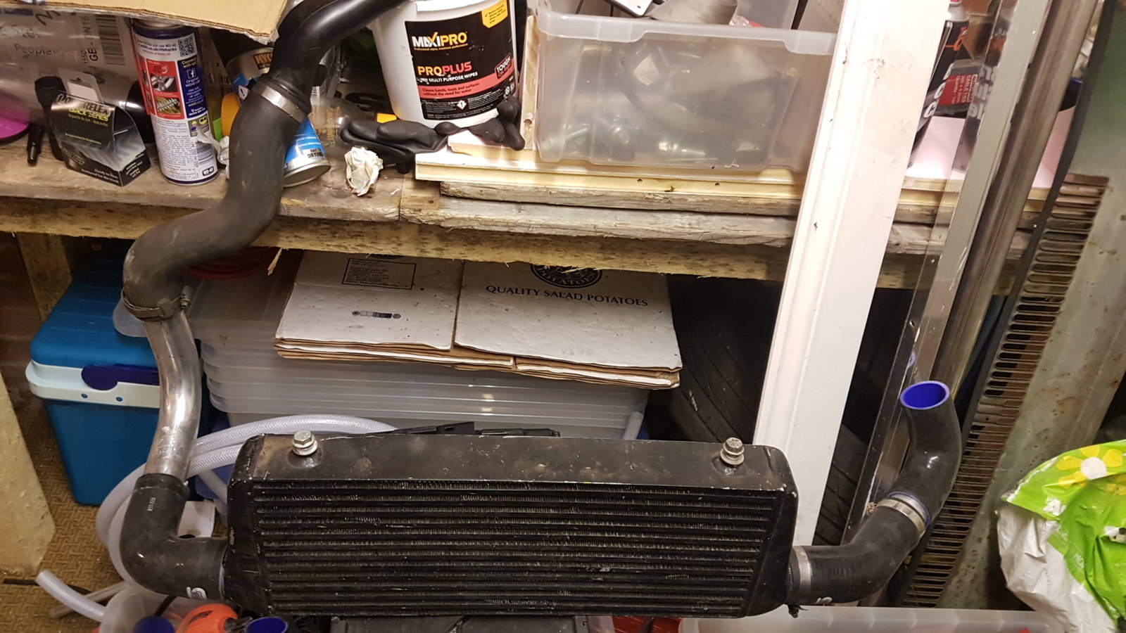

Ive dug out the old mk1 clio turbos intercooler too, needs a tidy up but considering it fits a mk1 and mk2 clio ok it should fit the twiglet with a little angle grinderaction. Fitting that is my christmas job weather permitting.

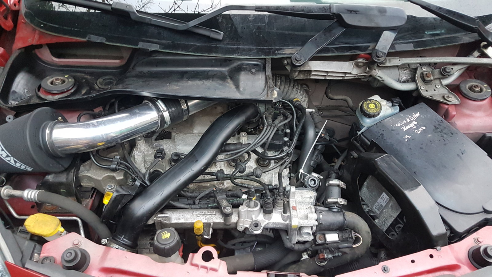

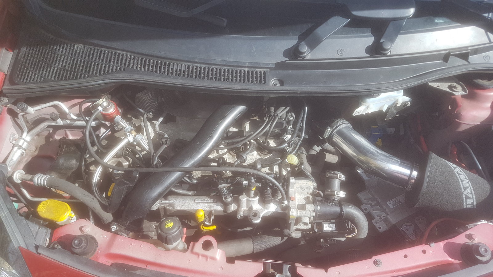

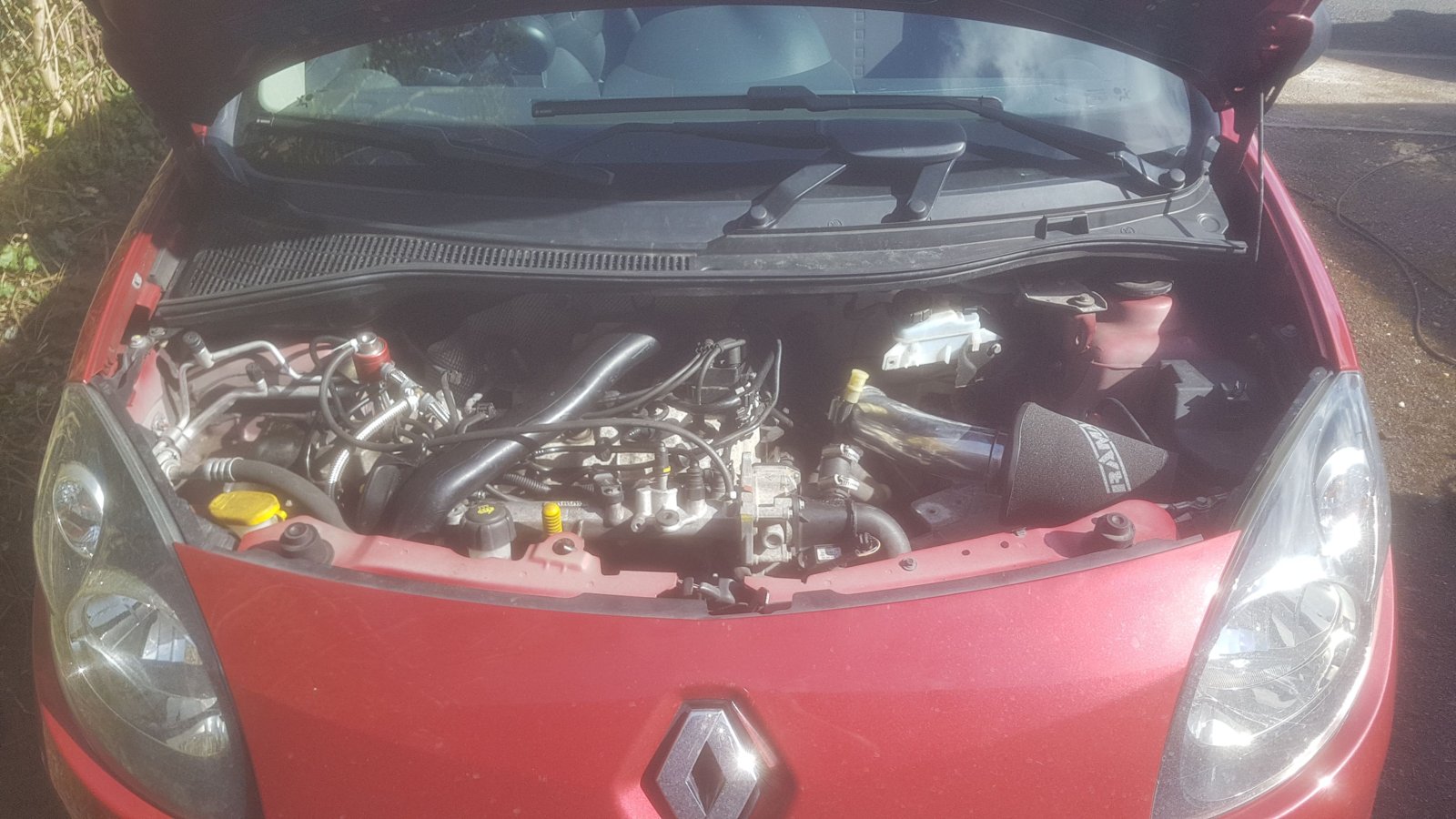

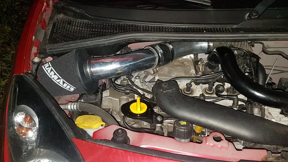

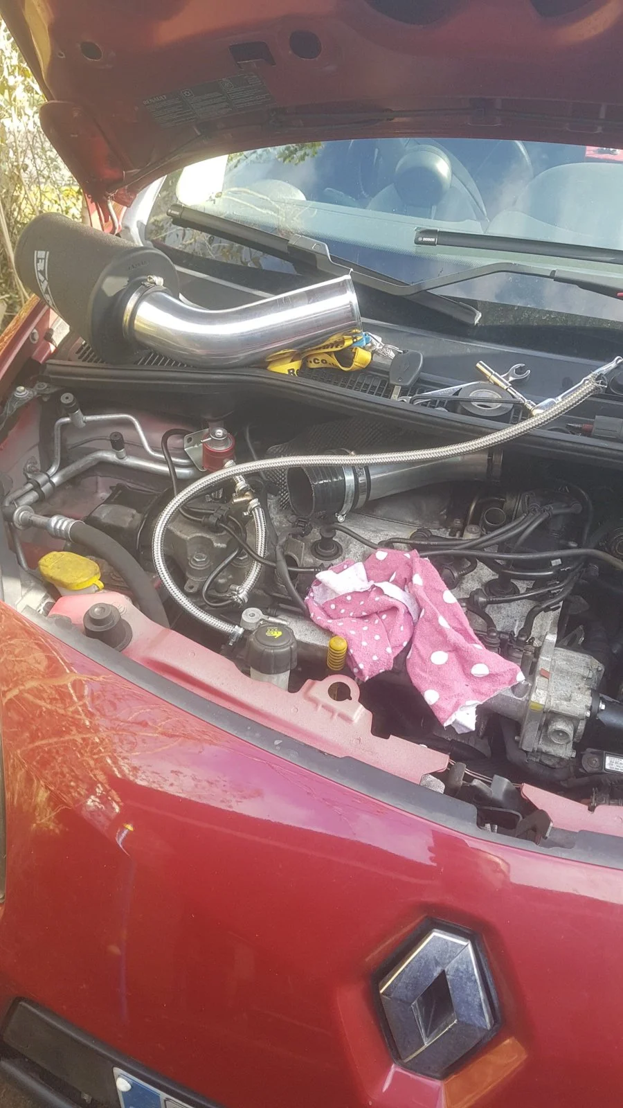

Managed to get 10min to make the new improved induction kit, 2 x 70mm 45 ali pipes, 70mm silicone joiner and 70mm ramair filter. Its tight but alot better than the diy bodge id done earlier. And it sounds awesome with a little rev.

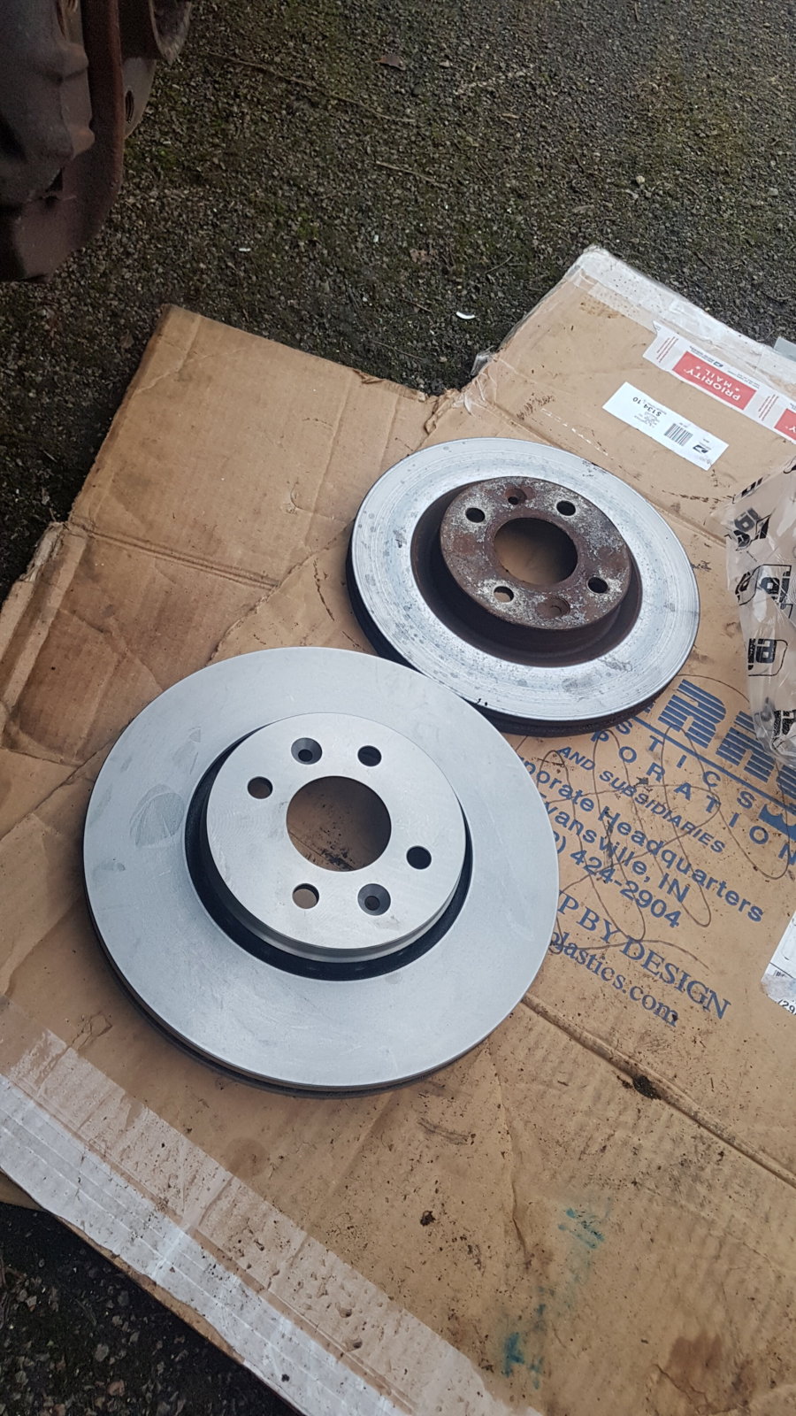

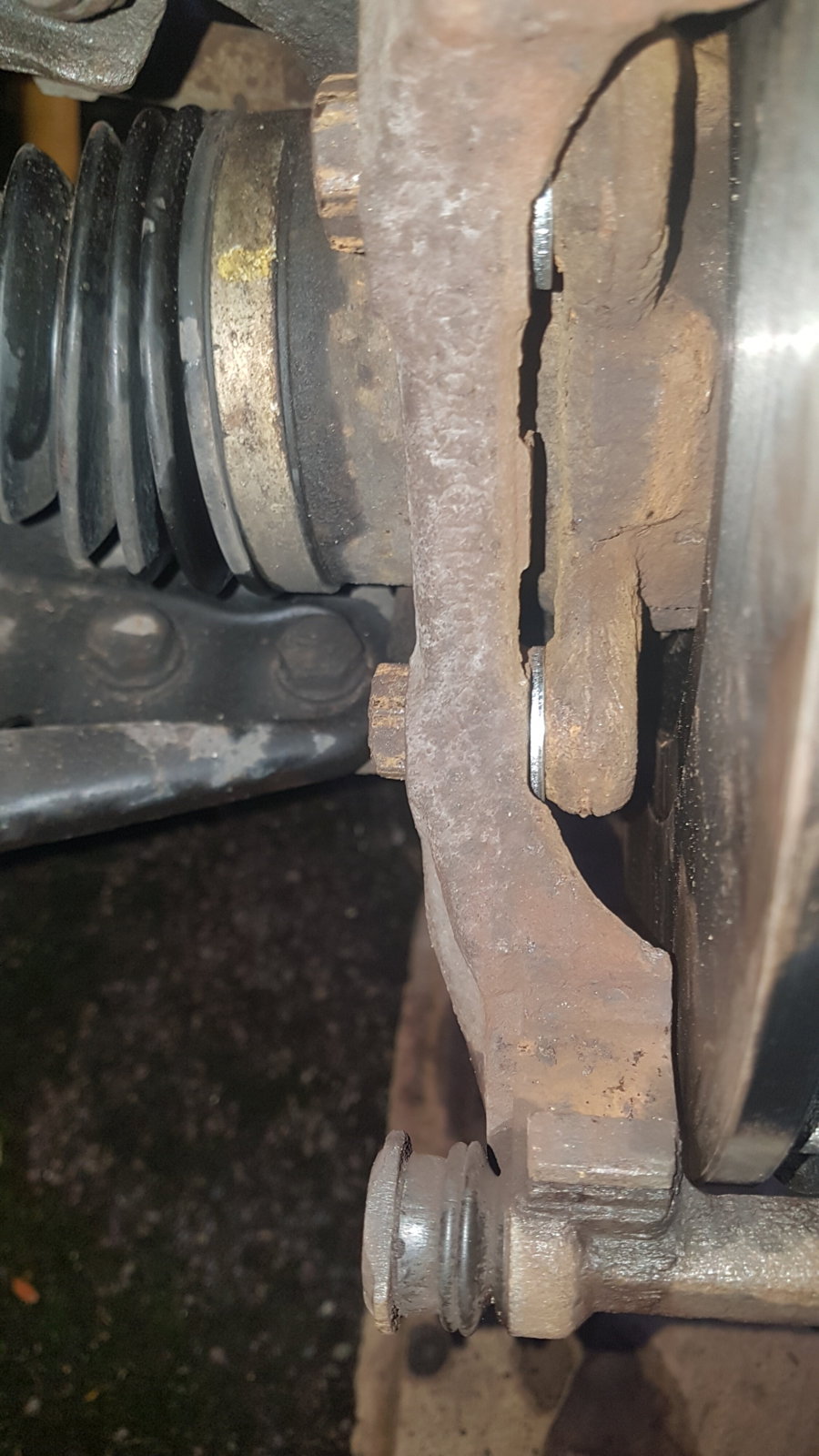

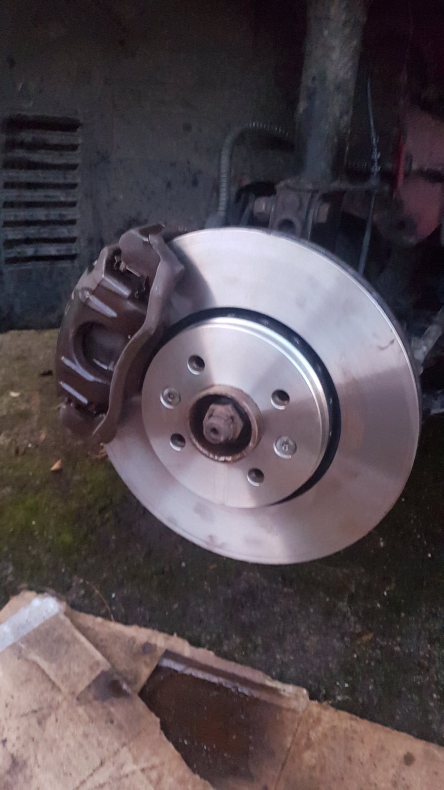

Tidy, 280mm big brake conversion on the Twingo GT, should be identical on the 5 gtt and the valvers and any base version clio or twingo that had the vented 238mm and 259mm brakes. l just need to complete the other side and bleed everything and take it for a test drive. Props to @niconkk as it was his thread i saw about the 16v brake upgrade and knowing Renault like to share from the parts bin the non rs clios and non rs twingos seem to share the valver brake setup, so i took a punt and tried this on mine.
Basically as already read on this site it can be done with a little PMT, some clio sport 280mm disks and the calipers and carriers of a Peugeot 307 2.0ltr (i believe the petrol and diesel use the same ones, i found these in a breakers by measuring the disk they were on which should be 283-286mm) The disk, pad area, piston and calliper are all bigger so should give better stopping power and heat dissipation.
The carriers require a little material removing where they are close to the disk and then i fitted a small washer to centralise the carrier around the disk. After that is sorted it is a properly bolt on affair. The metal removed is so slight you could do it with a decent file, i did it quickly using a rasp in a power drill.
Aaaaannnnnnnd done. Roughed out the pipework then chopped out the crossmember a little..... dusted all edges with some black paint i had lying around to hold off corrosion. I did at one point think id have to ditch the AC as it was tight but think i have that sorted now using a mix of oem and aftermarket pipes. I may have to revisit the intercooler to inlet pipe as i had to sleeve over a pre formed plastic pipe. Ideally the whole part wants replacing but it would require some sort of adapter making to the inlet manifold. The only real issue i have come against is the oil filler, it no longer fits correctly due to the clio turbo outlet pipe being fitted, i will shortly be googling the clio or wind parts to see if they will clear. Pics in no particular order

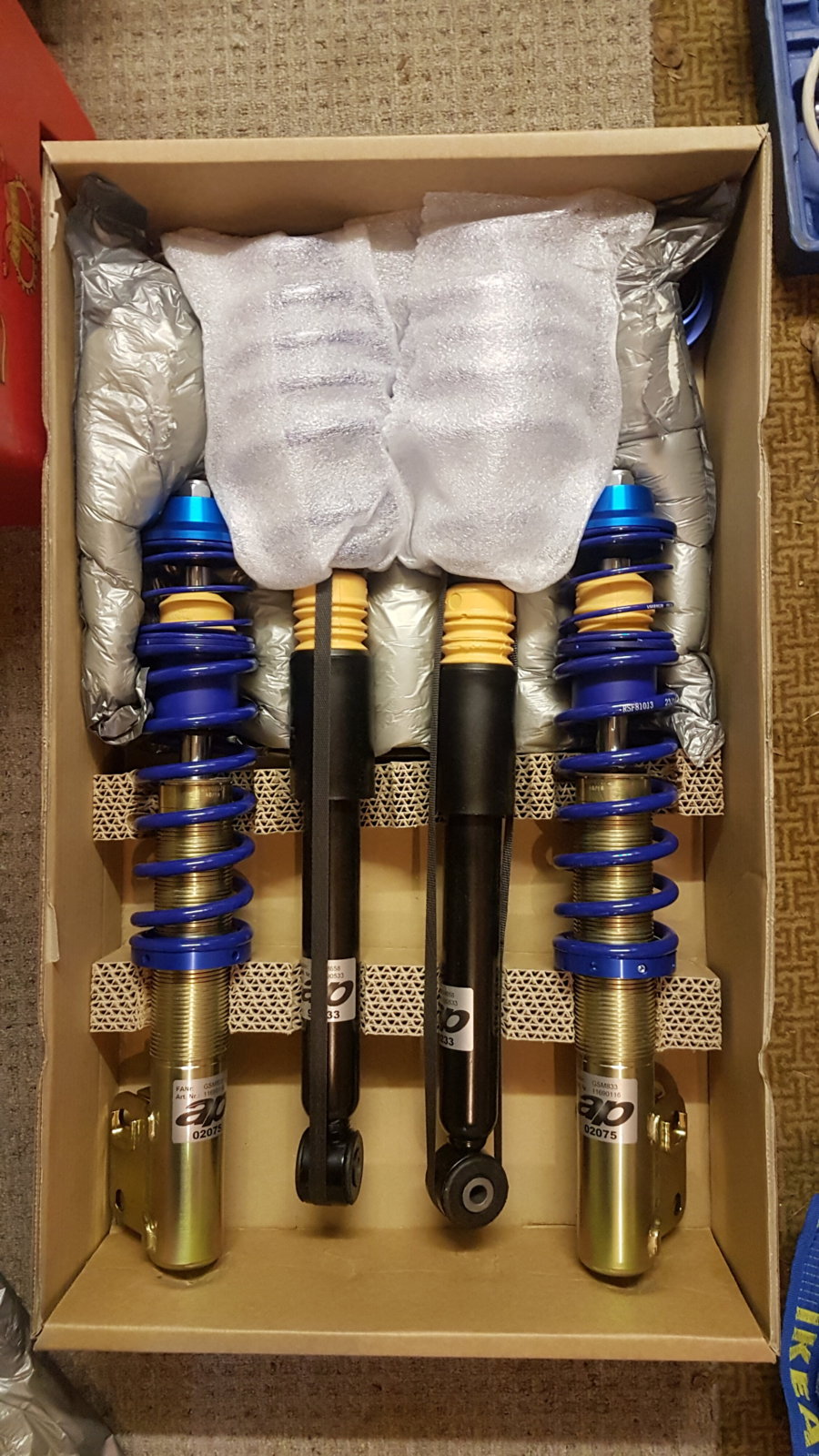

Finally took delivery of the coilovers. i was getting a little worried after the company i ordered through didnt reply with tracking details. Made a start on fitting them but needed to take the old shocks to a local garage to get the top nuts undone. Thus time has been cut short so i will finish up fitting them tomorrow. Im also on the hunt for some cheap gaz rears.

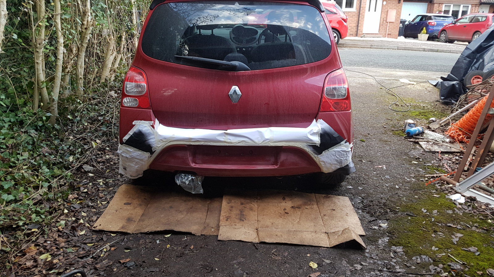

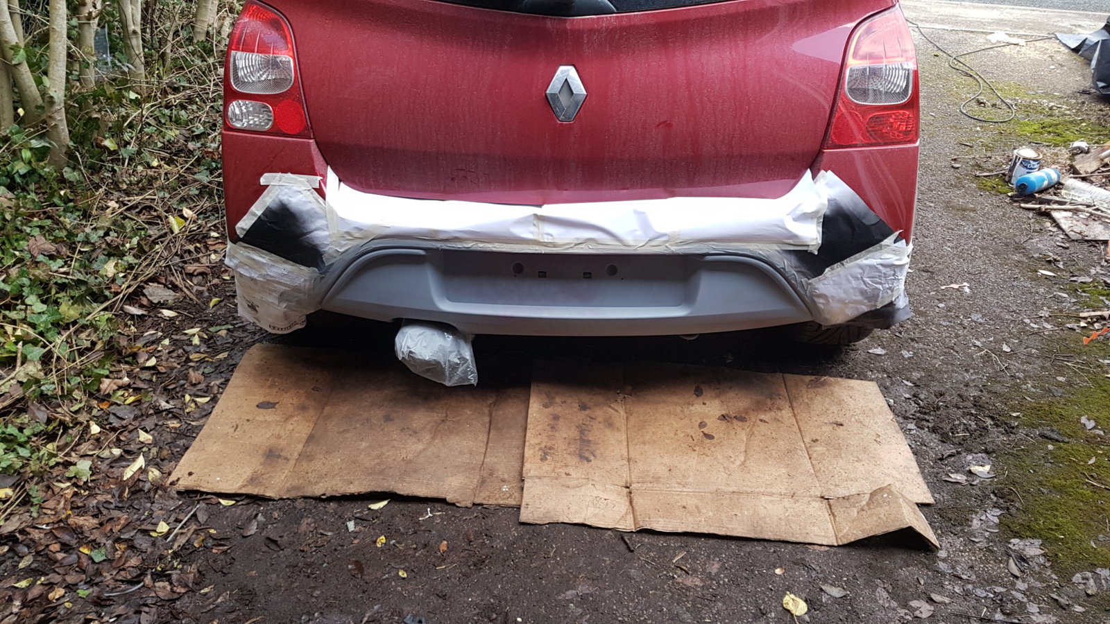

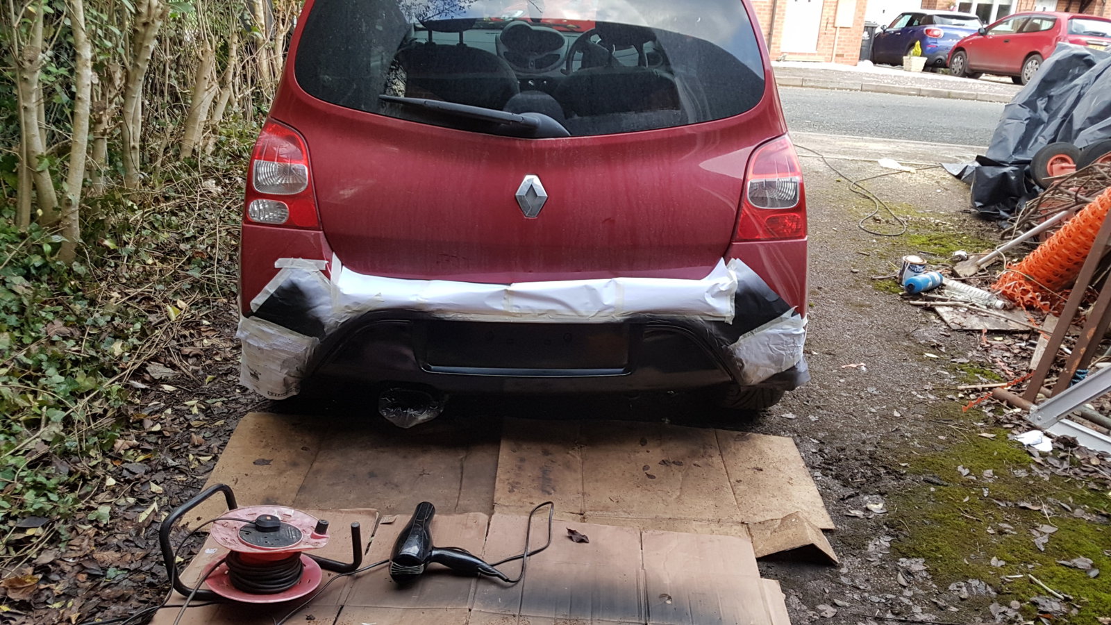

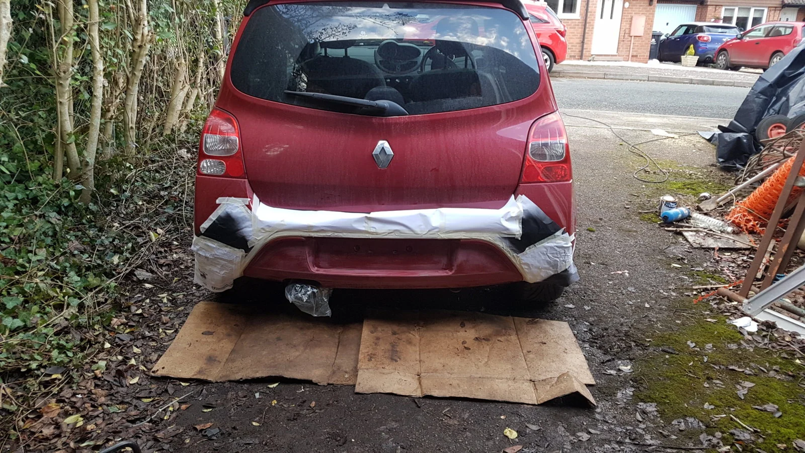

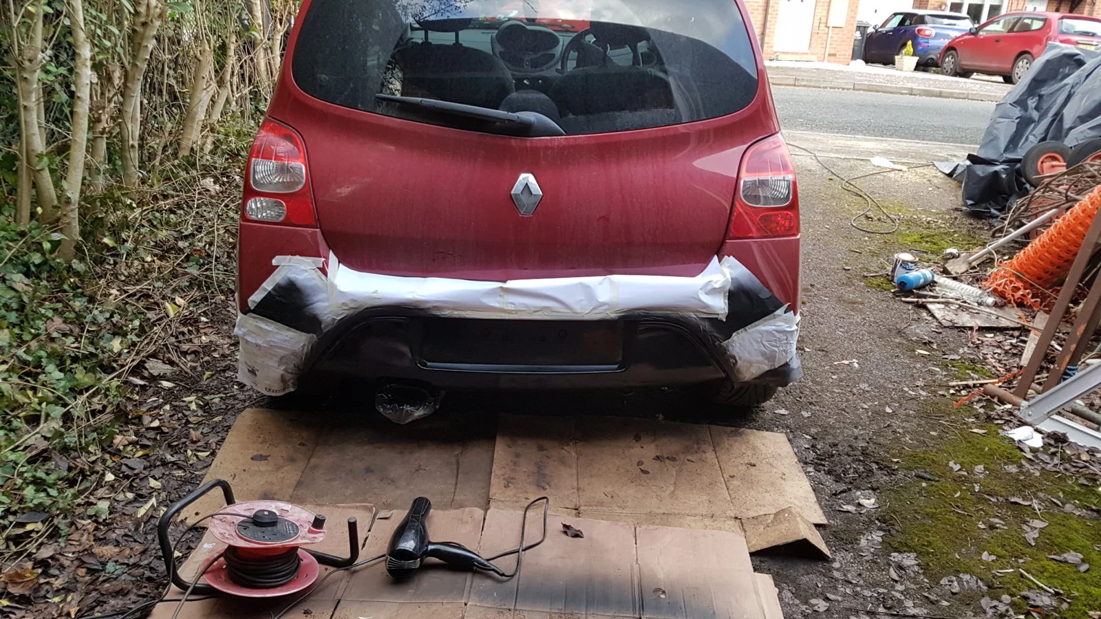

Got a little bored last night, was tempted to try wrapping but as the bumper was a little damaged anyway i hit it with a sander and satin black paint. Didnt turn out too bad i dont think?

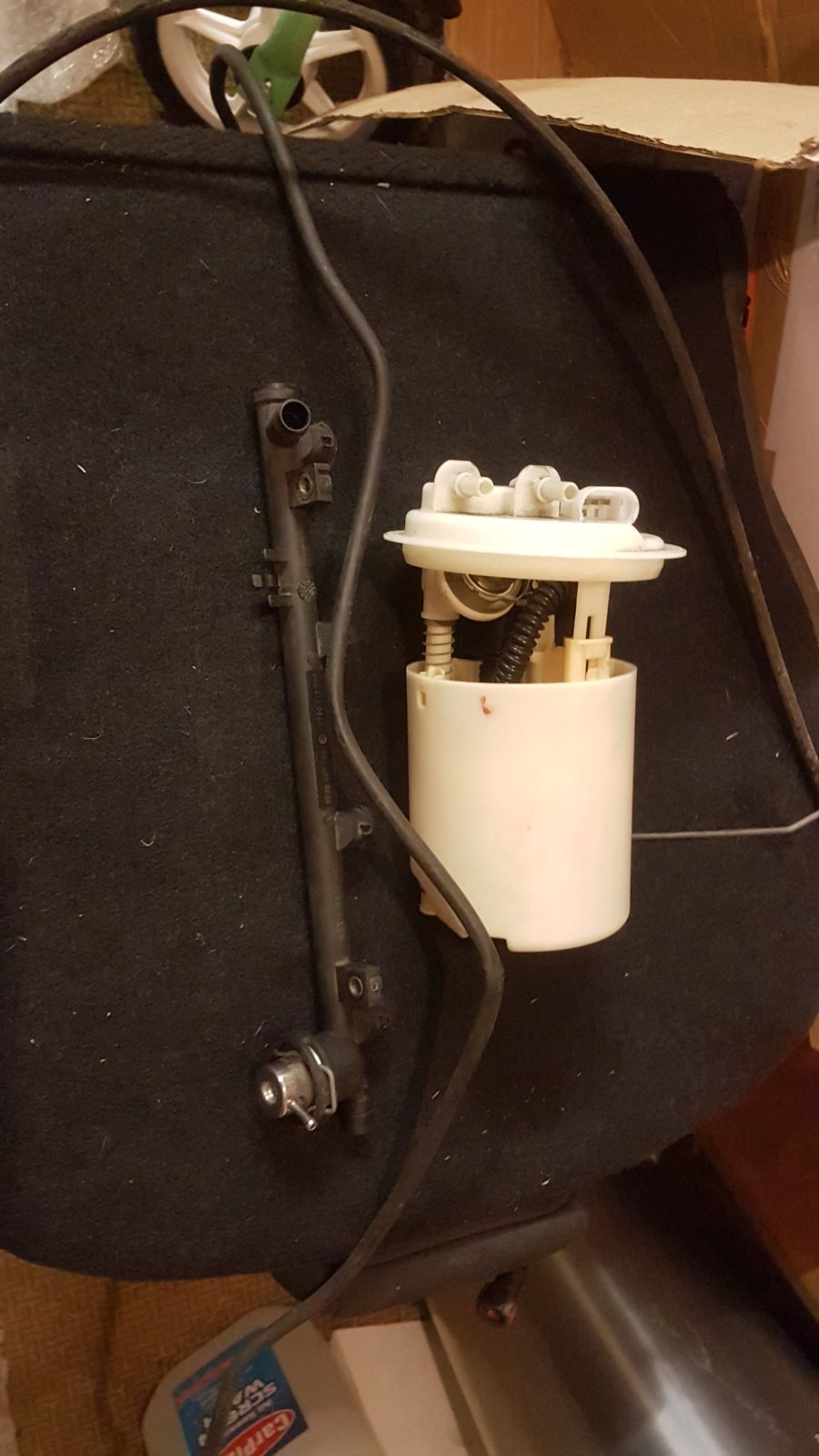

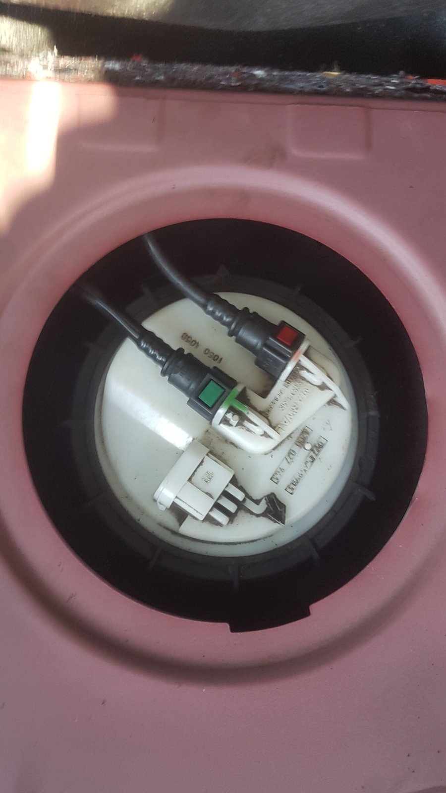

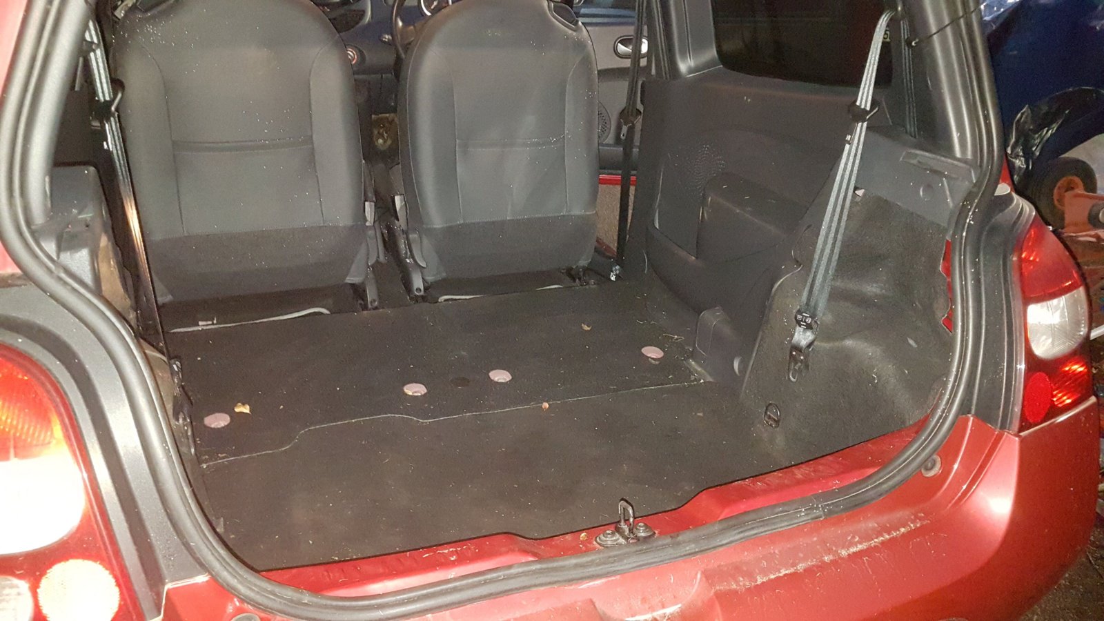

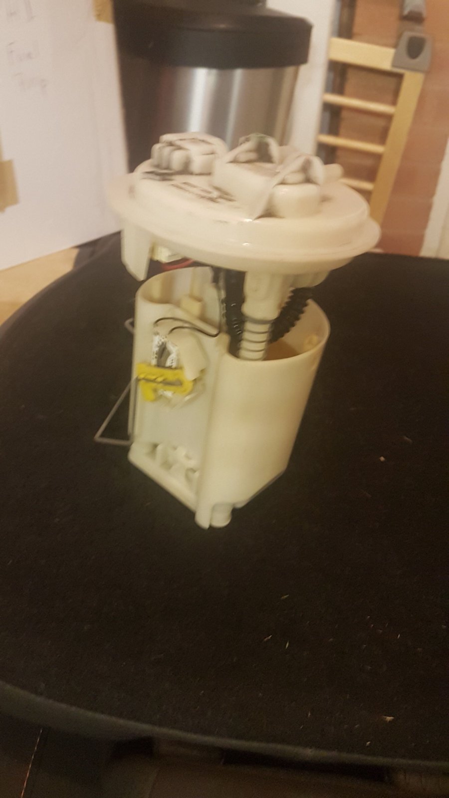

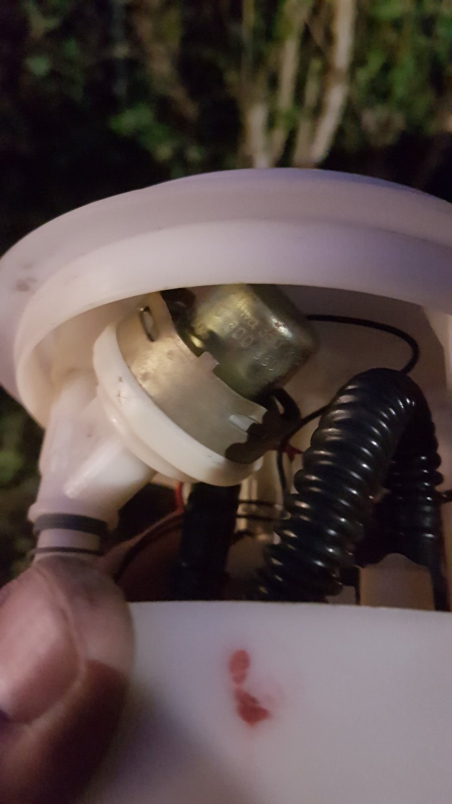

Still no pics of the wheels on the car but i did take a quick look at the fuel pump arangement to look at an upgrade. What i found was the rear seats are held in with 4 bolts and are quick release. Chucked them on the scales at circa 19kgs each so they can stay out for a little while, plus the whole rear is carpeted so isnt too offensive. Ive had them in the down position since owning the car so no loss.

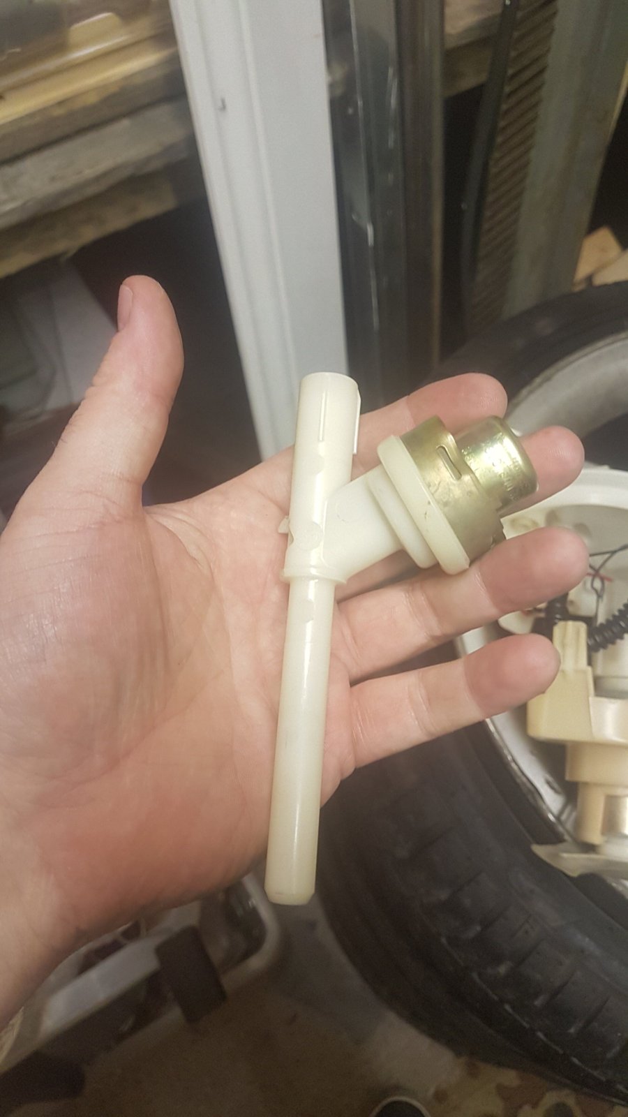

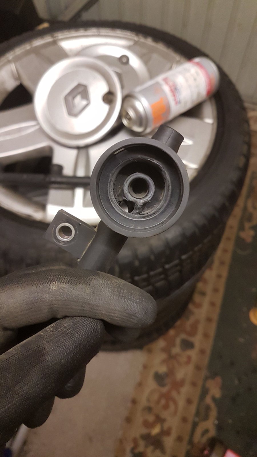

So ive gotten a few bits together for future upgrades on the twingo. what was sold to me as a ph1 pump set up and rail. The pump might be off a late ph1 though as it has some regulator setup in tank but still had a feed and return line. Quick strip down and check to see what was going on then a little fettel with the drill to bypass the regulator, ala a pump setup that will work with the ph1 rail. just need to make sure it fits the tank correctly and i need to score a wiring plug as its different to the twingo. Local scrappy will be visited in the next few days.
not sure why i bother trying to make it easy and buy stuff.
1 x PMT ph1 fuel rail setup. Survives the blow test for sealing so will try it with some fuel this weekend hopefully. Took all of 20min with a soldering iron and sand paper. Not pretty but should do the job nicely.
So the clio rail even though its said is needed on the twingo when fitting bigger injectors, isnt the right offset for the injectors, so wont fit, so i cant use the clio rail anyway. Im trying to gain a rising rate fuel pressure setup to negate the need to run silly big injectors for small gains. In stock form for example the clio 172 injectors on a non rising turbo setup will be flat out at around 135ish bhp, add a rising rate fuel pressure setup and they are good for 180ish bhp. This will give me scope in the future if i go with a bigger turbo.
The clio fuel pump setup i have will be fine for me now but ive added external rising rate FPR to the shopping list, its a jenvey housing and accepts the normal bosch/webber type reg. Ive also ordered up some ss braided fuel line for the connections. Fingers crossed i can have it all fitted in the next week and then get booked in for mapping.

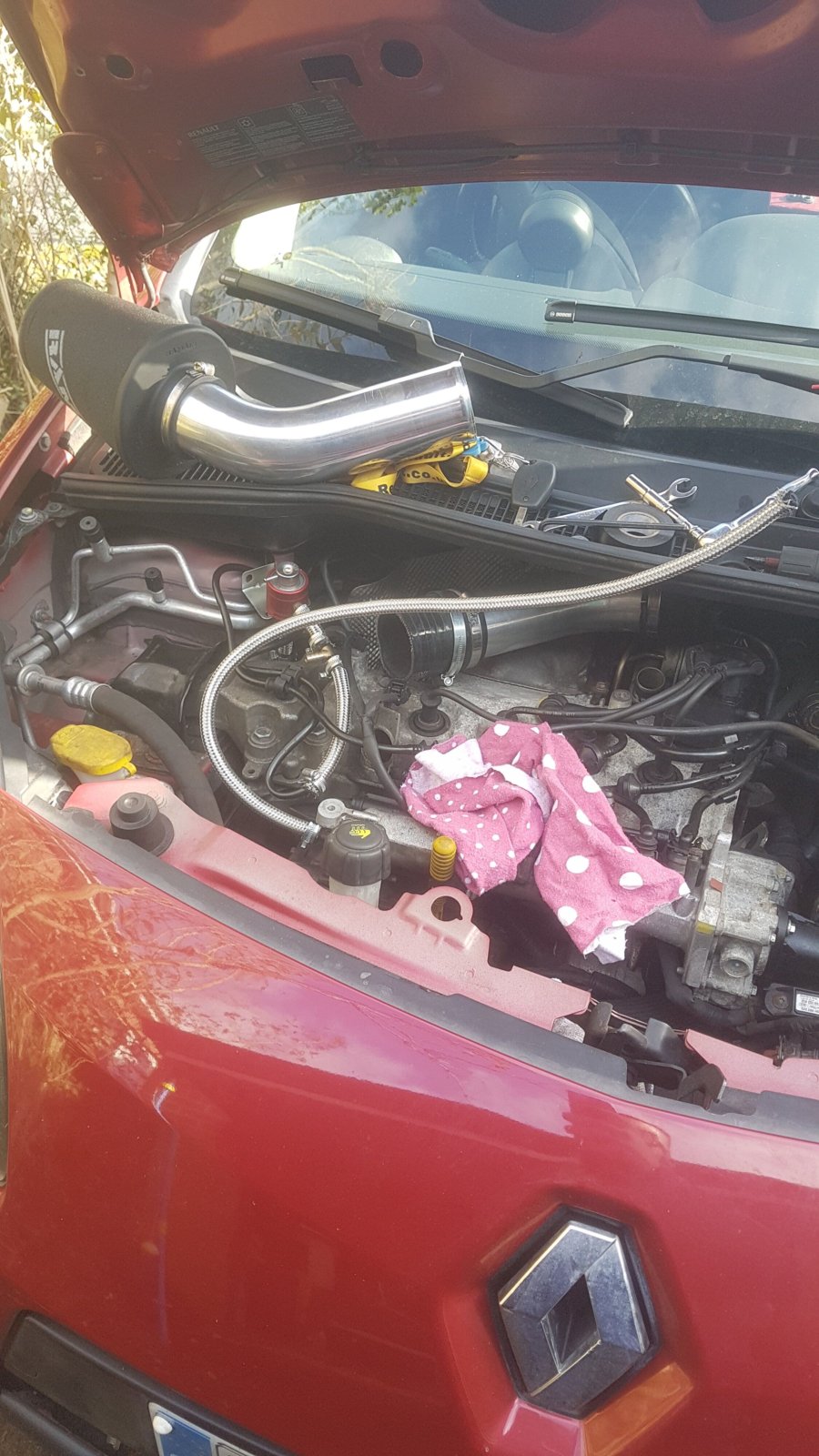

This mornings mission was to upgrade the fuel system to include an external fpr. Renault did good and left all the extra hangers and clips i needed under the car and the fuel pump was a direct fit so all went well. Looks a little pikey in the engine bay but its not leaking thus will do the job. I would like to go all out at somepoint and have the turbo intake and boost hoses all made up nicely in aluminium. Jenvey external fpr, some braided hose and a T peice to join it together. The reg has been fitted pre rail rather than post but still does the same job of keeping the pressure constant and will increase it when the reg is plumbed to a vac line. Ill put some miles on it to check for leaks but so far so good.

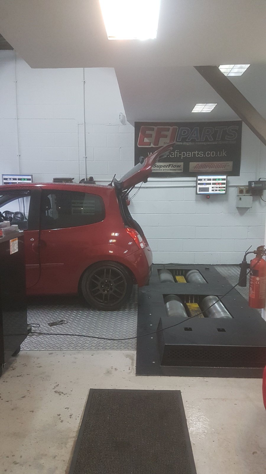

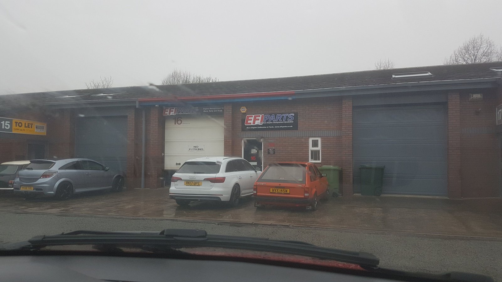

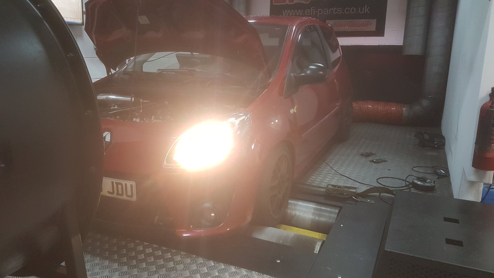

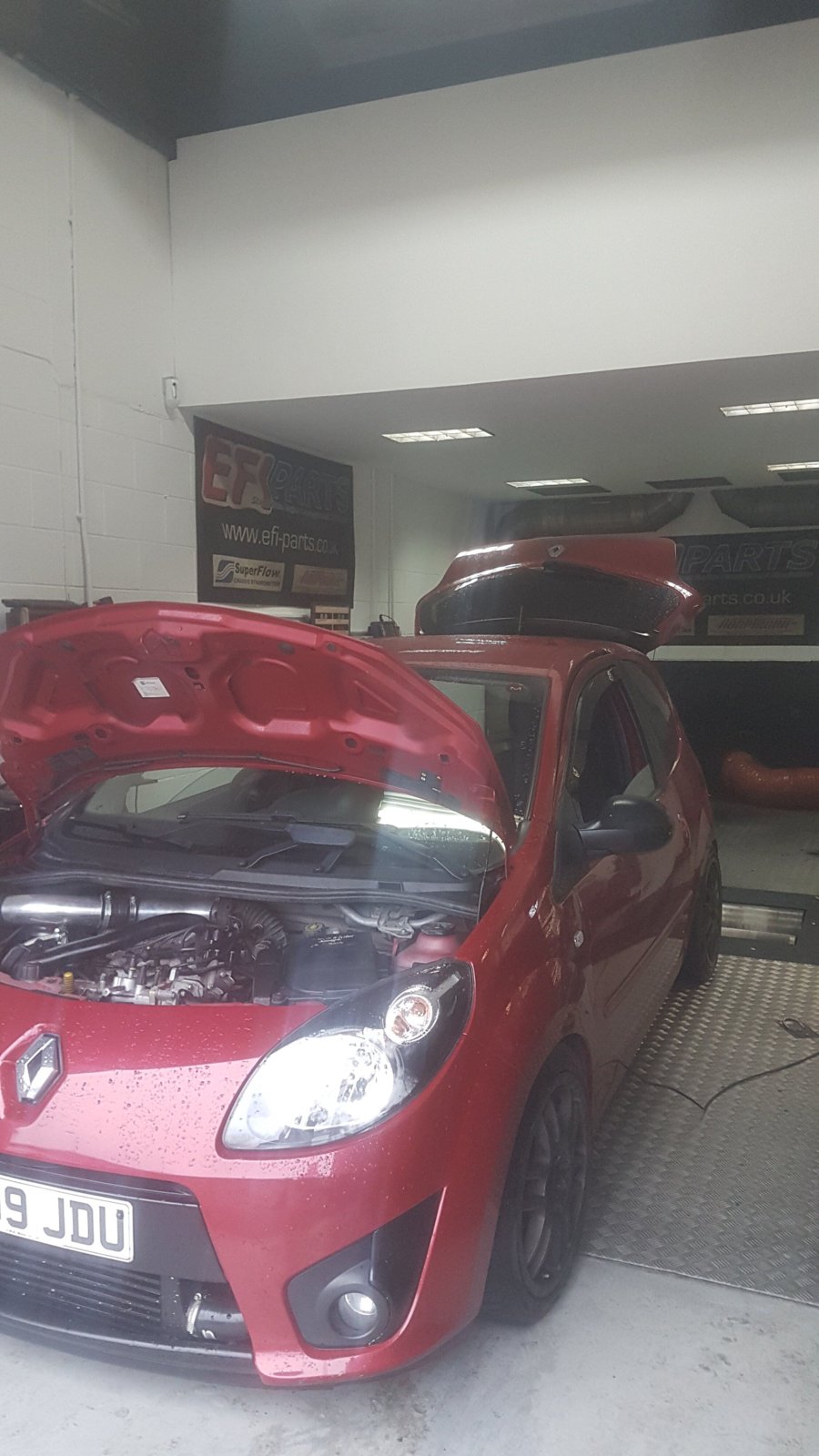

So I left the house at 10 am yest, giving me time for fuelling up, toilet stops and traffic. I was booked in for a 3pm start at EFI parts. A quick jet wash and fuel up before leaving town saw me hit the road in reality about 10.45 for a nice steady drive up north on light cruise. Sun was shining and all was good. And then I got close to brum, the traffic was shocking and the weather grim. Any way I arrived at EFI parts just after 2 after stopping into burger king (free 5bhp extra if you get chris some fries from there lol)

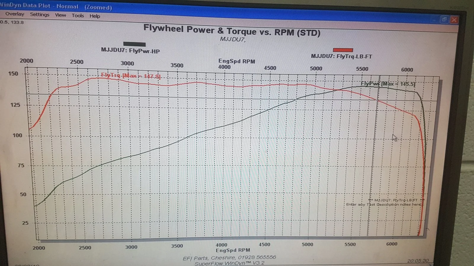

Once at the workshop we had a little chat about the old days, new stuff and expectations of the car. Bit of an odd one as the car really isn't tuned much anywhere so this was a little bit of research and development too. Chris plugged the laptop in and started doing his magic whilst I set about fitting the 172 injectors. After a little while a base map was written and loaded up onto the car and it fired into life. The ecu on these take about 6min for each flash so every time a change was made to the file there was a bit of a wait.
lots of pulls on the dyno logging and checking were performed. We at one point saw 170+ lbft at 20psi at around 2500 rpm..........abit high considering we didn't know what the engine could take lol we settled on 15/16psi max of boost and the nice flat torque curve we have, I cant thank Chris enough, the car is a little riot to drive now and is literally like driving a new car rather than the old diesel style car it was. I set off home at about 8pm and landed safely at 11ish. long old day bit worth it. Revs really nice all the way round and makes some really nice noises :D clutch wont last im sure......... The drive is more akin to 172 now strangely but a modded one with out the flat spot or kick. But whilst doing so sounds like a megane on the exhaust. Hopefully at the dyno shoot out tomorrow i cam go for a little play with some clios and see how she fares.
Bigger turbo and clutch are next on the list i think will be interesting to see how it handles it, good going for sure and yeah similar power as a r5 gt with less capacity but 8 more valves. I can guarantee this has smaller thinner rods though so torque will break something at some point :D
So power wise its had a 47.9% increase in Horsepower and 38% increase in torque. Its enough in a light car to shock a few cars on the road. Especially the bright yellow 8L S3 i jumped on the way home from work. He pulled about 2 lengths on me till about 100mph then took off but after a few pulls i think he was surprised. Would be even more so if he knew it was a 1.1ltr lol
Good day down at the dyno shootout today, the dyno showed it having more hp than at efi but the same torque. ill trust efi's rollers i think. It surprised them down there when i told them it was a little 1.1 turbo engine that came factory turbo charged rather than something i built. Had a little play with a 182 afterwards too and tbh there next to nowt in it! It would probably spank me above 100 but up till then its all good fun

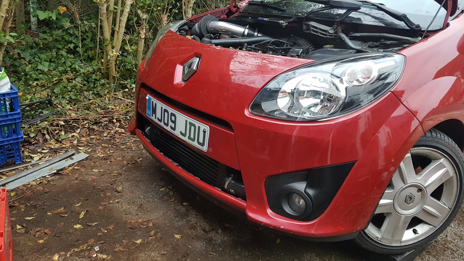

Its quiet at work today, so i am at home tinkering on the twingo. The silicone elbow is here to thrown that on to make use of the space where the filter was and declutter the bay a little. My camera and phone are battered so pics arent to good. Straighter run to the tiny tiny turbo now rather than a full 180degree turn. Need to sort a catch tank/bottle next.

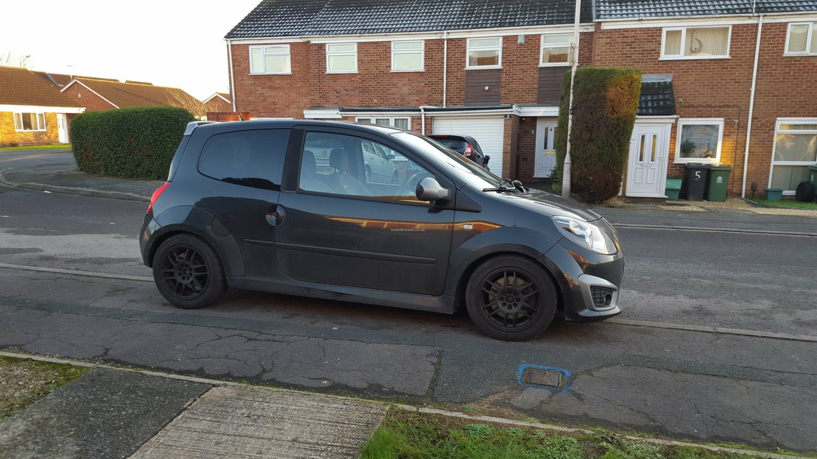

Ill do a quick jump to the end, but basically switched out to 15 inch oz f1s from the 16s. Dialled in 1.6 deg of camber and 6/7min toe out, chucked some cheapo toyo tr1s on front, flushed the brake fluid and came along to the cliosport festival where it was a blast. The drive alone was about 300miles and it did the whole day on track, only used 1.5 tanks of fuel, ive literally filled up again this morning.
