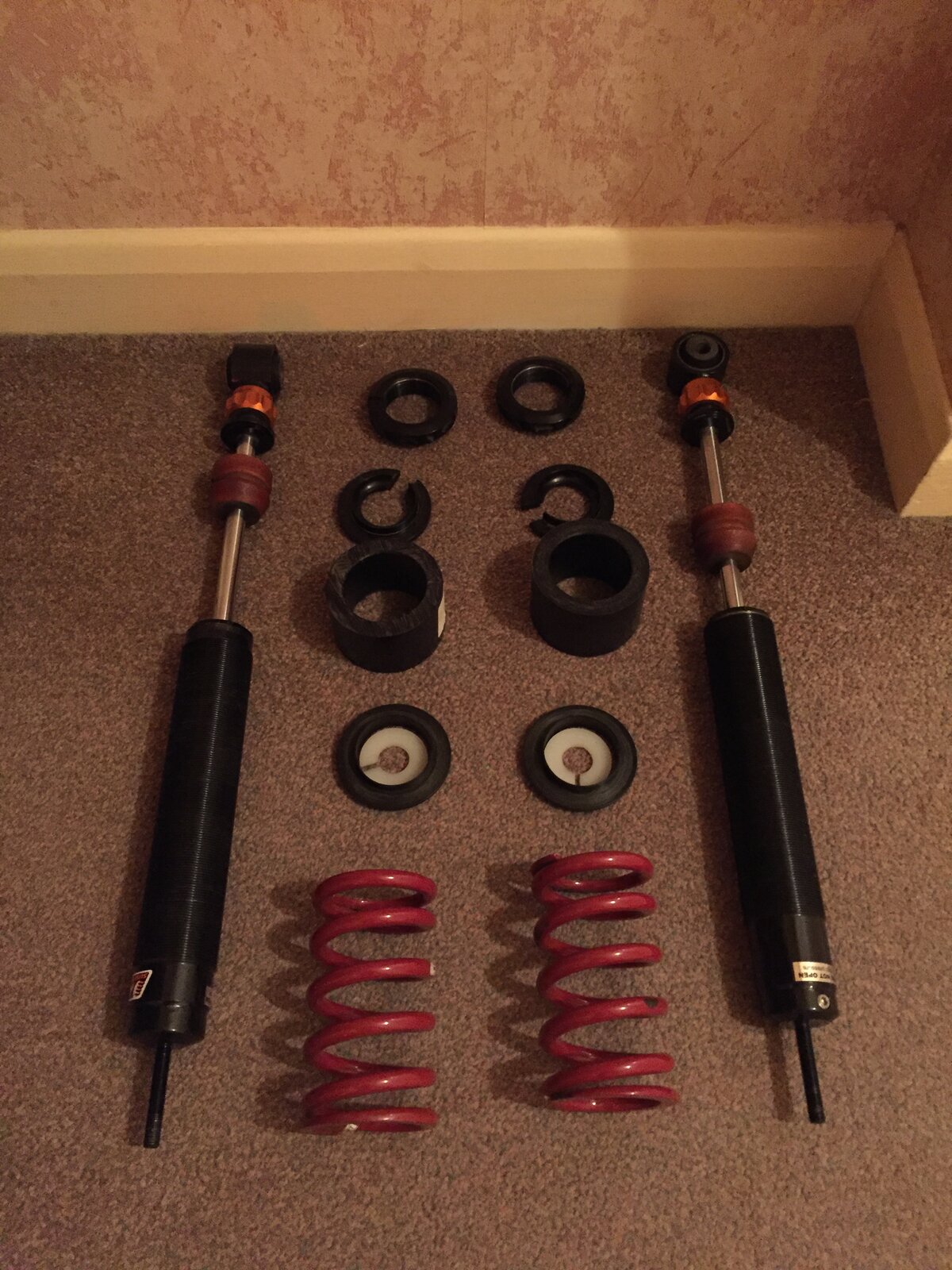

Just got hold of a set of these but can't fathom how the height adjustment works. I get you move the collars up or down the strut, but in doing this it adds or reduces pre-load to the springs. Now if I move the collars down to much the springs aren't under load and are loose on the strut and if you move it up to much then the springs compress adding unwanted pre load.
Or am I missing something? Not fitted them yet but as is the springs aren't under load and move about on the strut... See below.
Collars have a Allen key to keep them pinched and not moving.
As for the play, that's because the helper spring is to keep the the spring from becoming displaced at full droop - like it's simulating now.

So when fitted and under the weight of the car the strut will compress, therefore compressing the spring?
Yes mate that's it. The helper spring is designed to run fully compressed as they're only needed when you're at full droop. Very unlikely thing to happen unless you're raising the car up off the ground.

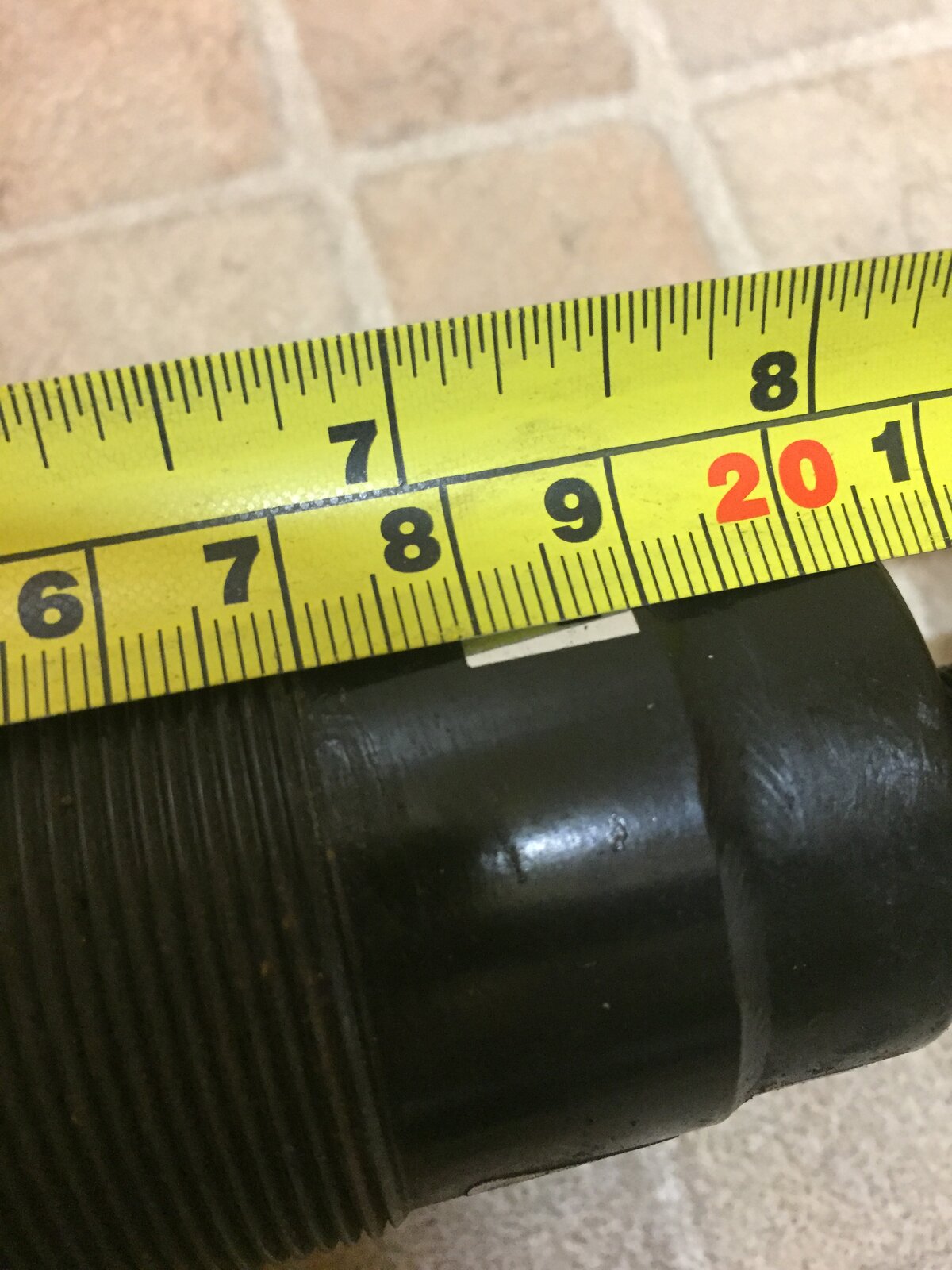

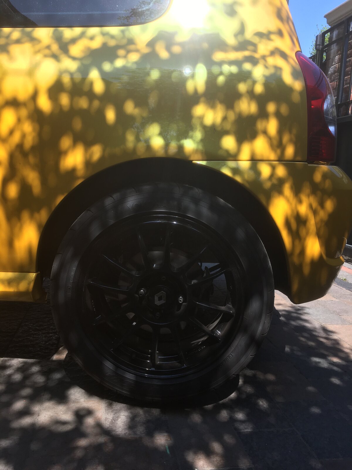

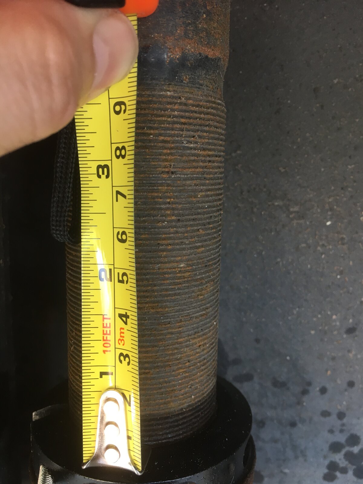

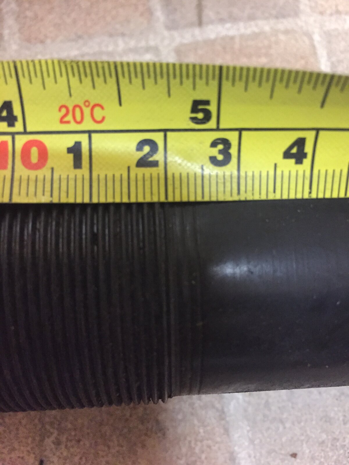

Thanks chaps for the quick replies. I suspect that I am already at the max ride height and that any more adjustment of the collar is simply compressing the helper spring not extending the strut length any further. Here's a photo at full droop - does this look about right for max rear height on the 4100s?
This photo shows 94 cm between the collar and the top of the threads.
The pic is shadowy so difficult to see, but the wheels are off the ground i.e. this is full droop with no weight on the suspension. When on the wheels the edge of the tyre is more or less in line with the arch. I'd like more ride height as this is primarily a road car and I hit the bump stops when taking dips at speed.
On my ASTs for a near 50% cross weight the measurements from the bottom of the thread to the bottom of the collar are as follows
Front: 52mm each side
Rears 119mm left, 169mm right

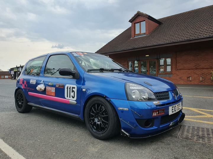

If it helps you at all.. My car is set at 30cm from wheel centre to wheel arch all round whilst its on the floor.. Running AST5100..
