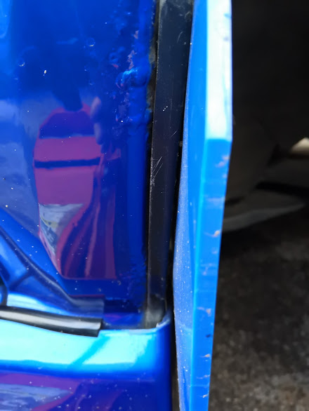

Mud flaps next, I hate them. They're not even the same colour.
I thought the idea was to deflect the mud... they've just concealed it and its rusting behind the fixings to the arch. Now they need attention.
There's just a big pile of crap inside the bottom of the arch and kit, just daft.

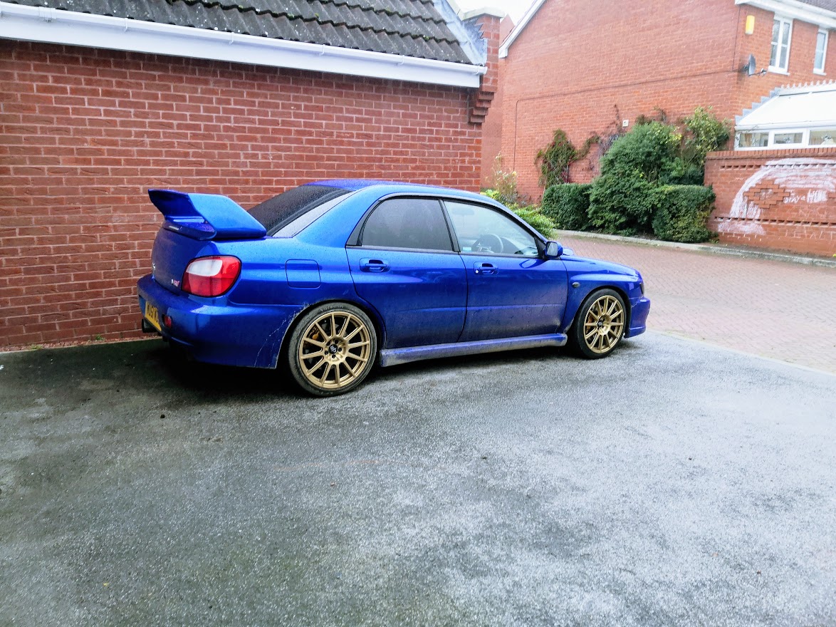

I'm making any excuse to drive it. I even went to @leeds_182 I was that desperate.
Probs should think about where I live + the time of year though.

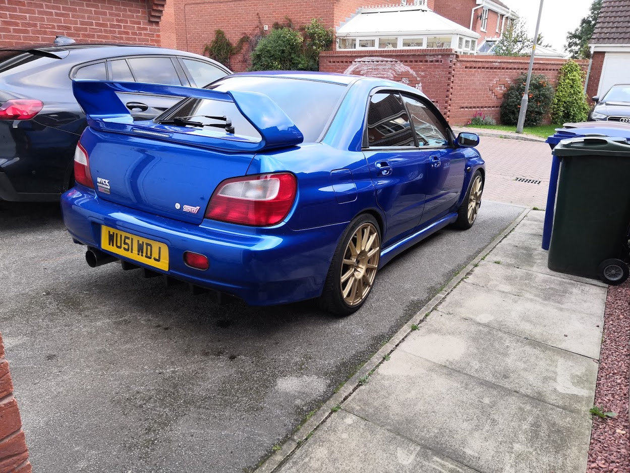

Given up on the spacer idea. I think it looks good enough now, without the flaps.
Got a new window switch coming and that's about it. Prob sell it.

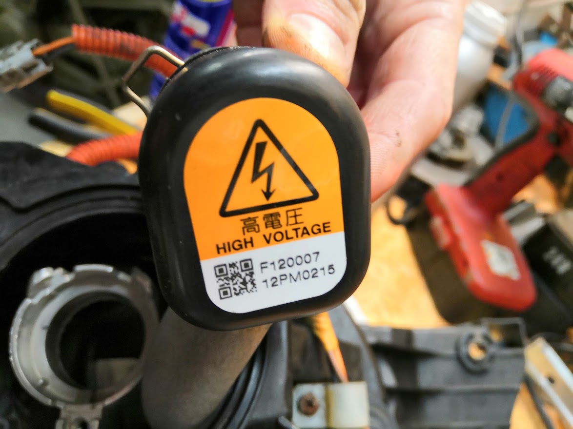

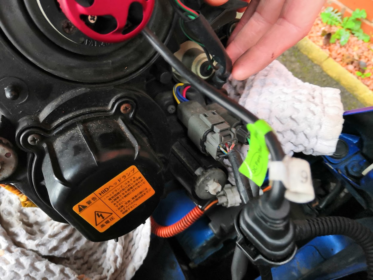

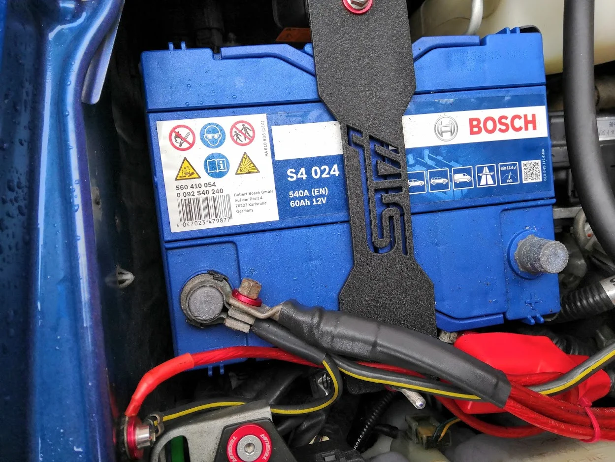

The battery died, so did a headlight bulb.
£65 Lucas battery - didn't think that was bad.
To replace this bosh one - look at the STI battery holder, never noticed that. How sweet.

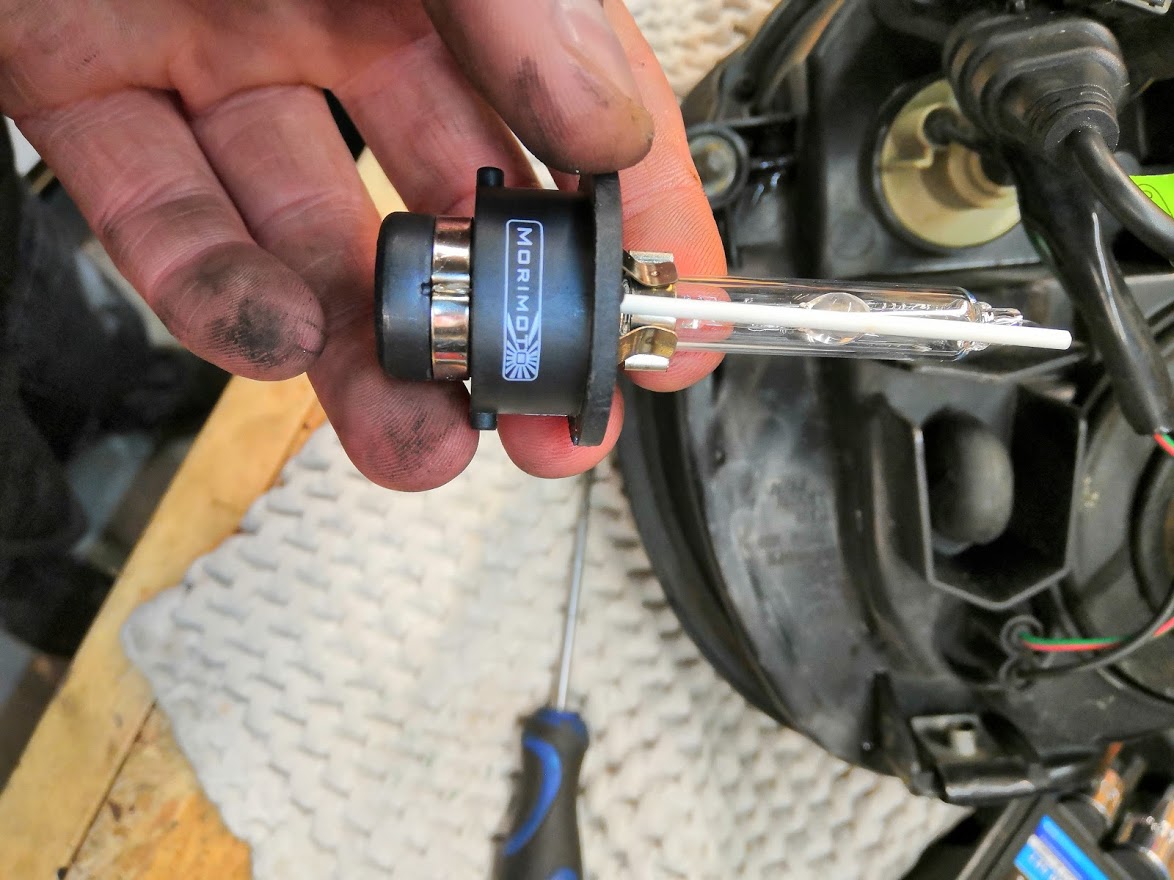

Took the headlight unit out, to see what it all was - didn't look like your normal bulb setup.

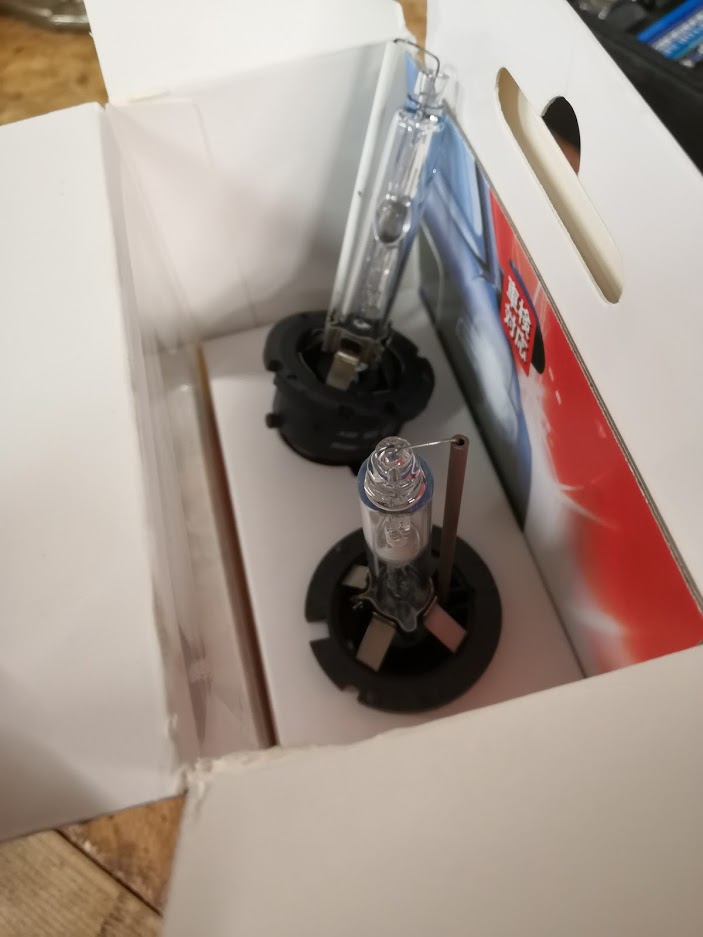

Never seen these types of bulbs before, presume this is what HID's are. Googled the part code for them and they were silly money from the USA.
Not sure if anyone knows if the JDM bugeyes came with HID's? Everything is in Japanese, just looks like someone has retrofitted modern lamps from Morimoto.
I found some alternatives for £25, but they have a different coloured erm... like stalk bit..... that runs alongside the bulb. What is that? The old ones were white but the new ones are brown.
They work ok, maybe the hue or something from the lights is going to be different in the dark? not tested them in full darkness.

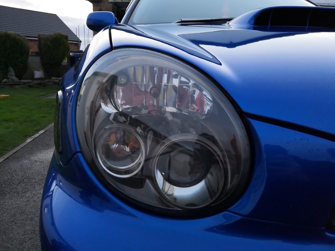

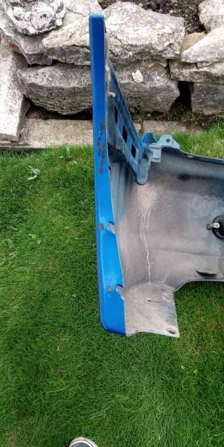

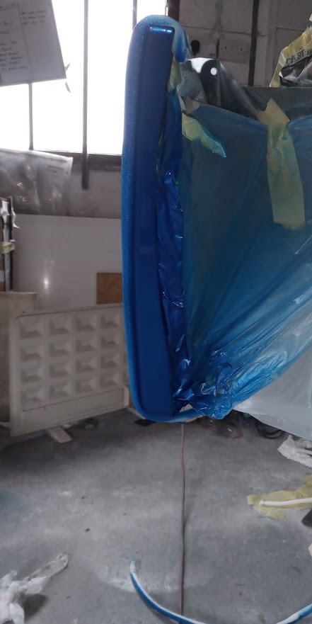

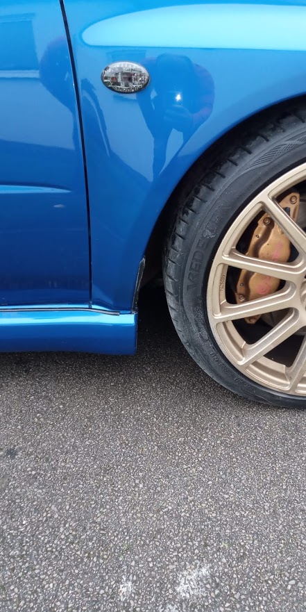

A few weeks ago I had any paint issues remedied. The section where the mud flaps were, holes in the rear bumper plastic welded and painted.

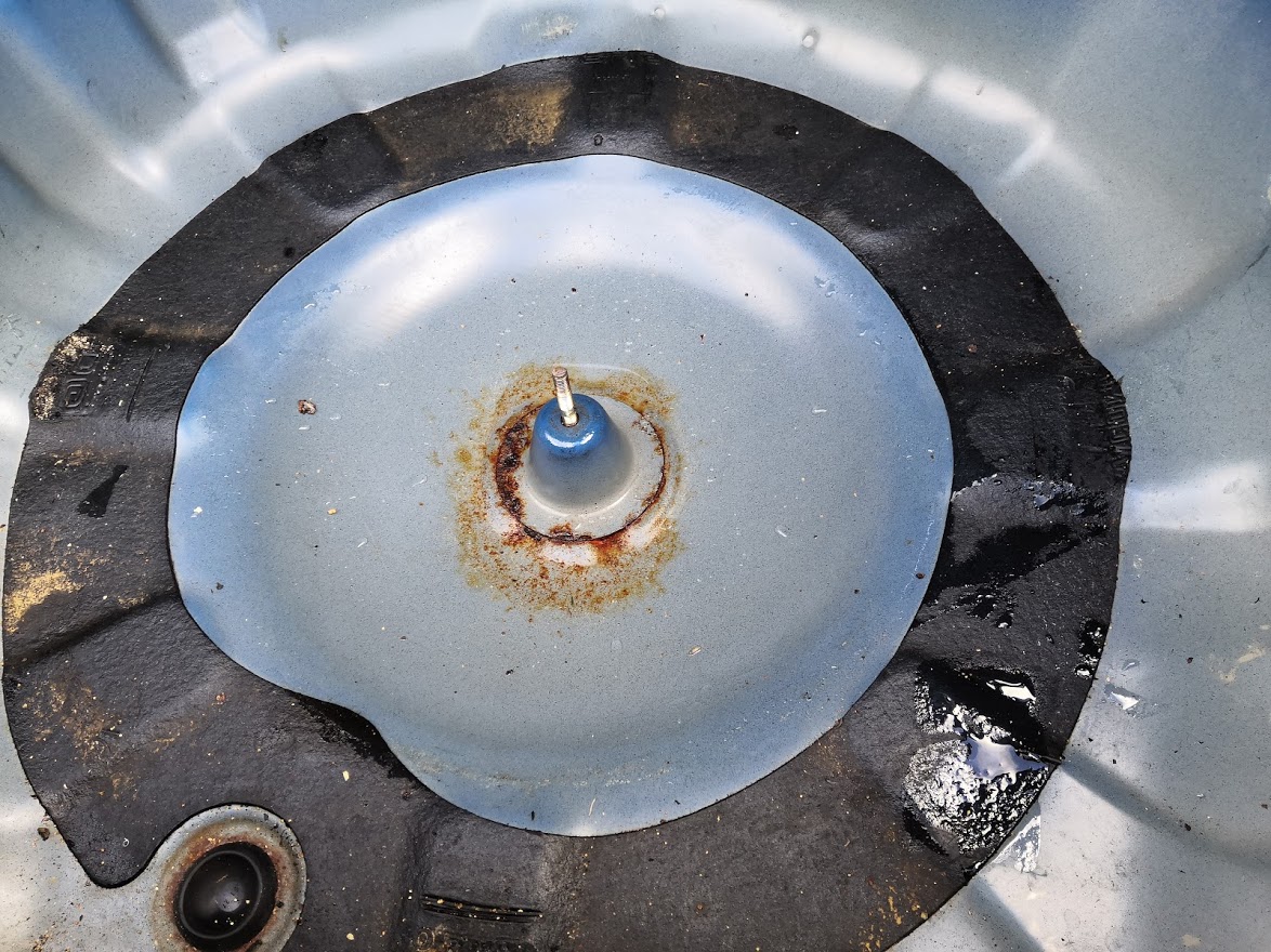

Also noticed the boot floor was holding water - which means there is a leak into the boot I must find. The painter said, not to fully paint the boot in blue, as it was originally just like a primer. the car will look like it's had a rear end repair, which it hasn't - so he replicated the primer look. Looks OEM now.
Asked him to use the rotary on the headlights (pre-bulb issue). They've come up like new.
Along with resolving the trapped rubbish from the mud flaps that had made the paint start to blister.

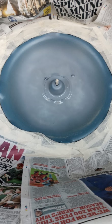

before
After.
Had each arch done, just to be safe.

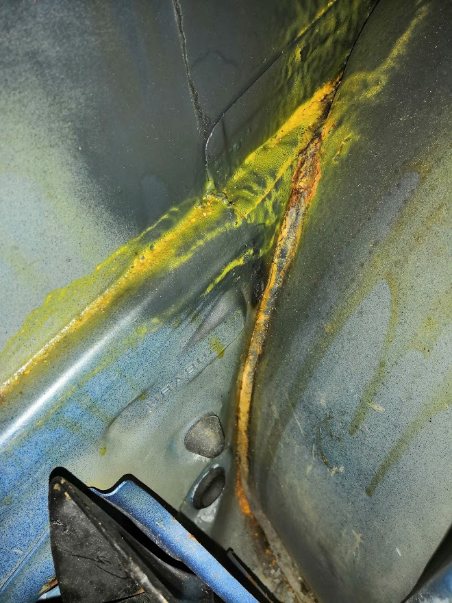

If anyone has any ideas on what product to use, to spray/coat the inner wings from the inside, let me know. I've seen these rot from the inside out.
There is what looks like, cavity wax all around the seams - it looks like rust on the camera (there is a bit as well). Cleaned it all up, goo and all - but want to spray some either convertor or wax oil or something in there.
Speedo Gonzales
That looks good, especially with that lance thing. Someone recommended Dinitrol 312HS cavity wax.... is this better? I know fck all about this. Do you just spray it on the actual seams, or everywhere?
Not used the Dintrol stuff but @Touring_Rob swears by their gear
I've used the Dynax stuff on a few previous clios and it looks awful but definitely does the job of stopping corrosion. And it comes with a nice long straw so no messing about trying to wedge it into stupid spots
Donny_Dog
  Jim's rejects
I’d paint any rust with Hydrate 80, then coat with Elecrox zinc primer and some satin black. You can then seal it with Dynax UB.
I have primer and will get that Dynax stuff, but it's not an easy place to reach, to apply that hydrate 80. how do you apply it?

Dynax S50 is fantastic. Just always make sure if you're spraying it where there are drain holes that you skewer them afterwards.
Flob
Im sure there are others which are just as good etc. I just have had good experiences with it. My old RS Turbo was coated with Dinitrol 10 years ago and is still perfect I'm just too lazy to find something better (y) Plus its not priced ridiculously like some of the other snake oil
