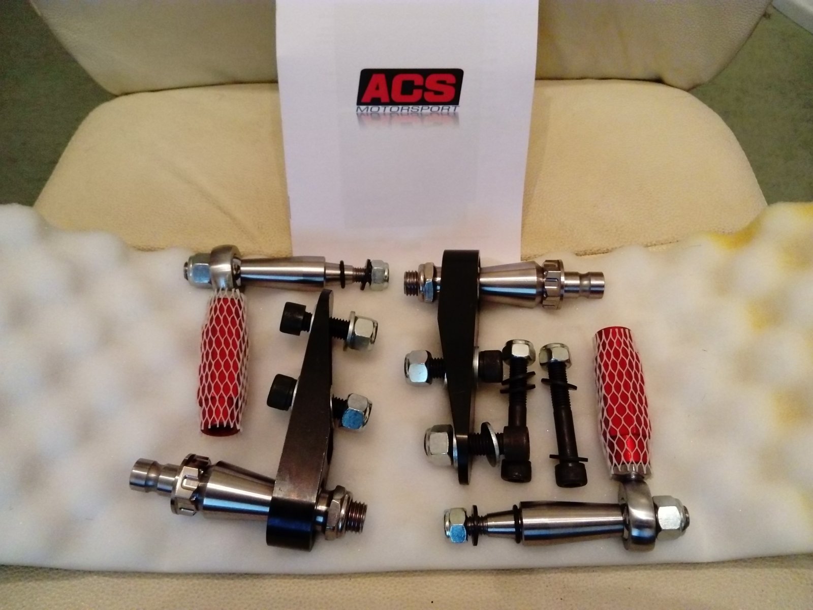

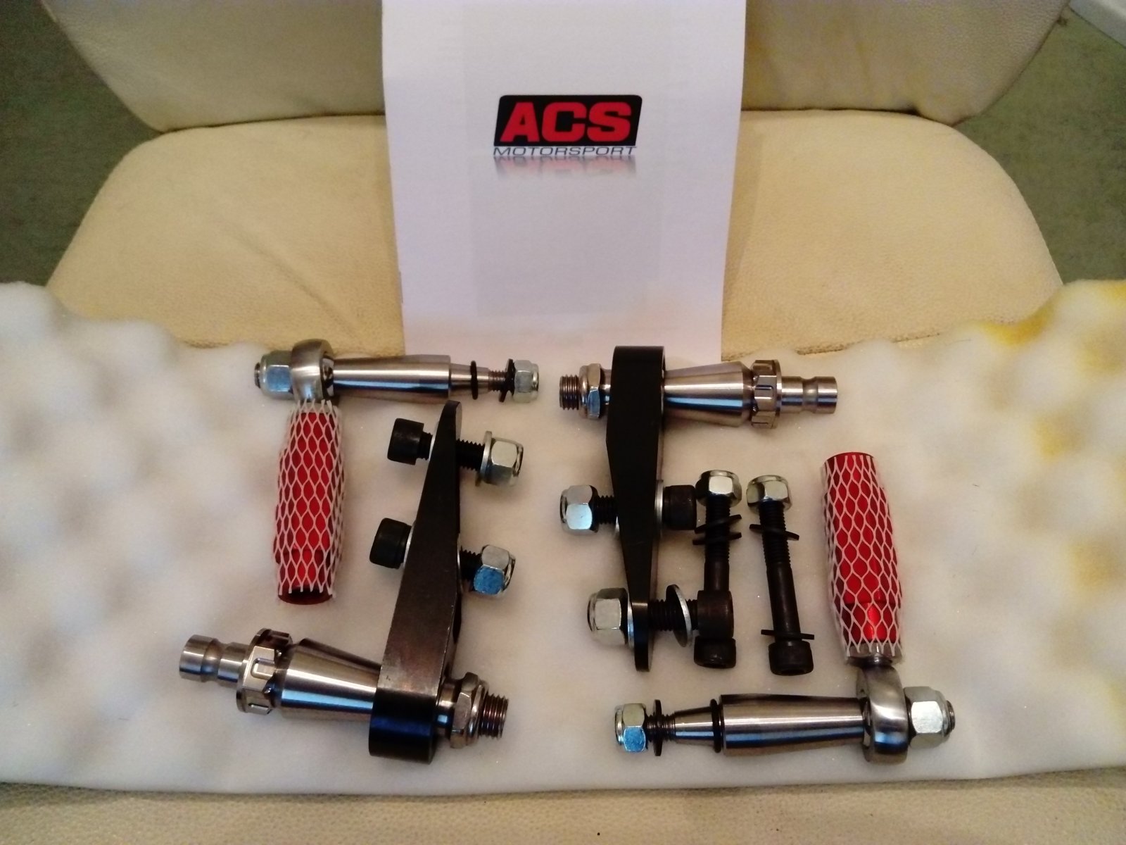

Sorry mate should have added the fact that the stick self centres in neutral (well mine certainly does anyway) when looking at the stick it's not overly obvious which gear you're in but once driving it just feels right and I didn't miss a gear all day

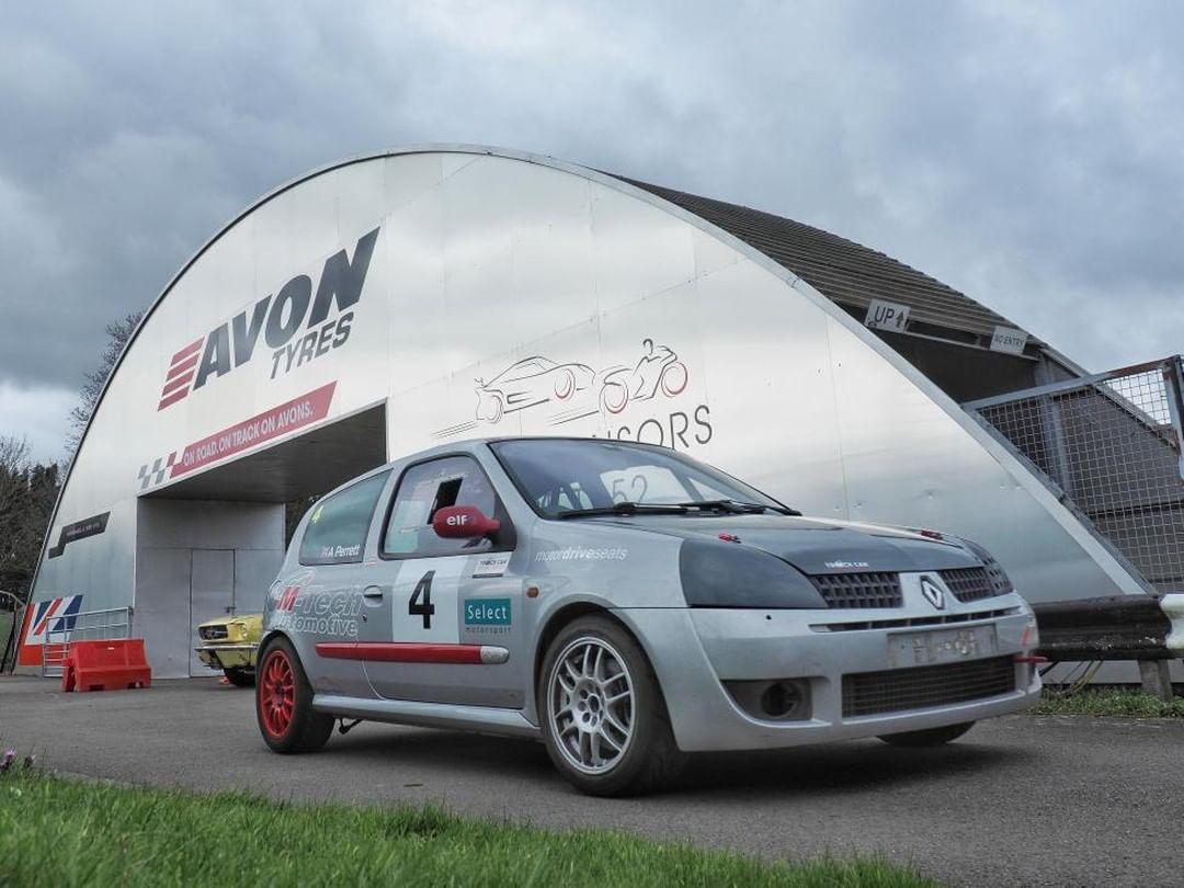

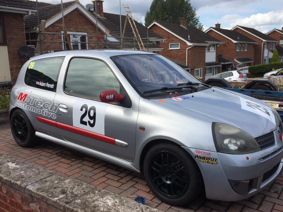

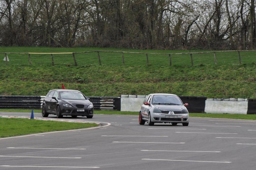

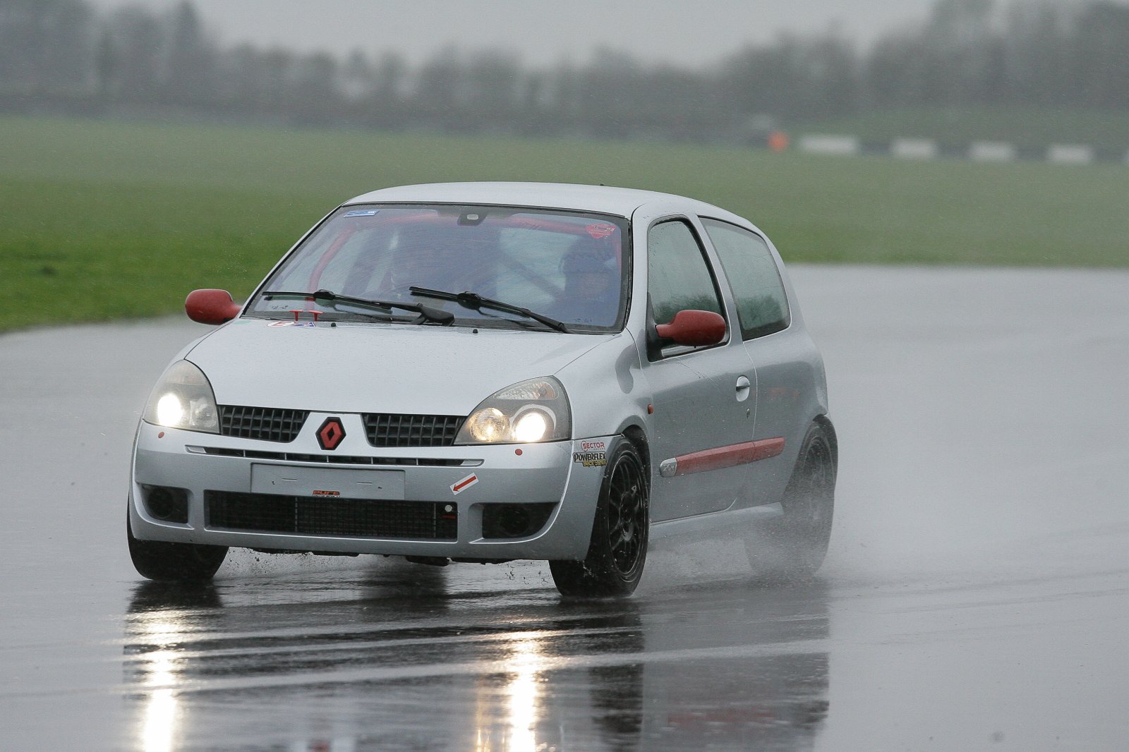

Few photos from another wet day at Castle Combe (03.03.17)

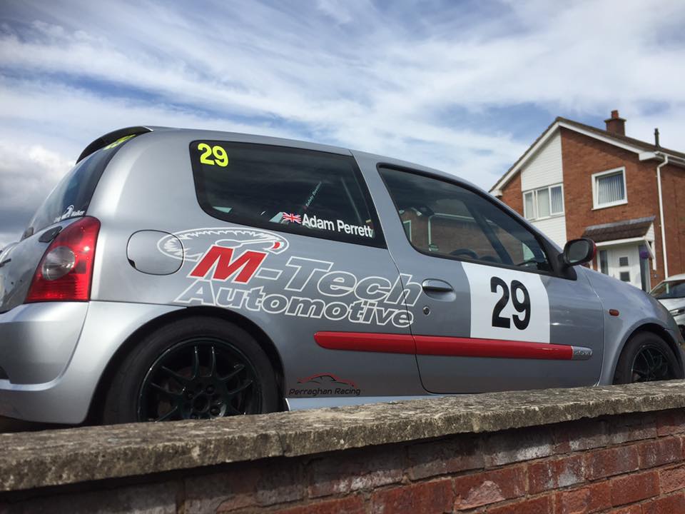

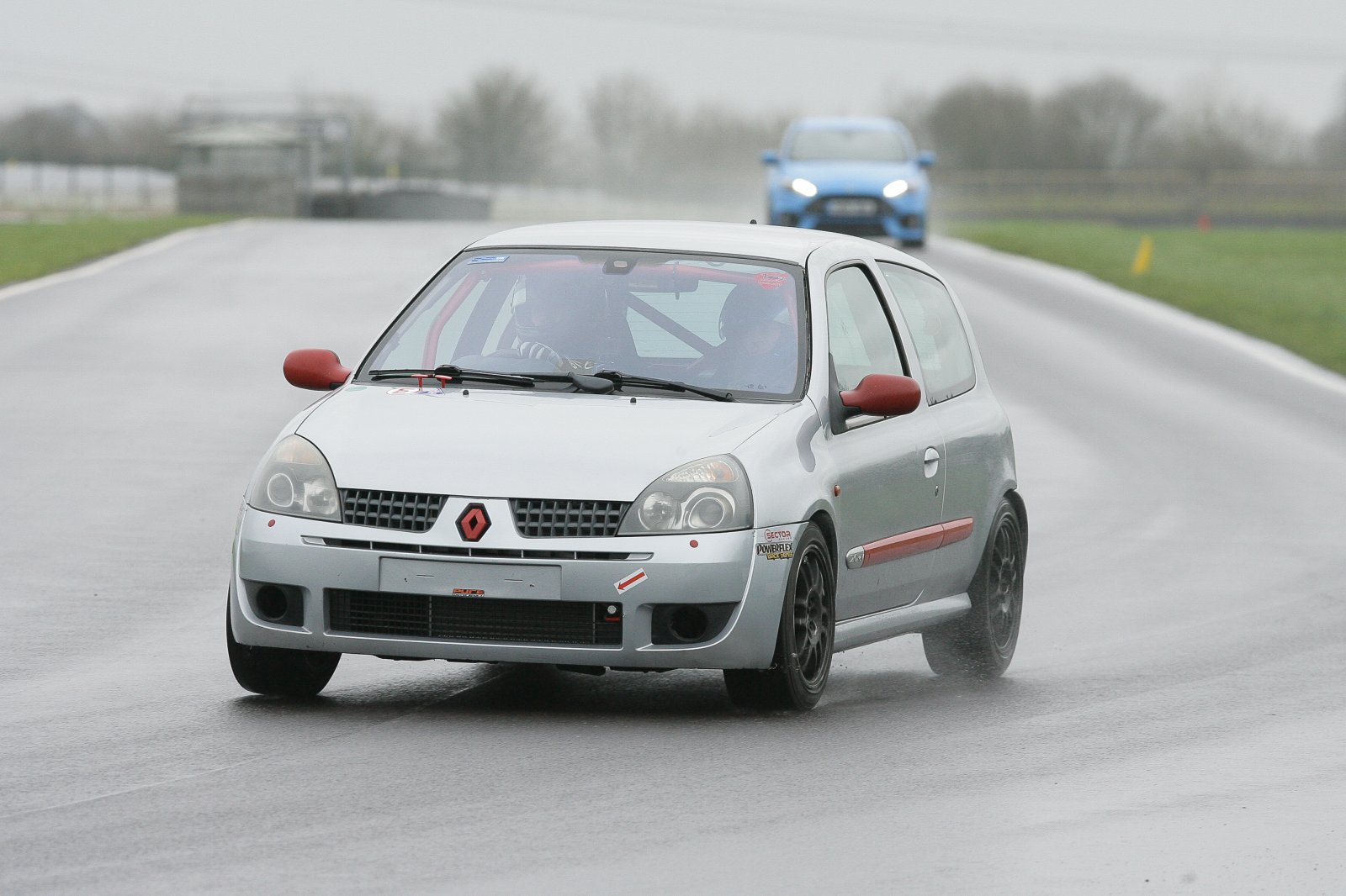

Possibly one of the nicest cars on the day, was a shame the weather was against is as this would have gone very well
How were the Gaz Gold's ? What spring rates have you got ?
Considering the fact that I didn't get a chance to have set everything up properly they were fantastic, once I'd got the damping set for the conditions I felt I could push the car more than I ever have previously despite the rain.
As for spring rates I've gone pretty hard, 800 front and 450 rear :)

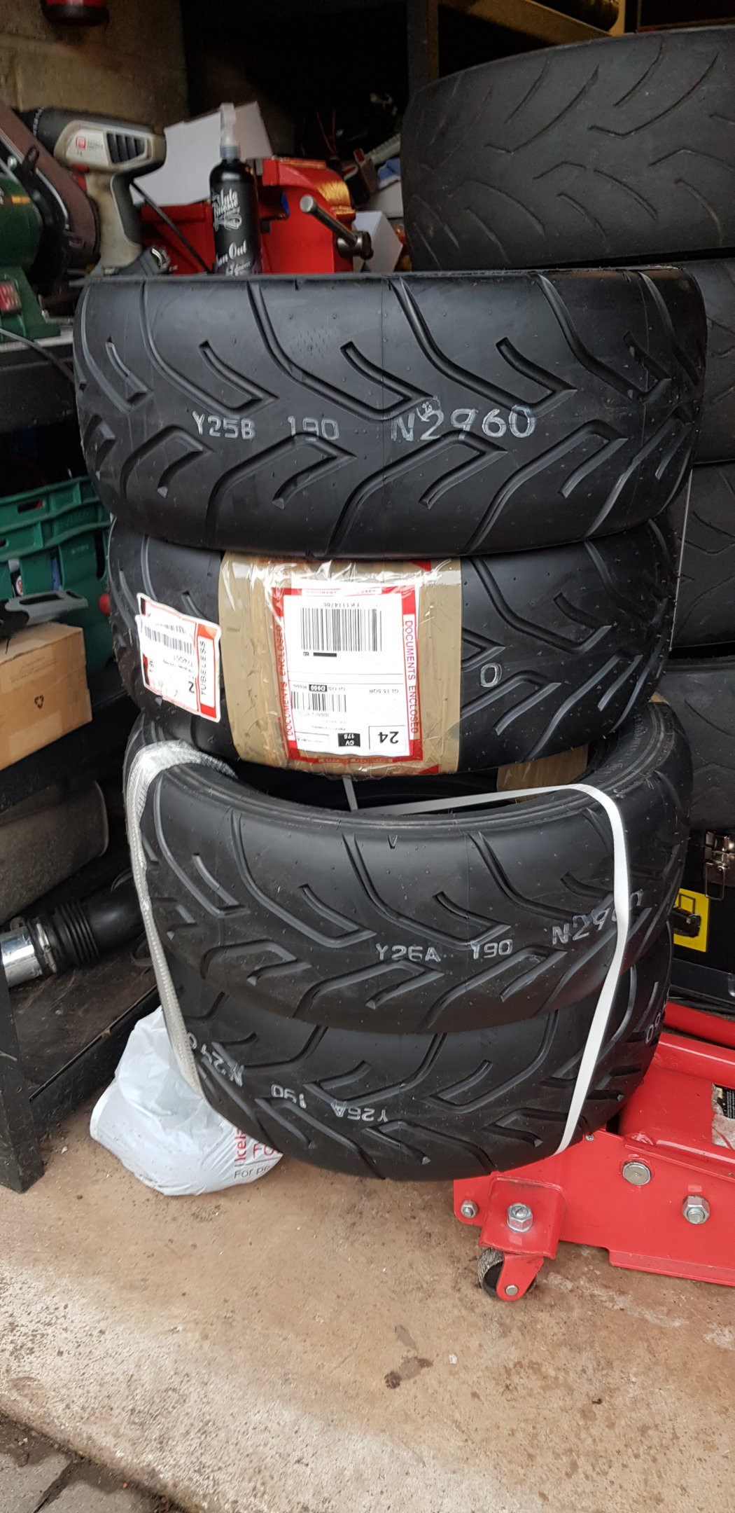

So not much to report on the car in the last month 😧 have picked up some direzzas to try out, and heater box is now out of the car to modify so I have a demister as I'm fed up trying to clear the screen on wet days.

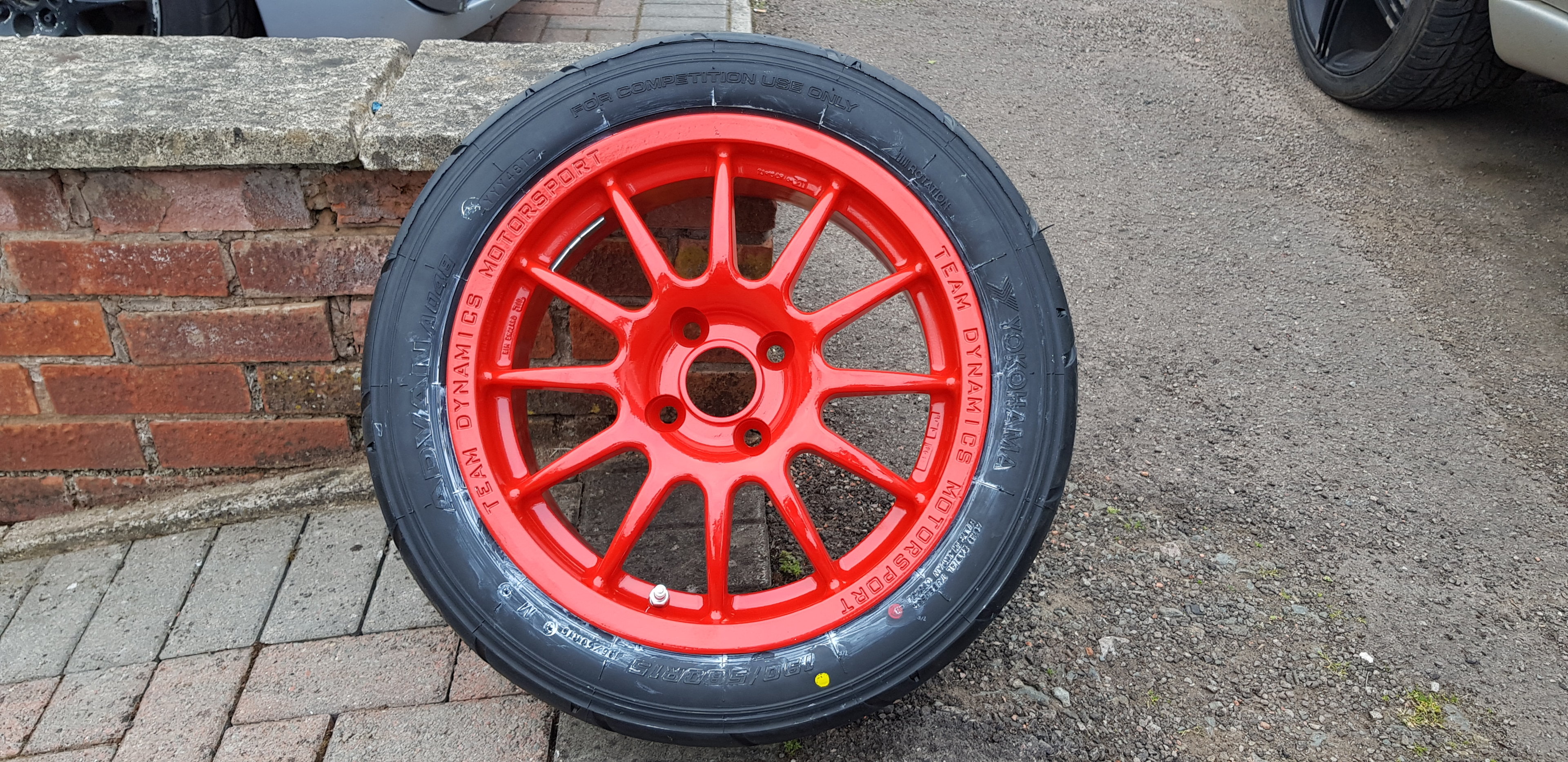

The mad rush is on again, only a few days to go until it's loaded back on to the trailer and there's still plenty to do.
Have fitted a basic spec heater box although haven't had the chance to modify it so it'll only blow onto the windscreen but it's better than before, also took the opportunity to fit a non ac blower motor and wire up to a switched permanent 12v on the dash.

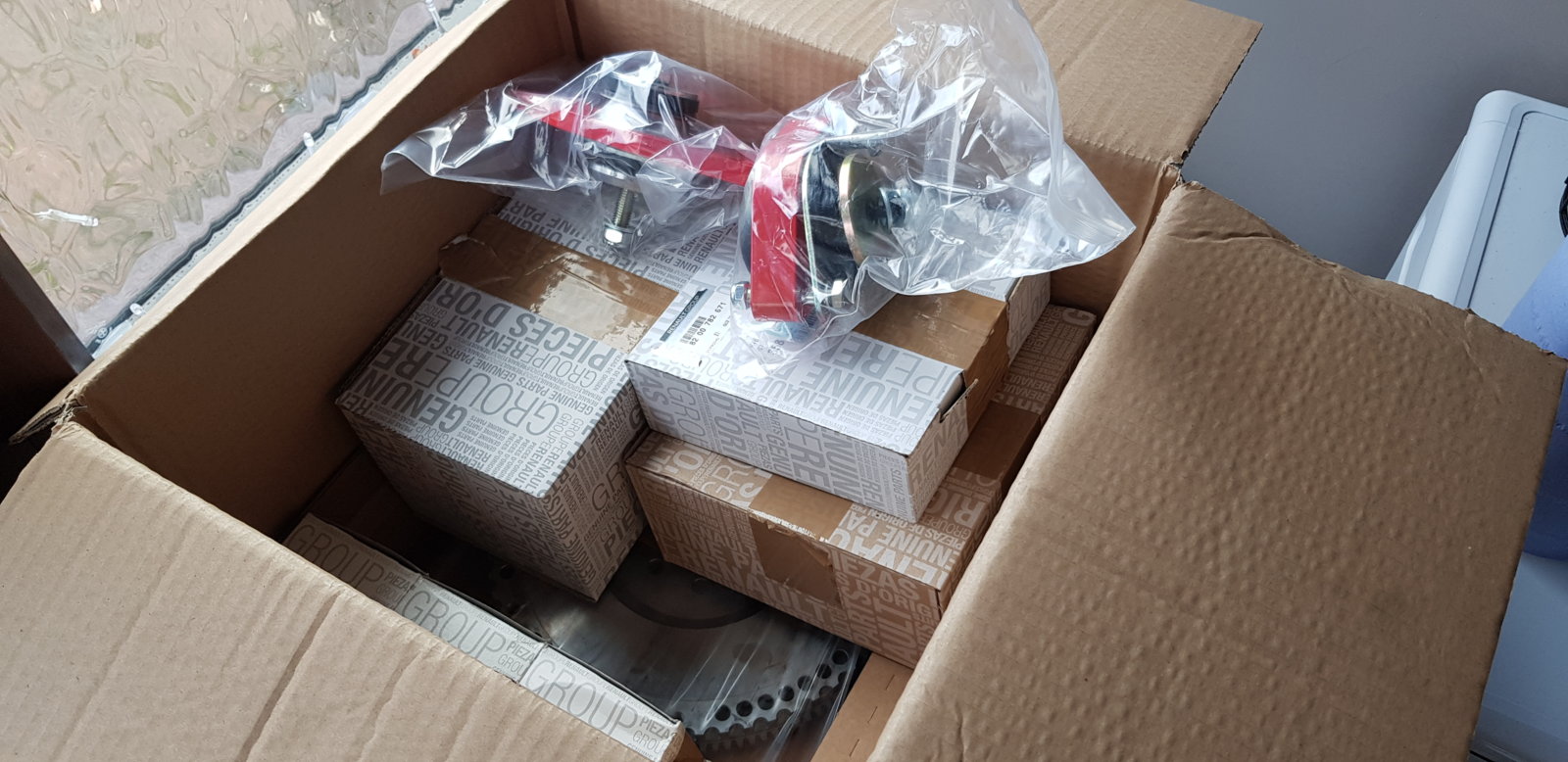

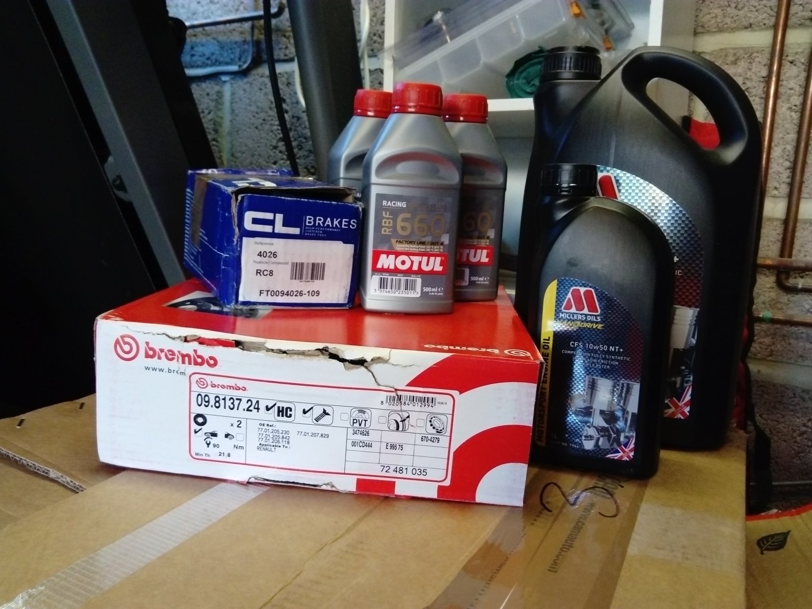

New brakes have arrived for the front in the form of another set of brembo high carbon discs and carbone lorraine rc8 pads along with motul rbf660 fluid, should hopefully bring about a more aggressive setup.
Quick oil and filter change to be done as well, genuine filter and some of Millers 'new spec' cfs 10-50 nanodrive

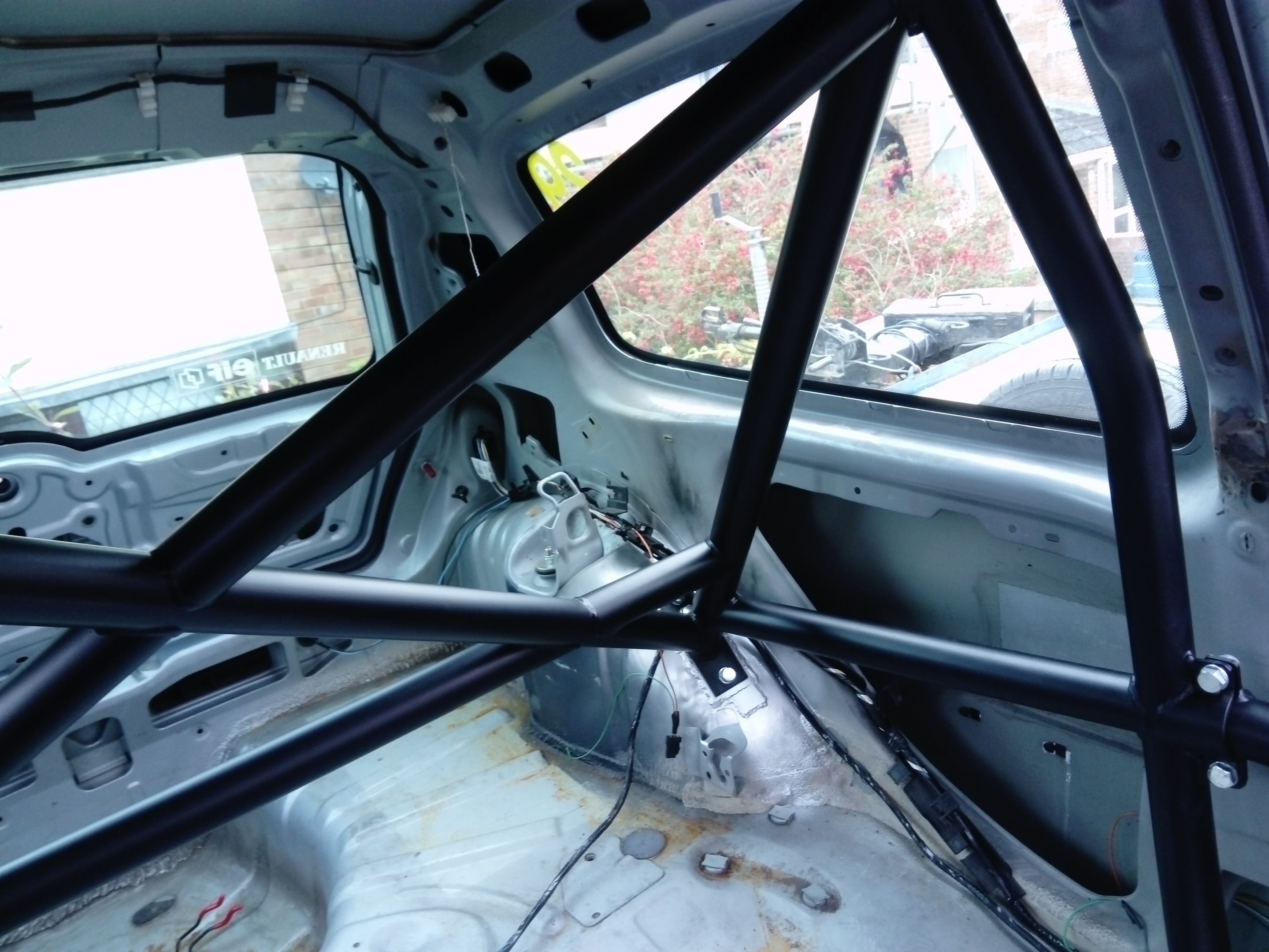

I've also arranged for my old roll cage to be collected by safety devices on Tuesday and should have a replacement here a few days afterwards, then it's a case of tidying up a few odds and ends and we should be on the grid later this year :) :)

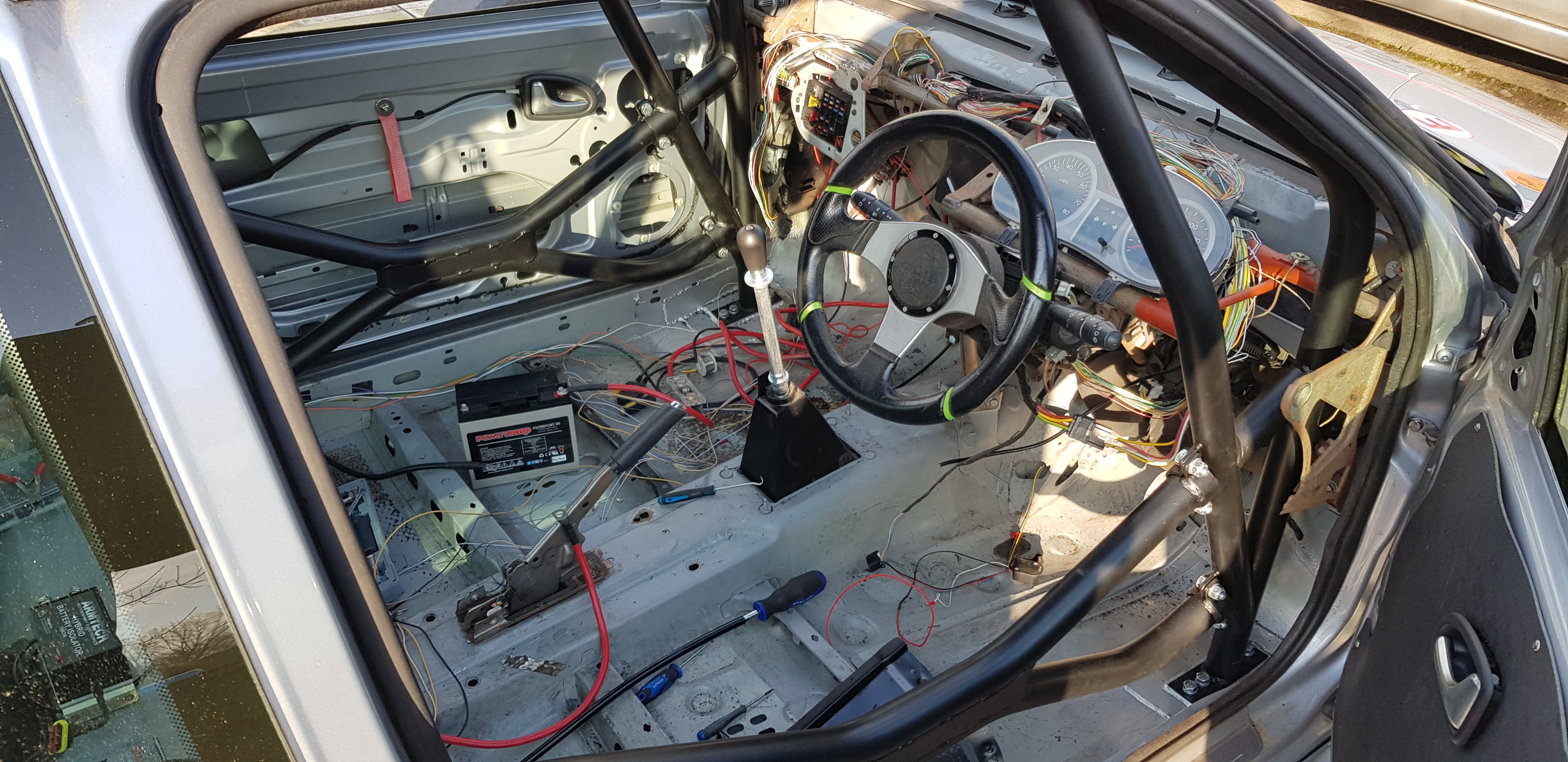

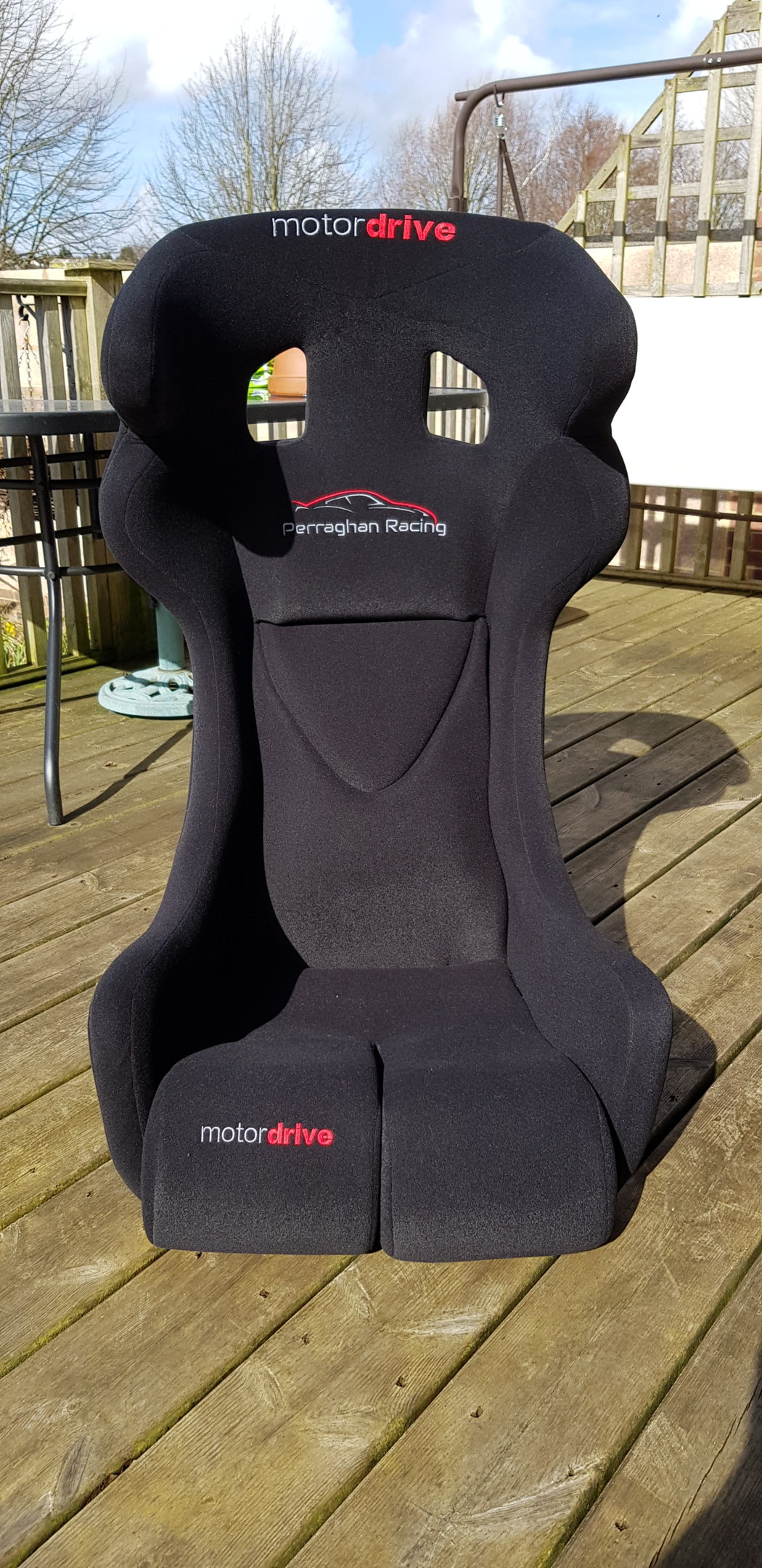

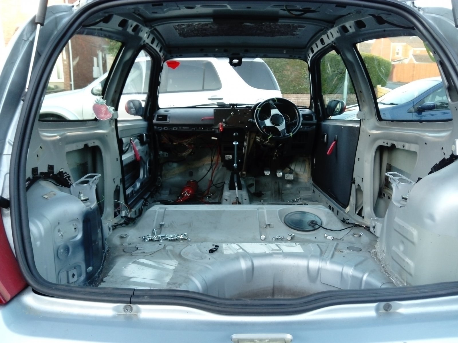

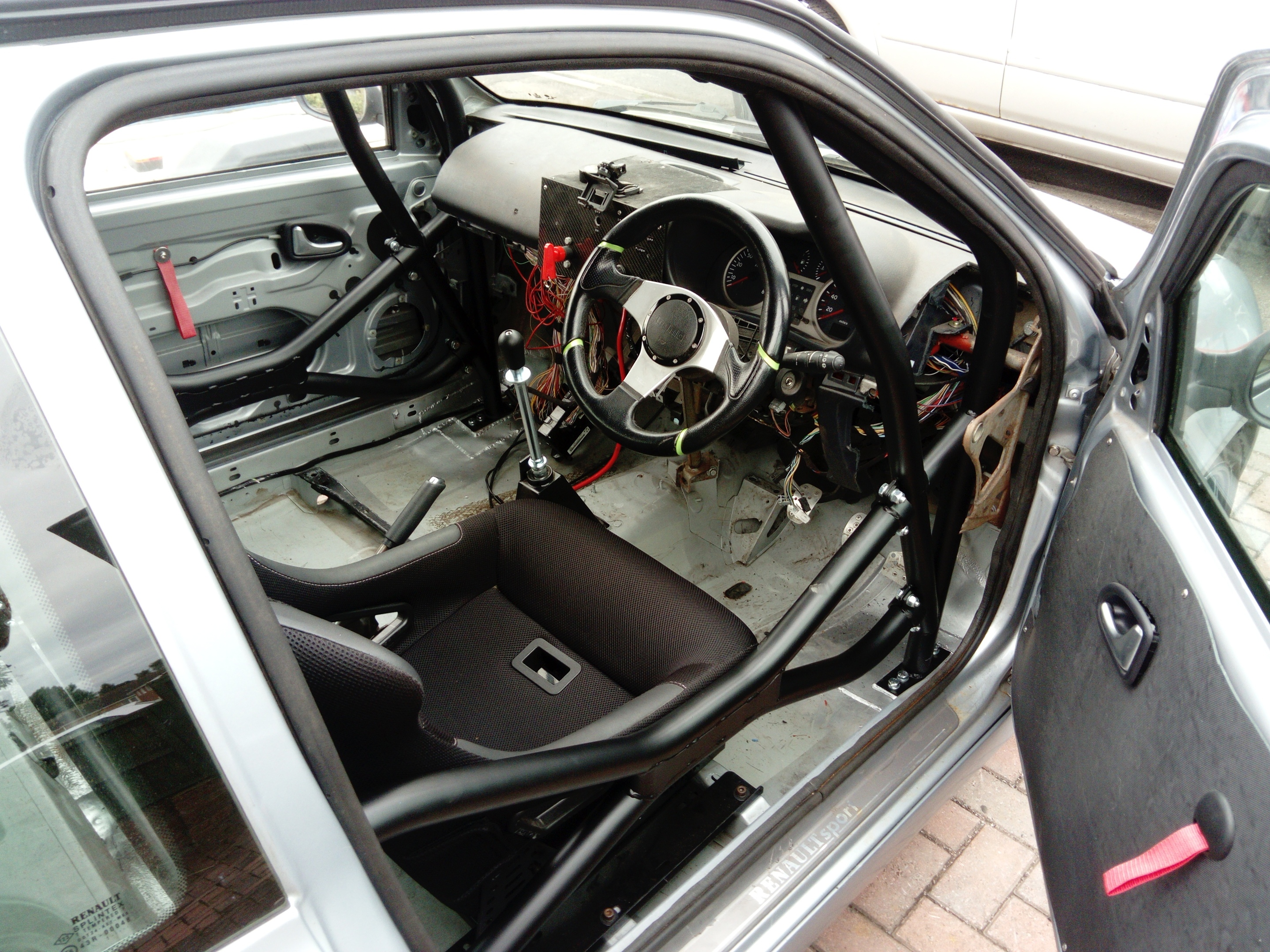

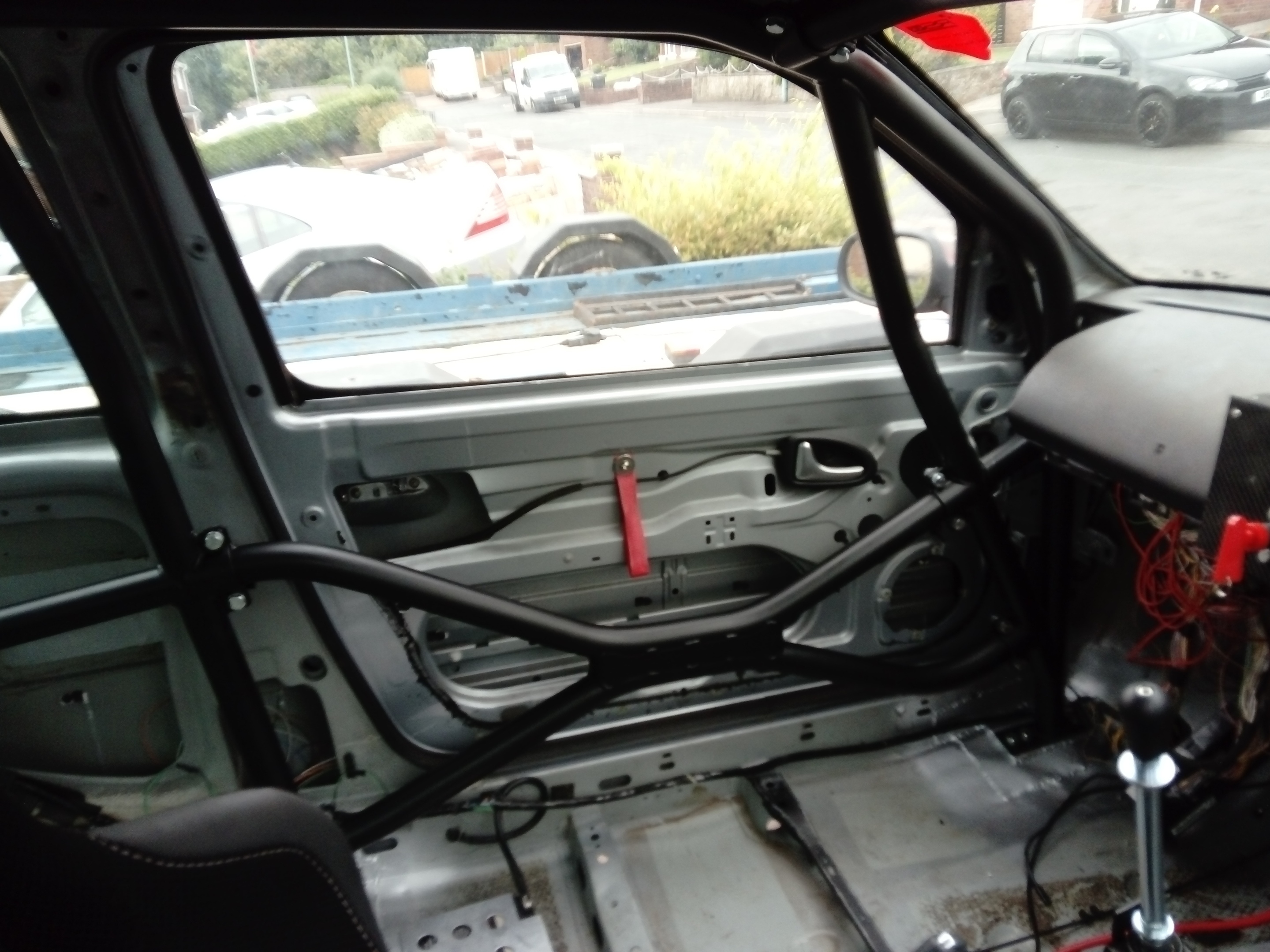

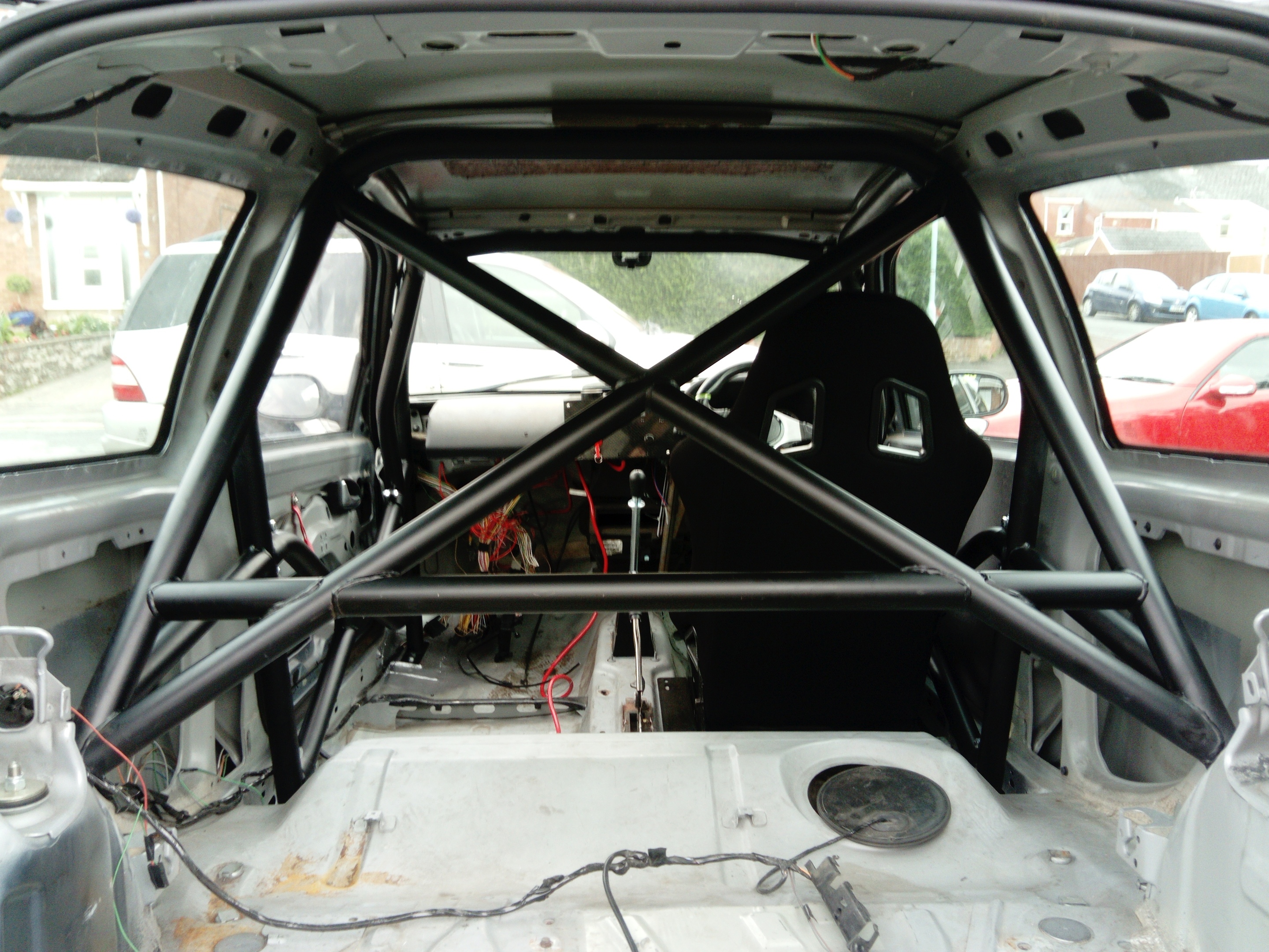

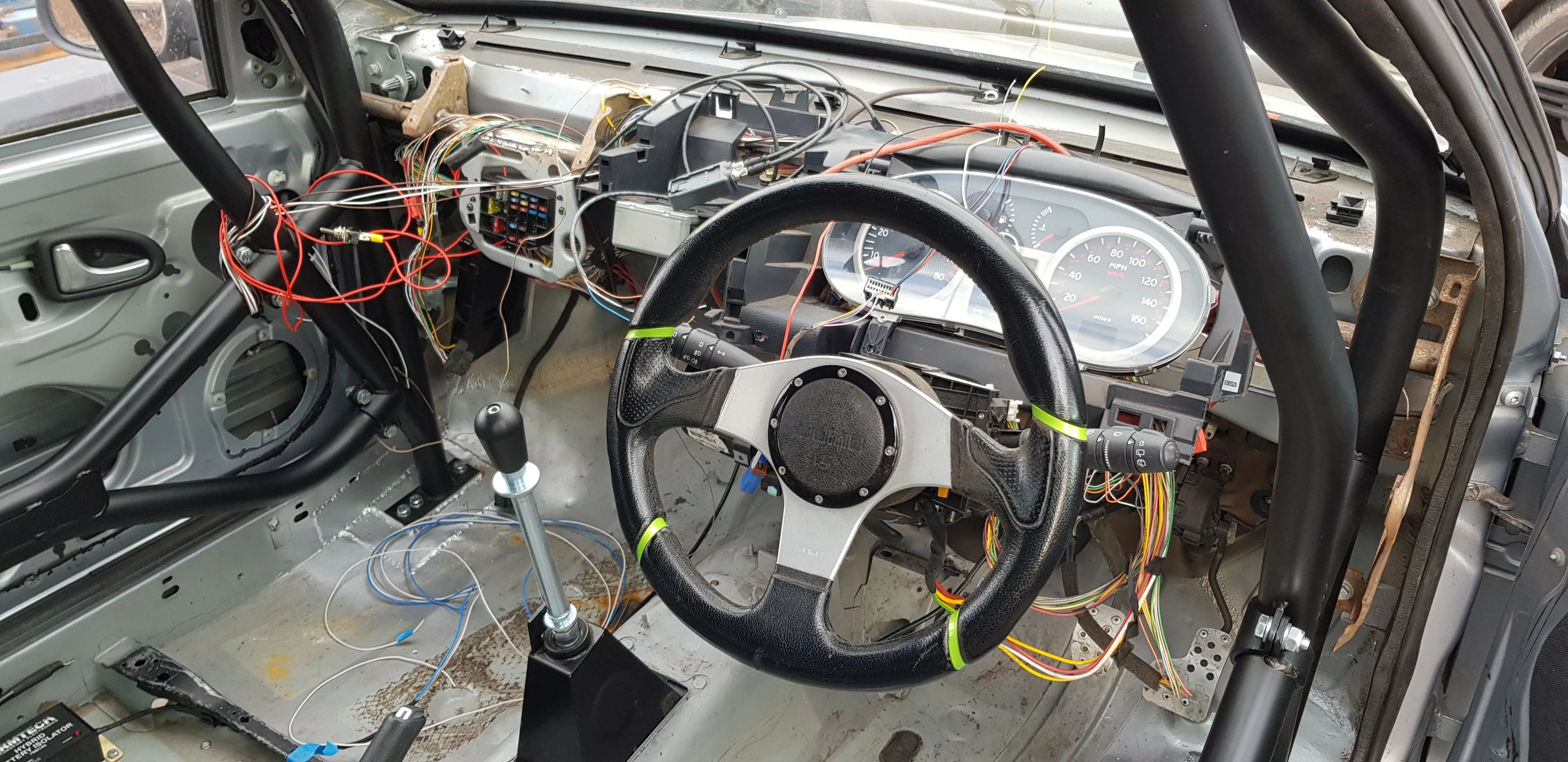

On to this evening and the strip down has begun, seats and cage are out, cage should hopefully be collected on Tuesday and new one returned a few days later
Certainly looks bare now its all out, but should have the chance to tidy up more of the wiring and make a start on painting the inside

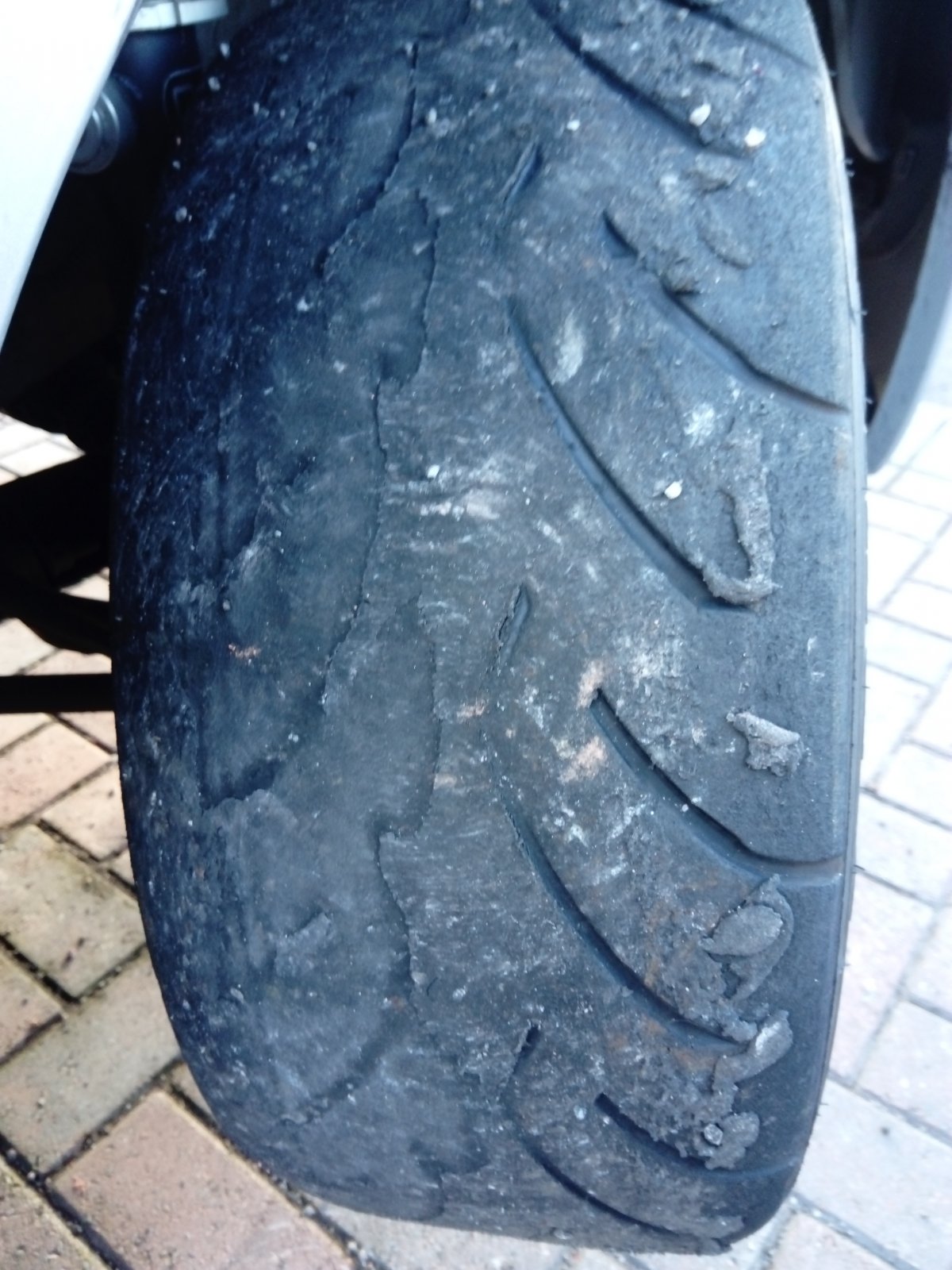

That's a lot of wear on the inside compared to the outside. How much camber do you think you're running ?
Or is that from spinning up the inside wheel coming out of corners ?
I think it's a bit of both to be honest, I was suffering with massive wheel spin at times, I'd guess I'm running somewhere around 2.5-3 degrees of camber but still haven't had it set properly so can't say for sure, it's all in the pipeline but as I'm still in the process of upgrading parts I've been lazy and not bothered too get everything set up, completely my own fault lol

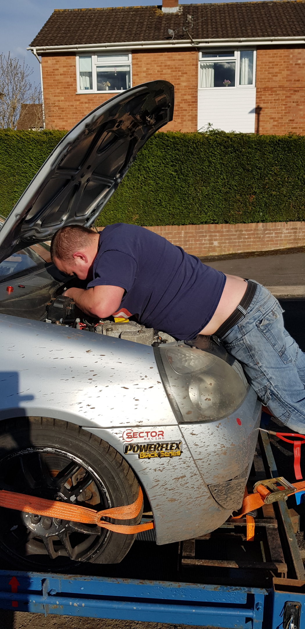

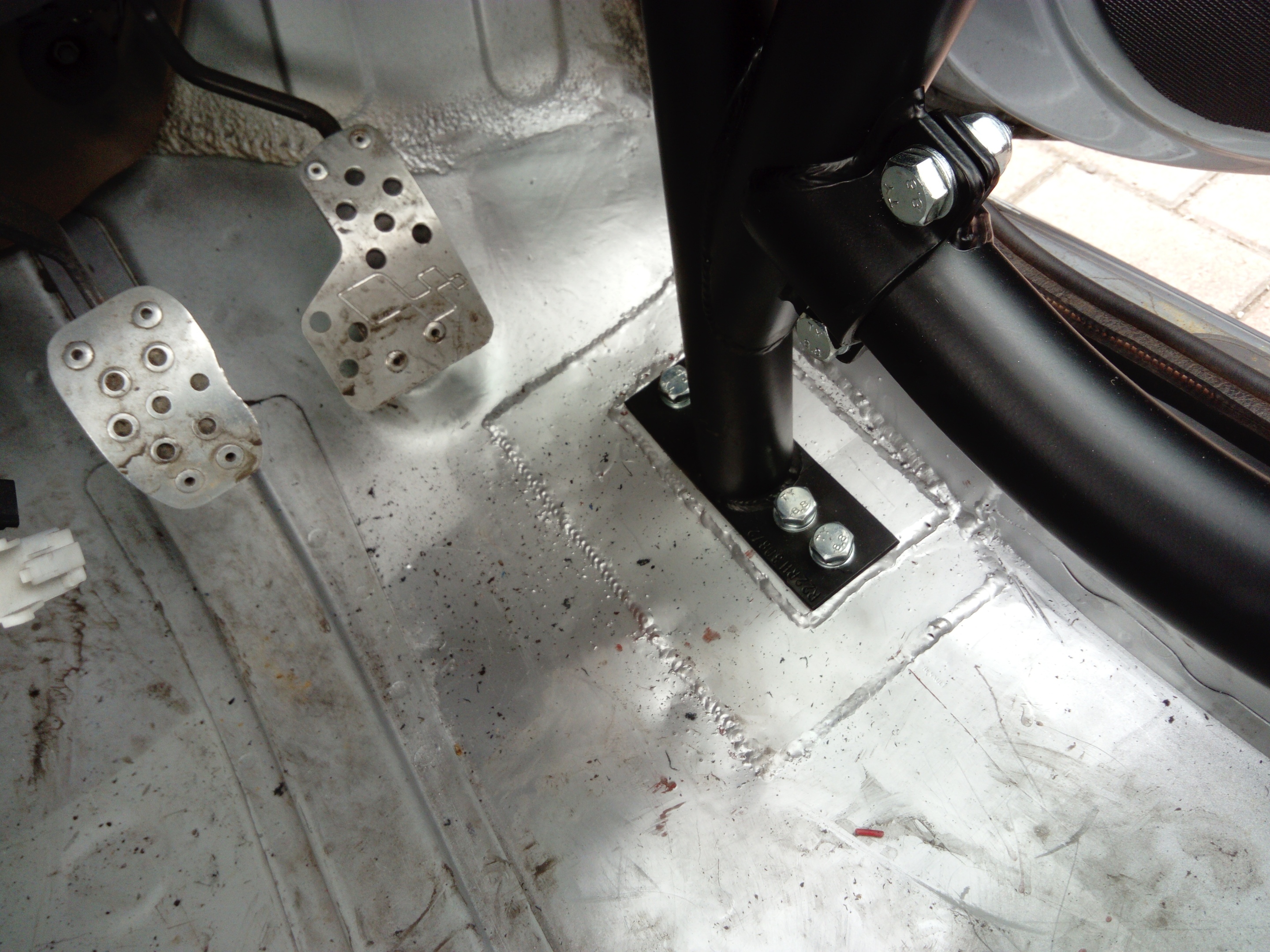

Well it's been a month since I dropped the car off along with the new spec safety devices cage, progress has been a little slow but the work is being fitted in around all their other work (mainly mx5 turbo/supercharger conversions).
In good news though my roll centre kit has arrived, well been collected to be precise. Fantastic quality and top service from @ACS_Motorsport, very highly recommended, and has a group buy for these on here too. Looking forward to getting these fitted and seeing the difference on track.

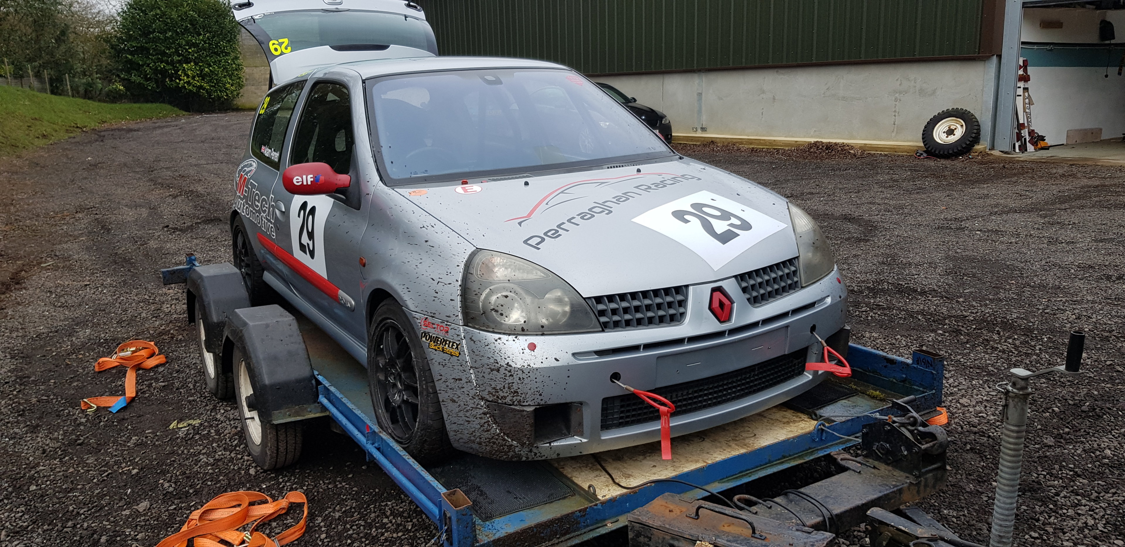

Little road trip today to pick up an old friend, nice to have it back at last. Few quick photos for now until I've cleaned all the grinding dust up. Only downside is I now have plenty of wiring to re route.
I may yet see the grid this year, fingers crossed

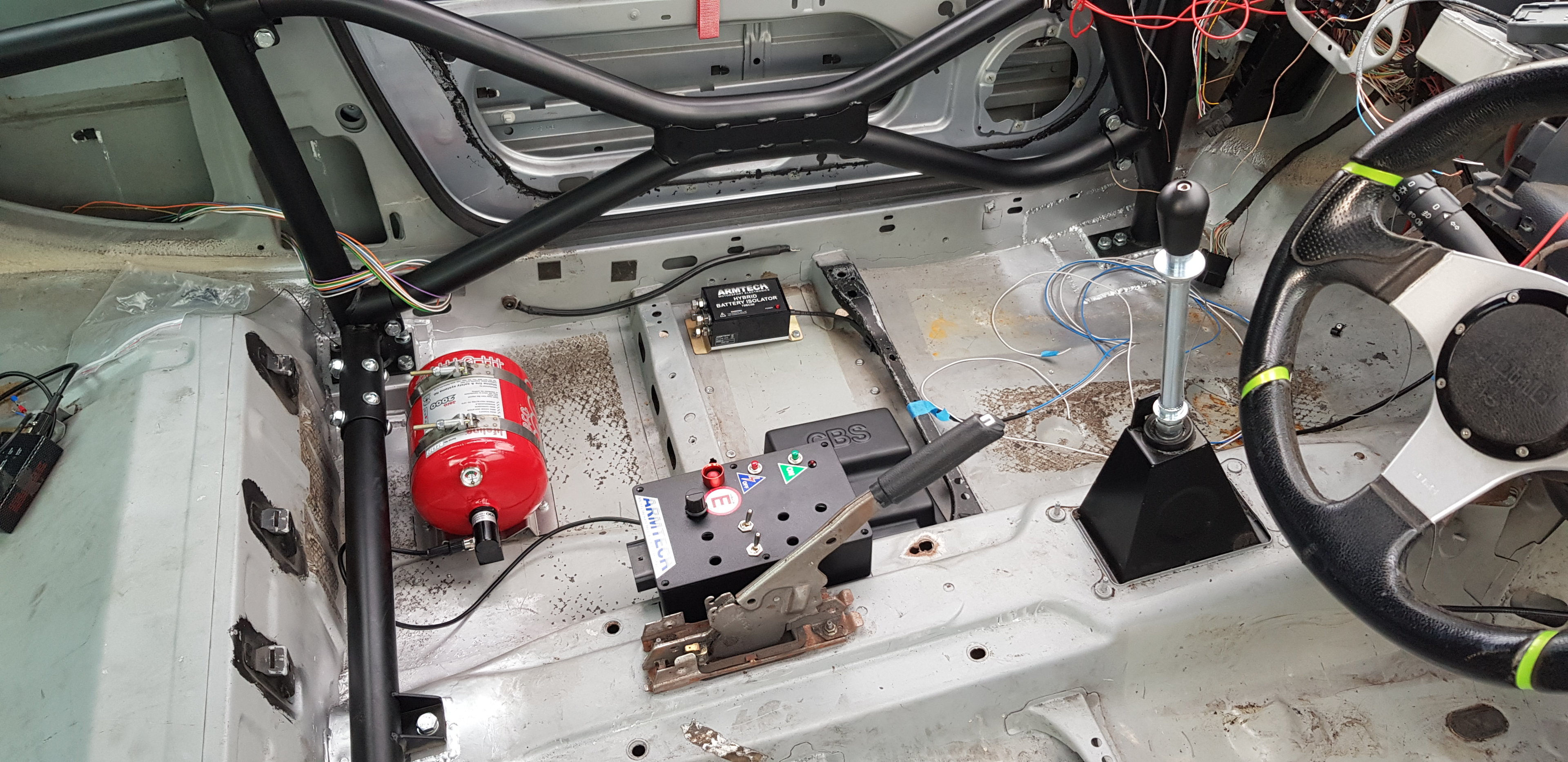

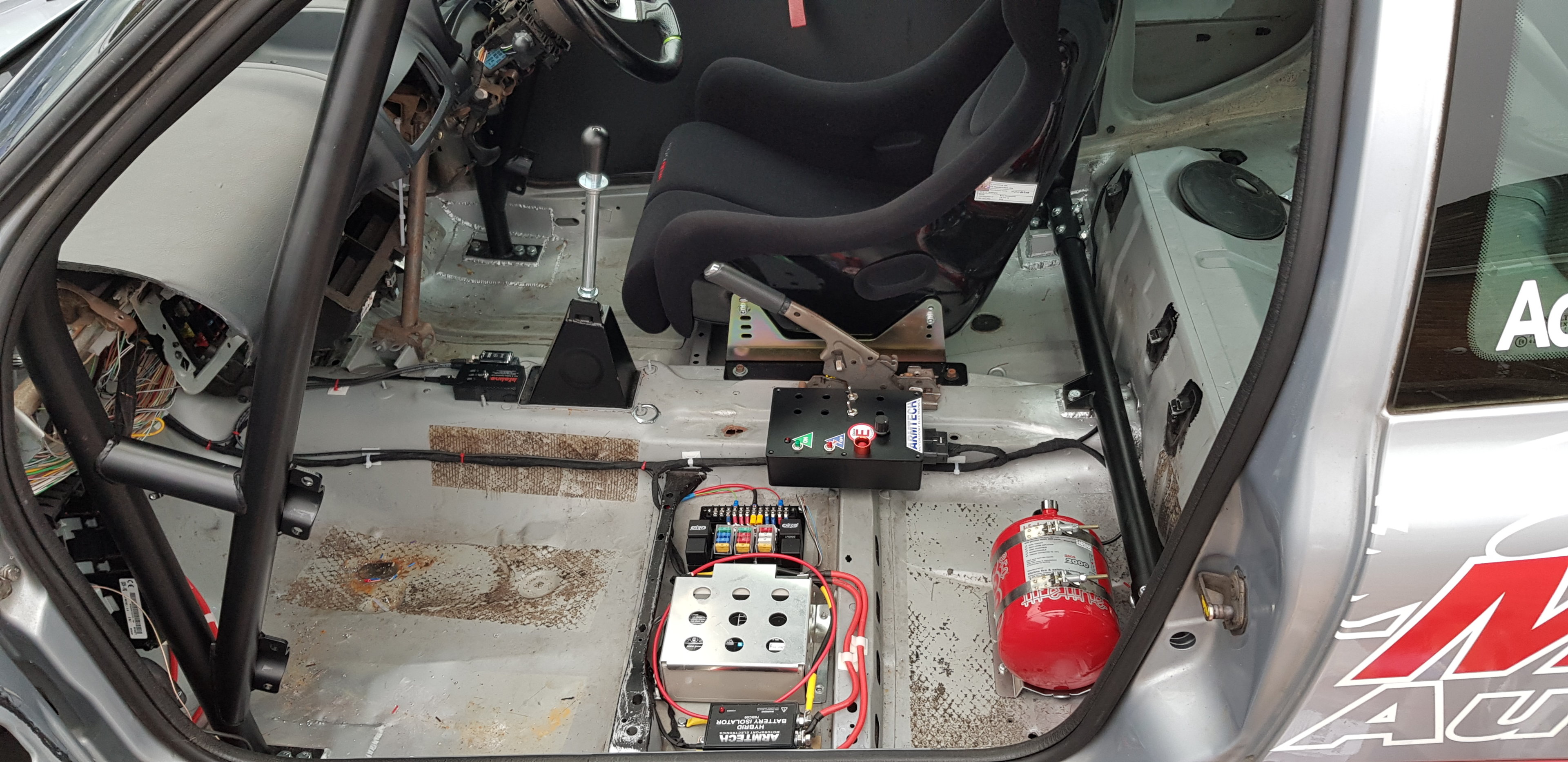

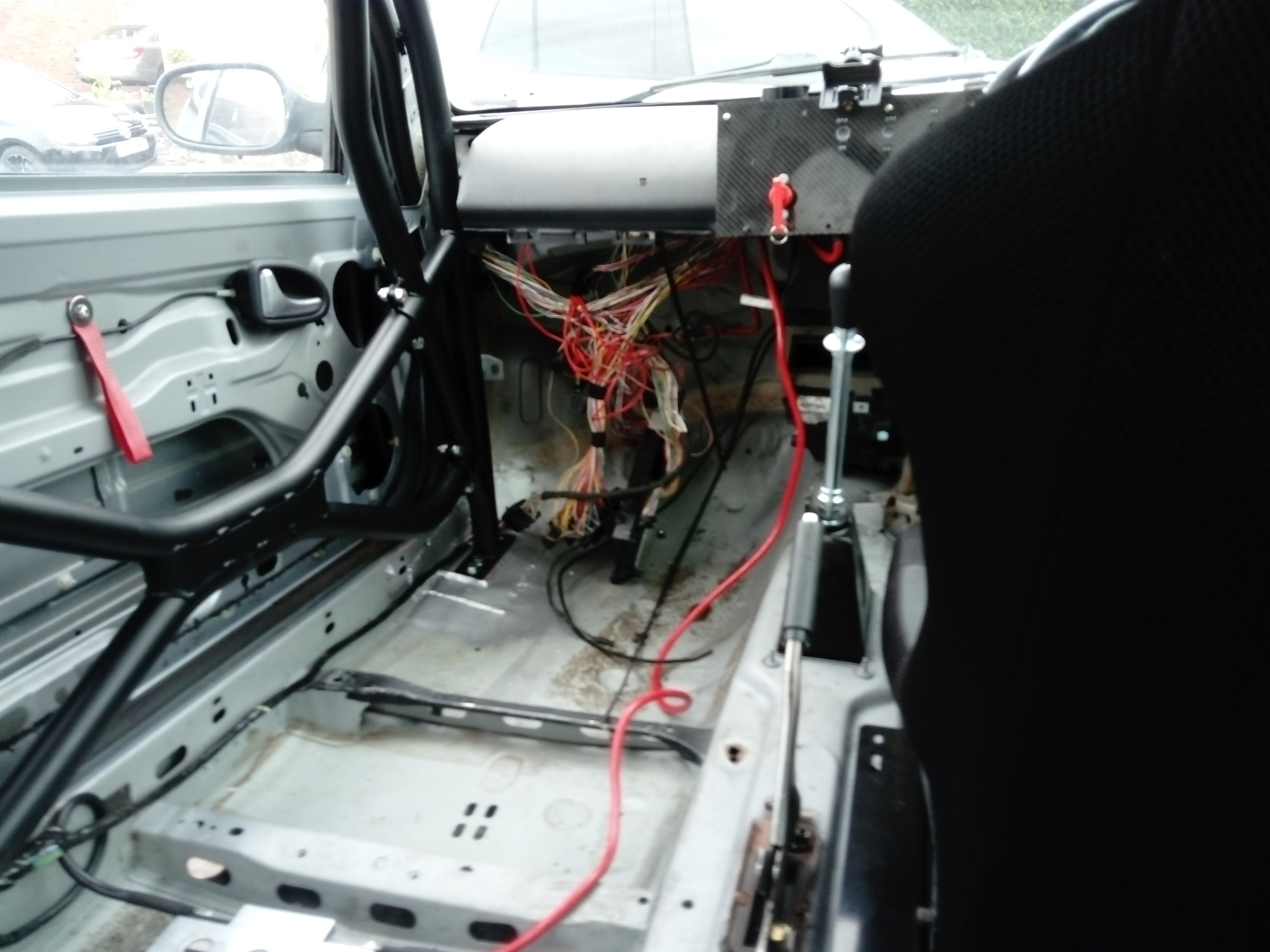

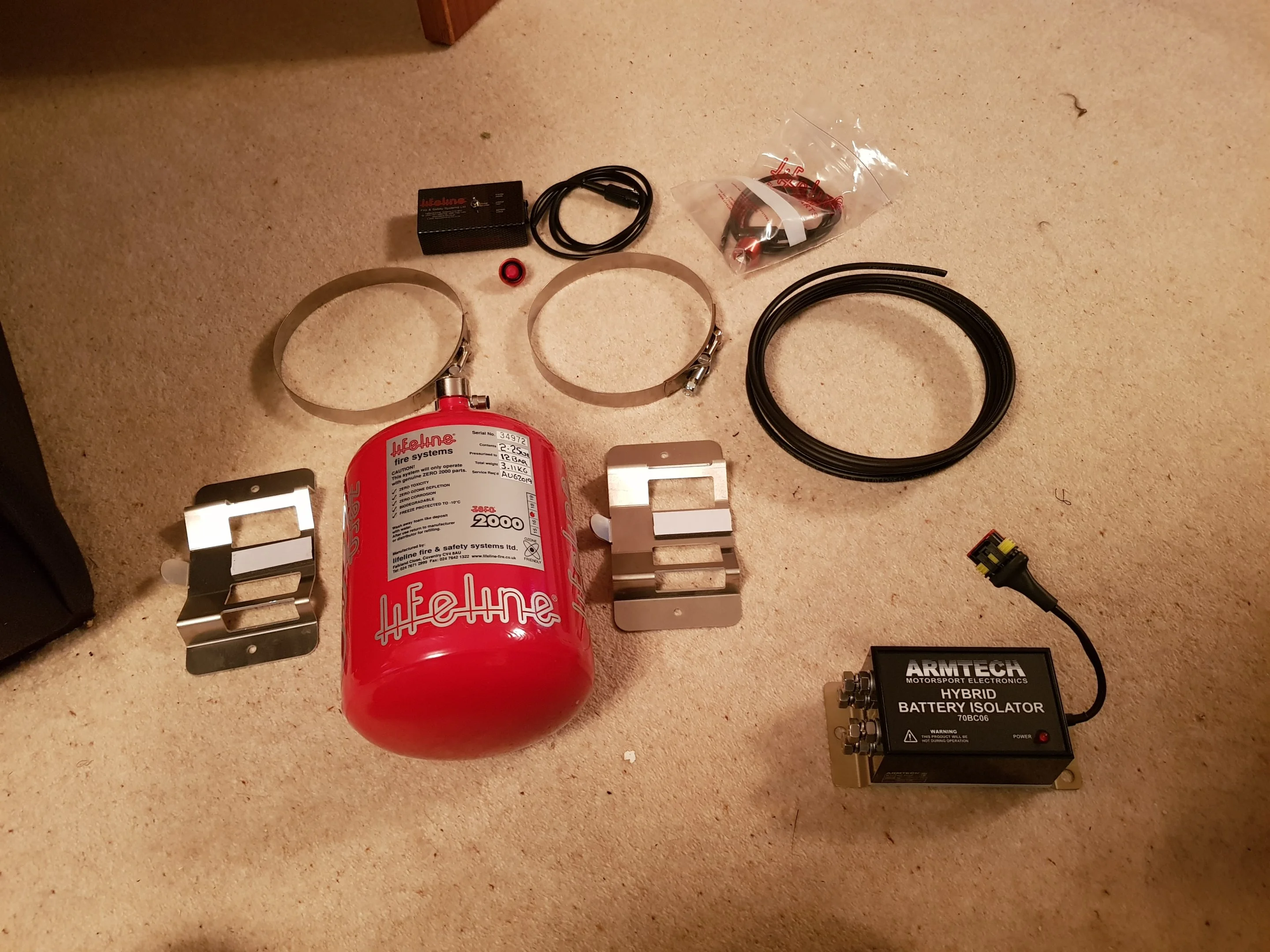

We started off with a new fire extinguisher and electric battery isolater, I've never been a fan of manual pull cables and the idea of push button switches seems better to me so in came an armtech isolater and electric lifeline extinguisher system
These were initially mounted onto a spare passenger seat subframe but ended up mounting directly to the car, every bit of weight saved helps right? ;)

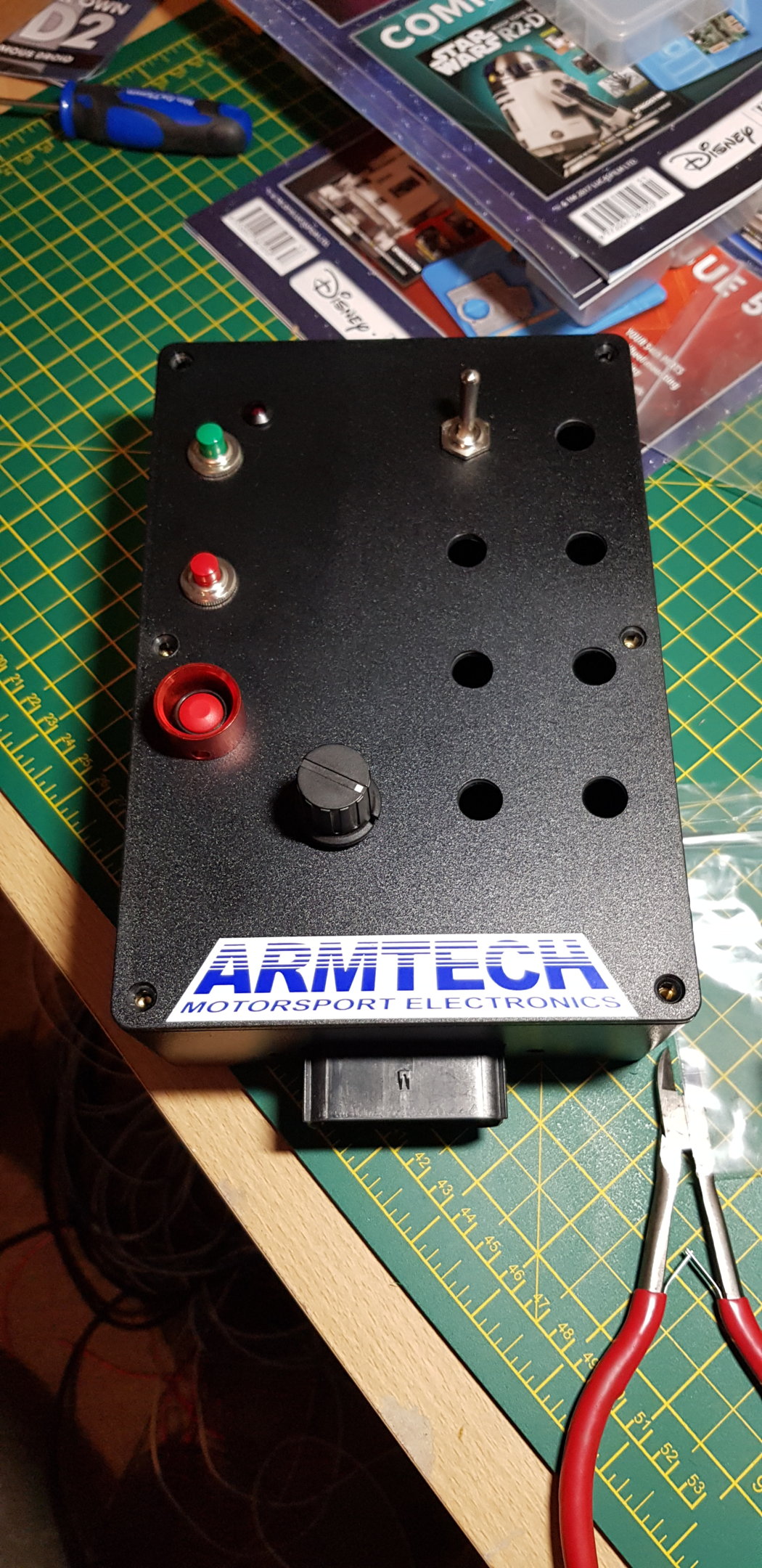

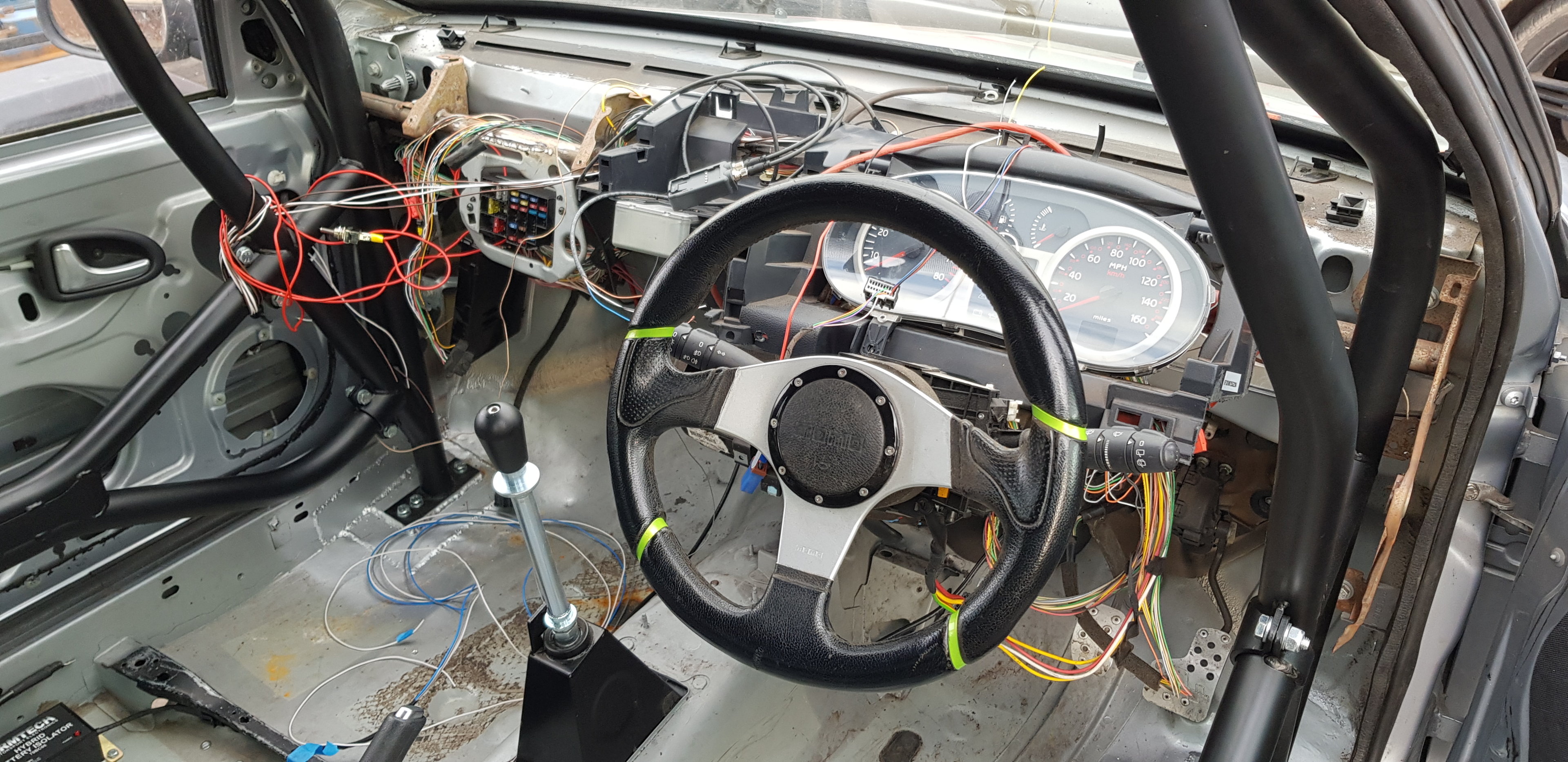

Next on the list was a new control panel to house the switch gear and a fee other bits, so taking some inspiration from other threads on here I came up with this, currently has both the electrical cut off and extinguisher along with epas controller, rain/fog light and heater switches
There's also a new fuse box from car builder solutions, at the moment it only runs a couple of aux systems until I get the time to transfer more across from the original one and a hard wired race transponder from mylaps (new version of the old red amb ones)
Few in progress shots
With everything fitted, and the original rear part of the wiring loom thinned out and 're routed' along the centre tunnel to incorporate with all the new bits the interior currently looks like so
It's hard to describe just how many hours ended up going into something that seems so simple to achieve, there are bits I'd like to have done differently but it all works so for now it's staying as is :)

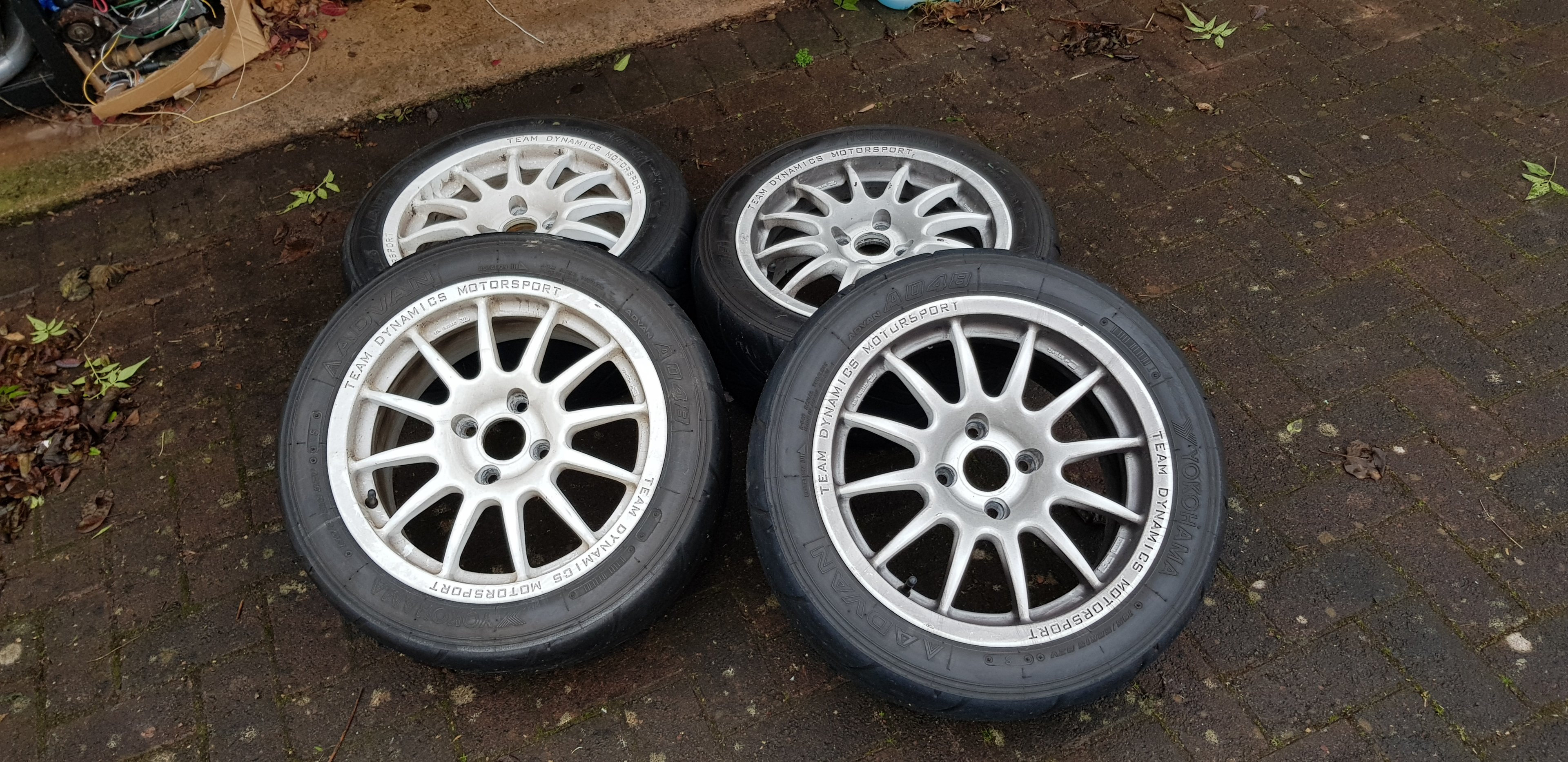

Spent the rest of the day getting used to some new 2nd hand Yokohama A048 tyres, which seem to suit my driving style better than the Dunlops we used previously
Along with the roll centre kit the car felt completely different and consistent 1.22/1.23 lap times seemed to back this up. Packed up at the end of what was all in all a good day, feeling ready for our debut race day which was looming

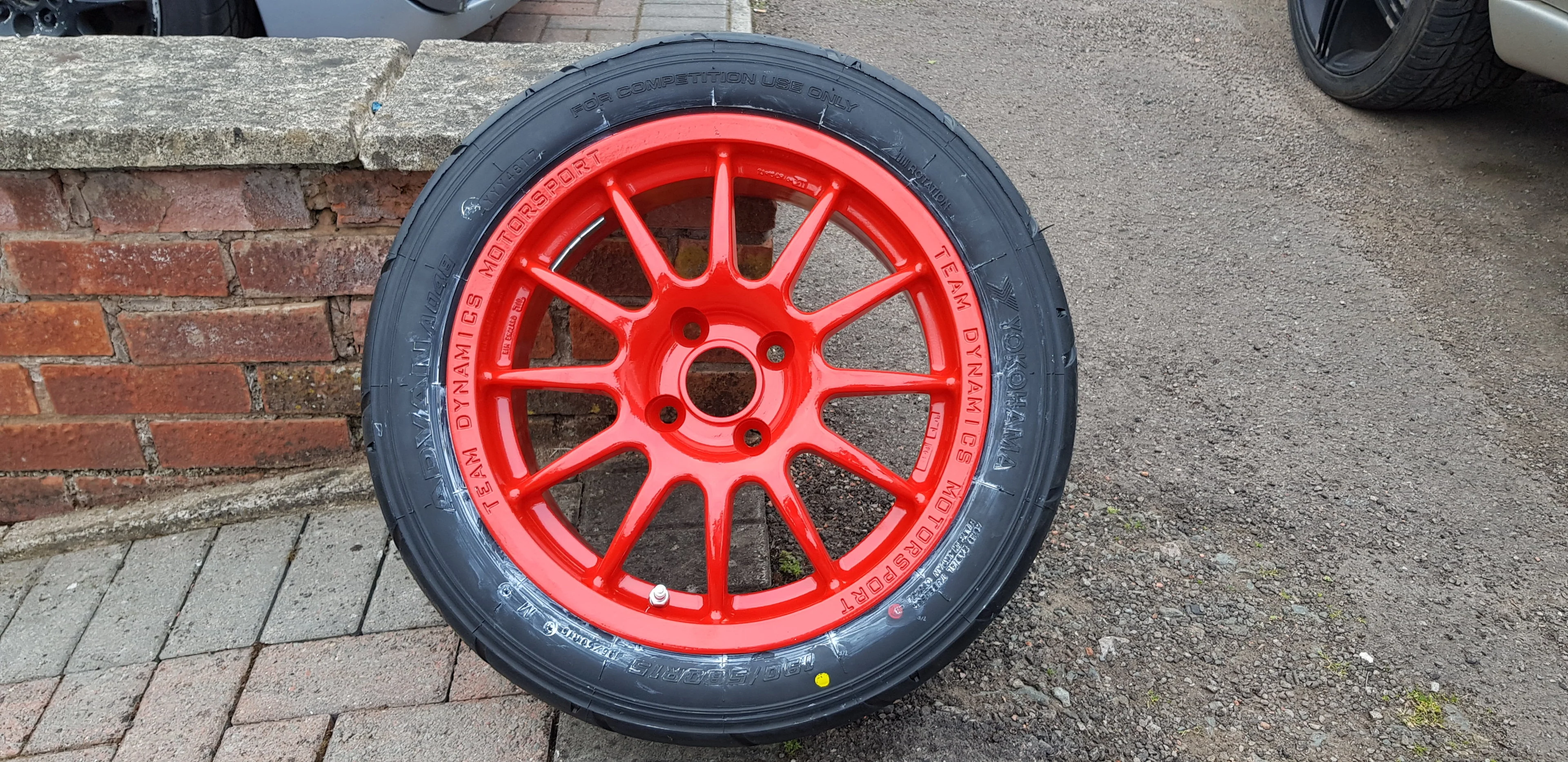

Also decided that the pro race 1.2's needed sprucing up (another winter purchase I'd forgotten about) so they went off for a refurb and some fresh rubber, from this
To this

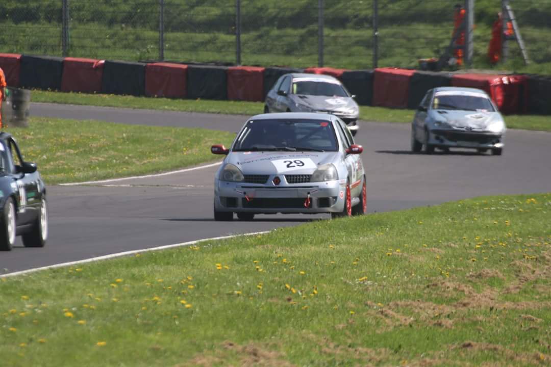

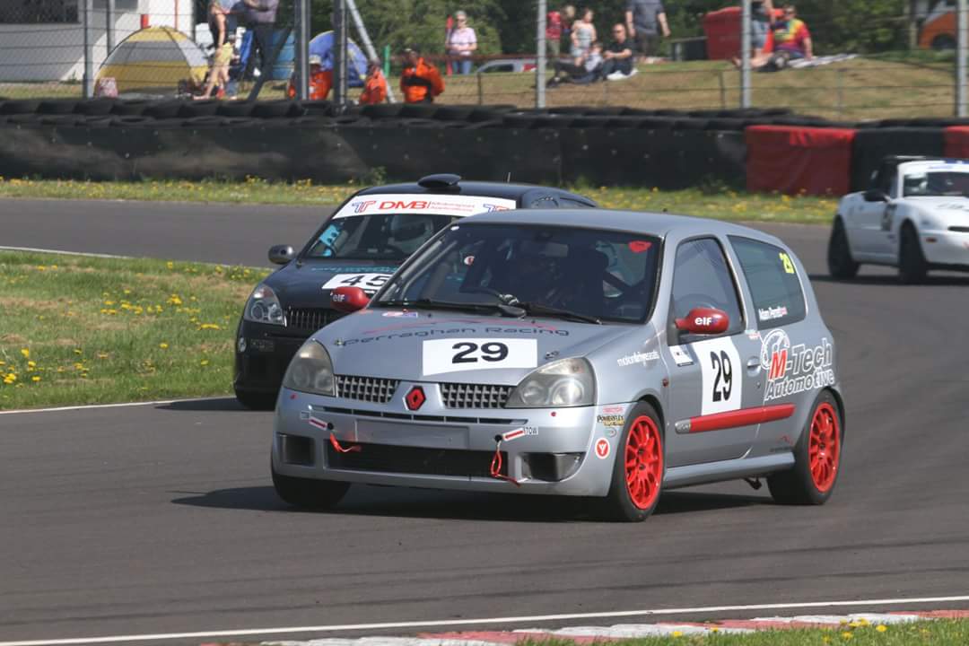

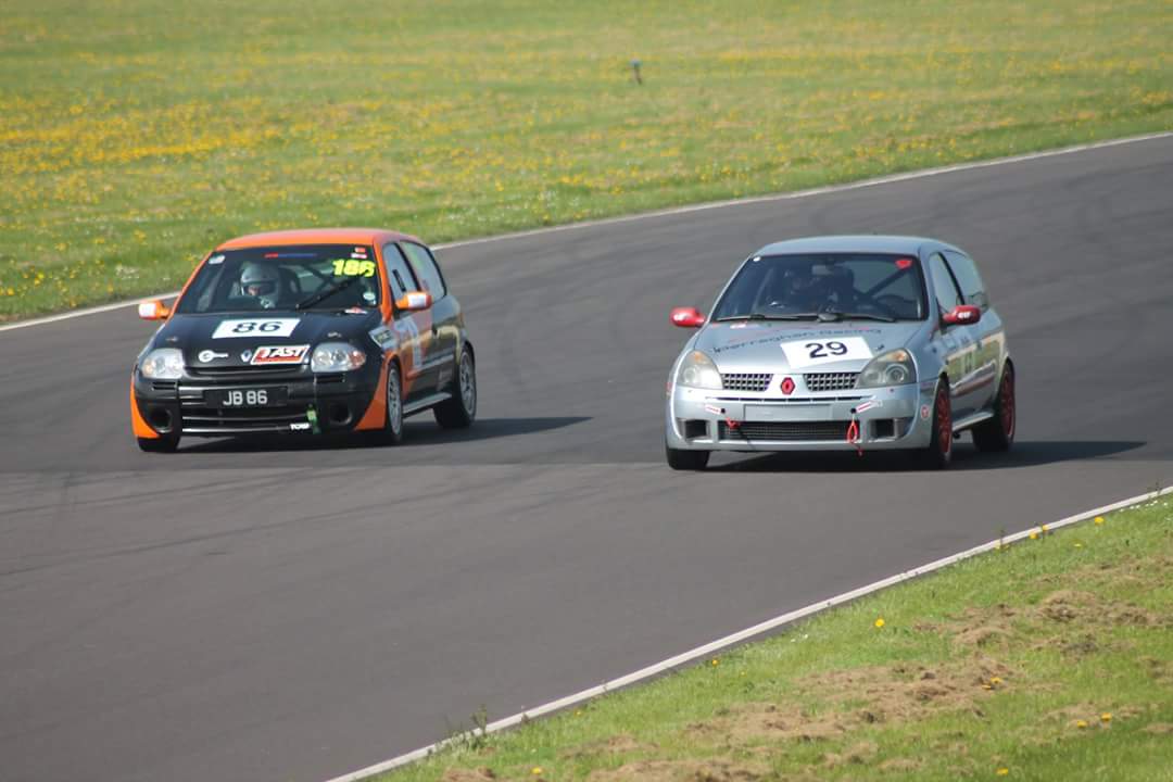

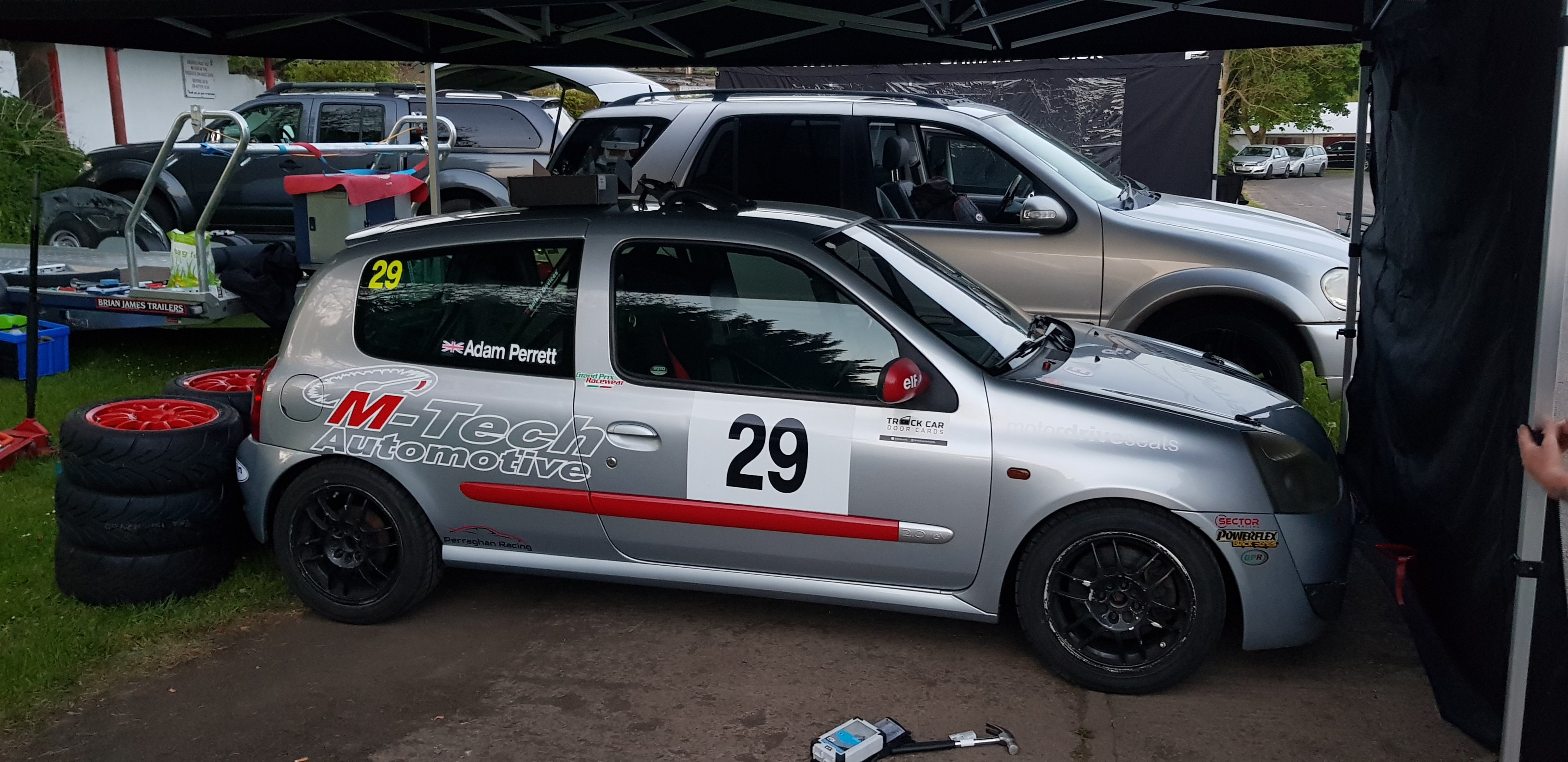

Castle Combe race meeting with Track Attack/Tricolore Trophy
Early May bank holiday weekend, finally our new trailer was ready, with a day to spare. Off I went to collect first thing Saturday morning, really impressed with the quality and ease of towing, I can highly recommend Brian James for their transporters ?
Loaded the car up and we were all set for Castle Combe, although local we went the day before and camped overnight in order to give plenty of time to set up and not have to rush around Monday morning
This went straight out of the window, and all hell broke loose after asking one of the experienced drivers to have a look over the car, cue a drive back home to pick up some bits I had disregarded as needing, by Sunday night a state of calm had descended and all was good.
Scrutineering had been my biggest worry, I know the car inside out having built it virtually by myself (bar roll cages) but having it inspected by somebody else had me on edge, thankfully it flew through straight through and thanks to the scrutineers running late we were rushing around to get out for qualifying. At this point all that's in my head is get 3 laps in, need 3 laps to set a time, and then start to push on for a decent time, onto the 4th lap and on fastest part of the circuit coming up Avon Rise and into Quarry and as I hit the brakes the car snaps left, managed to hold on and get out of quarry but the steering wheel is all over the place, 90° out of line once I straighten up, and that was the end of qualifying, come back in to find the o/s/f wishbone had come loose (with camber adjustable bushes) and put the wheel at completely the wrong angle ?? timings come through and we're P26 (of 36) with a 1:27.702. Well off our expected pace but qualified if nothing else.
With no way of adjusting the tracking properly everything ended being done by eye, so that we could at least take to the grid for race 1, the lights come on, go off and our first race is underway. 3 laps in and we're under the safety car, by the time it goes in there's 4 laps left, having made up a couple of places early on I decide to go for another overtake, get it horribly wrong and take a trip over the grass. Ending up 25th, in some ways disappointed yet in others I'm on top of the world, I've finished my first race in one piece, but with fastest lap down in the 1:28's it was clear that there was much room for improvement
Race 2 was the last race of the day and with cooler temps the car felt much better, P25 off the grid became P18 by the flag, times were quicker, in the 25's, still slower than I'd have liked but better than race 1.
All in all I couldn't have been much happier with our first race meeting, as I said there's plenty of room to improve, in both me and the car but we're there, we're competing and that has been my aim from the beginning ??

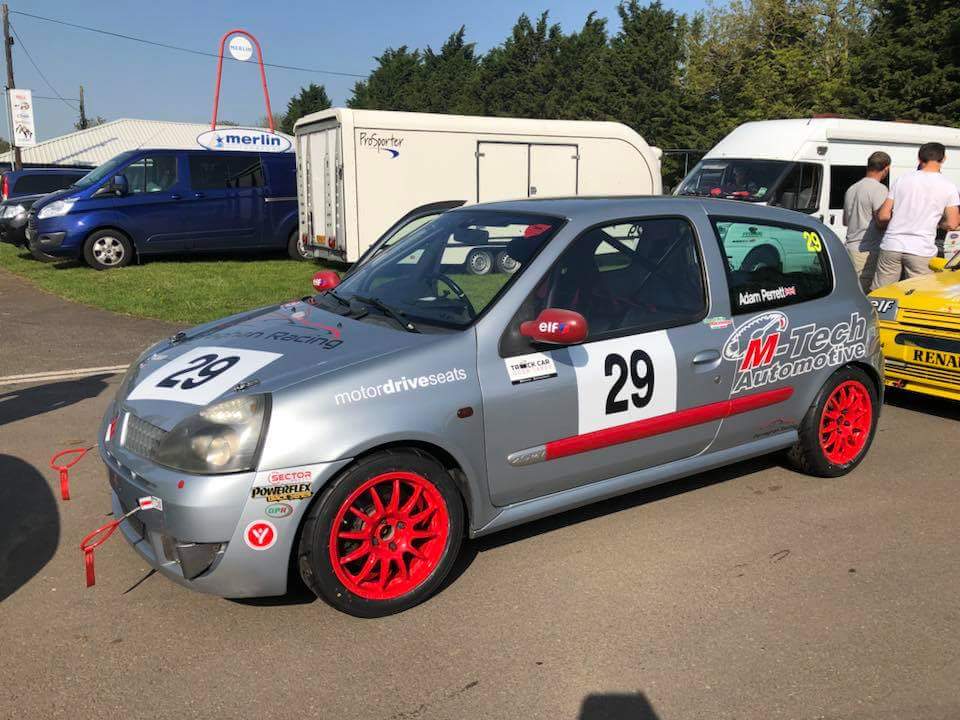

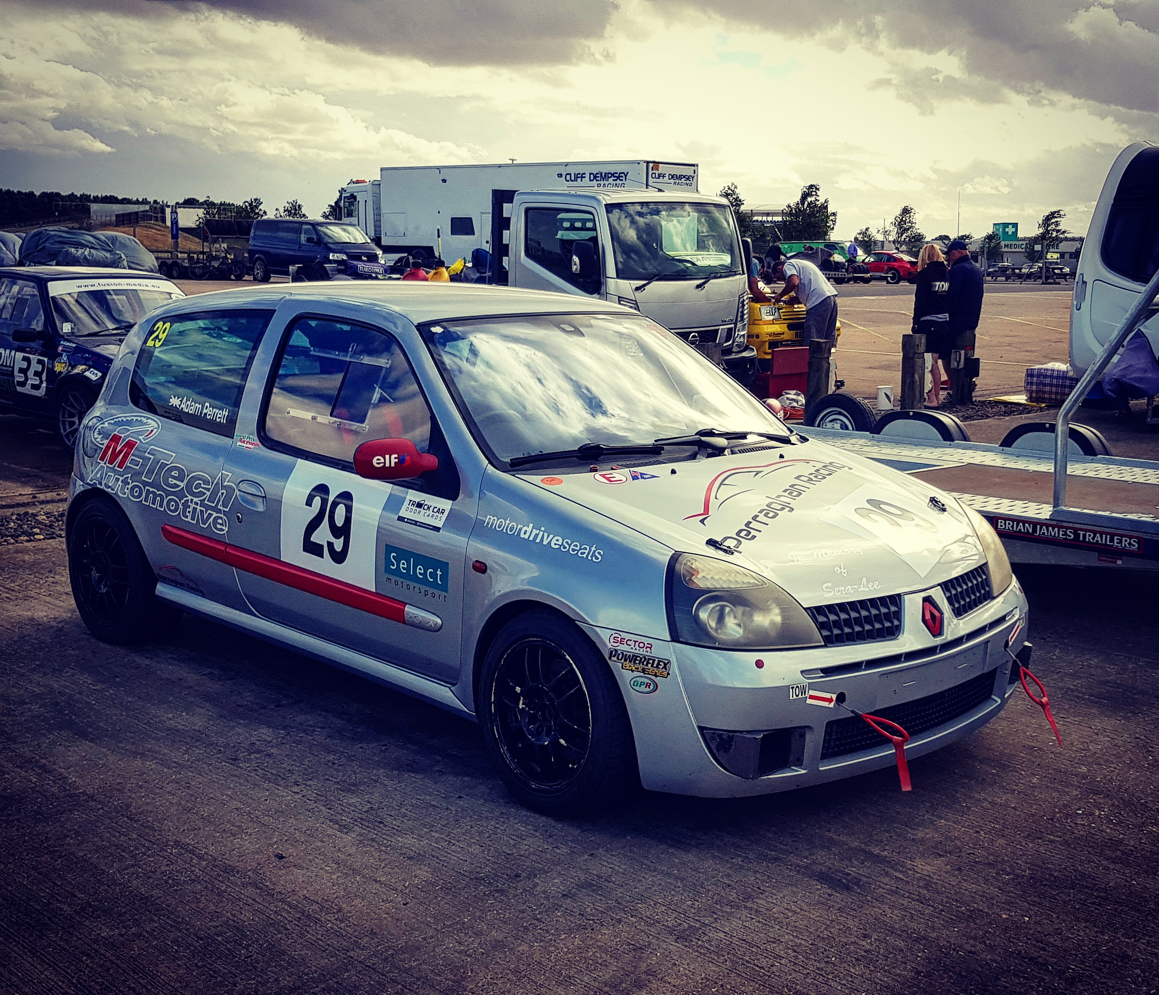

Silverstone weekend 28/29th July

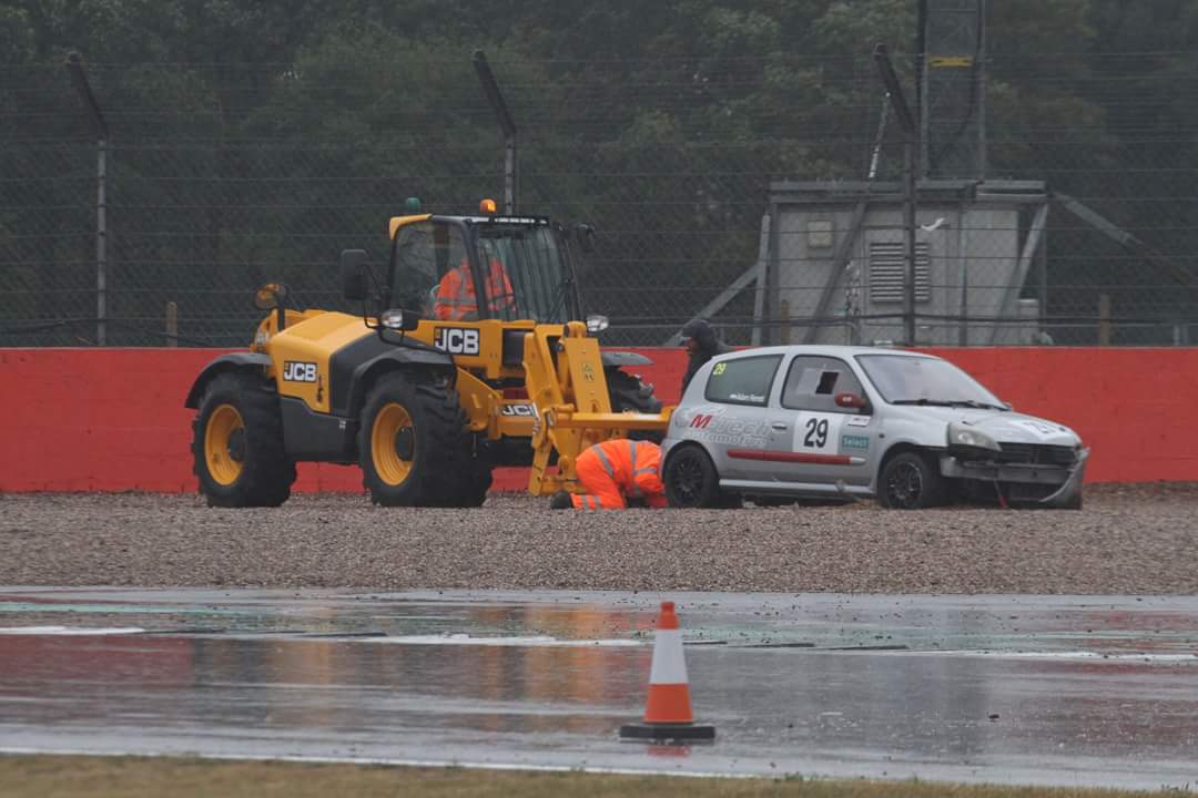

Where do I start with this one? I've never set foot around Silverstone so I was both excited and a little nervous for this one. With the ever changing weather forecast getting progressively worse as the days ticked round it became obvious that we'd be getting wet ;)
So we arrive Saturday afternoon to a sunny but windy circuit, managed to get signed on and scrutineered to save a bit of time for the Sunday, tucked the car and trailer up and headed off to the luxury of a hotel as I had the wife with me.

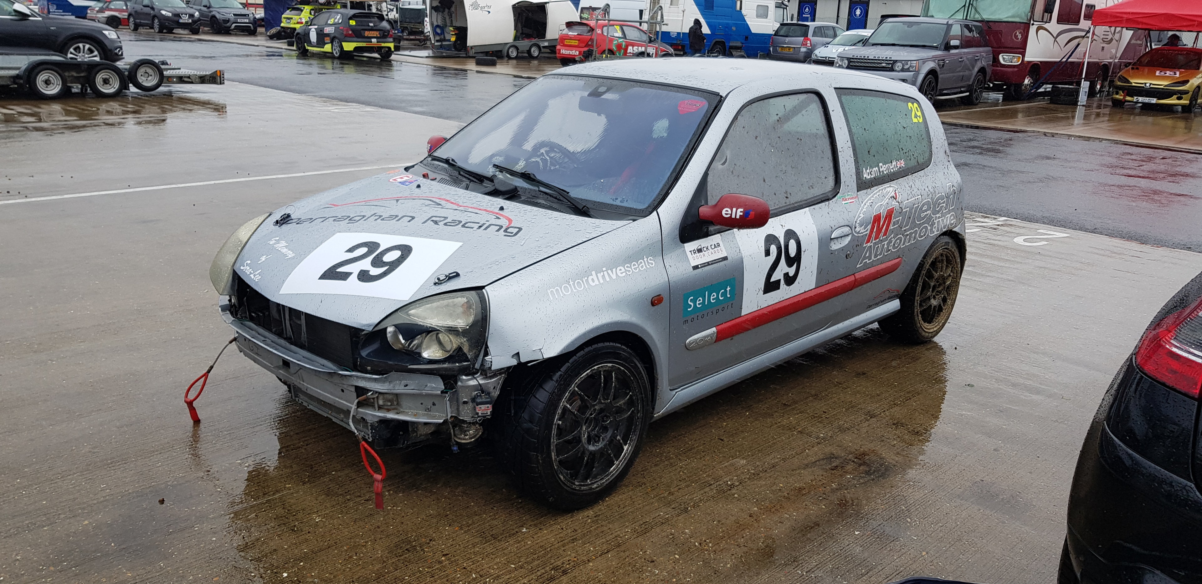

We woke up Sunday to a wet start, and that only got wetter and windier as the morning continued, headed out for qualifying with the usual plan of get 3 laps in, find a little bit of space (not easy with a big grid) and then start to push on a bit, the circuit was absolutely soaking with very little grip but I have always enjoyed the wet so wasn't too worried at this point.

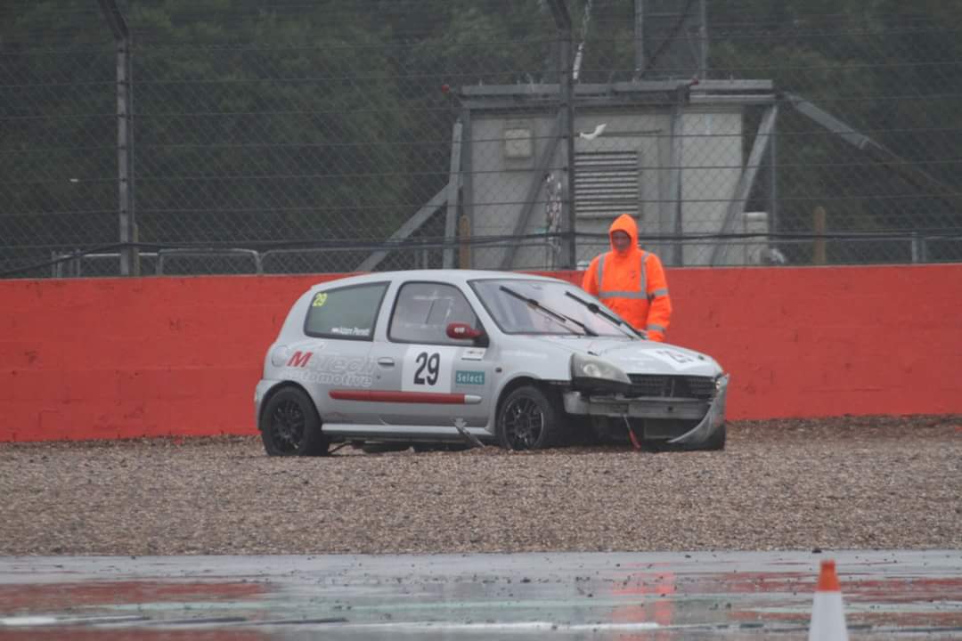

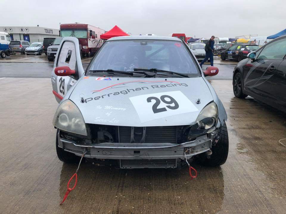

So I get going, try to find what little grip there was, picking up a bit of time lap on lap for 5 laps and then on the 6th 'disaster' strikes, the back end washes out under braking for the entry to Becketts, cue a trip across the grass, make contact with the wall and finish up in the gravel trap. Qualifying over just as I was starting to get into a rhythm, had to be dragged out and came back to the paddock on the back of a lorry.
To add I suit to injury I just happened to drop right in front of the cameras too, so there's no hiding lol.
Can be seen here at 22 seconds in
Back into the paddock and with 4 hours until race 1 we were confident of at least getting back out. A couple of hammers quickly made work of the cosmetic damage to the crash bar, allowing the panels to go back on curtosey of a lot of cable ties and gaffer tape.
Qualifying results come around and we're 19th of 38, mixed emotions as I did feel there was more time to be had, but considering what had happened I couldn't be too disappointed overall.

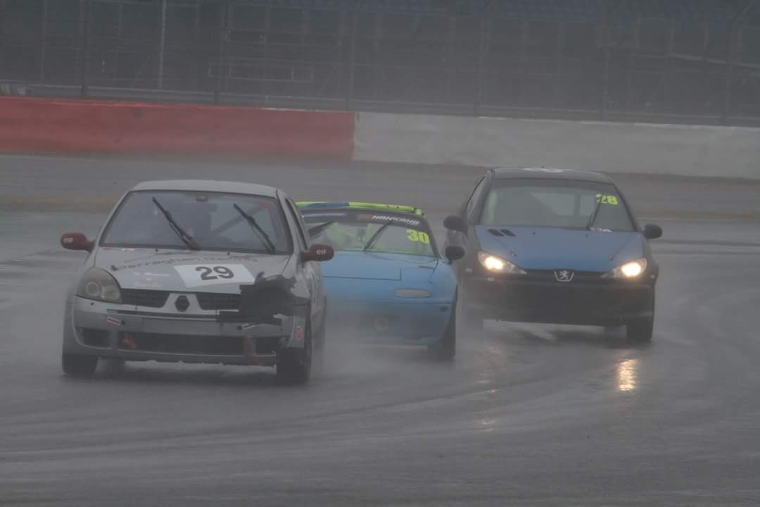

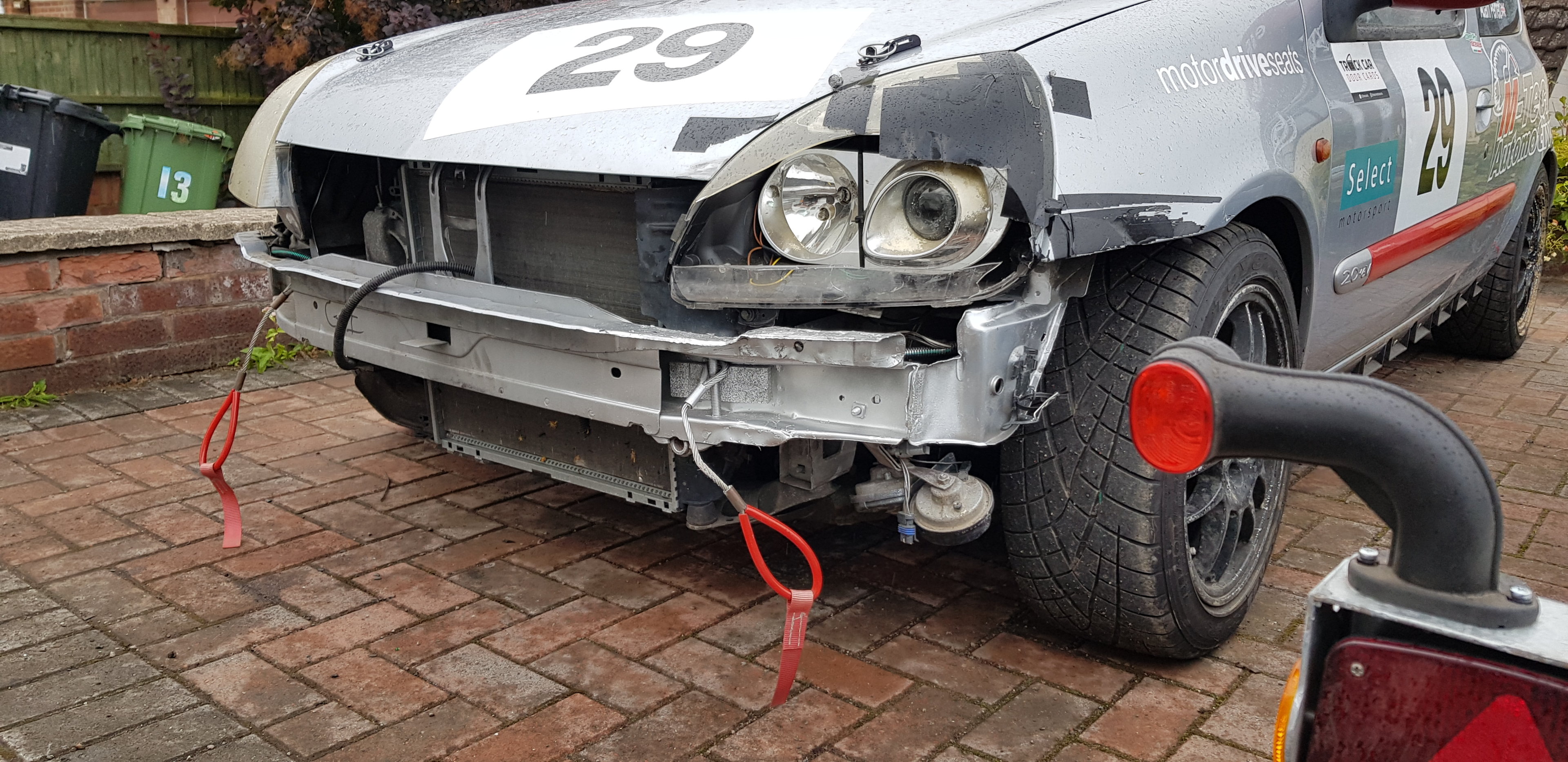

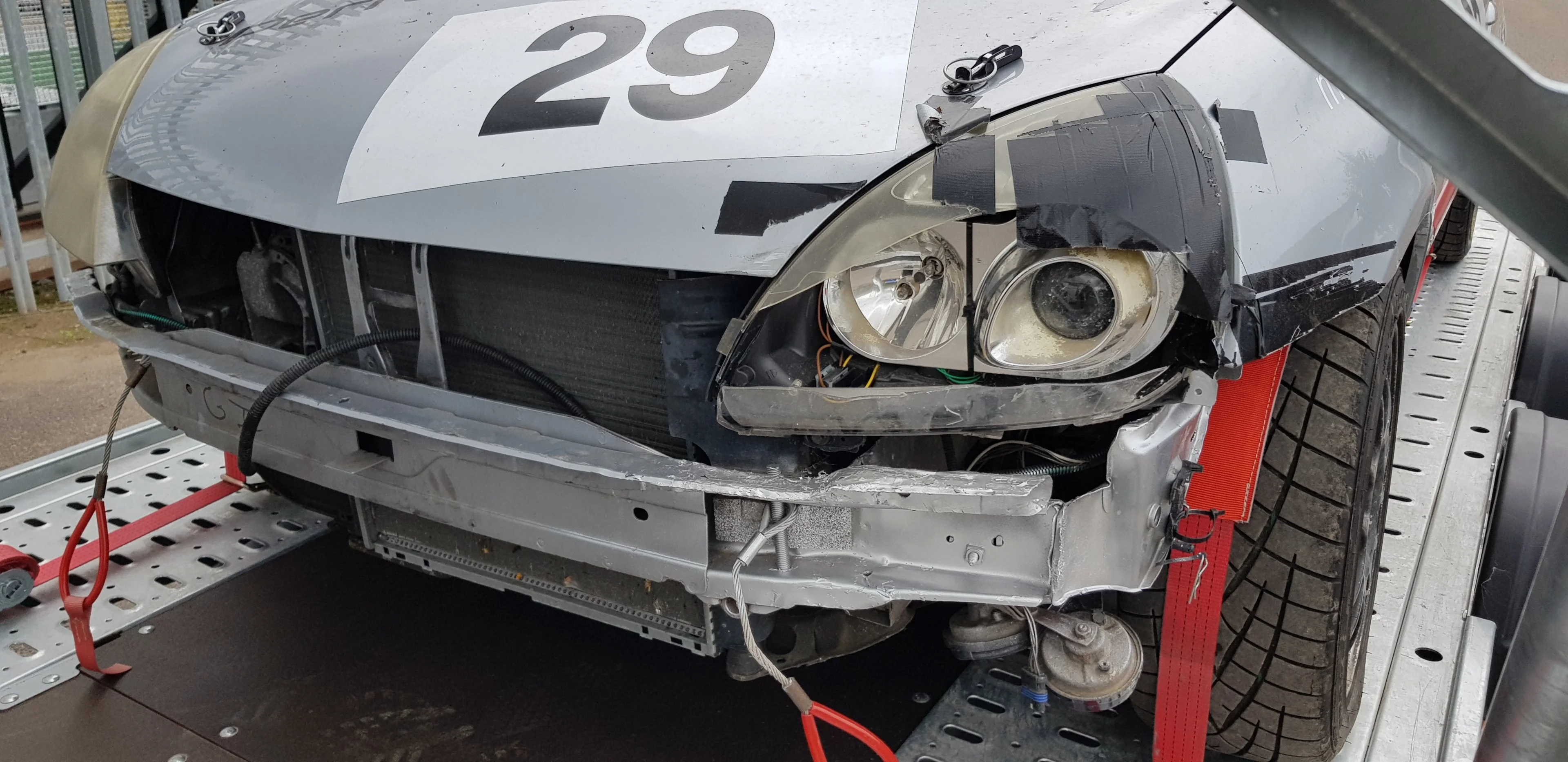

With our focus being on getting the bodywork back together we hadn't noticed the ABS light on until a few minutes before having to leave for the 1st race, so I decide to take the risk to go out and see how things go.
Line up on the grid and got the worst possible start, dropped quite a few places but eventually found some grip and away we went, car felt good for a couple of laps until the back washed out again, this time coming onto the start finish straight, the next lap the car just didn't feel right, brakes were all over the place so I decided to retire the car, and bring it home.

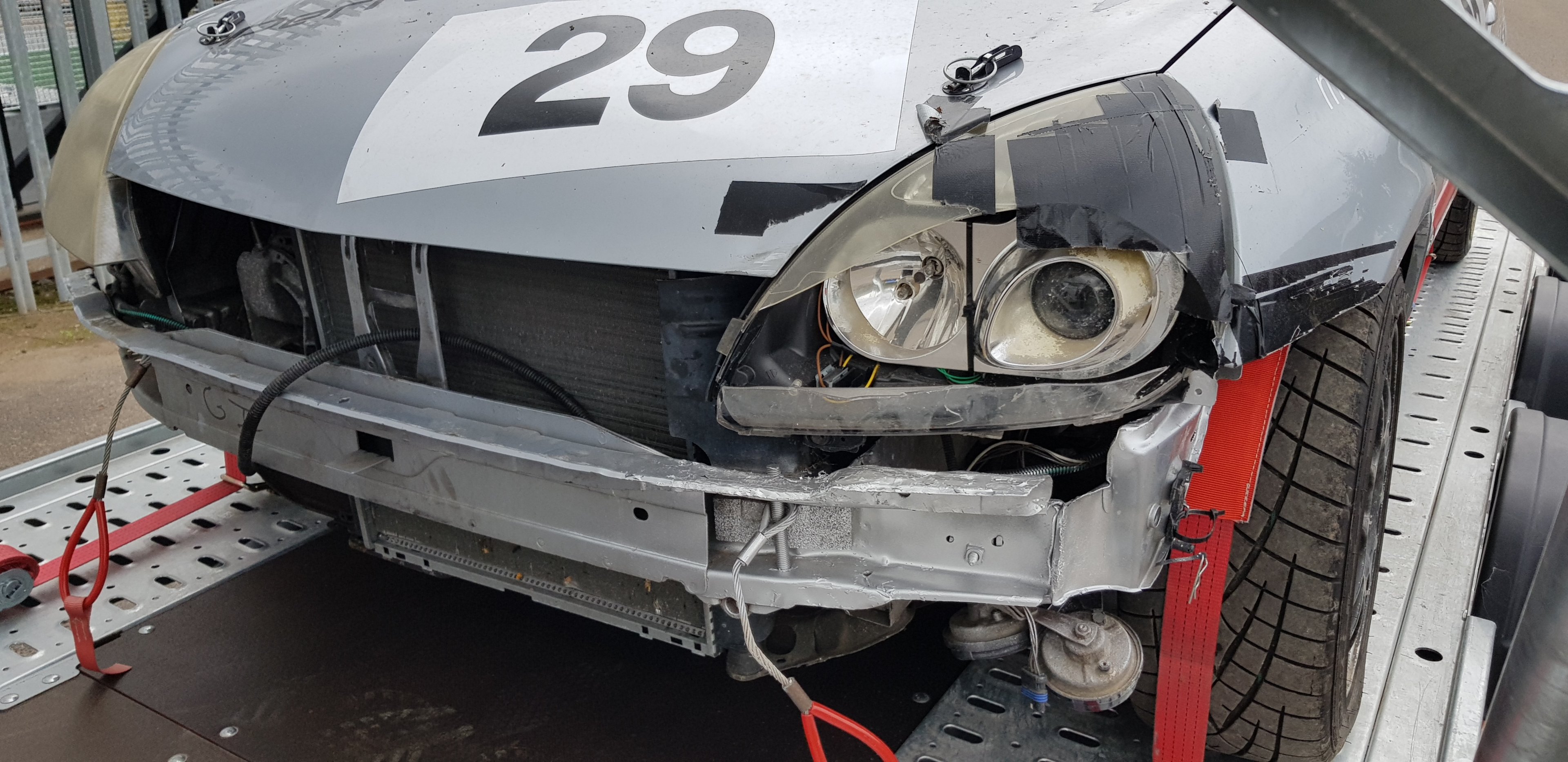

Not the best weekend all in all but a good learning curve, and plenty of experience gained.
The car is now in a local body shop having the front end damage straightened out (possibly damaged the chassis legs) and the ABS light is on as the rear sensor wiring is damaged, whether this was during the off in qualifying or before/after I'm not sure but it's time to remove the ABS system entirely.

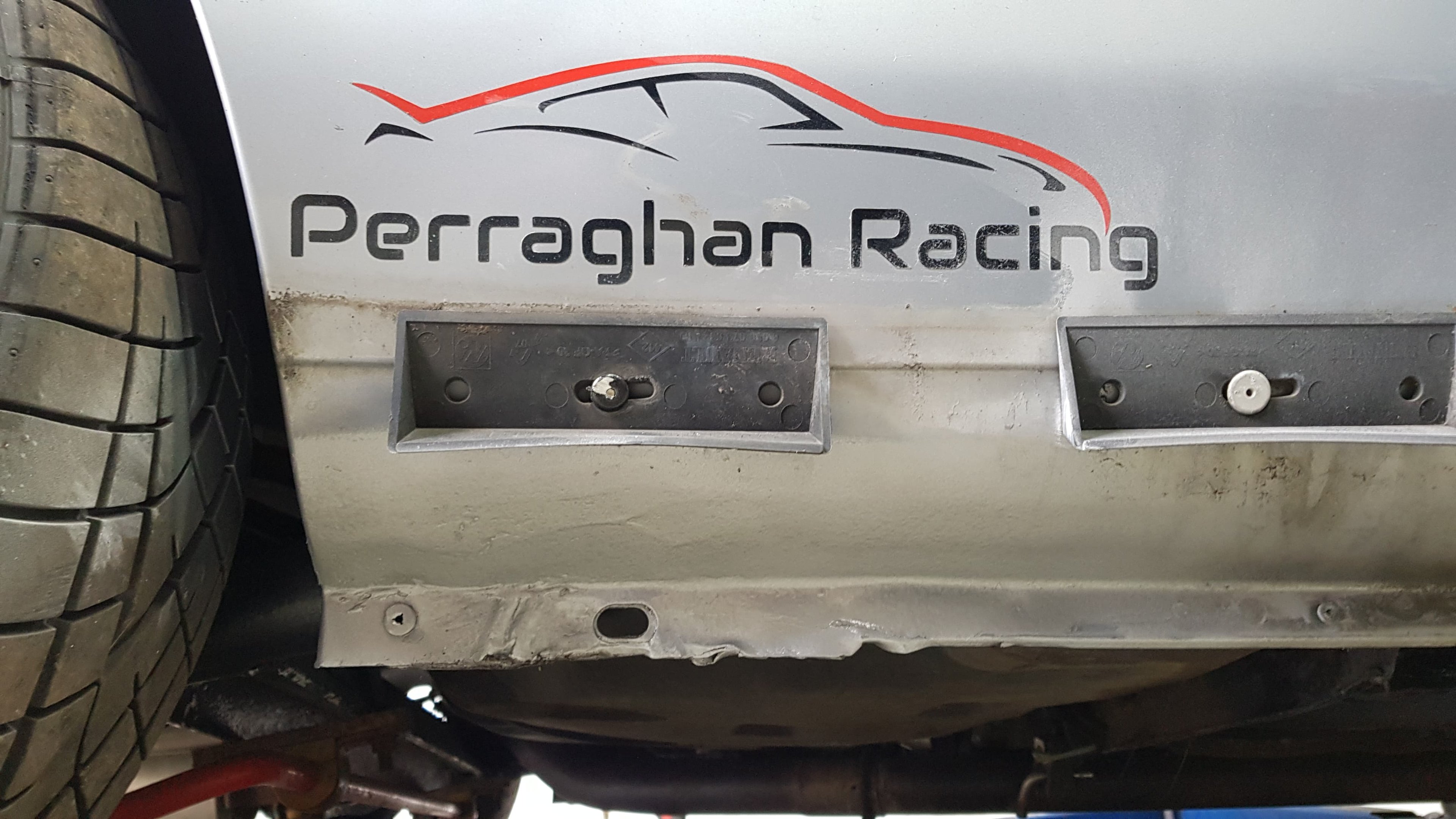

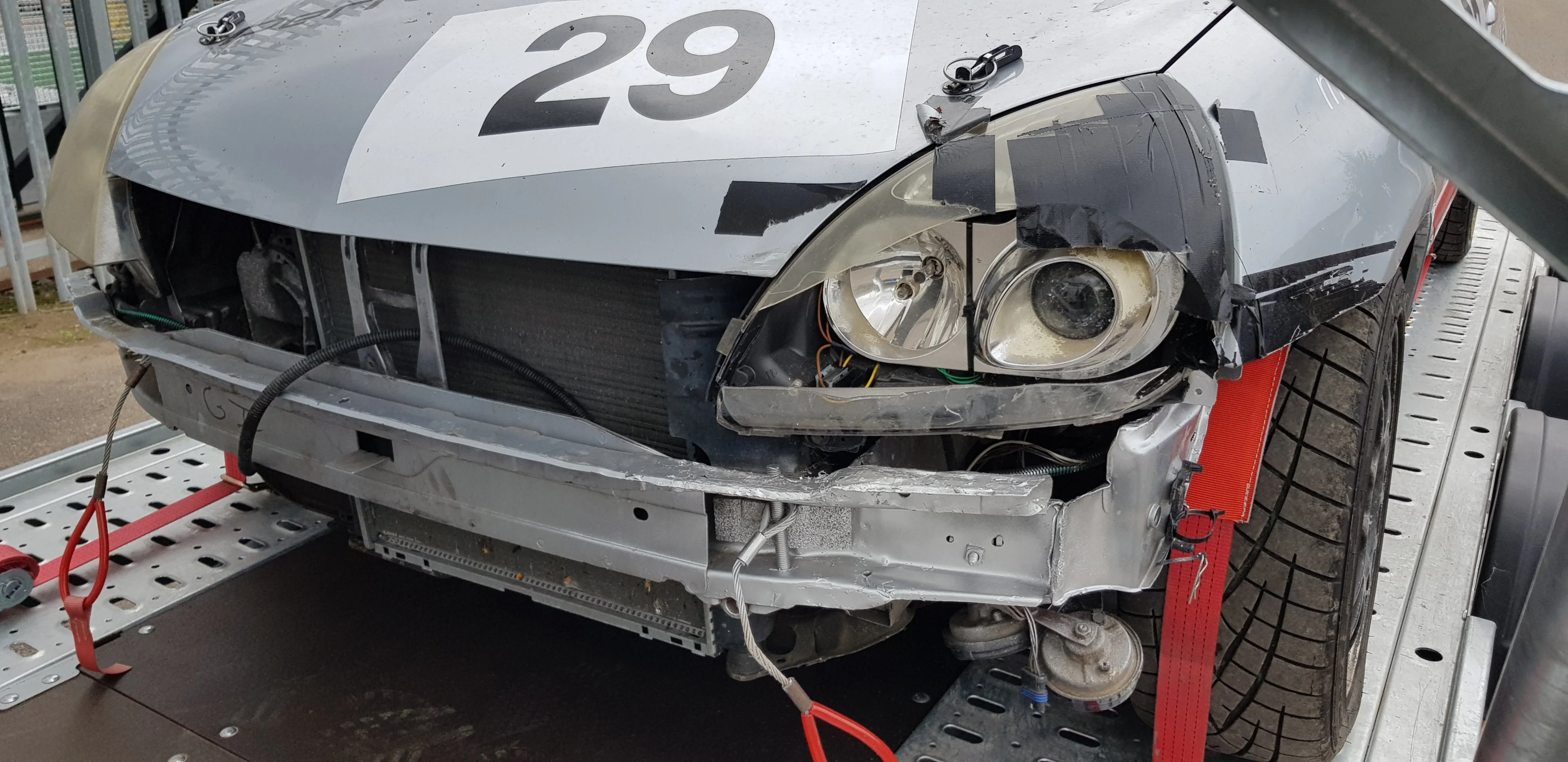

Following on from my last post we picked the car back up from the body shop with the front back in its correct orientation and looking much better, even without the new panels and lights?

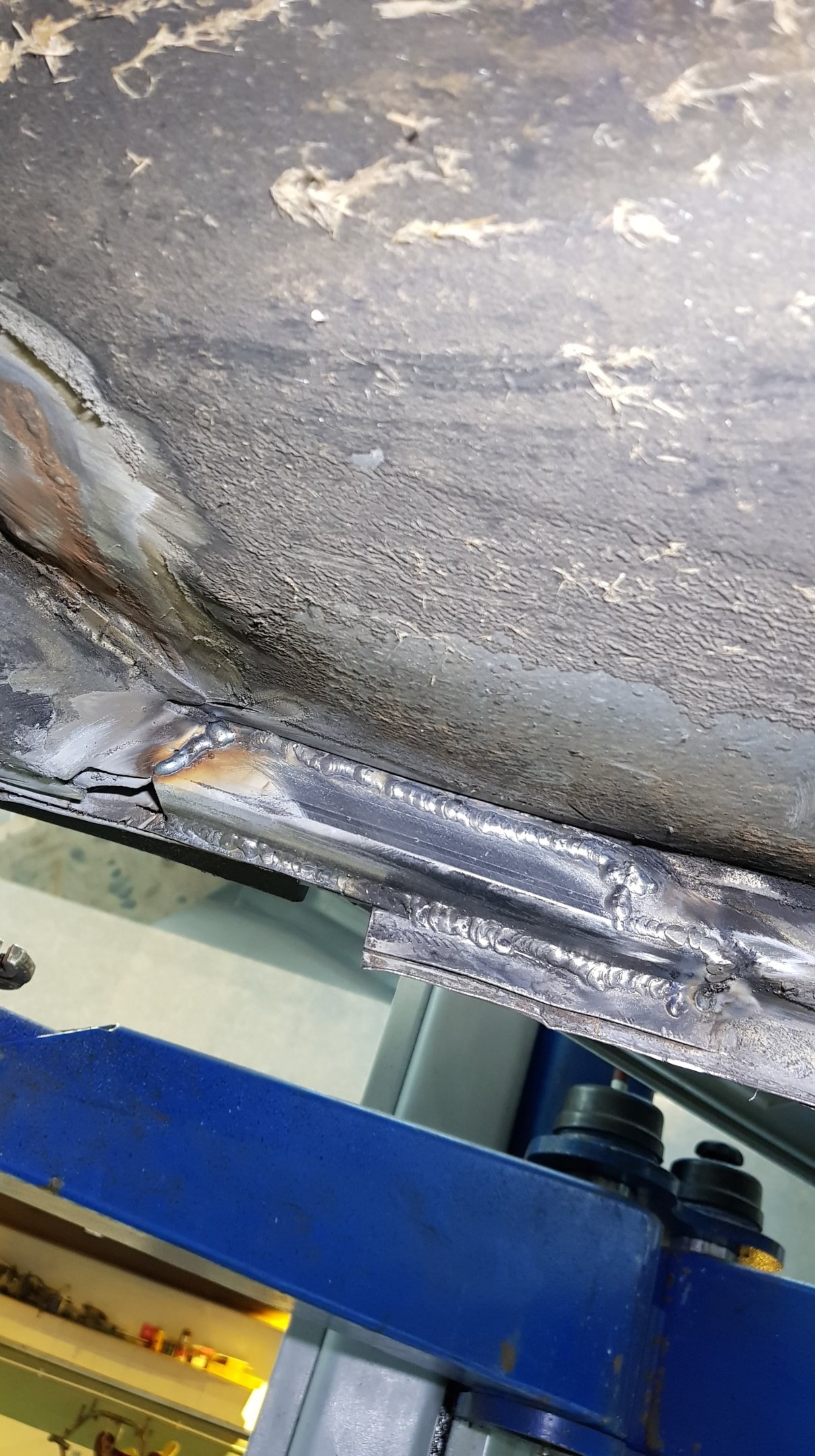

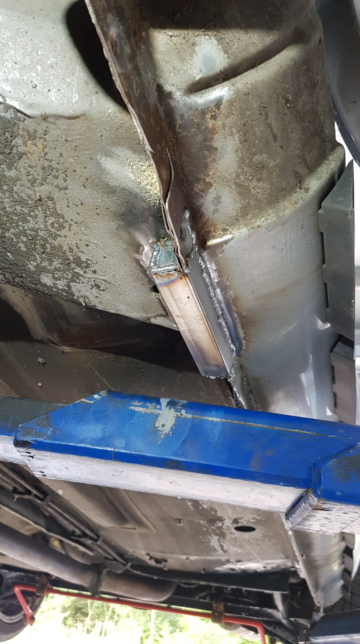

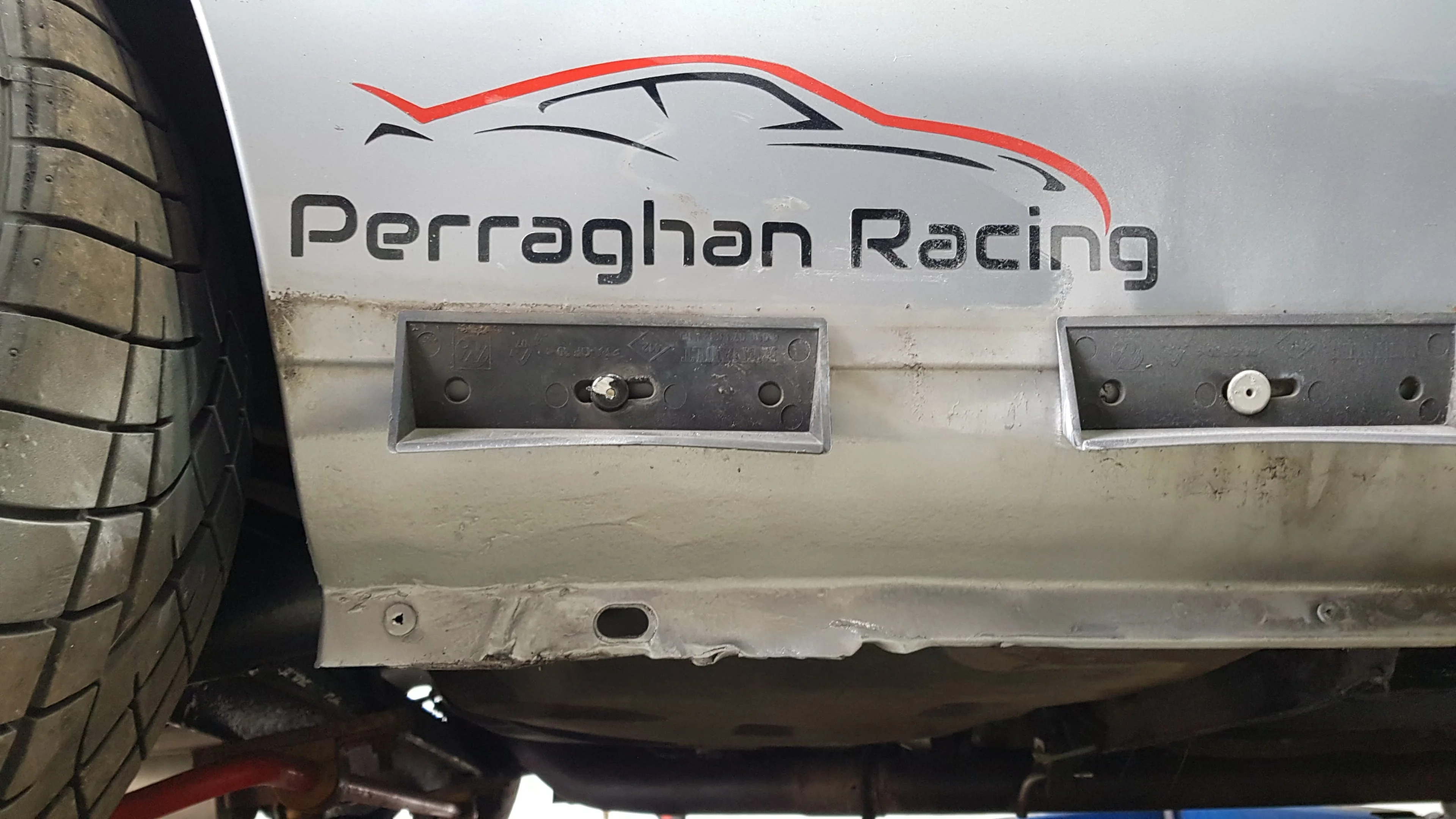

However upon closer inspection (when about to jack up) there was a noticeable dent in the o/s sill, no idea how long it'd been there or what caused it but there it was, took a closer look and right in the middle was a patch of soft/rusting metal ?? cue some messages to Matt @ Select Motorsport and a few days later the car was loaded up for the trip to Reading. Turned out to be a fair bit of rust in the o/s sill, very little of which was visible until some deeper poking and prodding had been done, so this had to be taken care of along with some planned welding/tidying up to the areas around the cage mounts and front jacking points.
Selection of photos below from the updates sent by Matt, can't emphasise just how pleased I am with his work, and can't recommend him highly enough either.
Due to pick the car back up on Saturday and then make a start on the brakes, currently waiting on a HEL brake line kit to go with a tilton bias valve, and a set of refurbed calipers to go on too.

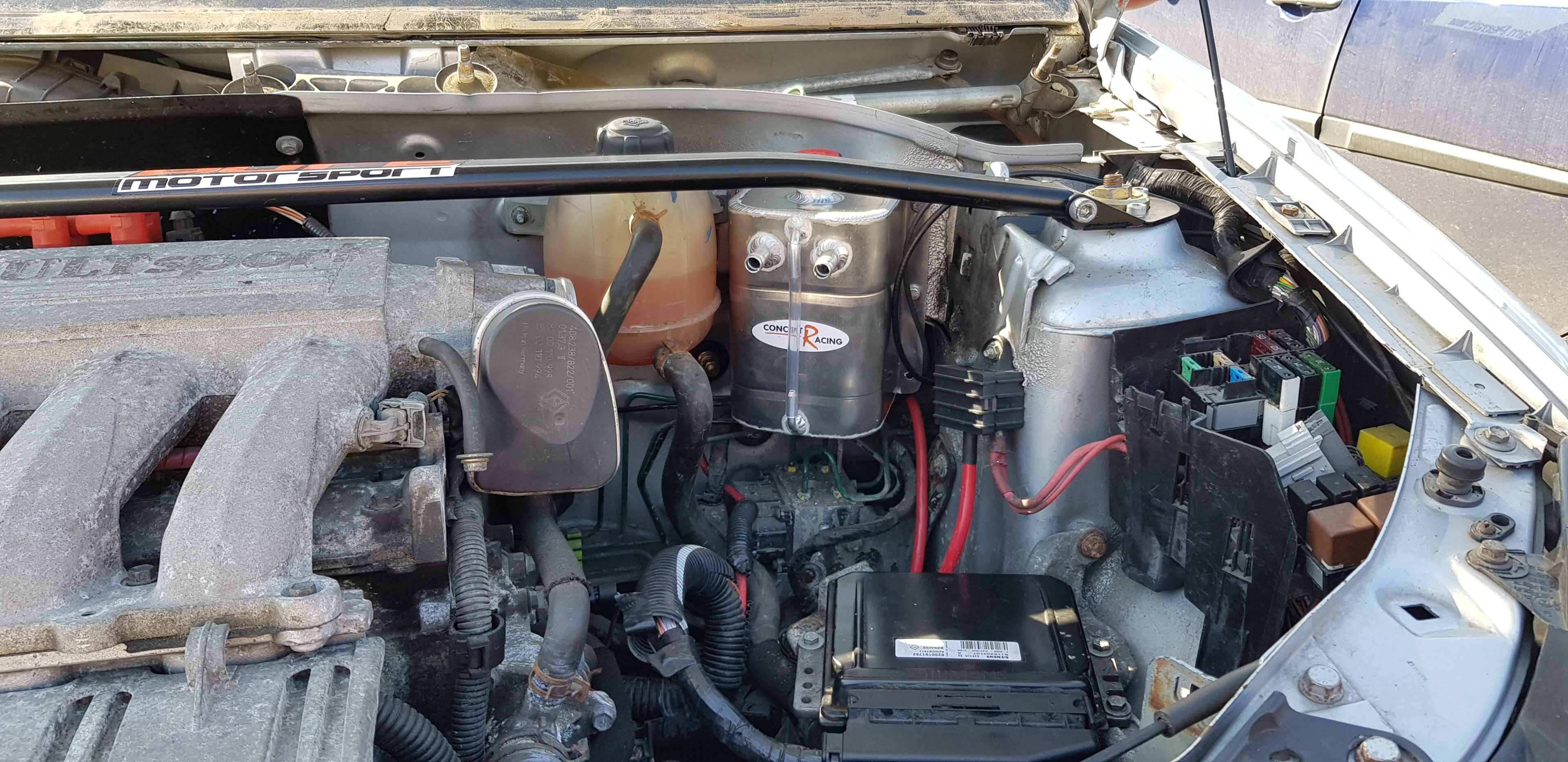

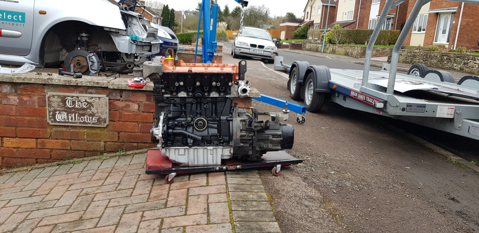

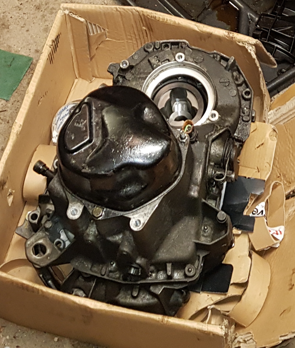

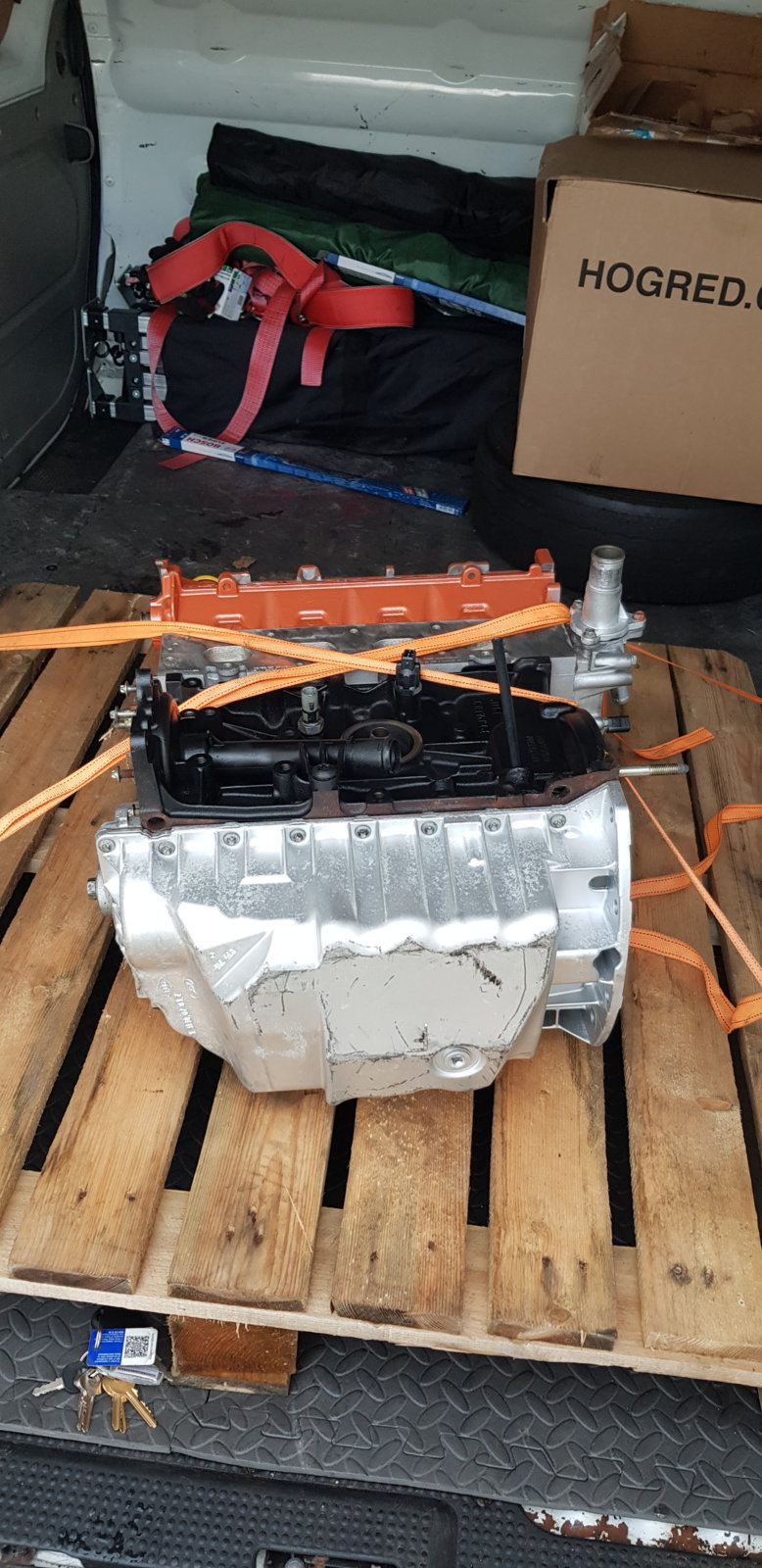

With the car home it was decided to pull the front end apart, remove the engine and box and go from there. The plan had been to strip, inspect and rebuild the engine and have the gearbox refurbed along with a shorter 5th gear ready for 2019, however we found a 'cheap' freshly rebuilt engine, well cheaper than rebuilding ours even with a trek to Manchester and back in the van, this allowed us to spend some more on the gearbox, so with some careful spending meant we'd also have a LSD fitted, a quick call and a gripper had been ordered.
It seemed silly not to upgrade a few more items whilst everything was apart so new engine mounts and a lightened flywheel where hastily ordered, along with a full service, cambelt, dephaser and clutch ready for the re assembly.

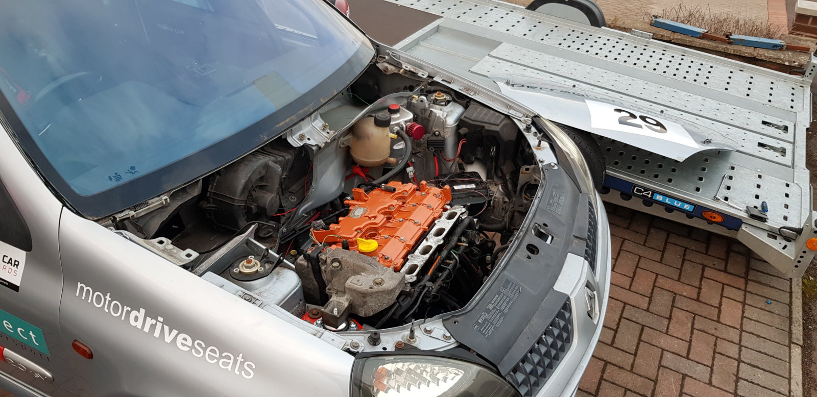

Winters up's, downs and inbetweens part 2. (Jan-Mar 19)
With the engine bay virtually empty it seemed the perfect time to get on with removing the ABS system, and replace with fully braided lines from Pro Line Motorsport, a Tilton internal bias valve and a set of refurbed calipers curtosey of Bigg Red.
Engine and box went back in in Early Feb with the extras previously mentioned, also took the opportunity to replace the injectors, leads and coil pack as there was still a slight misfire on start up of the new engine.

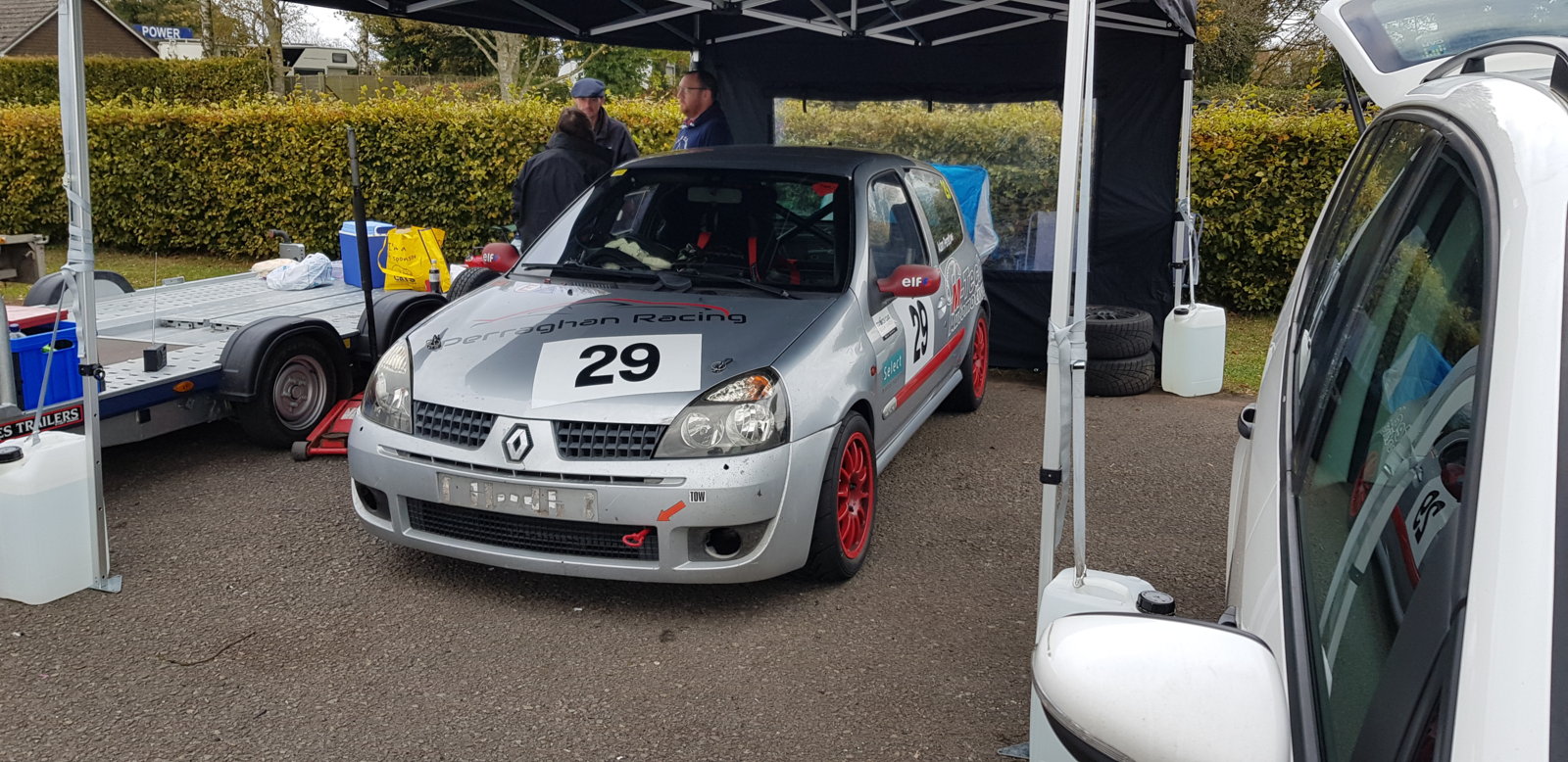

Cue early March and trip to Llandow for a afternoons shakedown and then onto Castle Combe for a proper run on a track day, finally some clean trouble free running to re learn the car with no ABS and start to get an idea of the difference of a gripper in the box.
Some unofficial timing pointed toward 1:21/22's but knowing there was plenty more to come the important bit was purely getting some time back in the seat after all our trials and tribulations
