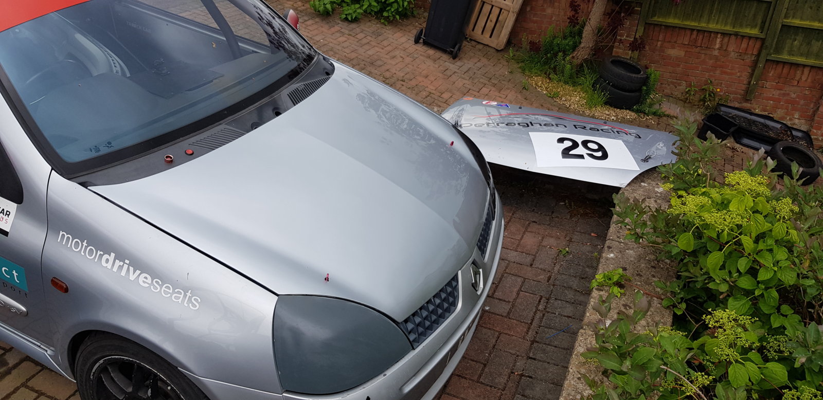

• Painting bonnet

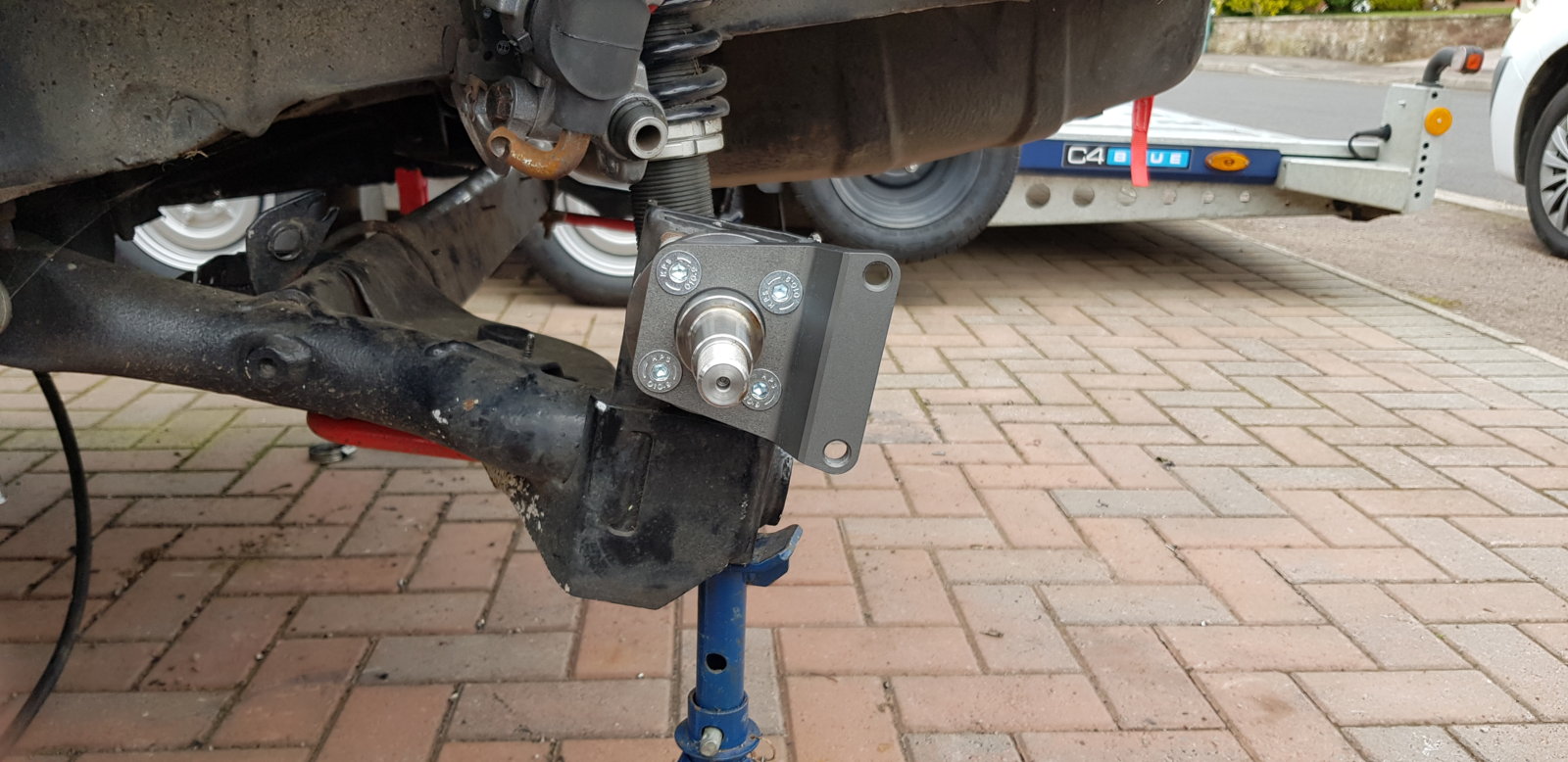

• Fitting PMS bullet rear axle kit

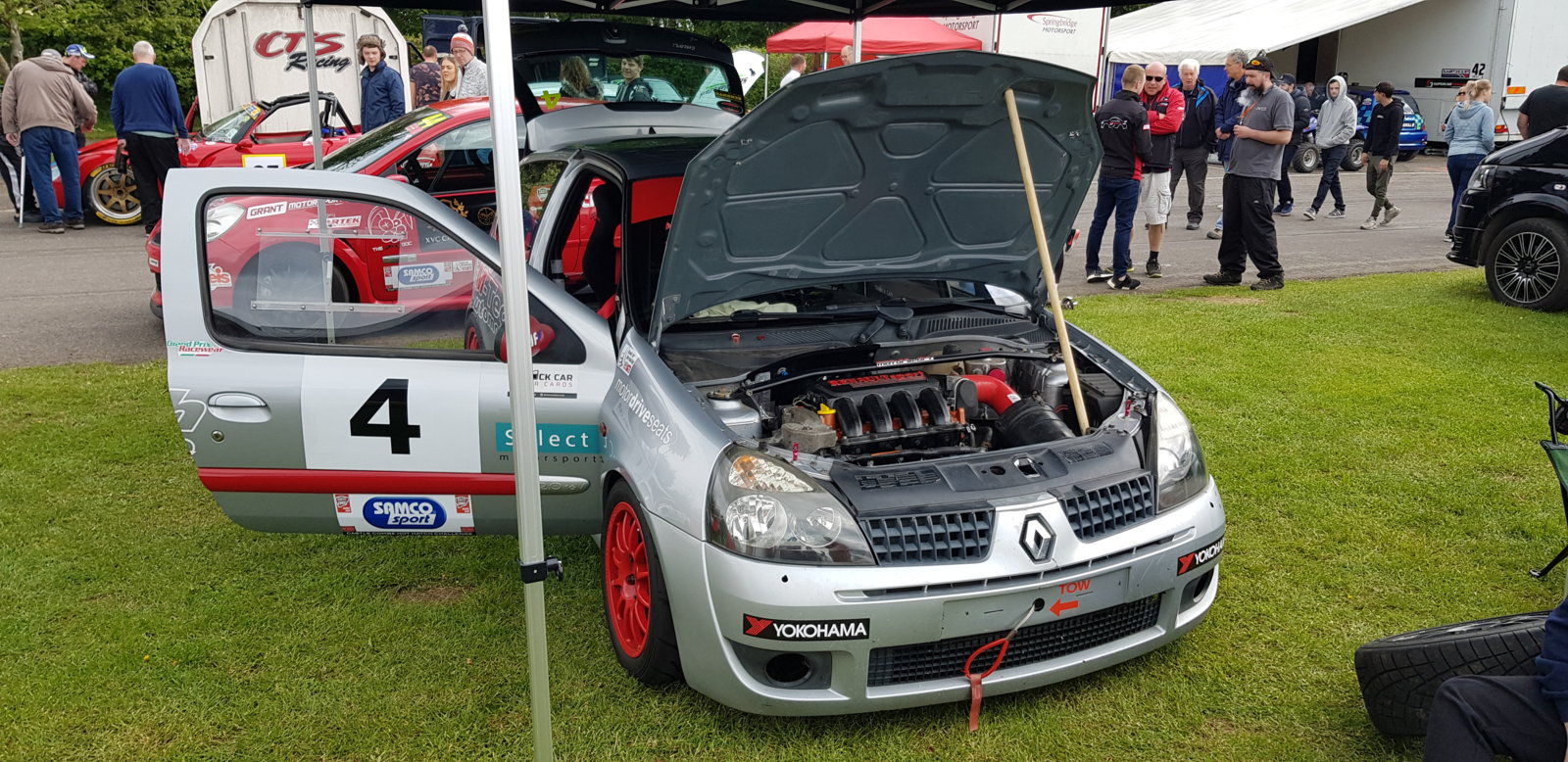

Normally we'd be rushing around trying to sort everything out last minute but for once the car was ready well in advance, so to save time and find a space in the paddock it was dropped off the night before the Early May bank holiday (May Madness as Combe like to call it)
Mon 6th May arrives and we set off for an early start, get the car prepared, sign on, run through scrutineering etc etc.

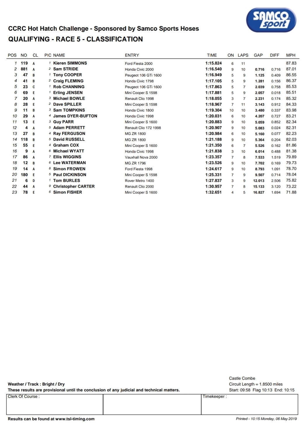

Half 9 arrives and we're called up for qualifying, a little nervous as again there were new untried/tested elements but the nerves soon settled as we drove out onto the circuit. The first 10 minutes flew by until we lost the throttle coming through Folly and onto Avon Rise (quickest part of the circuit), cruising into the run off at the first chicane gave me an opportunity to switch off and restart the engine, hey presto the throttle returns and we continue on. 3 more laps and the chequered flag is out, qualifying over and we're all eager to see what the times were.
A fastest time of 1:20.9 saw us take 12th of the 23 on the grid for the race, with some comfortable 1:21's to back up our previous non timed timings from track days.
To say we were all ecstatic would be an understatement, yes theres plenty of time to still be found but that's the fastest documented time I'd done, for me an achievement.

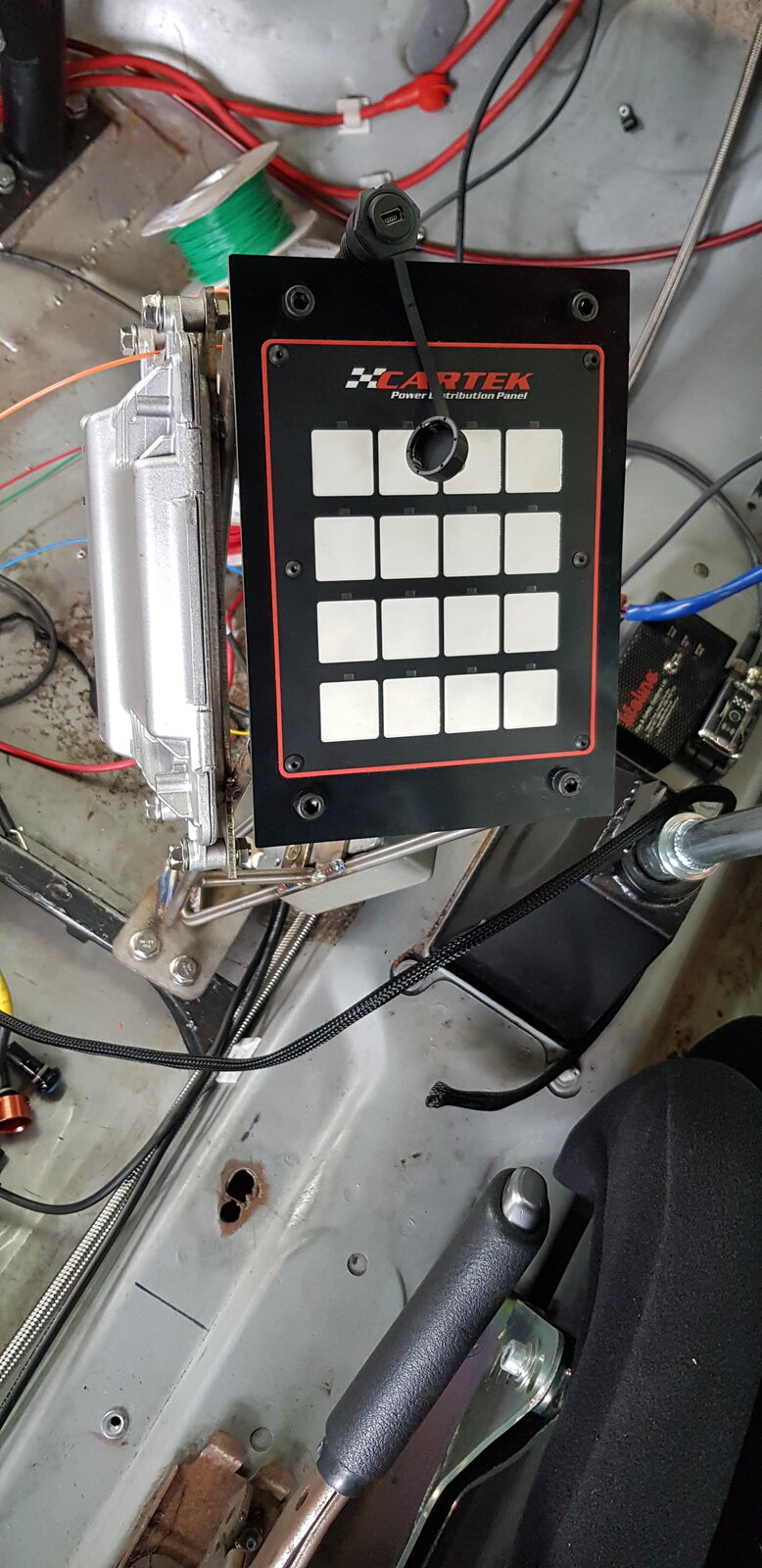

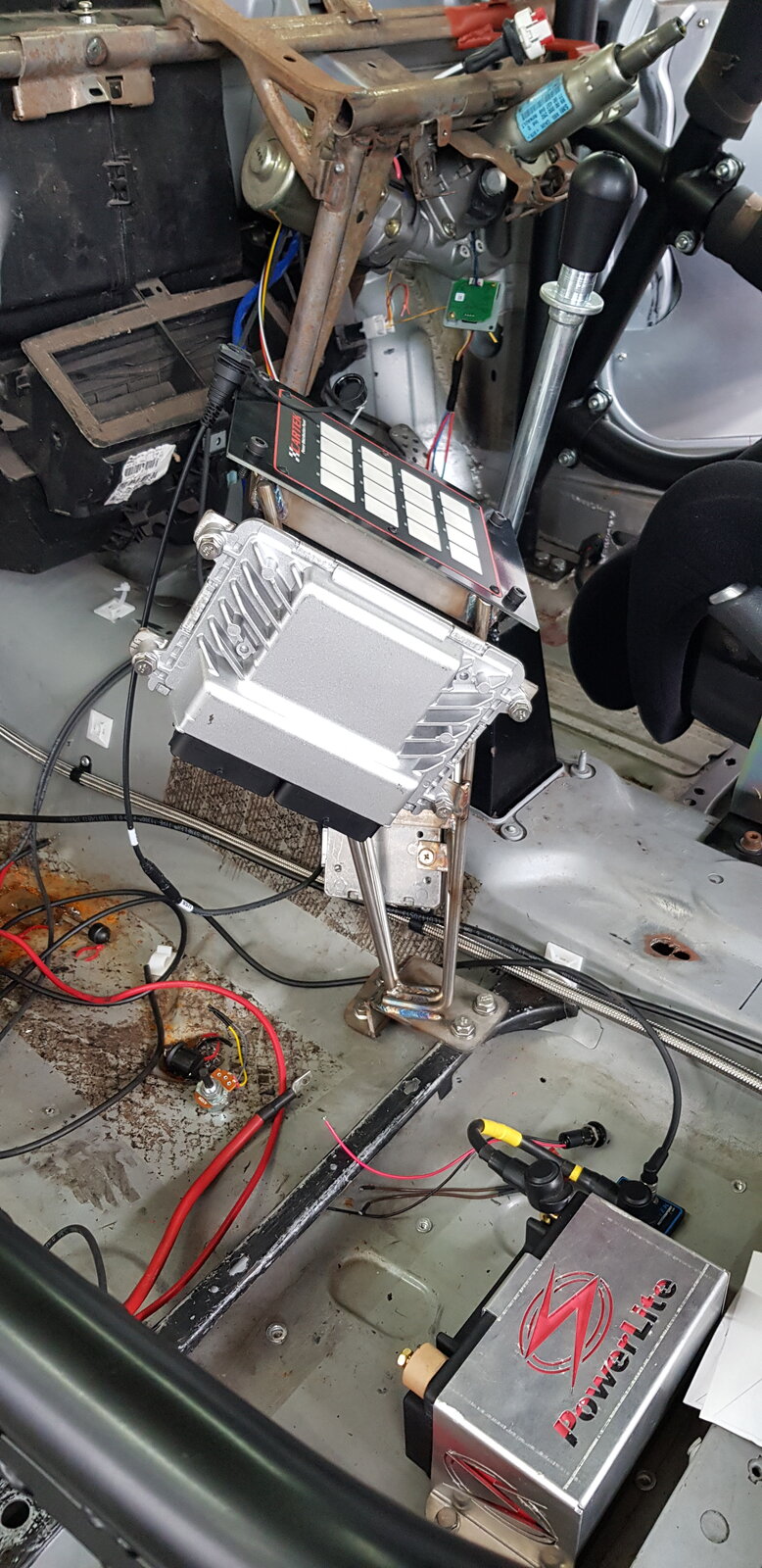

We got the car back, and left it on the trailer overnight whilst starting to think why/how/where something may have gone wrong, I should have mentioned in the last post that when the car refused to start the immobiliser light wouldn't clear, another had to be a wiring fault somewhere.
I spent the following day going through thread after thread and a few hours reading through anything else I could find online. Most of what is left of the loom was stripped apart, checking continuity, voltages, fuses, relays, anything I could think of without any success.
At this point I contacted one of the few people i trust to work on the car (I'm an ex Merc mechanic so 99% of things I do myself anyway) who ran through a few options, replacing the ECU and splicing into the existing loom, partial rewired or go big and replace everything, rip out all the original wiring and start again.

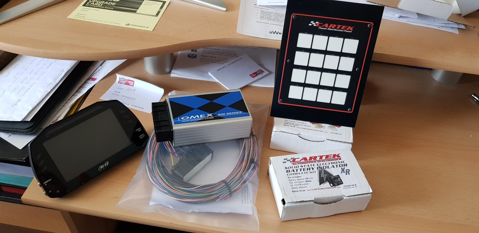

A chat with my wife and another phone call later we've spent a little over £3k on the major items for a complete rewire
To summarise our little shopping list
• Omex 600 ECU and semi assembled loom
• Aim MXS digi display
• Cartek PDP to run everything bar the ECU
• Cartek XR isolater
There'll be many more odds and ends to come during the rewire but at least the big bits are sorted
I'm in for a wait as the guy I use is busy, but the car will live again, and will be back out in a couple of months.

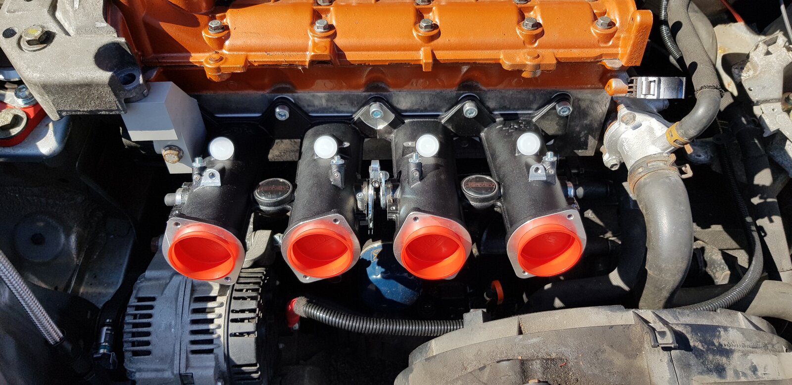

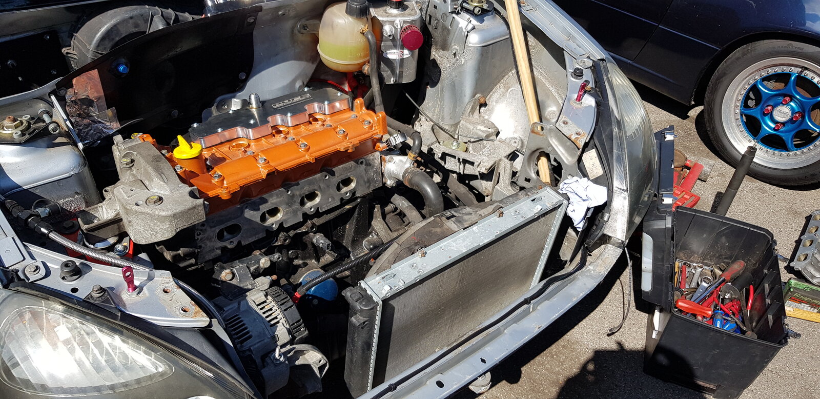

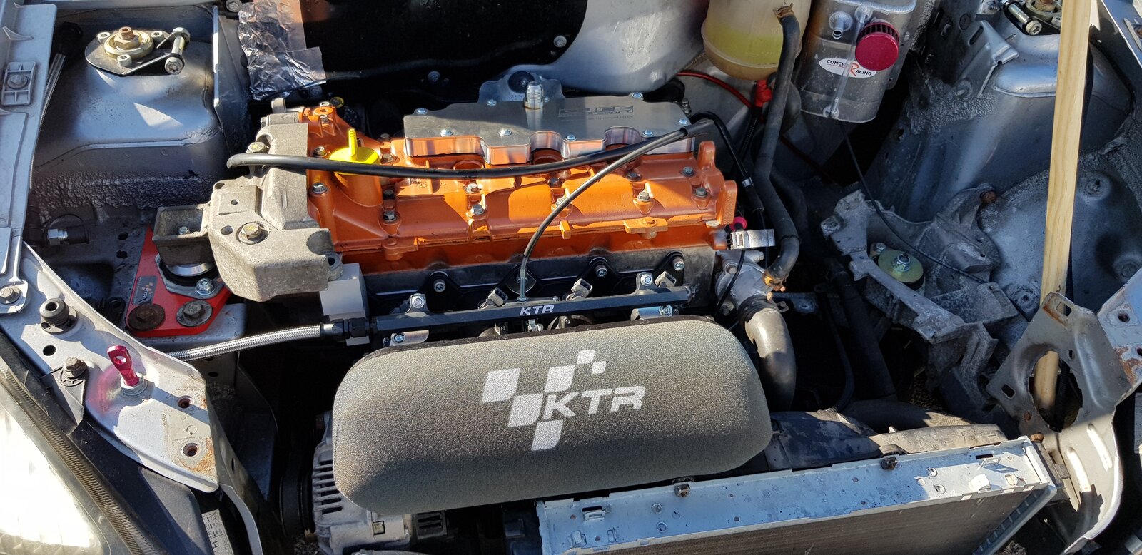

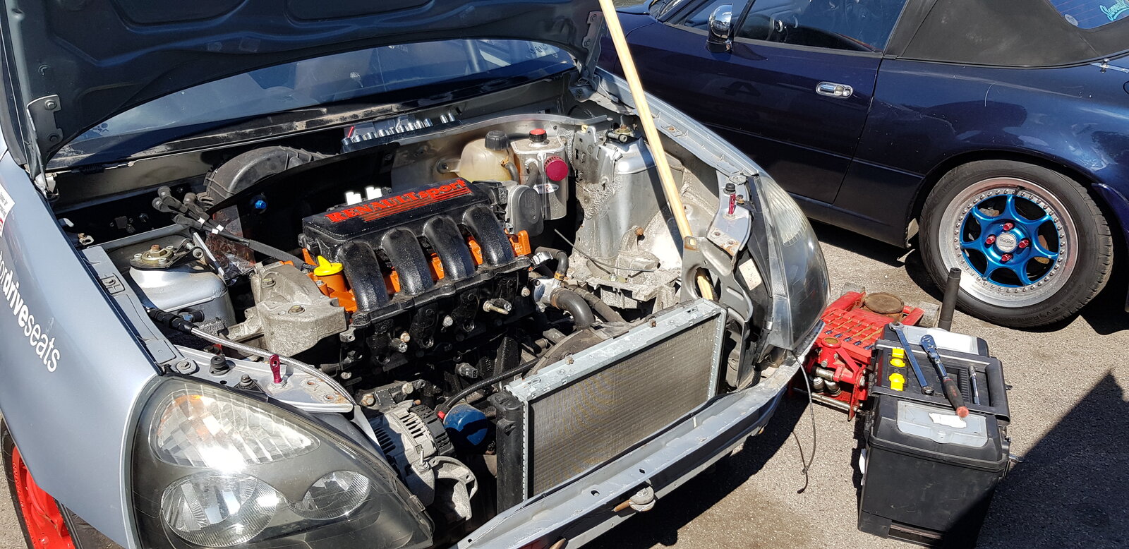

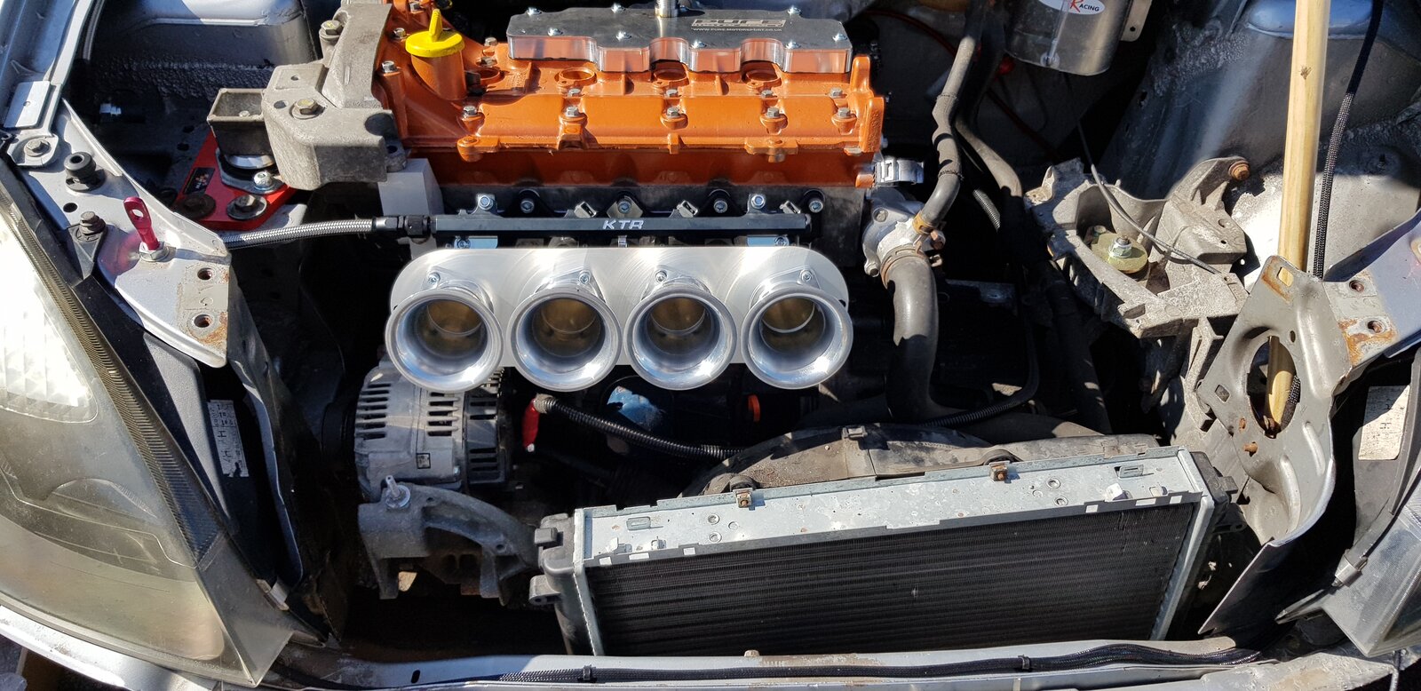

Another 3 months have gone by and yet again things have changed direction, thanks mainly to finally changing jobs, a different ecu and waiting for an engine loom to be made.
A friend of mine is one of the guys who runs Motorsport Electronics, and after a chat we decided to utilise one of their ME442 ECU's and use the car to design a custom loom.
I had originally planned to have this made to the spec of an original engine with some extra connectors to enable us to upgrade at a later date and then look at more power next year.
Due to the wait though it was decided to bump up the power now however and just build the one loom, so.....
From this
A couple of hours work in 30° sun 🥵🥵🥵
And the final result, minus setting up the throttle cable
Still need to order a new radiator setup from PMS when they re open from their summer break, and this engine is staying standard internally (bar some arp rod bolts) while I build a higher spec one over the winter, but it'll be interesting to see where we are once its mapped.
