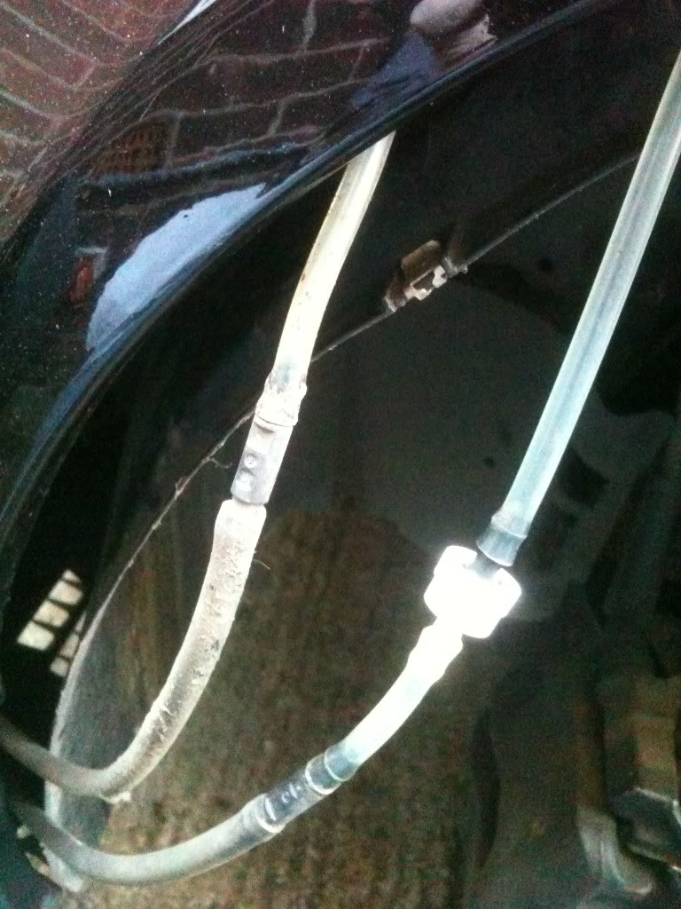

Browny - below are the washer pipes, pulled out from inside the arch liner. The arch liner itself down't have to be removed, just unbolted. The pipes are held in place by a little clip, that you should easily be able to reach with your hand.
The left tube is as standard. The right tube has the non-return valve fitted in place, for comparison.

Thats great mate, thanks a bunch
