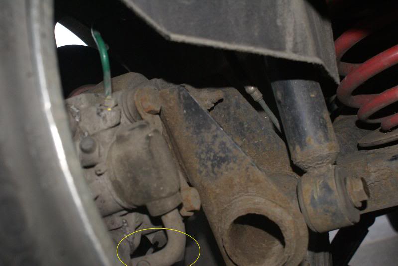

Renault will have me a new pipe tomorrow first thing.
Fitting it shouldnt be difficult TBH, got myself a 11mm spanner to remove it.
Ive since checked what you advised.
The handbrake "cable" that goes into the caliper;
Moves forwards/back freely when using the hand brake
However, when Hand Brake is off - I cannot pull the arm/cabe towards the back of the car any more,and the wheel may as well not move from the binding.
Discs should be here tomorrow too Ive researched bleeding and doesnt seem to hard, just need to identify the caliper problem and, of course, the fix.

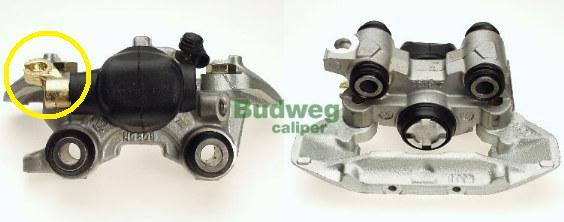

You can wind the piston back into the caliper using a flat screwdriver with care hooked into the slots and winding it back slowly.
Or try and get a hold of a wind back cube that you can fit onto your socket set ratchet and extension bar to make life easier, they should be easily found in your local car accessories/motor factor shop.
Heres what they look like, and the tab bits sticking out hook into the slots on the caliper piston you can see in the caliper picture below
