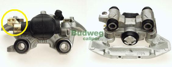

The handbrake "cable" that goes into the caliper;
Moves forwards/back freely when using the hand brake
However, when Hand Brake is off - I cannot pull the arm/cabe towards the back of the car any more,and the wheel may as well not move from the binding.
Discs should be here tomorrow too Ive researched bleeding and doesnt seem to hard, just need to identify the caliper problem and, of course, the fix.
