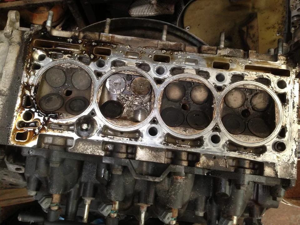

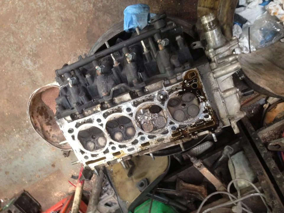

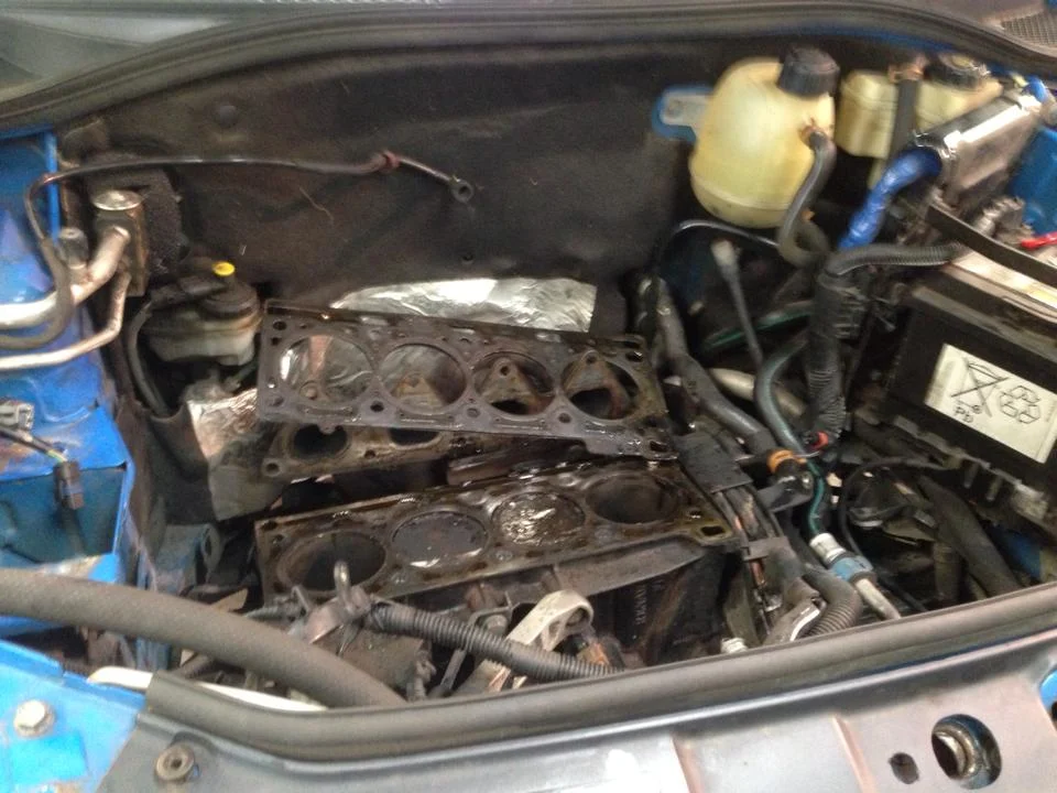

Ok so my car broke down, I got towed back to a garage and theyve had a look
this is the damage..
as good as fubar'd!
what are my options?

you said you had the belts done 3 weeks ago. who did the belts a renault specialist or local garage? imo it looks like timing has slipped and possible caused the damage

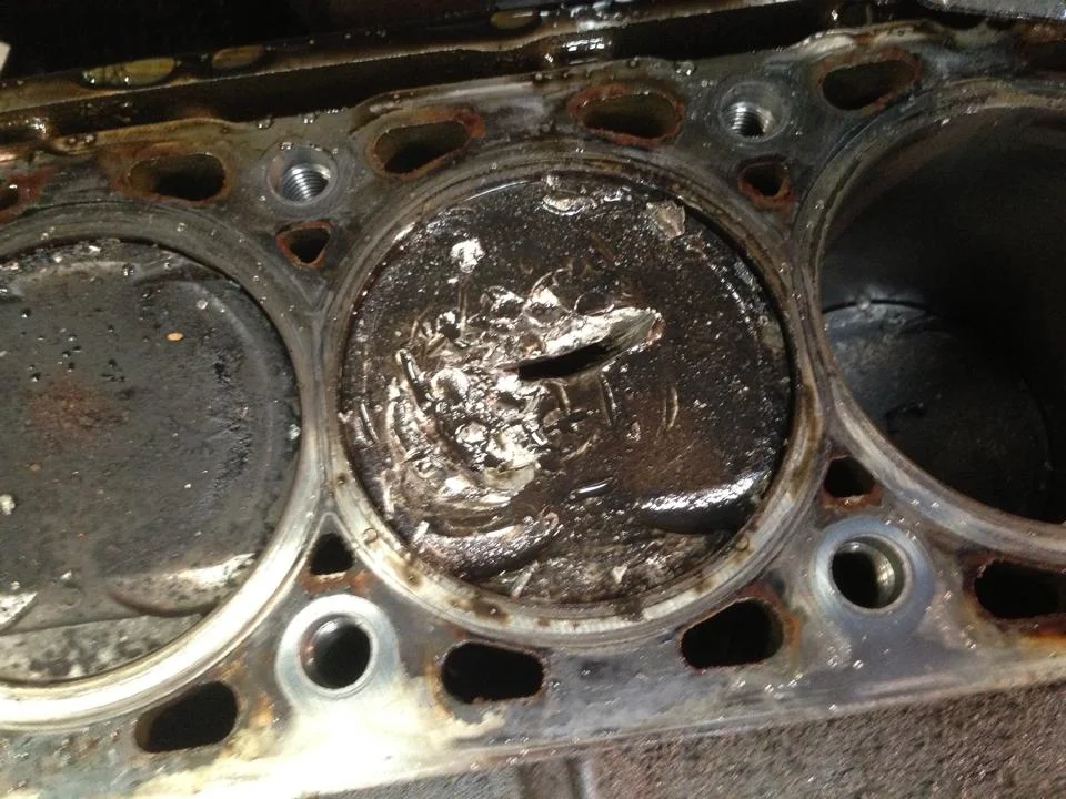

My money is on poor cambelt job. You can see marks on the pistons where the valves have made contact.

No, of course now that you have had a valve fail you wont get back what you put into it, much like if you buy a mirror and drop it you wont be able to sell the pieces for what the mirror was worth.
No good thinking at all about what you have spent previously as that is now in the past and gone forever, just have to decide where to go from here.
Personally I wouldnt repair that unless you bore it and fit new pistons as I would expect there to be damage to the bores with that amount of contact, so its a case of break the car, or source another engine for it.

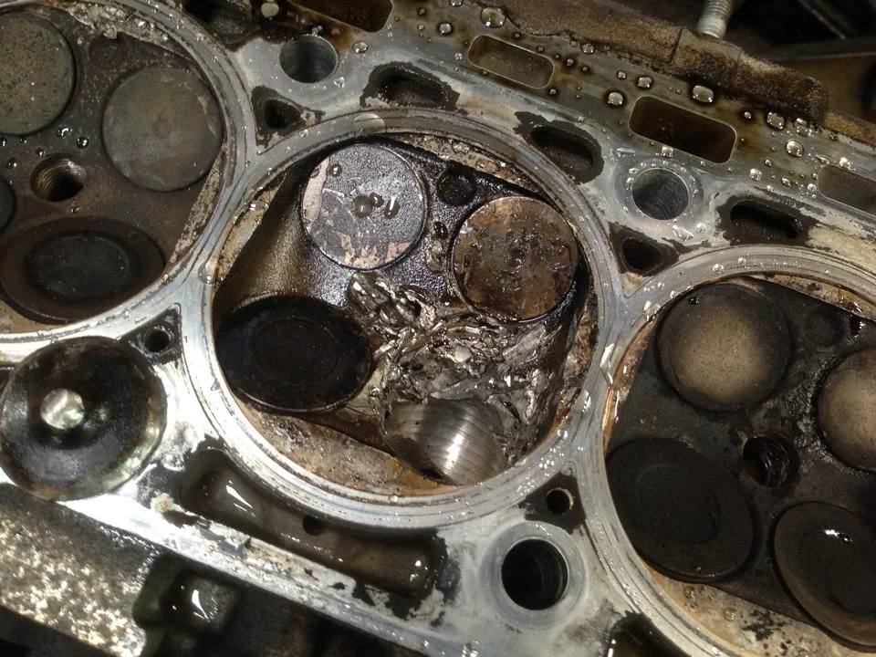

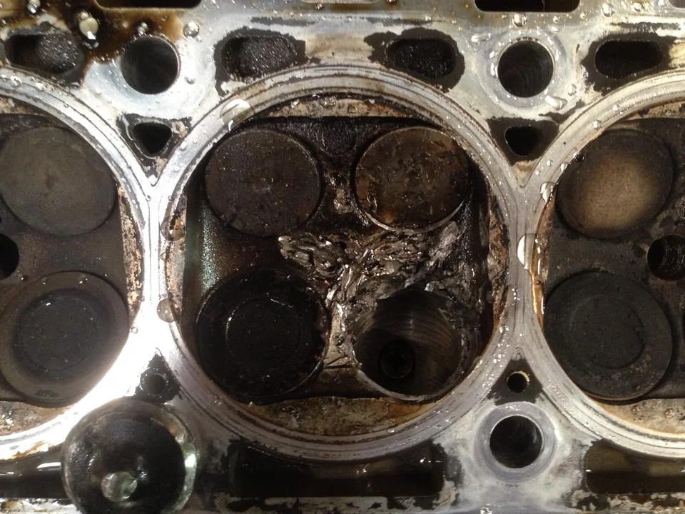

The valve cutouts on the piston adjacent to the cylinder with the failure do look to be shiney, which implies contact.
That said of course, the timing slipping could be a result of the valve failing, as it puts additional load on the pulley when the other valve gets whacked by a part of the failed one getting pushed up by the piston, so I would say its hard to be definitive its the timing, although like you say if it was rattling from the contact as soon as the dephasor became active then it would certainly imply that was the case, very little chance of proving it now though of course!
  Clio.
As chip says, a bit hard to prove..... But I'd say the contact in the other bores is more than likely consequential damage from dropping the valve in the first place, quite a common problem for valves to snap on these engines. Especially if its been revved hard when cold.
