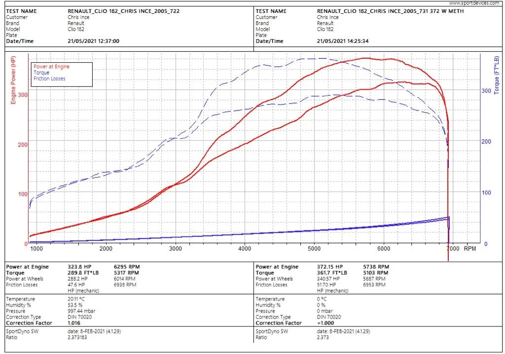

Mine isn’t dependent on meth, with it off I see 350hp with it on 372hp will run happily both on and off.. but actually cooler with it on!

Yes seemed too in my case, was quite surprised! Inlet temps dropped a lot

Megane RS 265 pistons and rods in Clio 182 block running 9:1 comp with a GTX2860R gen2 turbo, 630cc injectors with Gen90 ECU.. etc etc
Andy from Phoenix automotive technologies in Dorset, the main man with Gems/gen90 [emoji106][emoji106]
