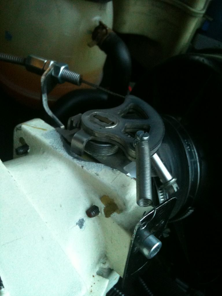

Found a potential issue. The touring car body keeps sticking about a mm open. Not sure why, but its when warm. It's not the cable as it does it when manipulated by hand. Could it be the main spring or the fact the return spring isn't very good?
  DON'T SEND ME PM'S!!
Get a shorter spring that's still under tension when the throttle is fully closed. Install looks a lash up
What I did John was change the bolt holding the TB on with a 50mm set screw and fitted an angle bracket, this way you can adjust the tension as required, the spring needs to be running parrallel with the bolt and not at an angle as you have it, I don't think it helps that the throttle plate is turned 90degs, as Dan said not the best fit, I'll be looking at doing a proper job myself over winter, just wish the throttle stops had'nt been cut as the plenum neck could have been machined from what I've seen to clear.

Not a problem, I still want the flywheel from you as well if you still have it ? forgot all about that tbh, I'm not sure what weekends I'll have free but send me a pm on available dates your free and I'll call across to yours, mines a temp fix untill I have a good look but it idles ok and does'nt over rev anymore, just a bit worried about what Dan said about the re-cal of the throttle pot for idle.
