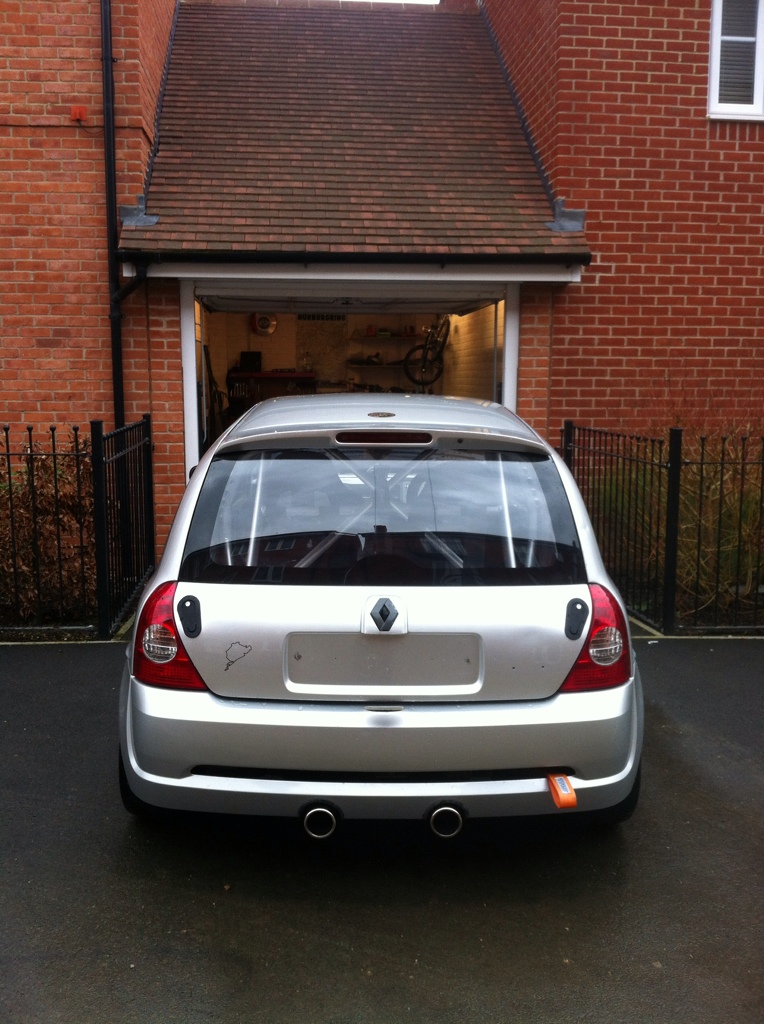

Open boot, remove the 2 rubber plugs (door stopper looking things). 2 holes perfect for said catches. :)
  182cup & 172 racecar
Trust you to fit them the opposite way to what I said. Well they obviously go that way aswell then.
So there you go.
  TrackCar & F30 330d
Haha! I can't 100% remember but Areocatches don't fit sideways using the hole that I used! So I went up and down but my tale gate is pretty much a single skin and I had to use a rubber mallet to bash some of the tale gate flat so you can fit the screws in.
It can be done but have a good think about it first!

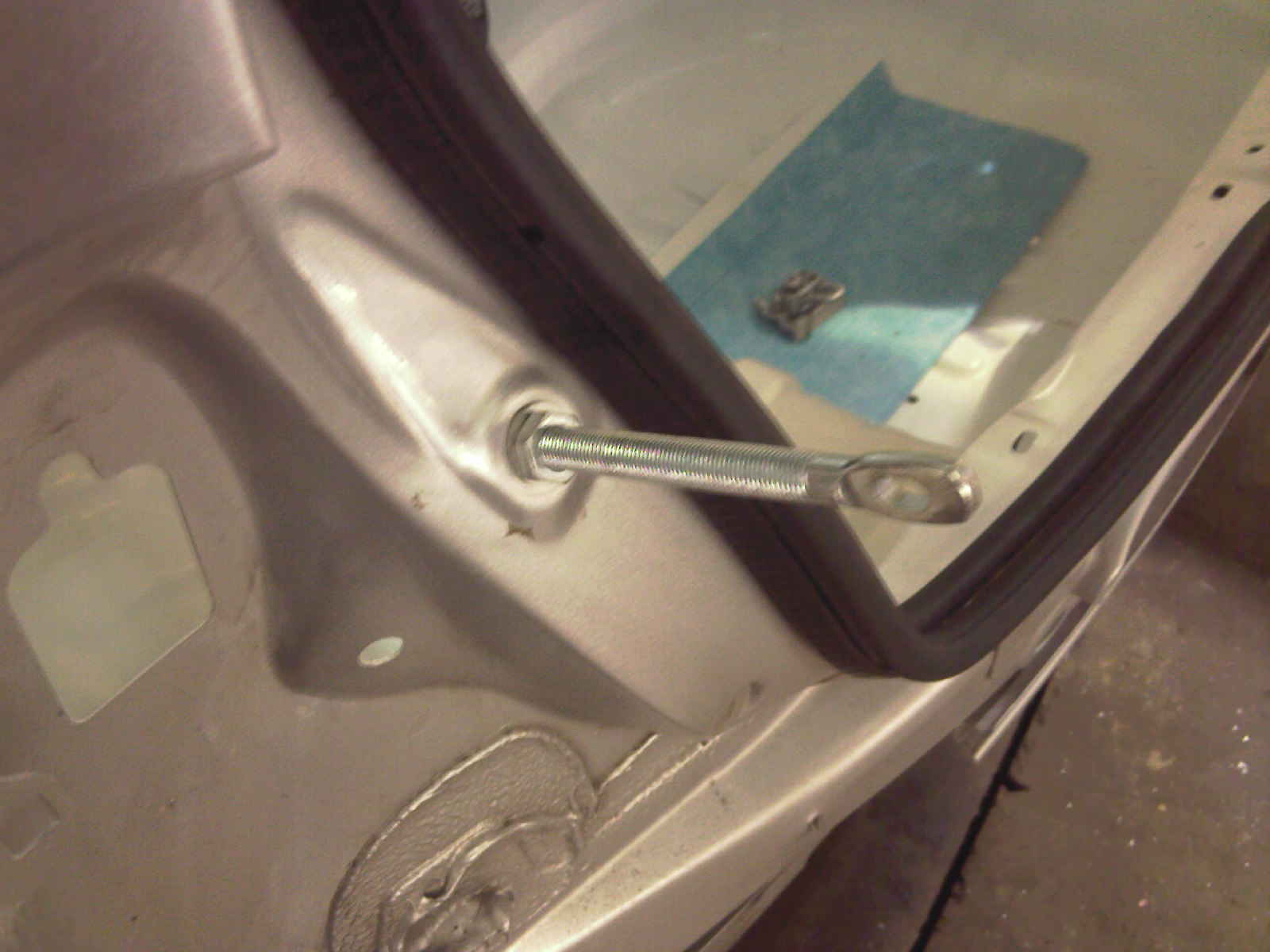

Chrispy, did you use the holes where the rubber plugs/door stopper looking thingys were to mount the threaded bar?
  220 Trophy
Yup that's right!
Thanks. Your key-holes (directly above the threaded bar) look to be higher than I remembered the rubber bungs to be so thought you may have mounted them higher. (I haven’t been out to the car for a couple of days so can’t remember.) You mention your hatch is pretty much a single skin now, any problems with removing the inside skin, does the hatch keep its shape/strenght? Thanks Mark

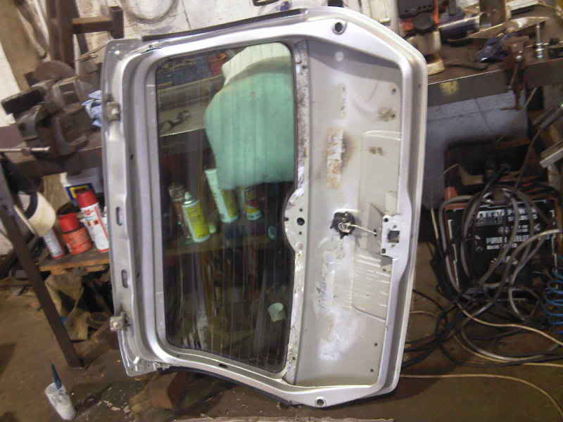

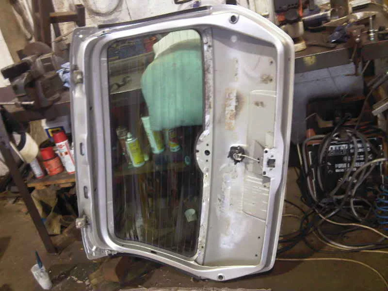

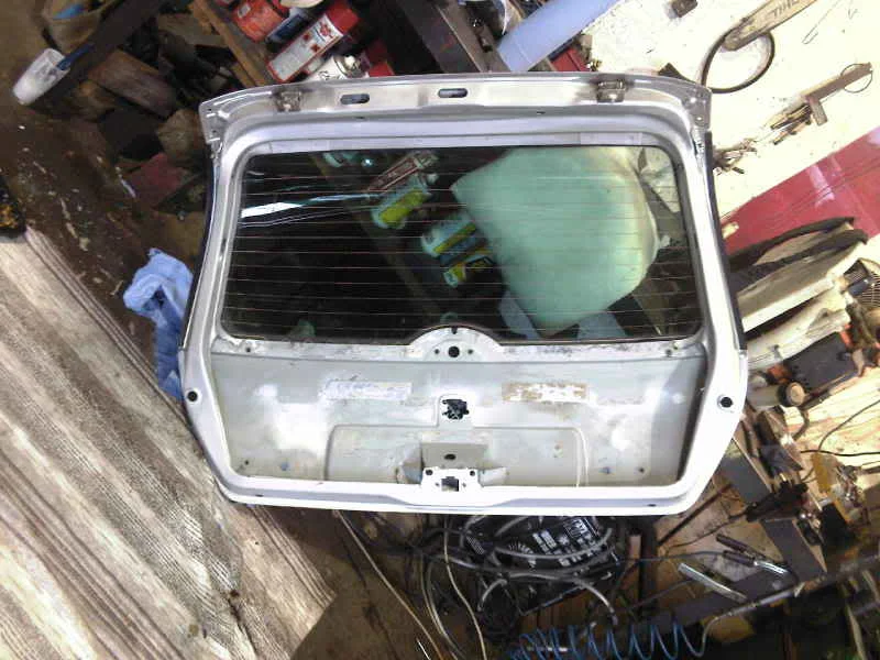

Yes it's fine, there is nothing left of mine. I just got inside and drew all around the inside with a pen, then cut just inside this line.
Alot of insides there, but you get what I mean.
Hi Tony, any chance you could take a photo or two of the inside of your hatch since cutting back please. I fitted the Aerocatches yesterday and couldn't decide where or how much of the inner skin to remove. In the end I actually decided it wasn't worth it but would be interested to see how much you've removed and where from. Thanks Mark Oh and I mounted the catches left to right (slightly pointing down towards the number plate), rather than up & down, seemed to suit the shape of the outer skin better.
Just do as I said, felt pen, mark it, cut it. It does flex a little, but that's the price you pay.
Don't forget, you still want the rubber to seal as not to let fumes in.

Before I take a grinder to my hatch I'd just like to see an example that somebody else has already cut, would be stupid not to.

Kelv, apart from the hatch I personally wont be trimming any metal off the other panels without first having a cage inside. Hope it goes well today. Jared I'm useless at posting pictures on here, but truthfully they just look like Aerocatches on a boot.

metal stripped out where its not needed on other parts of the tailgate, all wiring that's not needed in the tailgate gone aswell, and traced back up to the dash, then re-loomed, just kept the brake light wired in.

Hey Kelv. Yes catches all fitted a couple of weeks ago, I'm not going to bother trimming the hatch as don’t think its worth it for the weight saved. With regards the catches themselves I fixed the long threaded pins to the two small holes left when removing the stopper things in the shell. I then opened up the two holes left in the hatch to about 36mm (I think) so the pins could actually pass through to the catch on the hatch outer-skin. I obtained from Aerocatch a second pair of the rubber bungs that go around the pins as the catch is quite a distance away from the shell. Give me a call tonight, or pop around if you need any help. Also I found that the catches sit better horizontal and pointed slightly down towards the number-plate.
