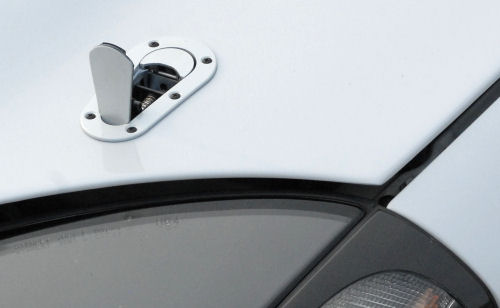

There are two fitments available; the Plus Flush has a 2.5mm thick flange that mounts on top of the panel, the Flush mounts from underneath leaving the panel completely flat on the surface. Made from glass filled nylon and stainless steel, in black or carbon look, black can be easily painted to match bodywork
Any use?

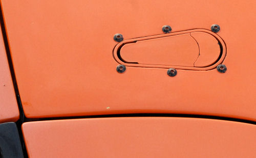

Ah ok only 2 then Ben, so would I be right to assume that the above ones are the 'plus flush' ones because its mounted from the top?? Doesnt look 2.5mm thick tho.
Dont you need a set of these Ben :rasp:
Yeah had a search through freds posts there, they are the flush ones with a carbon surround he made for it. Pics of yours guppy?
These are plus flush ones then?correct?
Are they fitted the right way as well?
Yeah thats my car. Yeah they are fitted correct and are the right way round. You can put them however u like to be honest. The other way round is a bit with the key hole at the bottom is a very weird way of putting them round if youve ever opened a set. The flush one i believe fit from underneath and sit completely flush with the bonnet where as mine sit on top of bonnet but only stand off by about 5 mm

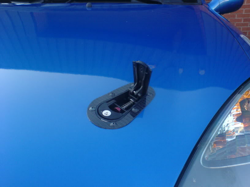

^fitted in the wrong place to be flush, see my picture above, they're 100% flat to the bonnet (mount front the underside) we finished them off with a carbon trim (not a sticker!)
ours were the flush ones + a custom carbon trim (they go in from underneath) Dan's in the pic above are the plus flush that go in from above
Cheers fred, I prefer the look of yours. You recommend fitment in a similar fashion too?

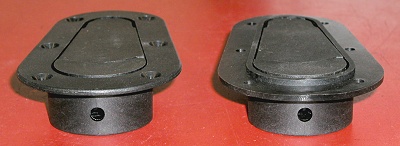

Trawled google there and have some photos to explain the differences should this come up ever again.
FLUSH:
PLUS FLUSH:
Both beside each other:
When looking at them like that I prefer the plus flush. But between that and what fred has done by just adding in a simple carbon surround I think i'll go for that instead.

Have a look at mine dude, I did the same as fred. Get the flush that fit from below and made a carbon surround about .8mm thick I think
Ive fitted my flush ones yesterday (underside mounted) but i really fancy the look of he carbon trim as the bolts like to pull the bonnet skin down around them. Need to really buy some to finish them off nicely. Where did you buy yours from? Il take a look in your threads.
You'll not find them anywhere, best thing to do is get yourself a flat carbon sheet and use the stencils to cut them out. Measure how much the catches sit above the skin and then thats the thickness of carbon you want

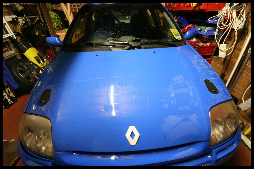

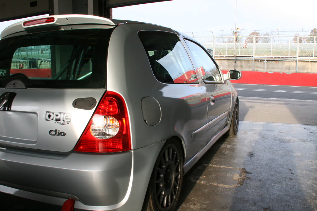

The ones on your boot are the plus flush surface mounted ones, ive fitted the flush (underside mounted) aerocatches, theres a pic on the first page on Yozzas old clio with the flush ones i have.
