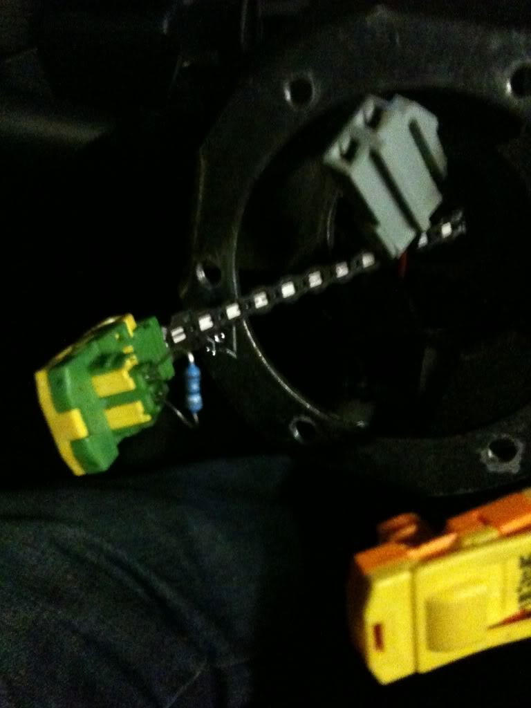

I recieved the boss today and it hasnt come with any of the bolts or airbag/horn wires. I should be able to bodge a horn wire up and find some usable bolts, but for the airbag resistor, will I need a specific one of can I use a normal resistor from maplins and tape it up?

Hi mate, you need 2 3.9 resistors, maplins is best place to go about 17p each
as above there just normal resistor loads on egay, i dont think the boss would come with them anyway
