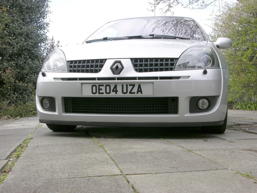

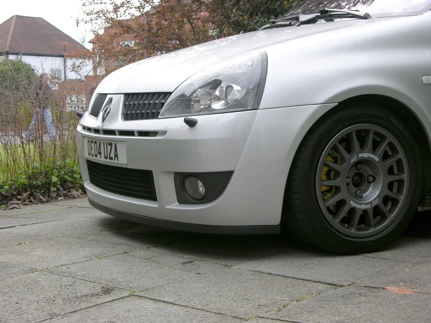

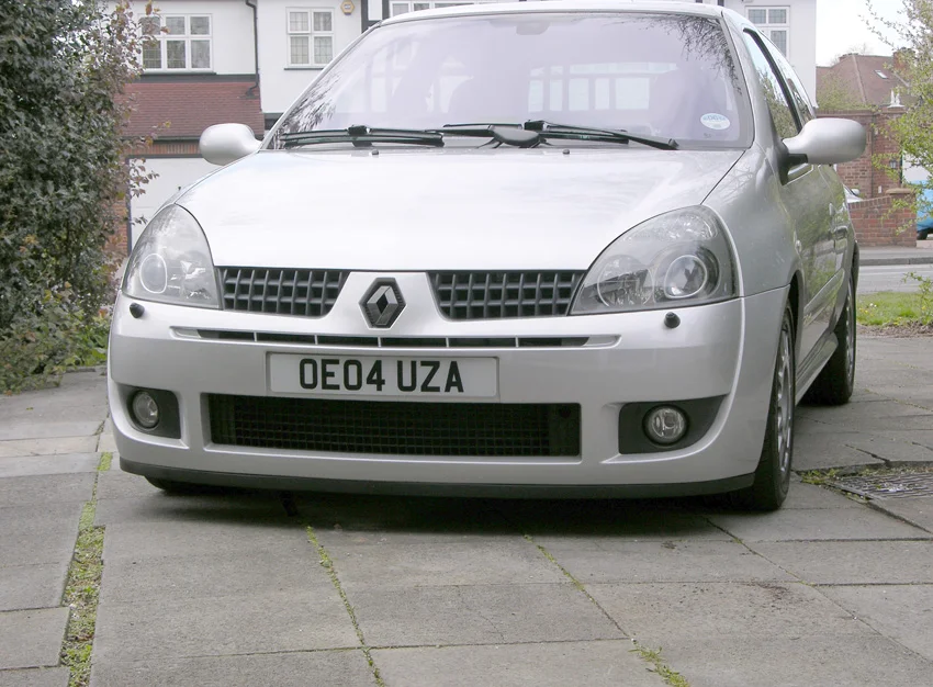

....my Skoda splitter is finally on. Fitted it today.
Umm, of course I mean the splitter was sitting in a box, not me
Pics are a bit naff. Had to lighten them in photoshop so that you can actually see the splitter.

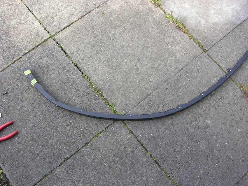

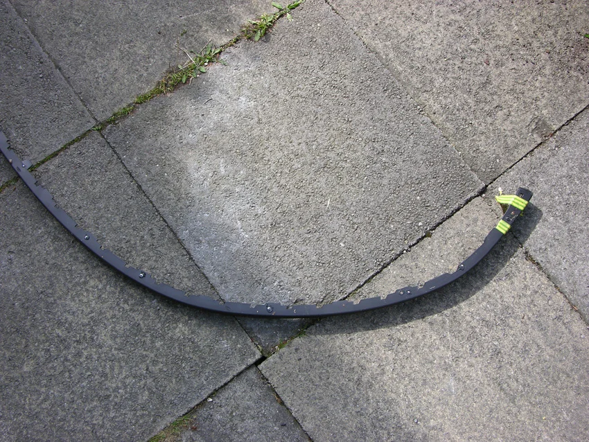

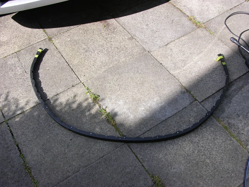

Not sure if they'll be of any use, but the pics at the end, of the splitter off, show where I drilled for the self tappers. And the 2 bits of tape on each end?
The outermost one was to mark how much to chop off the ends. And the innermost one was to use as a guide for avoiding the arch liner screw. Cut either side of the tape, bend the section down, thus avoiding the splitter sitting proud over the screw.
