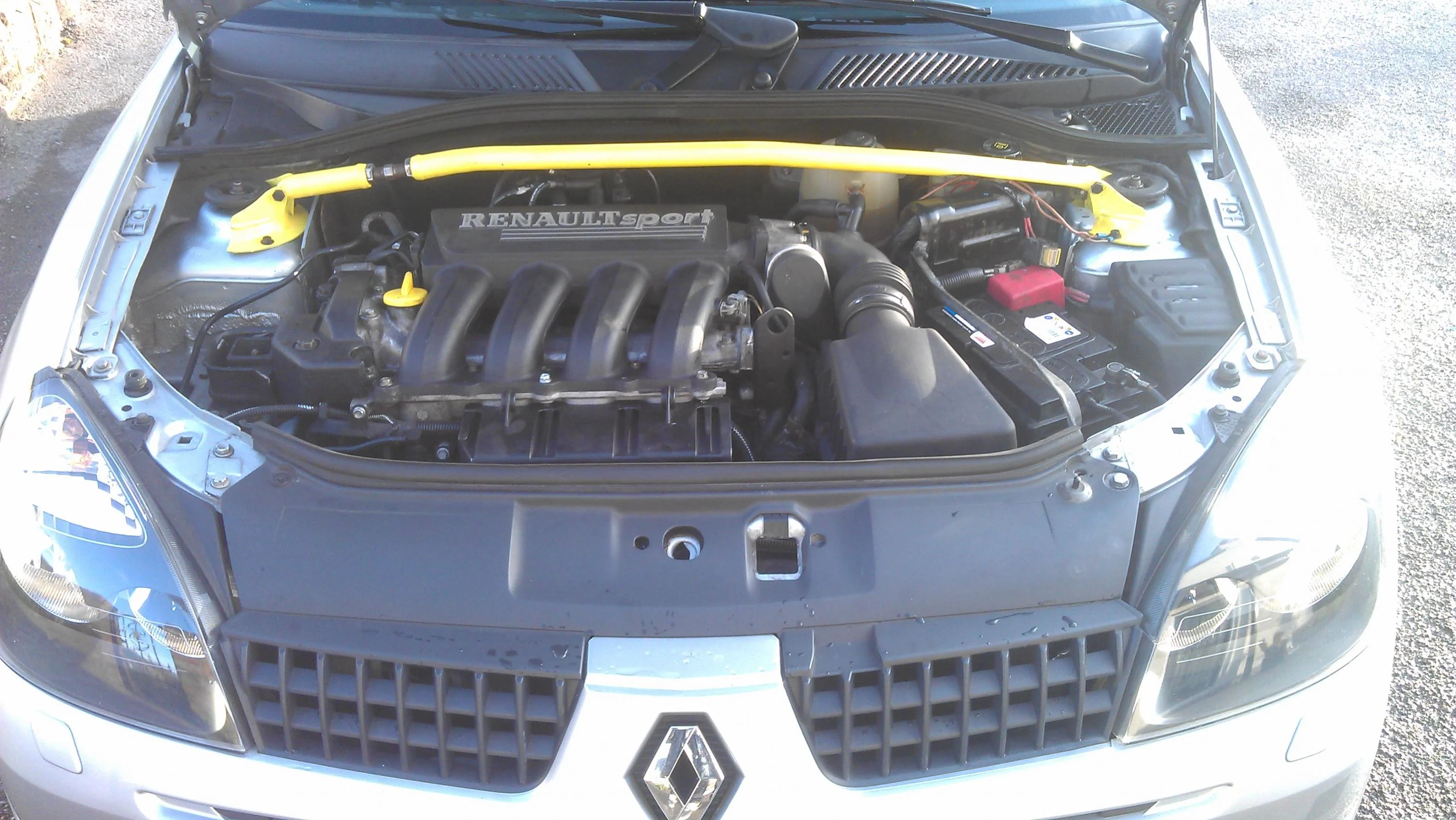

While all this was off I sanded down and painted the strut brace, upper inlet, top engine mount, bolts, hoist eye and fuel rail guard (stove paint for the black parts). Not the best finish but not bad for an accountant!

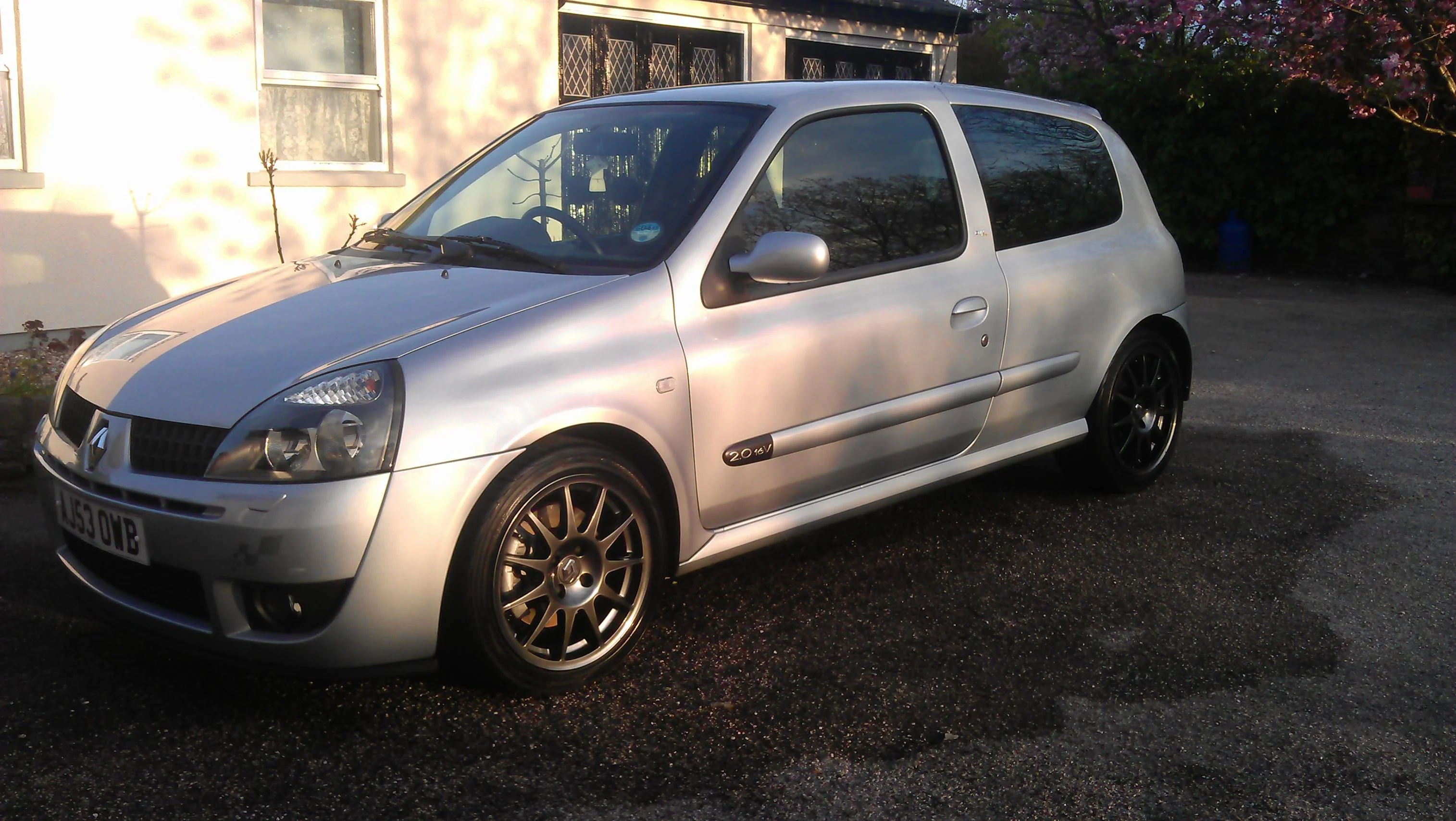

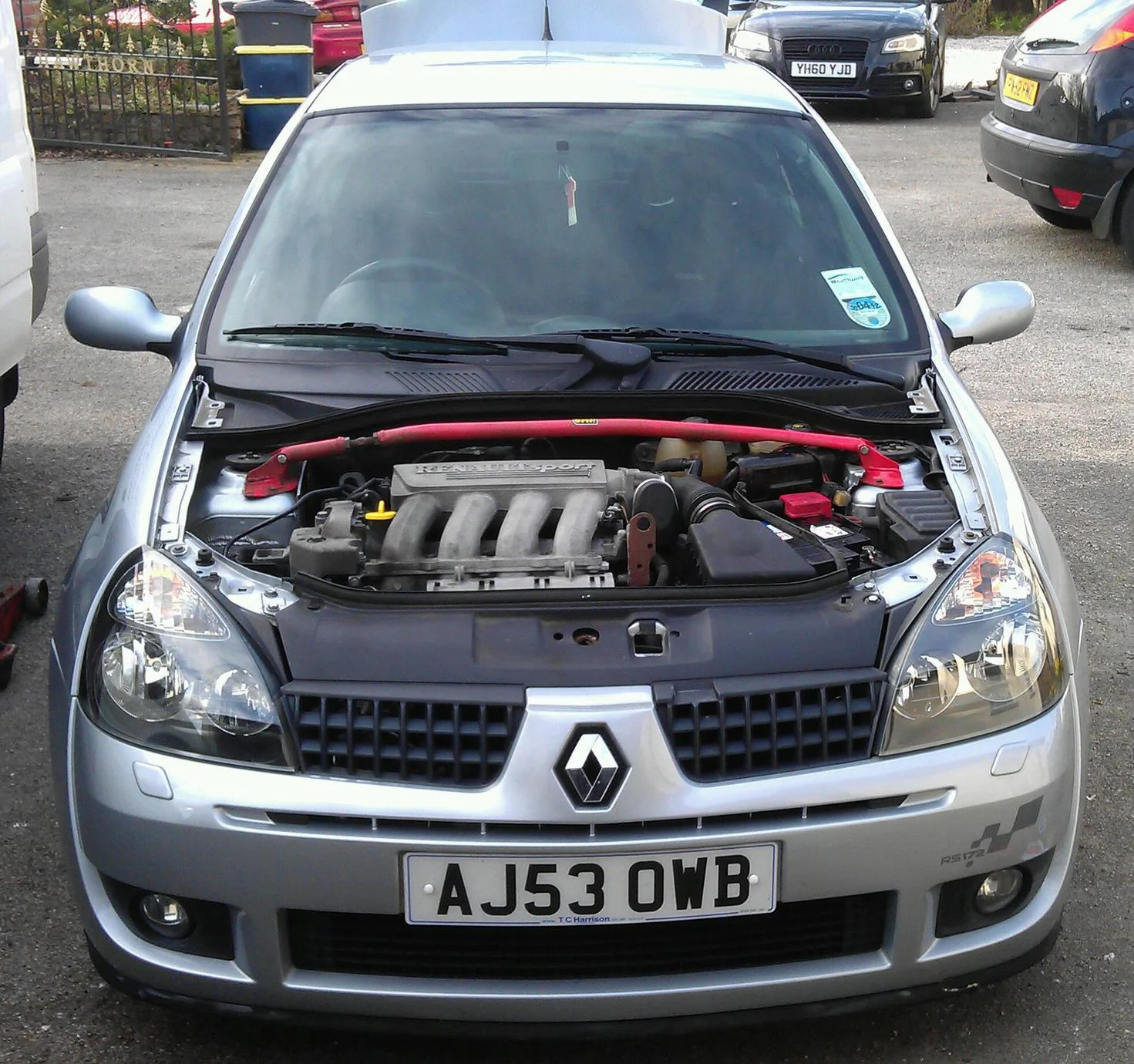

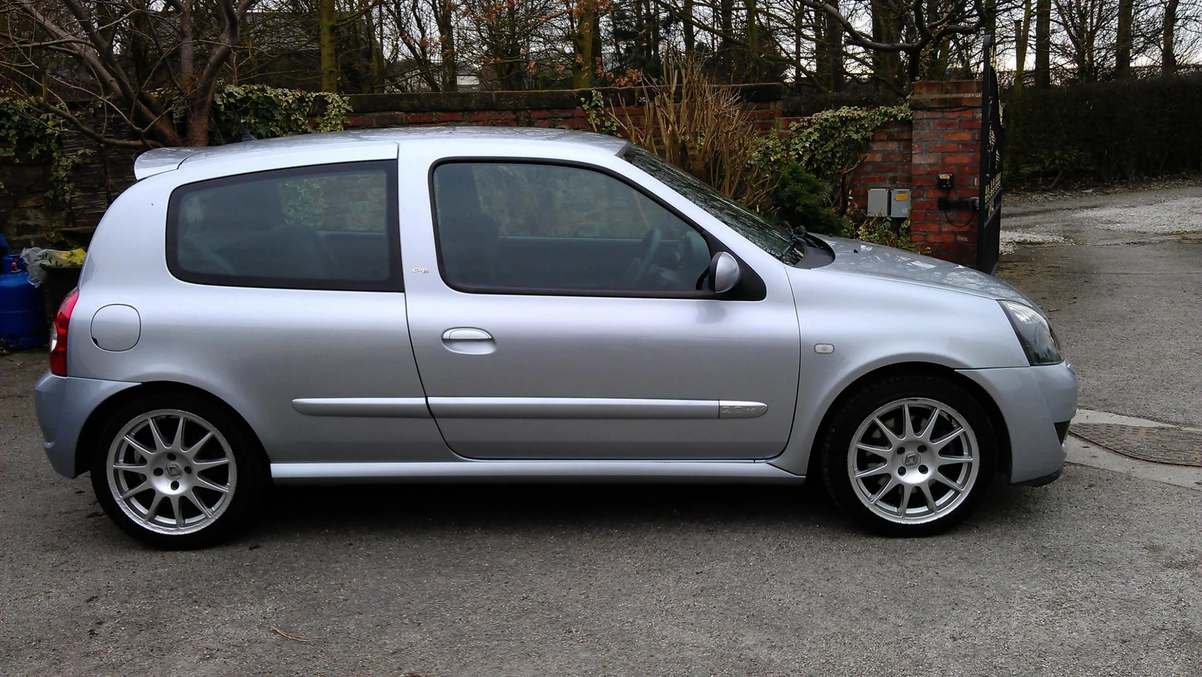

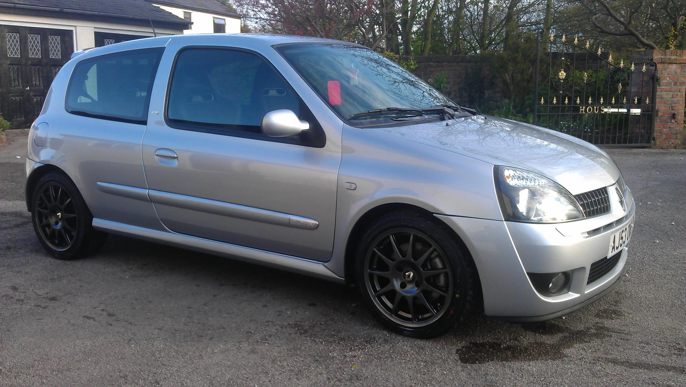

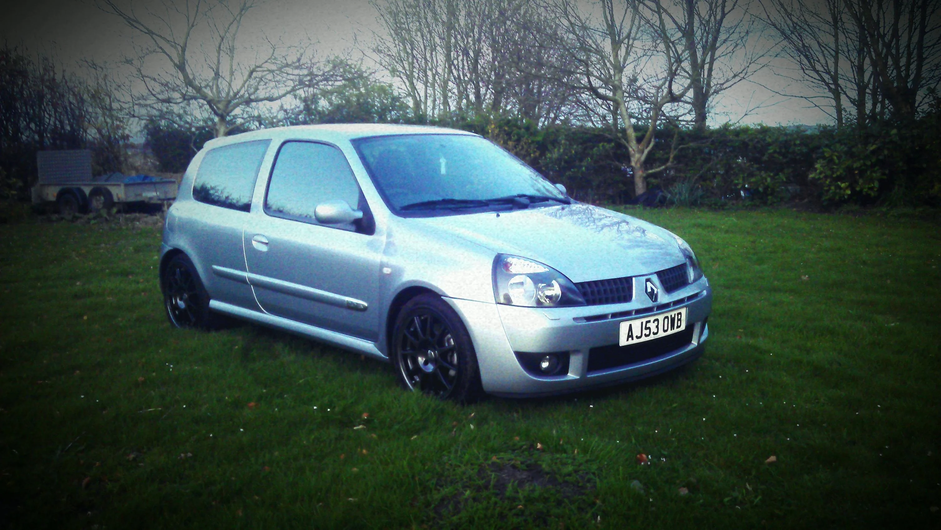

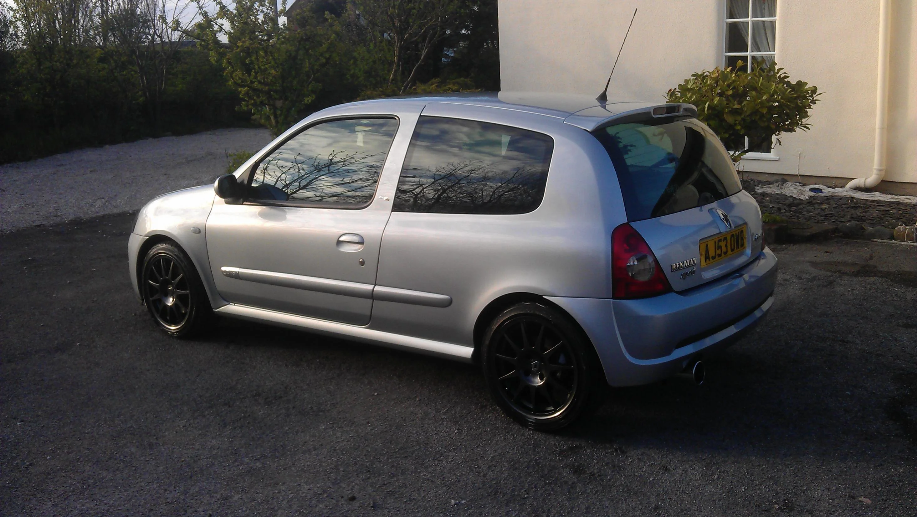

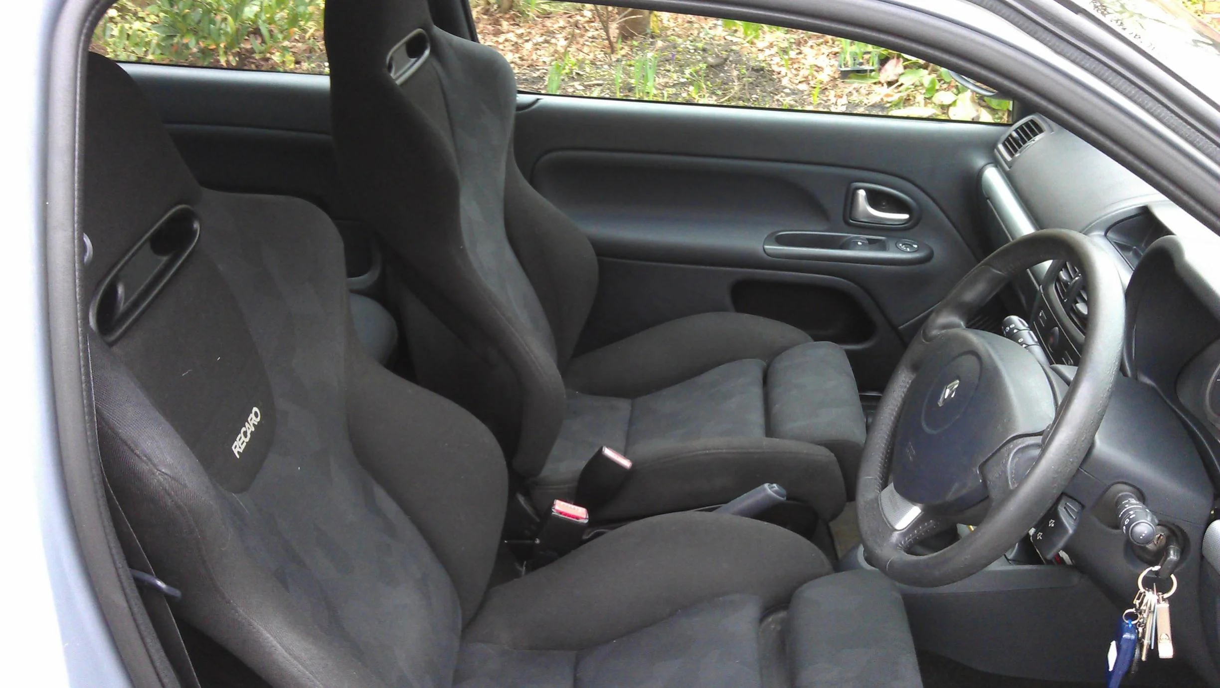

Here's some before and after shots.
Before:
AFTER:

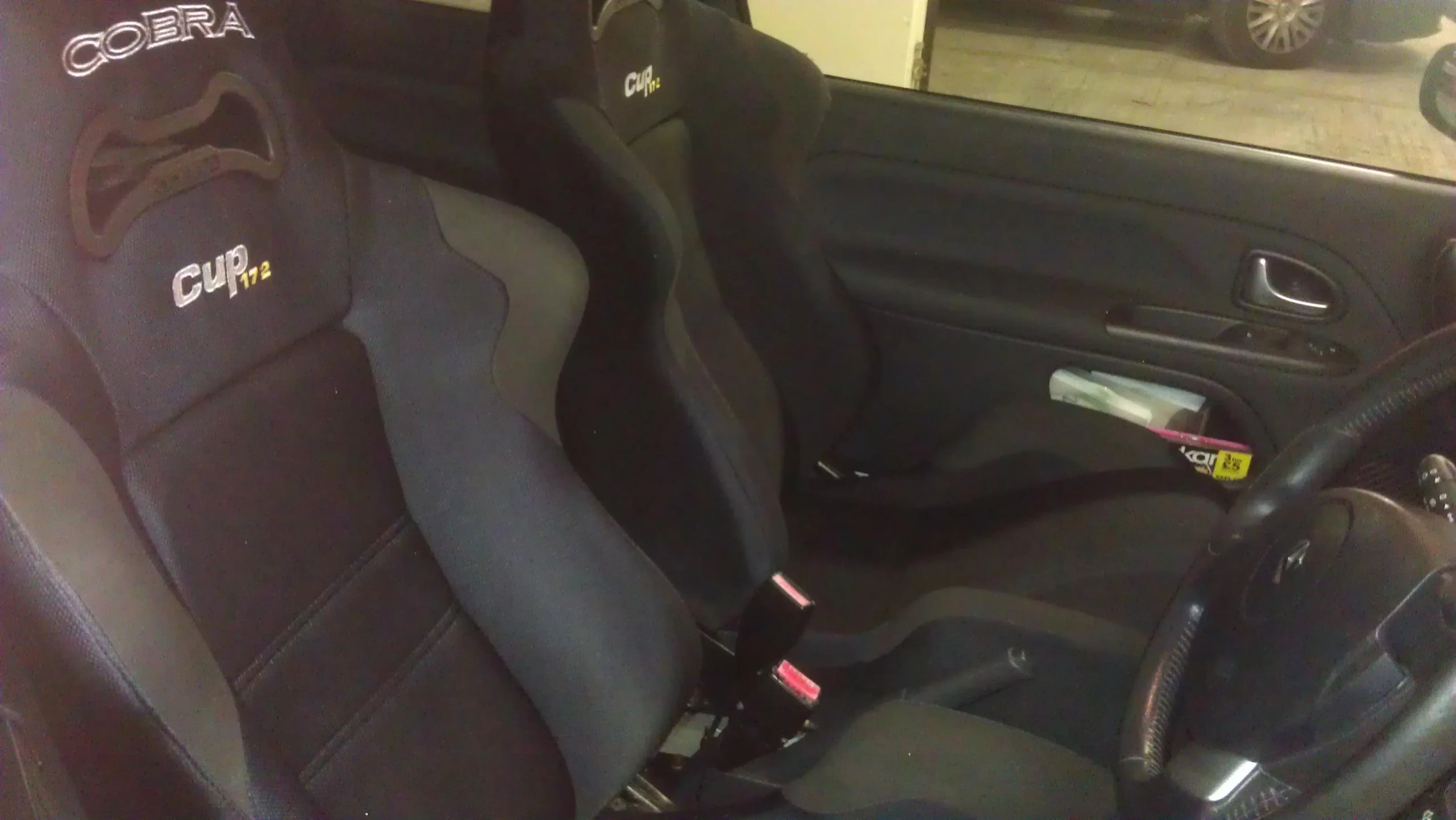

New seats today - sold the Recaros to fund tax, new seats, RS tuner and new rear shocks. RST in the post and shocks to be ordered ASAP.

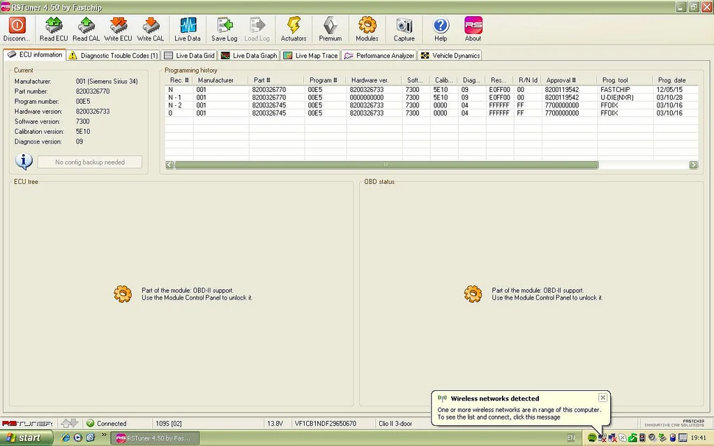

RS Tuner 98 RON map done. Idles a little higher and doesn't seem to 'back off' as much when you let off the accelerator and does seem a little smoother and sharper revving up. Nothing major though. Or is it all psychological!? Does this say it's been done?
That's the one!
