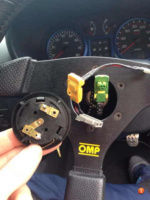

Had a search and found that i need x2 3.3ohm resistors on the 2 coloured connections, am i right in thinking i just need to run 2 wires from the grey connection onto the horn button?
Cheers
I have a different button to u it only had two outputs the centre isn't joined to another connection , but I think the middle is + and the other is earth so need to run the corresponding colours onto it with crimps if possible
