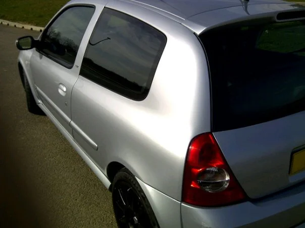

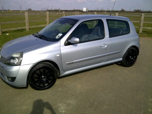

thats mine with a quick clean just using AG conditioning shampoo,SRP,egp
