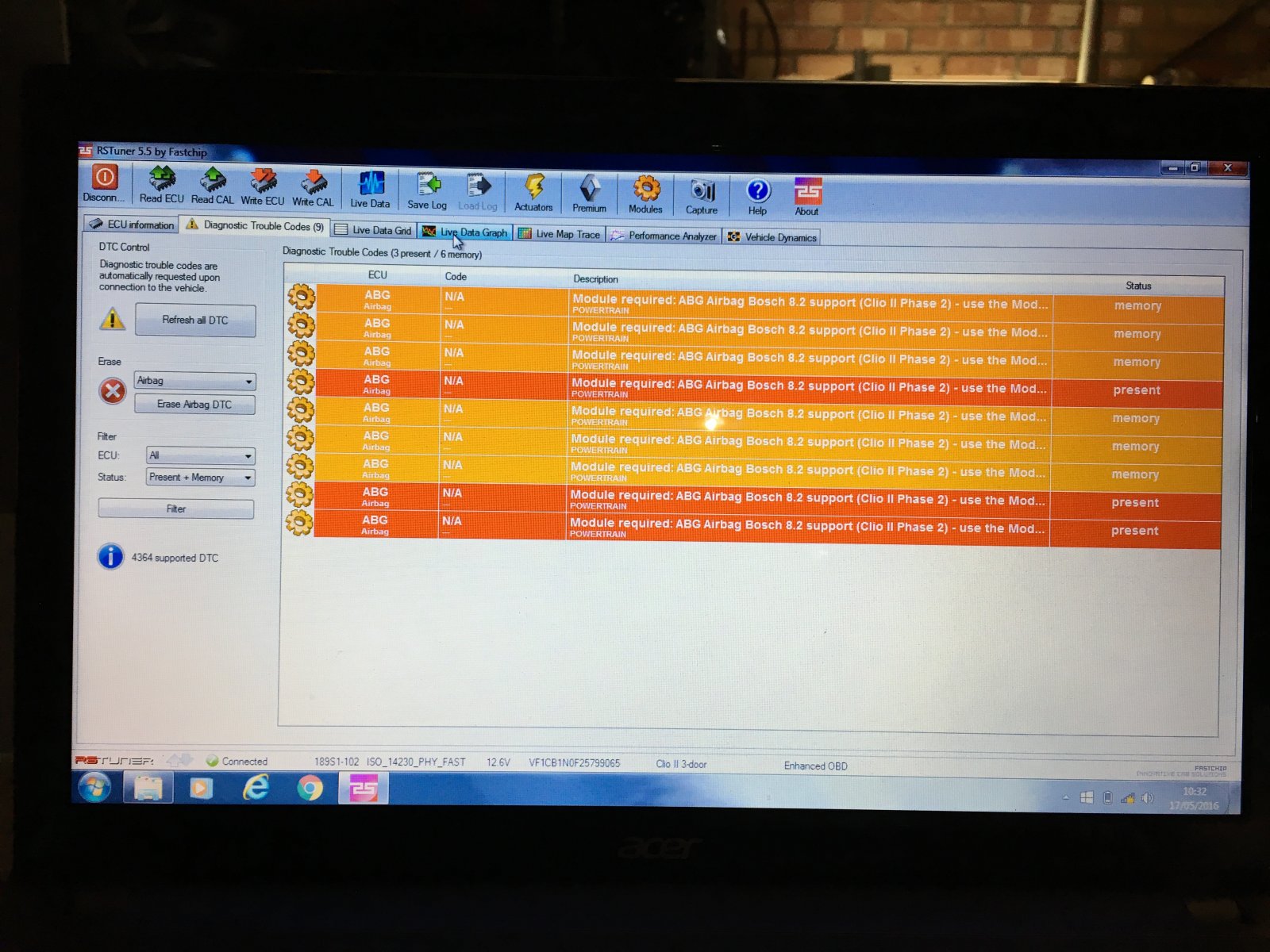

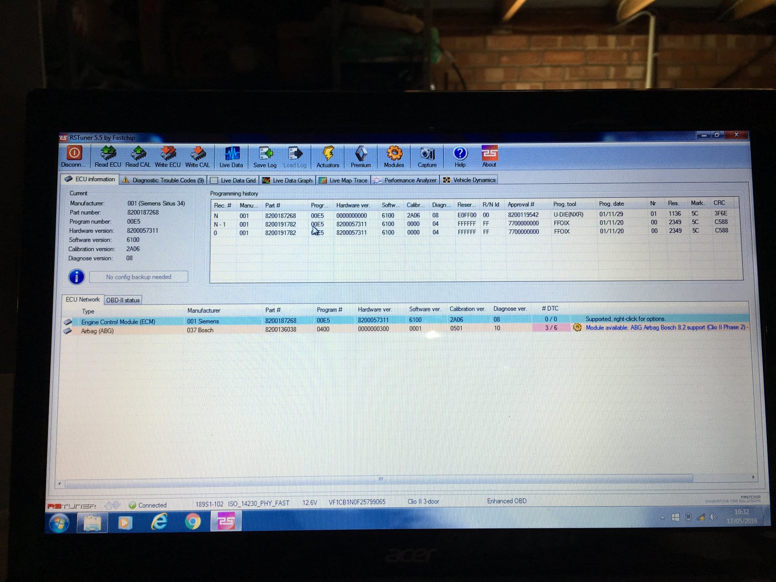

Hi guys any info on how to remove the 3 Ecu faults..
We have a stripped 172 track car all air bags have been removed and put 3.9 ohm resisters installed in
steering wheel X2
Drivers seat X2
Passenger seat X2
Passengers dash X2
Haven't removed the sensors mounted on the sills
I have proof tested all the connectors with resisters.. Ie removed resister and checked fault code on RSTUNER then reinstalled them (fault goes away)
Cheers chaps
