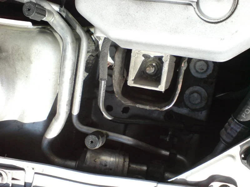

Erm It not working as well as it should. Got it topped up at Ren Tech last september and its not cold its just cool. Might need checking and topping up again.
In the photo, the thick pipe (on the left hand side of the photo) is very cold but the pipe next to it is just cool. I don't know whats wrong with it. I'll take it for a drive with it on soon, and see if it gets any colder. If not,t hen its another £50 to RenTech for a re-charge. I think it may be leaking!!

Right its Freezing, I should have drove it around before starting this thread. I was testing it just standing still revving the engine and it didn't seem that cold. Anyway everything is ok.
Ren Tech should test it for leaks. I got mine tested for £10. Found leak on condenser. Fitted a new condenser £85 and then paid £40 for flush and re-gas. Now it's mint.
only 1 pipe will get ice cold ;) the other will be warm.
