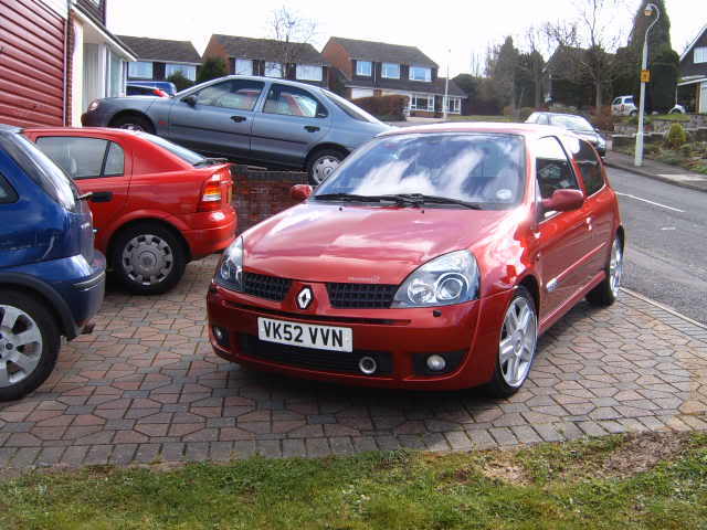

You wont have to cut a circular hole as a caf will fit quite snug into a square one. Also I don’t think you will need to take the grill out (I didn’t)
Ball ache is getting the caf down the arch. Most people remove the acoustic valve (which was a pain) but you just have to squeeze the caf it down the gap.
Don’t even bother trying if you have foil ducting as it will tear to shreds.
I whish I’d never done it to be honest (cut the grill at least) if I did it again I’d put the caf behind the grill

no internal shots i'm afraid
i did my cold air feed the other day and to be honest bit of time not a hard job. Acutlly very easy and good result and mine was a 100mm too.
