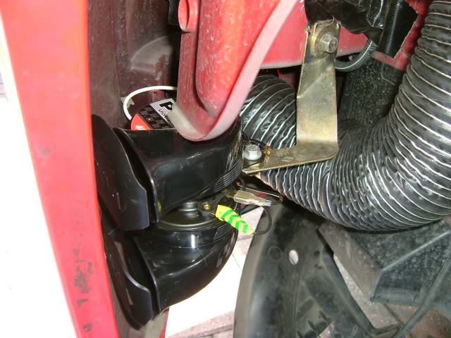

My horn has stopped working. Well one of them has, do clios have a double horn as somtimes it sounds as it should do, with two tones of the horn, but now its just sounds like a single horn which sounds high pitched.

i cant remember if it has one of two.
i thought it was just one, and yes the clio is very girlie horn wise.
this pic i took a while back looks like it could be two, but it doesnt really provide a definate answer.

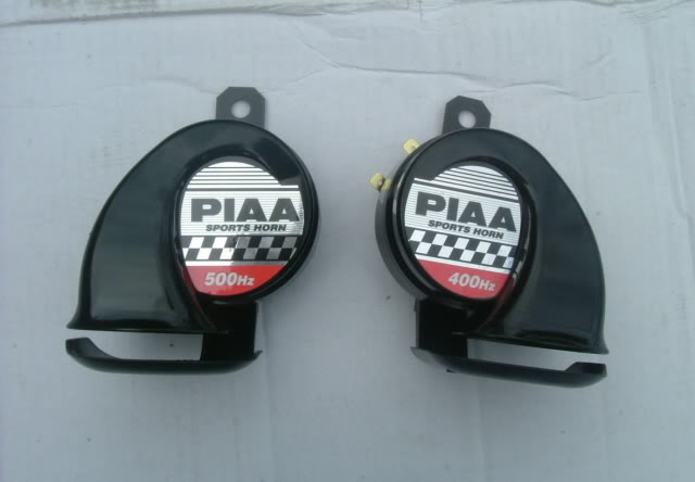

The Piaa twin horns are ace (nice and loud also), fitted these to my trophy as it only comes with a single tone horn.
