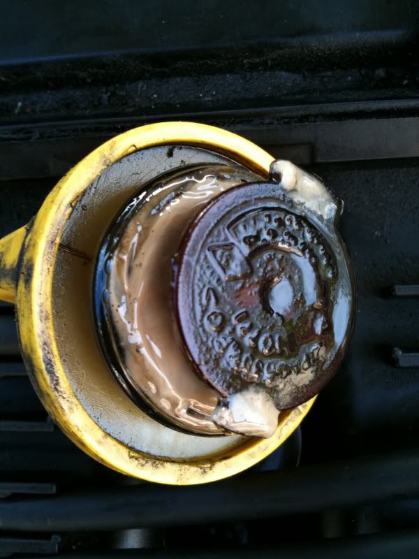

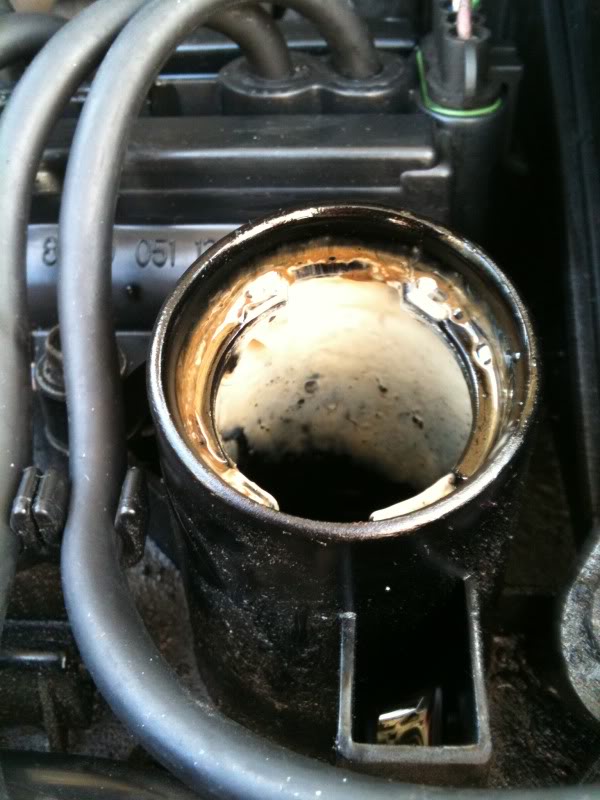

  4. sludge on oil filler sides and cap botton (I have cleaned it now car has only been used short distance)
Here Is some pictures But looks worse than it was
If any members can Give me some Advice I am very Grateful Indeed I will try and get a hd video uploaded :D
The mayo like mess is actually just from condensation. If your car only does short journeys it can do this. Temp is normal, and we would need a video of the wooshing sound.

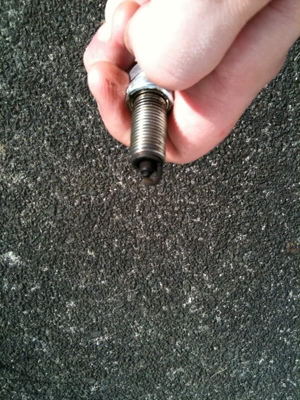

Hi just took coil pack off and the lead came off plastic very strange anyway I decided to remove cylinder 2 spark plug and it was dirty they have only been in a few weeks the old ones were cleaner here is a picture any way to clean inside ? or wd 40 / carb cleaner Here is picture
Can't really tell from the picture, they should be brownish. If they are black and sooty it's a sign you're engine is over fueling. If that's the case it's more than likely your lambda sensor.
Also as far as coilpacks go I got mine from eurocarparts and It's been perfectly fine :)
