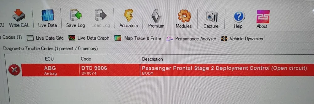

In the last week I have been getting intermittent, tending to in the last day or so more permanent AIRBAG + SERV lights on the dash - though when I start the car no lights show for a few seconds before they come on again. I had hoped it was the common pretensioner connector issue under the seats but fiddling with them did not sort it, and after getting RSTuner on it this morning it is showing fault code DF0074 - which indicates it's an issue with the passenger airbag in the dash?
Searching on here for DF0074 doesn't bring up anything, though DF074 does - which seems to be either 'passenger front airbag circuit 2, open circuit' (which sounds the same as my issue) or 'Steering Wheel angle coherence' (which isn't my issue).
I will be removing the dash top on the weekend to have a look, but just wondering if anyone on here has experienced this fault before - did it require the passenger airbag to be replaced or could it possibly be just a loose connector issue? Seems unlikely to be a loose connector but I guess you never know...
