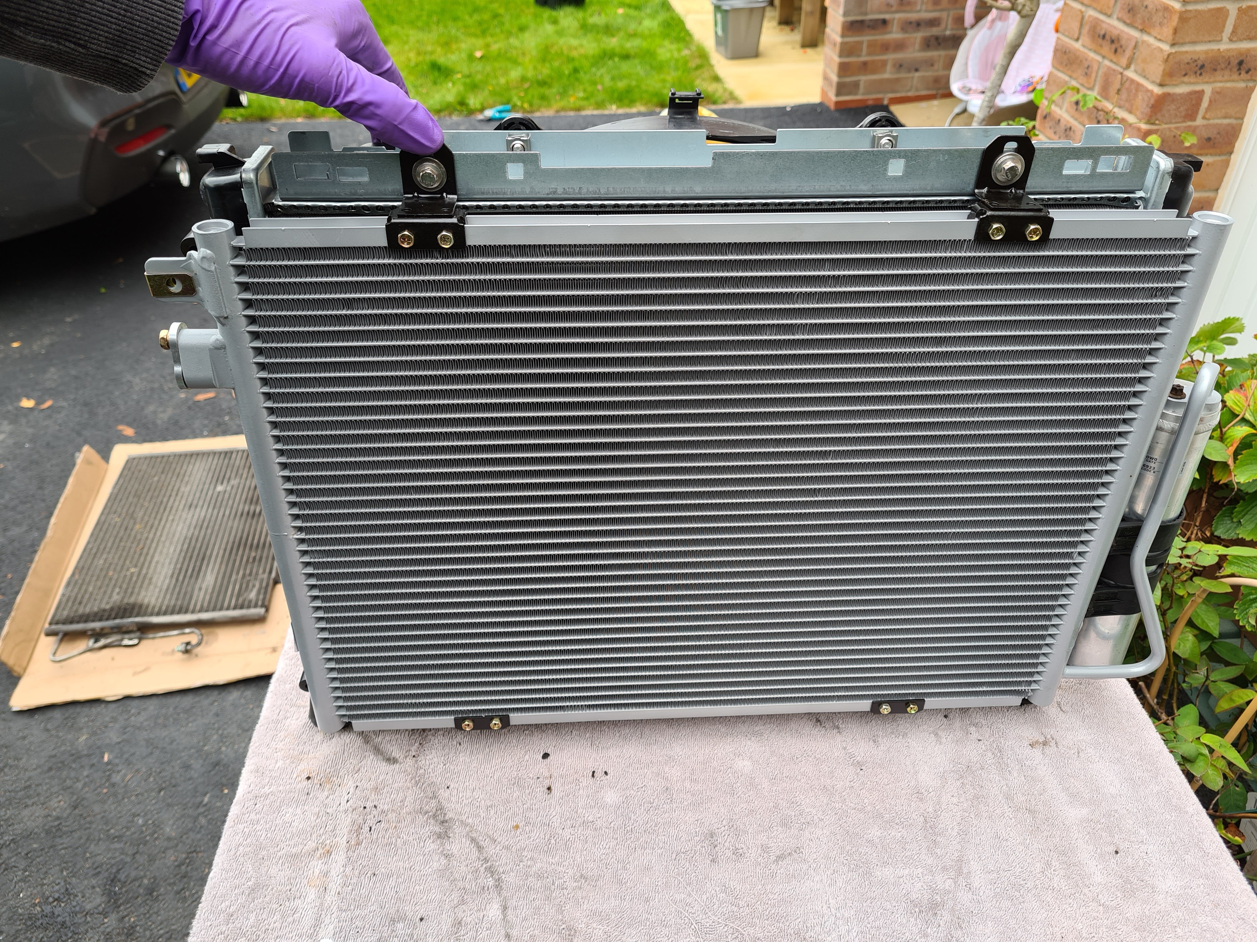

Hi, I'm slowly working on my 182 as I get chance and the aircon condenser has definitely seen better days and isn't secure. It flaps about at the bottom as looks like the bracket is totally shot. I'd like to replace it myself (maybe the radiator aswell but will look at that when its out) and wondered if there is a guide anywhere on how best to do it and what condenser to get.

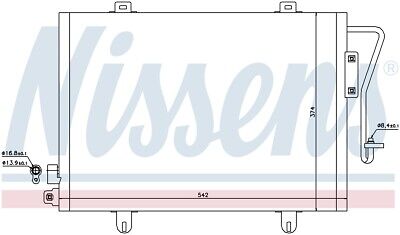

I've seen posts on here with a mix between nissens, denso and delphi but they all seem to be slightly different sizes when I've looked on Autodoc.

If the compressor clicks when you turn AC on, then it still has gas in the system. If not then the pressure switch will stop it engaging.
Can't remember which one I bought now, @Louis might cos think he got the same one. Was only about 15-20 quid

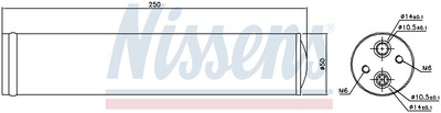

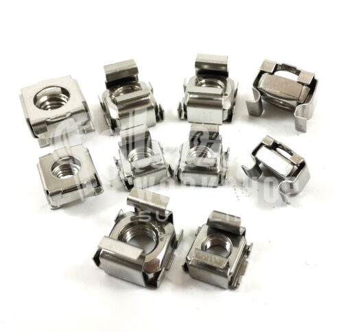

These are the dryer and condenser I bought for my Clio, all connected up with m6 caged nuts and I believe 20mm m6 flanged bolts

Thanks. condenser is out of stock on the ebay one but found same one on autodoc for not much more.
Do you know if there is a guide for replacing them anywhere or is it simply slam panel off, drain rad, disconnect rad and condenser and lift out the rad, condenser and fan in one go?
The ones from Ebay are now about 120quid unfortunately.
Pretty self explanatory when you're there for changing the rad, but I'm sure theres guides and also some photos in my thread.

Thanks Louis. Just got the nissens one MLB said but from autodoc for £63.90 which isnt bad i thought. I had a look for threads and guides but will search for one of yours. Thanks all. Hopefully have it back on the road soon (been on my drive 15 months now) and will be looking for somewhere in east yorkshire for belts

1) On the aircon dryer. Which pipe goes to the 'IN'. is it the pipe connected to the condenser or the pipe which loops back around the front of the car. cant see any markings on the original dryer.

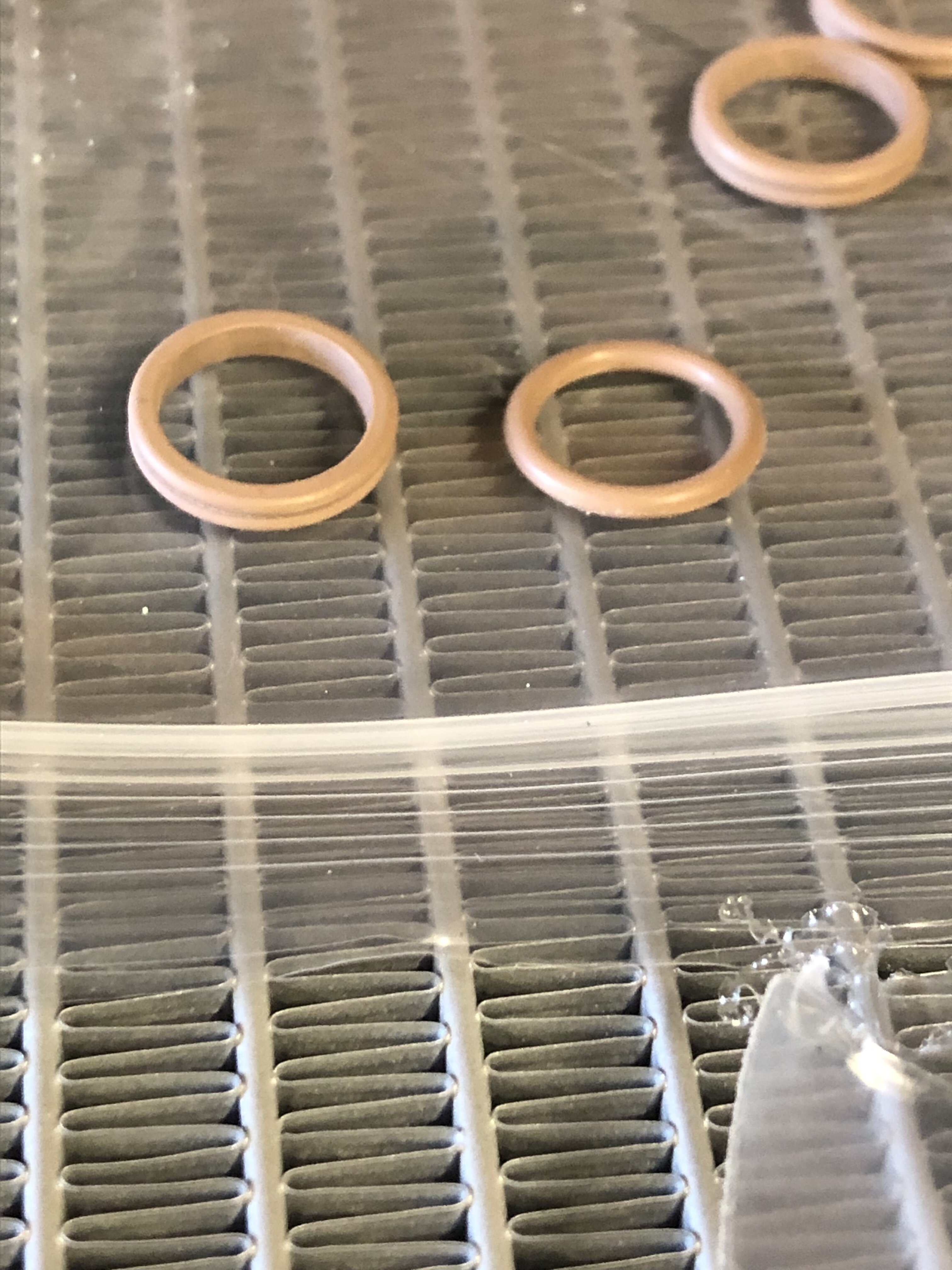

3) can you get just get the 3 aircon seals. the one on the condenser and the two on the dryer or do i need to buy a full kit.

Flow is from condensor to dryer so I think I connected the condensor to the 'IN' on the dryer.

Not sure re the seals, I don't think Renault do them seperately but I'm sure you'll be able to get individual seals from ebay. Or maybe just go to your local garage/ATS euromaster they might be able to help. ATS near me was super helpful and gave me some small stuff like seals and oil for free.

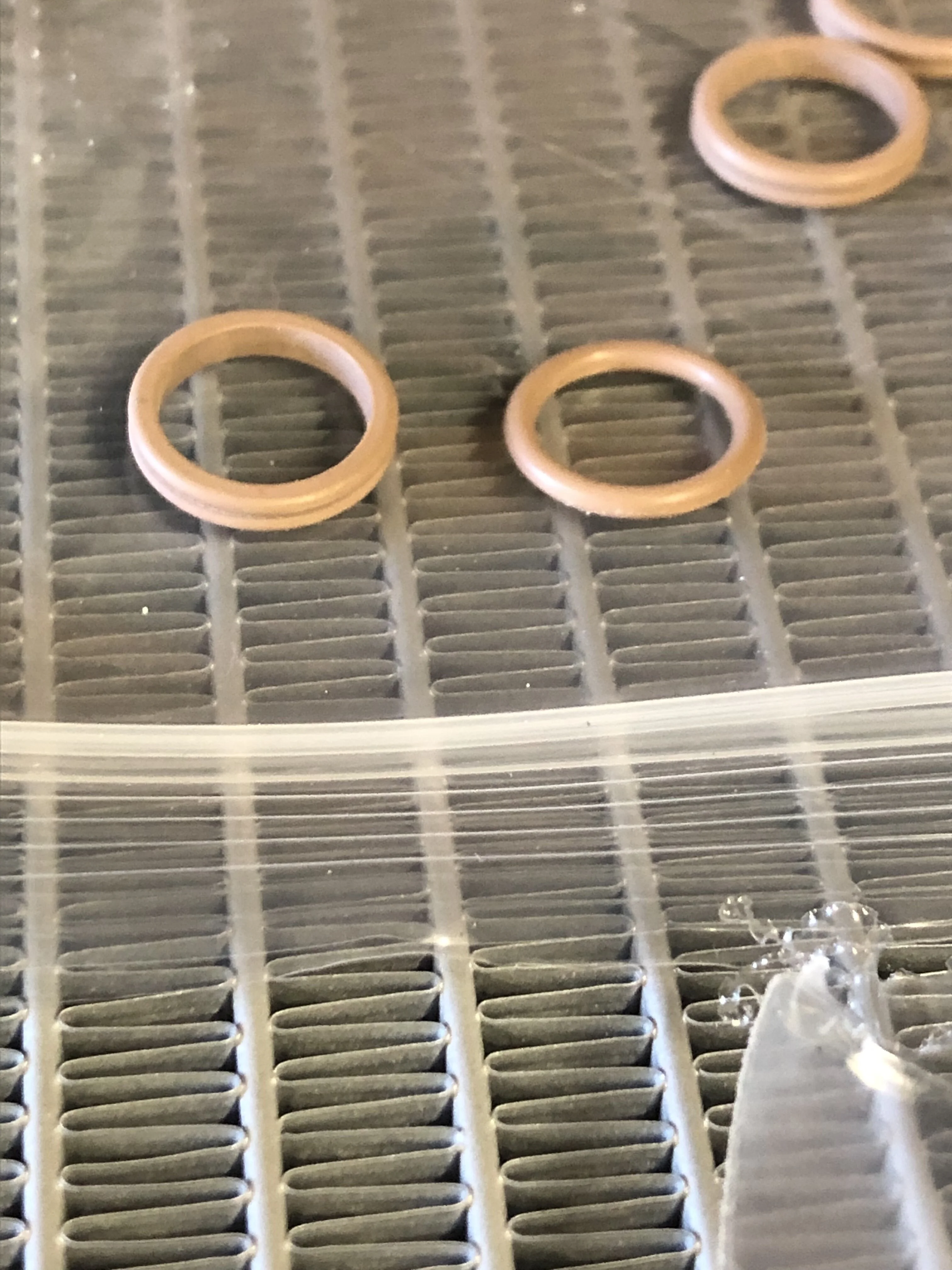

Follow up question. For the pipe that connects to the side of the condenser. I have 2 types of seal the same diameter but one type is double thickness. The one that was on when I took the old one off was none oem and single thickness but with signs of a leak. These are the ones which come in the oem pack.
Anyone know which one I should use.
Thanks in advance.
