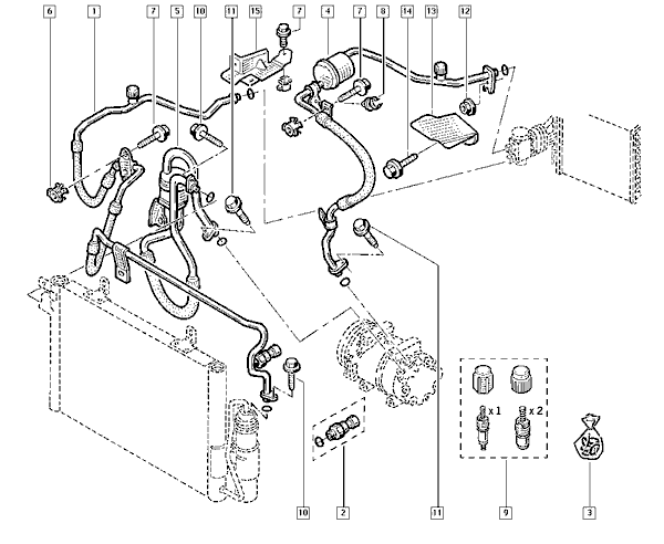

Hi all recently found this forum whilst lookin for part. This is 1st time postin on here so here goes. Ive recently brought an 02 reg clio 172, after i purchased car from a private seller i found the aircon to be blowing warm. I had it re charged to later find i ad a leak. The leak is coming from the top pipe in picture below. Does anybody now where i can find the part cheaper than renaults £93 quid.
http://i211.photobucket.com/albums/bb30/bigkel25/pipe.jpg
Looking back at the pic he posted i am now not so sure as he has posted a pic of both item 1 and item 4 shown in the above pic together, but i think you have both bud.
are you sure its not just leaking from the schrader valve (the bit under the black plastic cap) ?
spray some water around to be certain, if its the valve it can be replaced for pence
this valve (part 1) is leaking. it only do that if i open the plastic cap.
benji&eka says, it can be replaced, true?
i asked this from renault today, only whole pipe @ 244€!
or is there any way to fix it?
some say, aircon service can be happen only without that leak.
