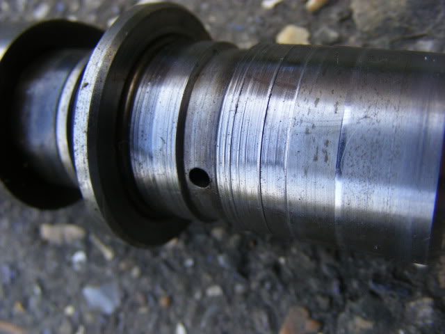

I got myself an EC1 from Matt @ TDF and a set of Catcams 421's. After taking the cam cover off this was revealed to me...
It wasn't the prettiest of sights when you know there is only a week left until Matt works his magic in mapping it, bearing in mind the only time I got to work on the car was from 7pm onwards when i finish work!

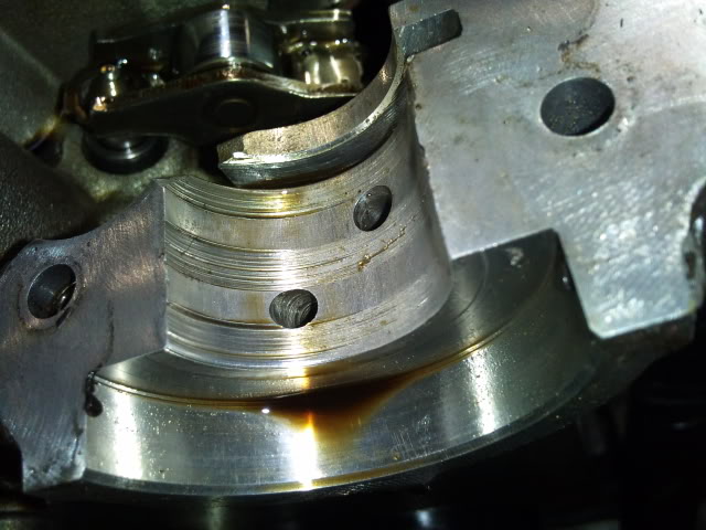

Turns out (I didn't know this at the time as I use Autodata on the daily - there tightening torques aren't "quite" right for the F4R!) My engine was ruined, there was a chunk missing from my new head and I had blue rods along with melted bearings from my oil pump having a lunch break whilst flat out on Matt's rollers!

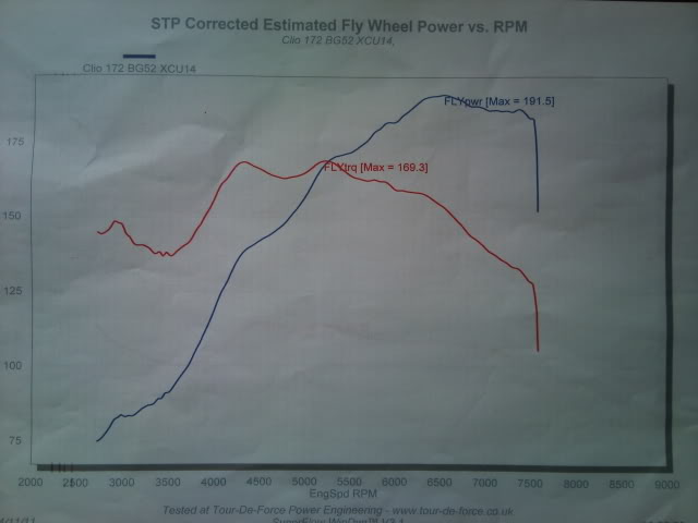

Much better! The car made 191.5bhp & 169.3lbs/ft!

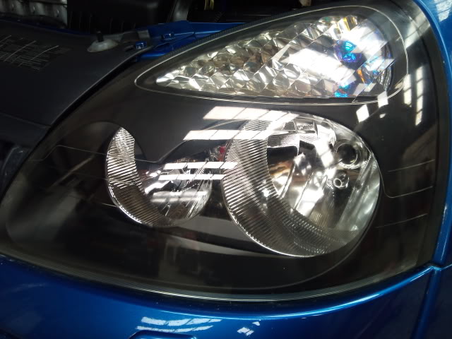

Oh and a headlight clean-up, they where real bad!!!
