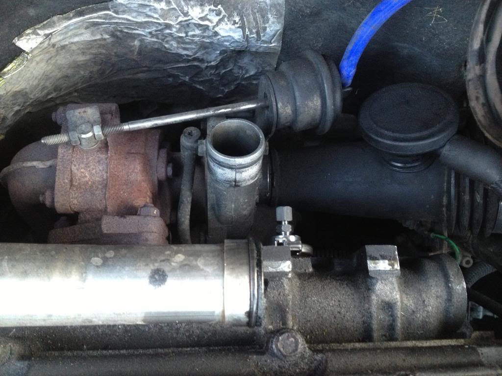

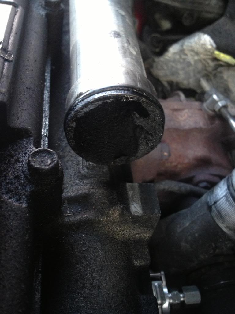

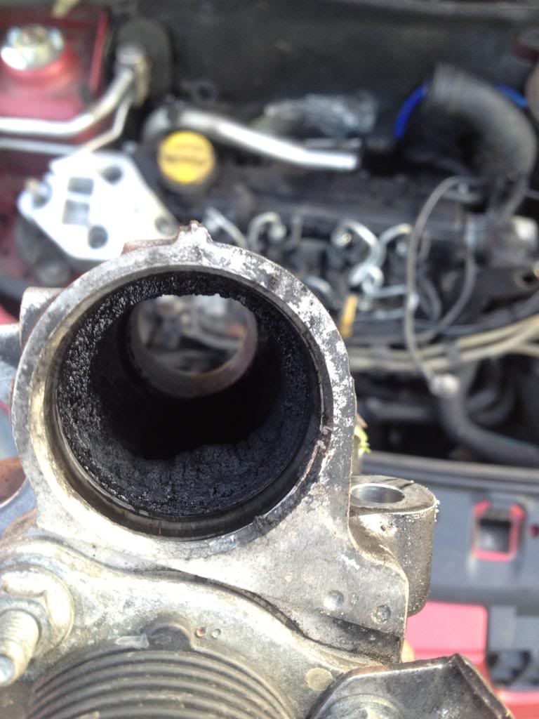

The other night I stripped all the boost pipes, EGR housing etc off my Clio to fit a EGR blank and EGT sensor...
Nicely caked inlet pipe
And housing
Now have a working EGT gauge, I plan to remove the housing (just disconnected EGR valve atm), but we'll see.

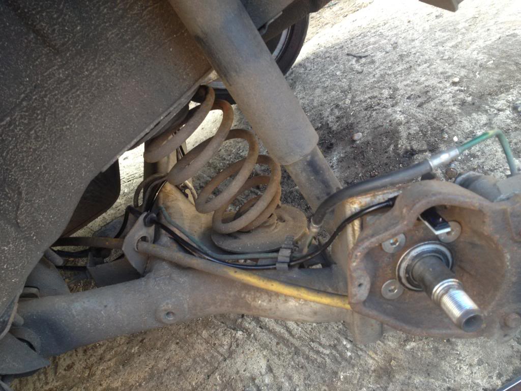

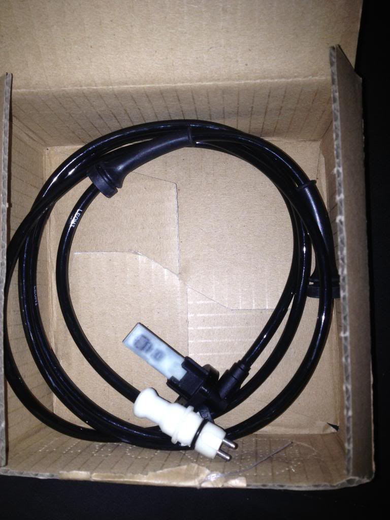

Got some rear ABS sensors from Renault...
Very expensive.
Pic of one fitted...
Now have fully working ABS. Yay!

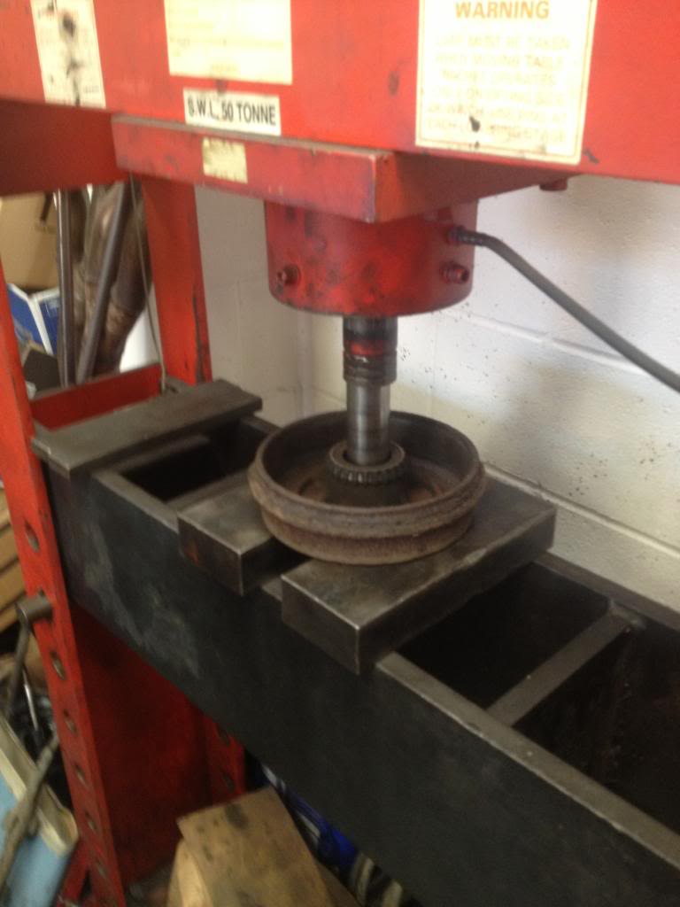

Then did the last job on that 5dr 1.2 I have... New rear wheel bearing.
Pressing the old bearing out...

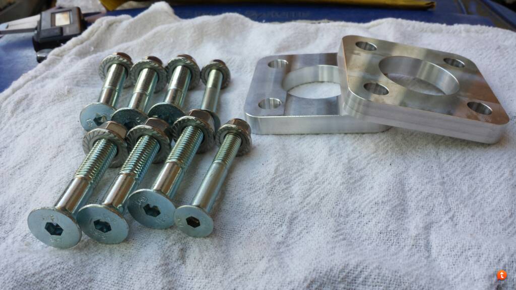

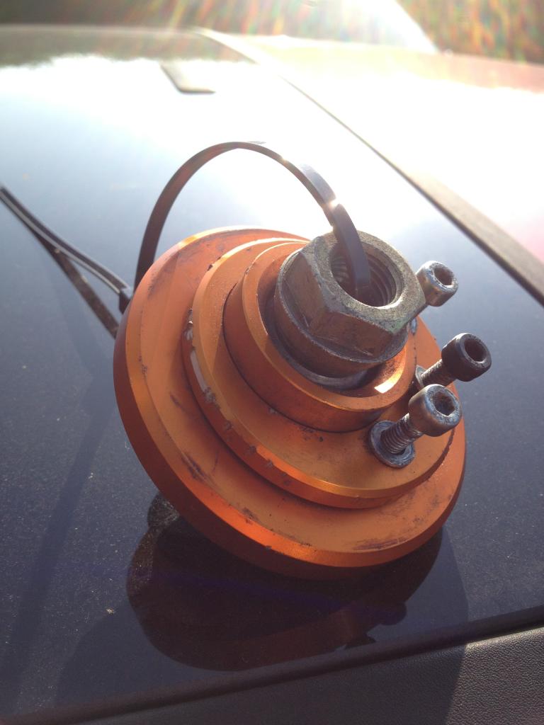

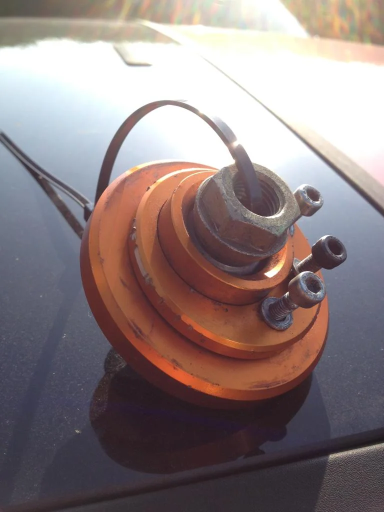

Where did you get the bolts that hold the stub axle need some for my spacers?
GrahamS
  335d, GT4
You can get them at any fixings supplier. I bought my bolts from the local shop, cost me about a fiver with nuts.
Alex, don't have 0 deg 10 or 15mm rear stub spacers laying around I can purchase from you? Feeling the need to get my b**ch a bit fatter.
GrahamS
  335d, GT4
As MWright says. Can't remember length. I found it somewhere in a thread in the original group buy last year.
Think my bolts were around 100mm
Rear Disk/Hub Nut: 175Nm
Rear Calliper to hub: 100Nm
Rear Hub to beam: M10=57 n2 - M8=29 n2
  Renault Clio DCi 65
Is that sufficient enough for a 10mm spacer or would I need longer than 60mm? Sorry for hi-jacking your thread alex
GrahamS
  335d, GT4
If you buy longer they can't get in the way of anything so don't worry if you buy longer ones. Take one of yours off, give it a measure and add the spacer size, sorted.

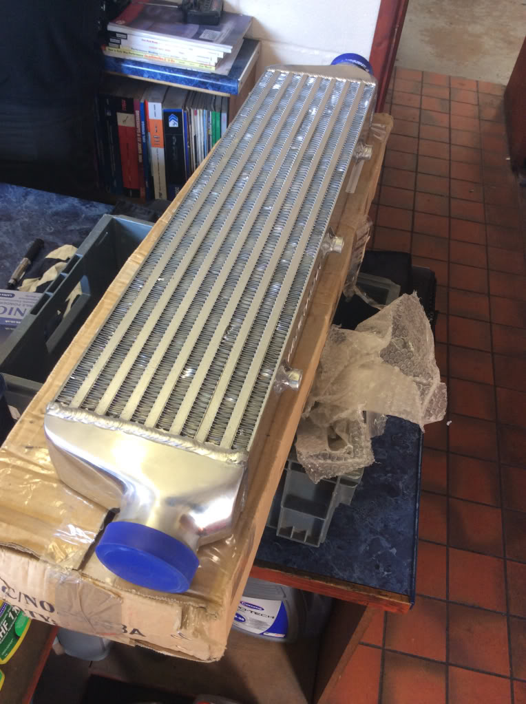

Intercooler is going to look good, Will give it a semi test fit tomorrow maybe.

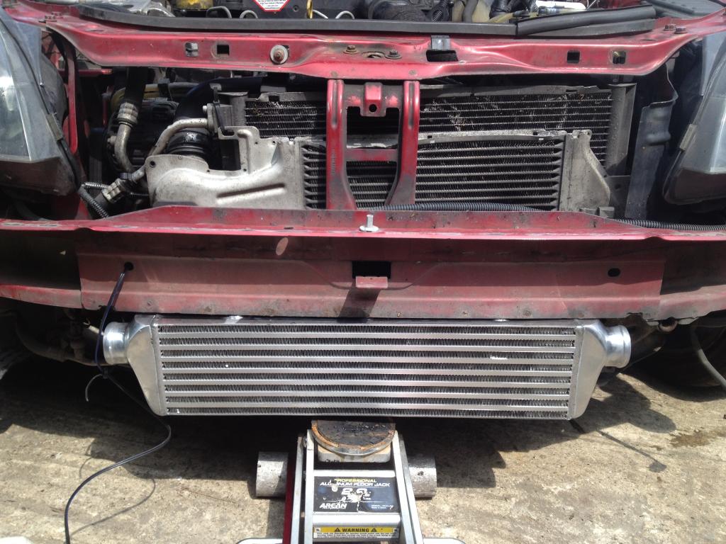

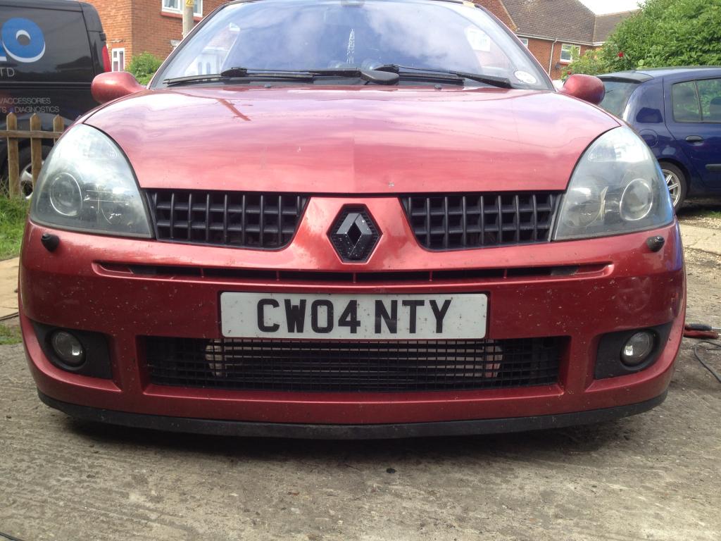

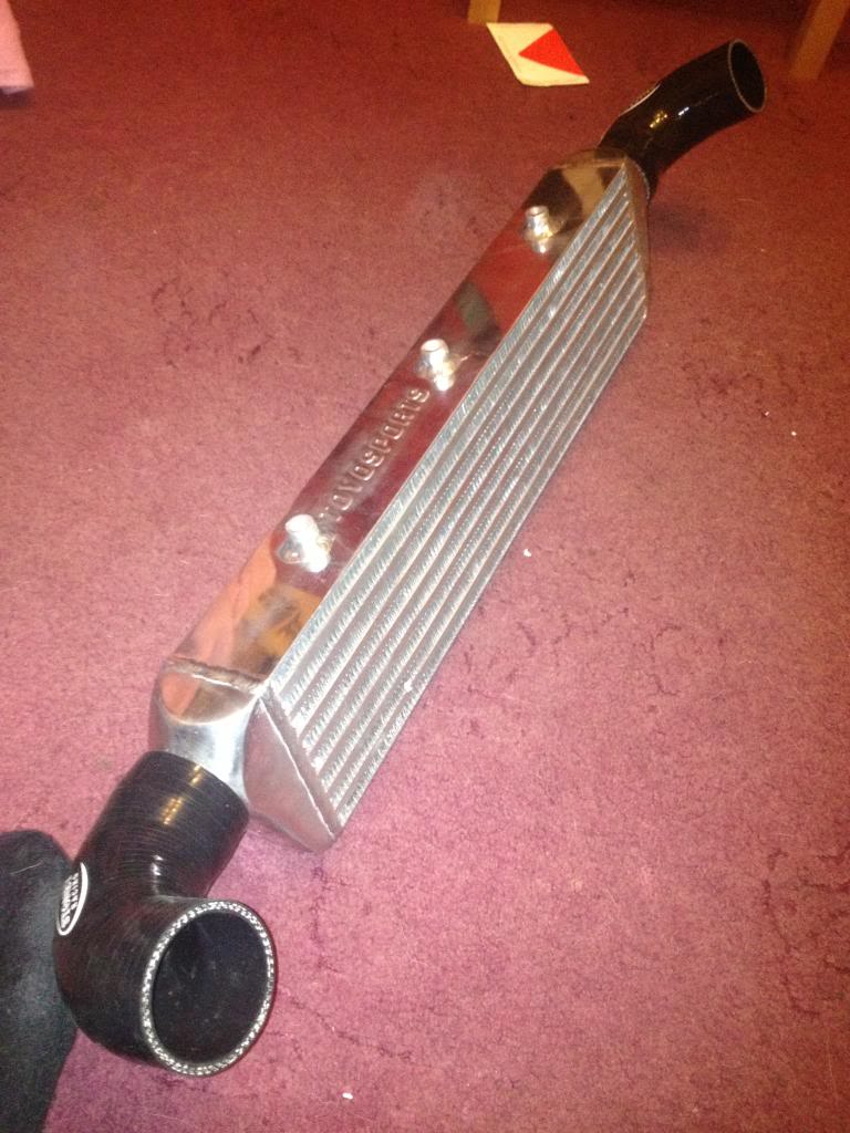

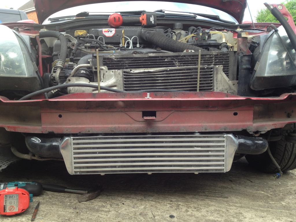

First up, fitment of my FMIC...
Studs holding it in place, Notice how f**ked my 80 intercooler is.
Studs cut down, and bumper refitted. I f**king love how awesome it looks. Not functional yet, just need to sort a couple of hoses, getting on that this week.

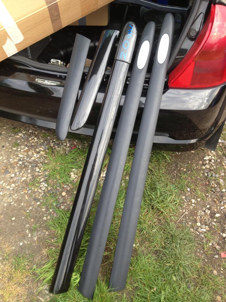

Refitted Ph1 side strips (TBH I much prefer Ph2 items!)

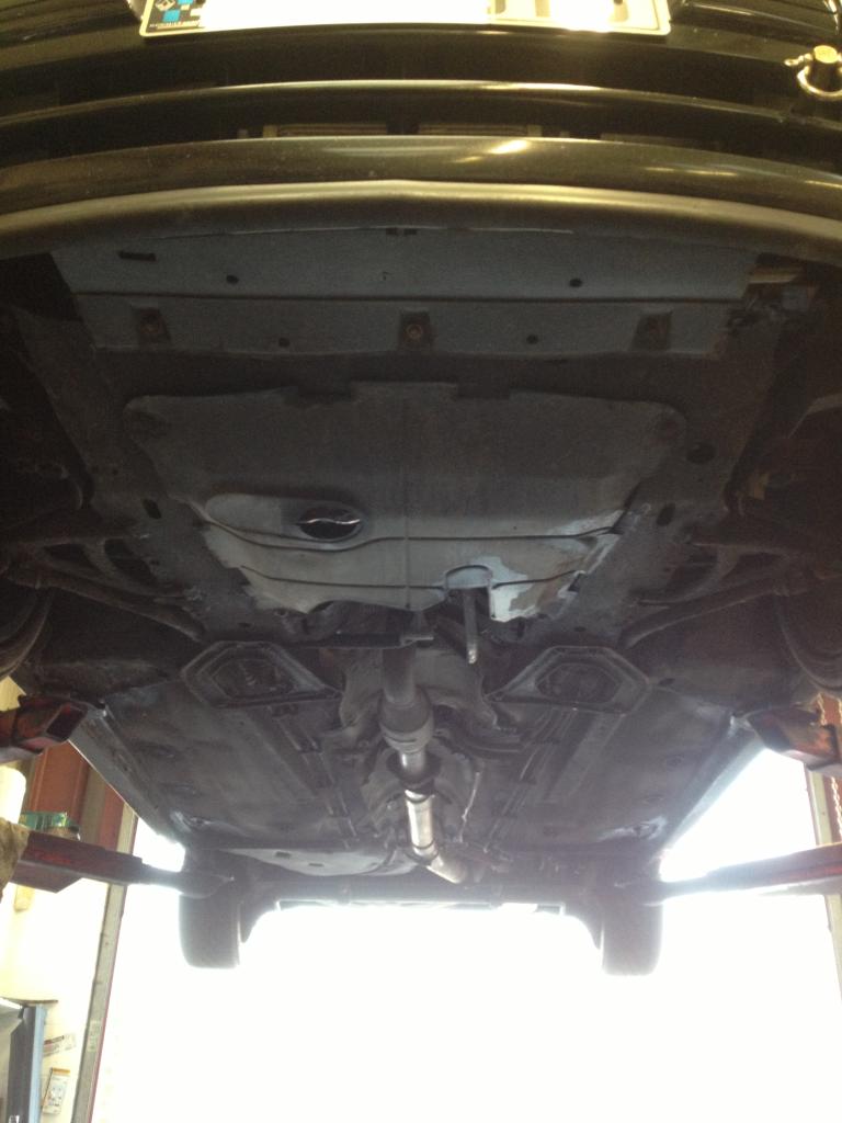

Then got it over my mates garage to get it on the ramp, give everything a good going over before the MOT.
Its surprisingly clean and everything is top notch.

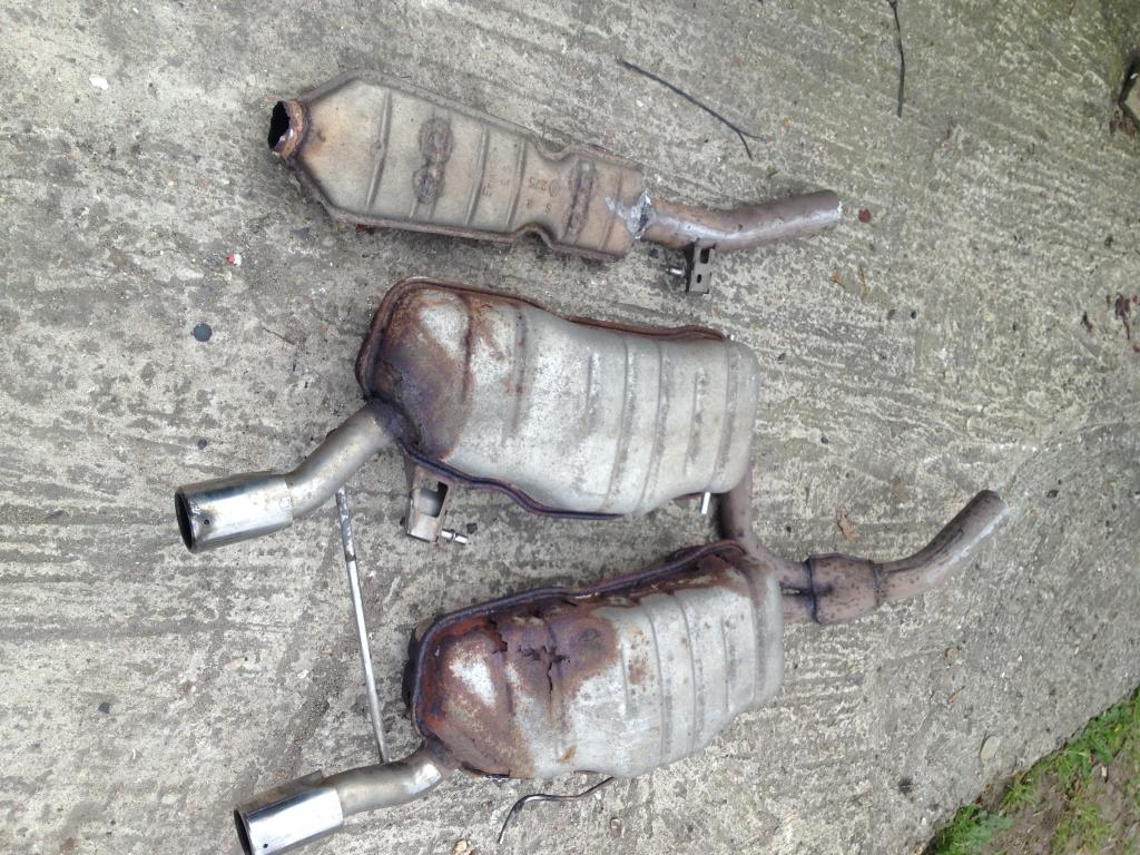

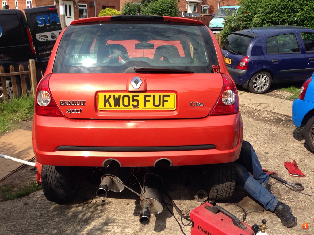

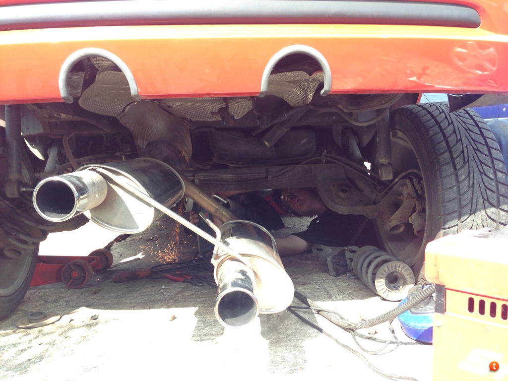

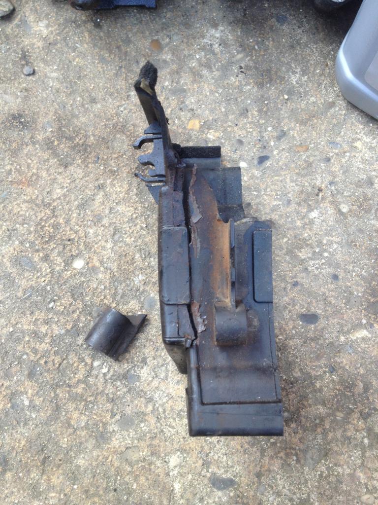

Then finally had @meekings14 pop over to remove this heavy, broken mess, off his 182, My old Inferno!
No pics but I fitted a used custom exhaust, Much better than that old thing, and in one piece! lol

Lots done buddy. Could say loads about all the different wonderful cars but I just want to have a ride with the cooler ha. Using half the lower boost pipe and going custom from there?
No idea if the pictures have added on this crappy iphone! But there should be some of the work being done!
Saved my ass by doing it for me today being as it was snapped from just after the cat! :)
Cheers Alex :)

Yeah using all the 80 pipework, and just extending it. I'll eventually (when 1.9'd) convert it all to silicone/hard pipes, but for now, a bodge up will do.
Annoyingly I forgot to measure the ID of the existing boost pipes, Don't suppose you have a spare set (or can measure a spare intercooler?), Would love you even more!
Cheers Alex :)

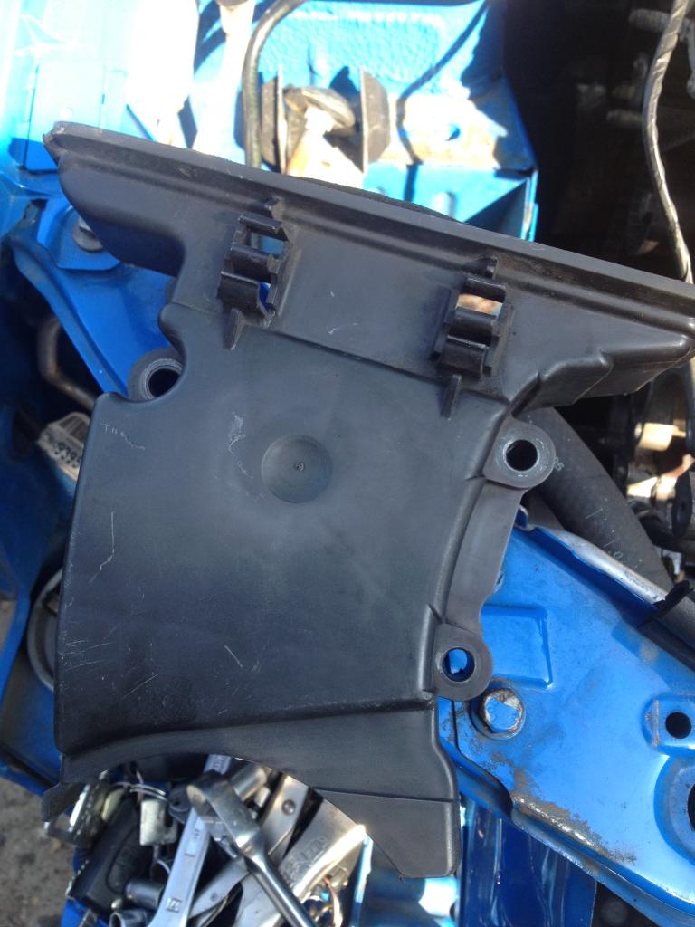

Got the RB finished today.
Old cambelt cover was well f**ked.
So a nice shiney one was fitted.

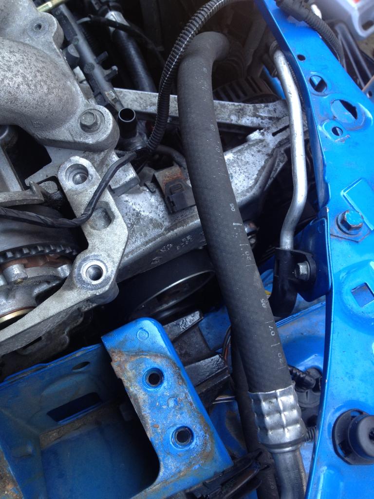

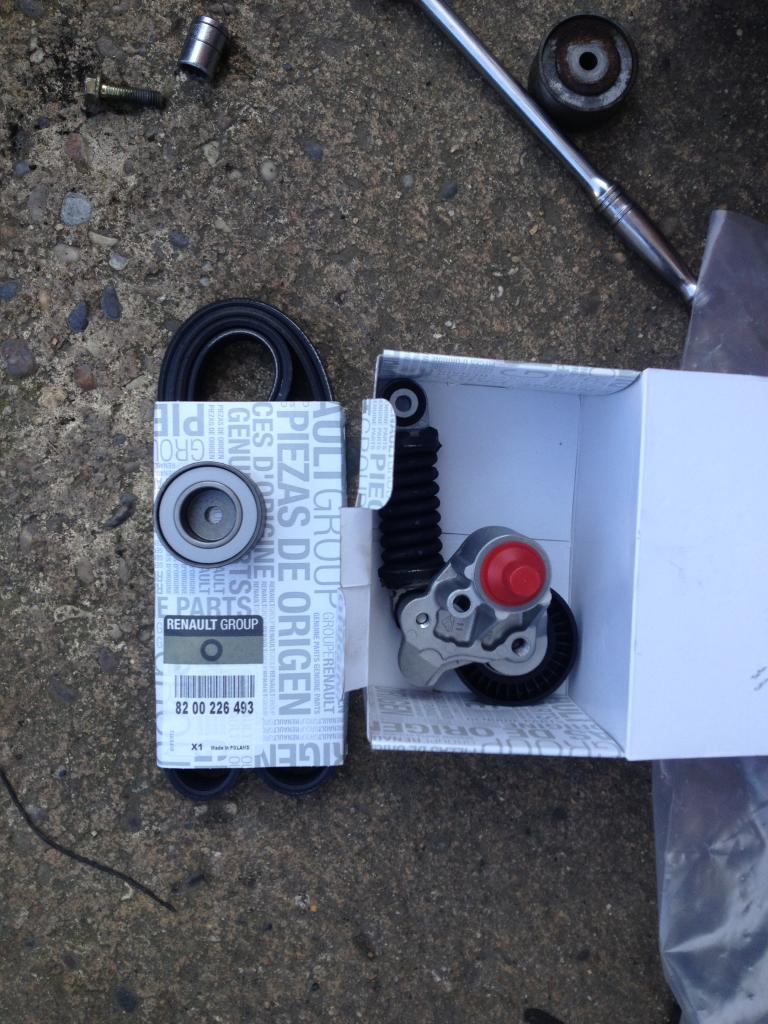

New aux belt kit, Old belt got covered in PAS fluid, plus it'd need replacing next year anyway.
Mostly back together, New top alternator bolt to replace the missing one, replacement PAS pump fitted etc.

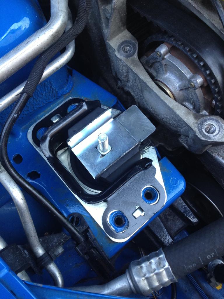

New top engine mount as the old one was ruined
Got it all back together, No more PAS whine, or leak! No pics mind.

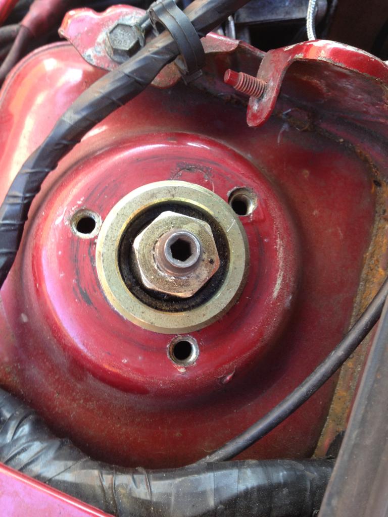

Then moved onto adjusting my intercooler a tiny bit, and dug the AST top mounts I got from dmallett the other day.
Not fitting them just yet....
I have the slight issue of having to weld up the holes required for the PMS top mounts, but won't be a big deal.
