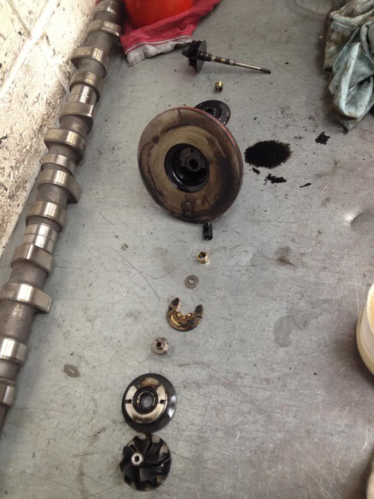

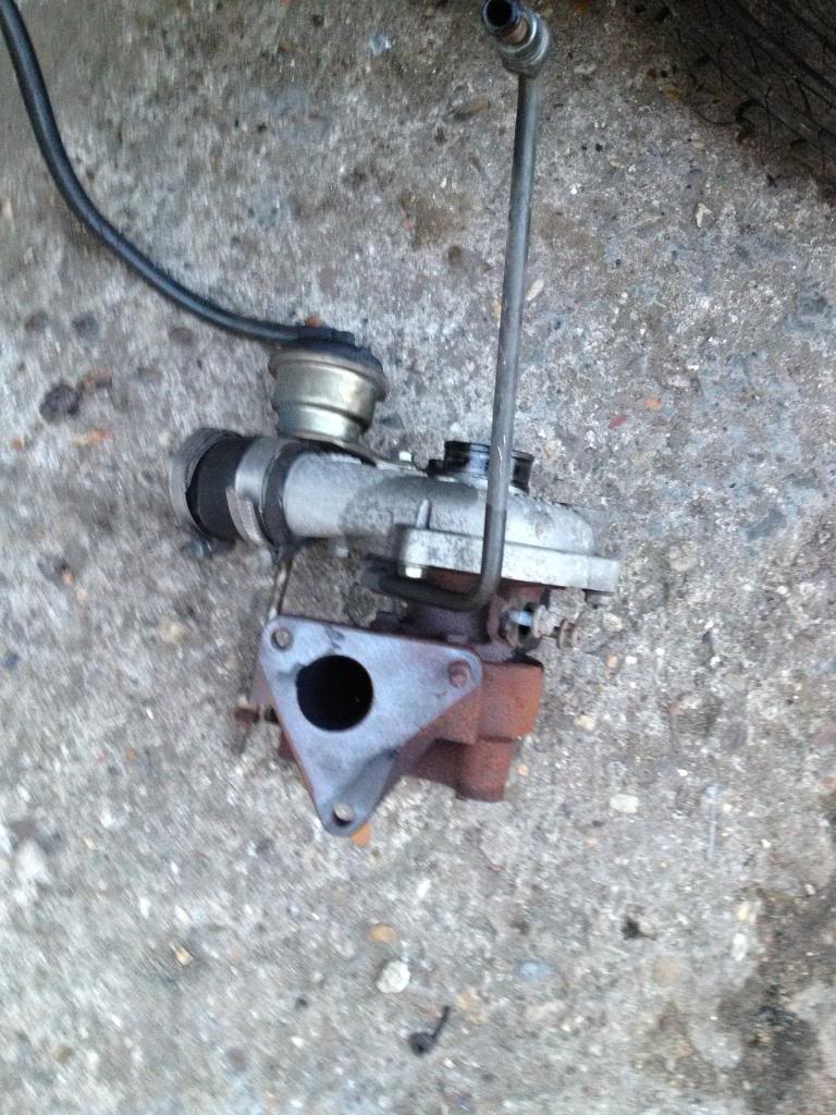

First up, a while ago, I got the turbo off the Black 80.

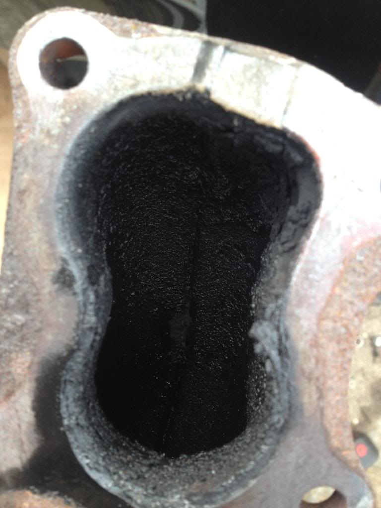

Looking into the cat, Very oiley and sludgy, Nice!
Got it stripped...

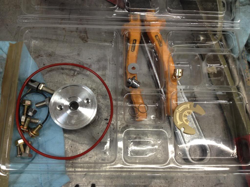

Rebuild kit, and then I lost intrest in taking pics.
I got it back together, turbo back on the car, and the whole car back together.

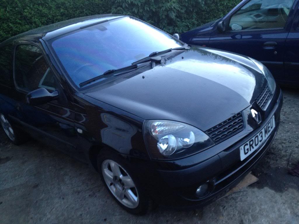

Eagle eyed will have spotted this. I sold the Black sport rep Thursday, and the new owner, this is his old car, I've got to do some work on it, so you'll be seeing more of it yet. Then he can have it back and sell it.

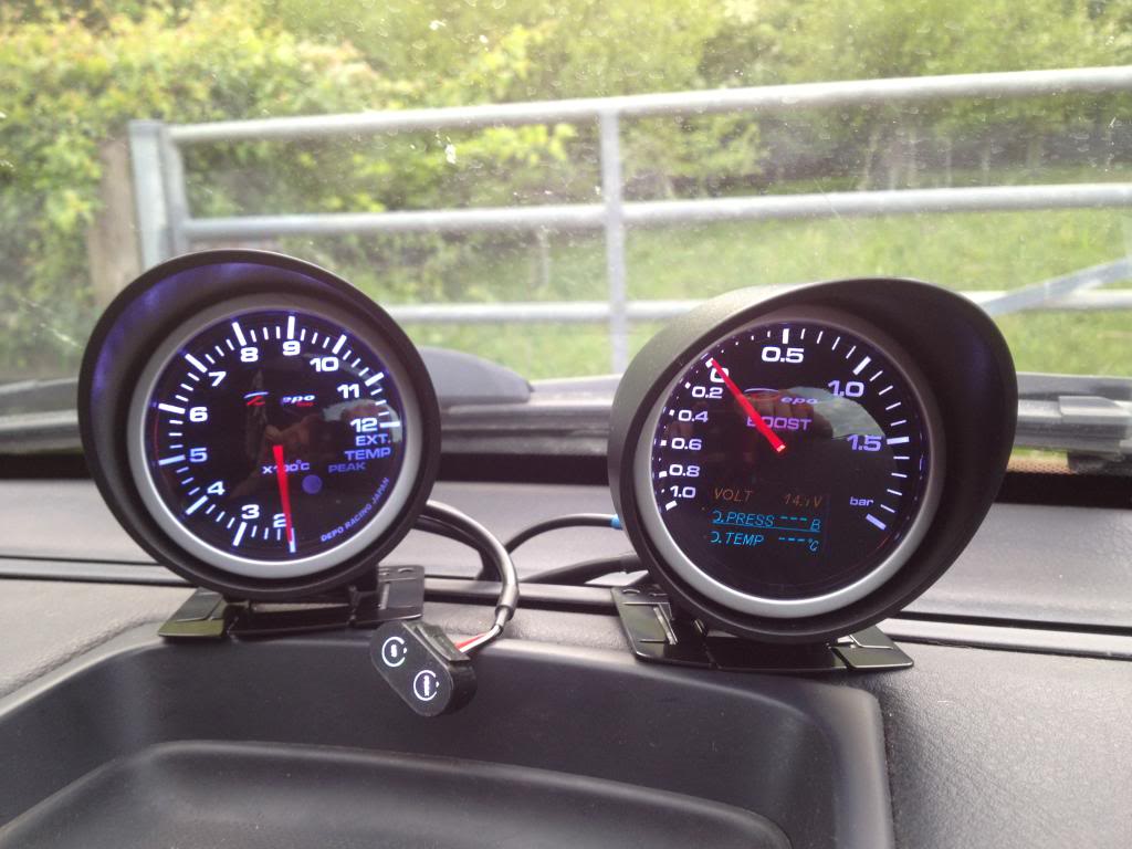

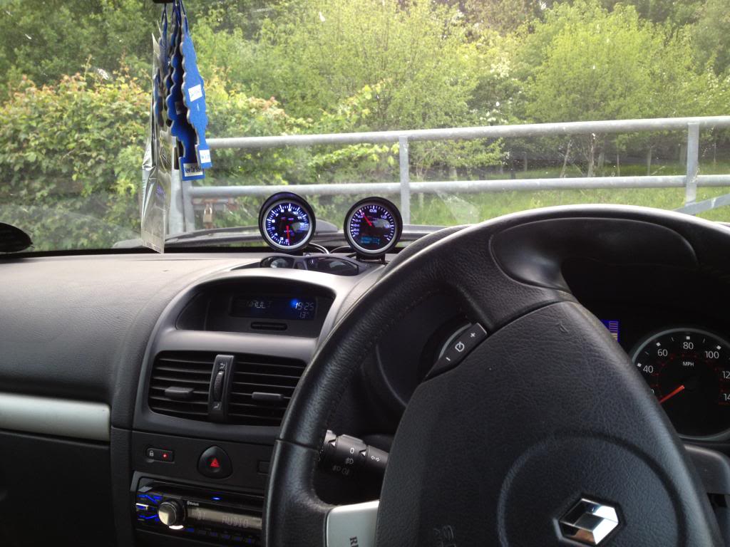

Fitted the gauges, not permanently, so hence why they look s**t.
Looks alright IMO.
Just gotta sort the oil temp, oil pressure and exhaust gas temp, Boost is sorted as thats easy.

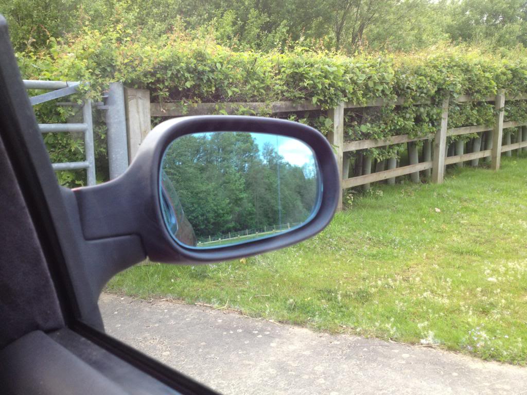

Then the mirrors, Blue tinted, Wide angle on both sides too, unlike factory. Fitment isn't brilliant, but again, it'll do.

Mirrors are cool, are they heated also?

Linky to guages ? I need a better set as mine are white and anoying me already.
I went for these...
http://www.ebay.co.uk/itm/290803628108?ssPageName=STRK:MEWNX:IT&_trksid=p3984.m1497.l2649
http://www.ebay.co.uk/itm/291094115082?ssPageName=STRK:MEWNX:IT&_trksid=p3984.m1497.l2649

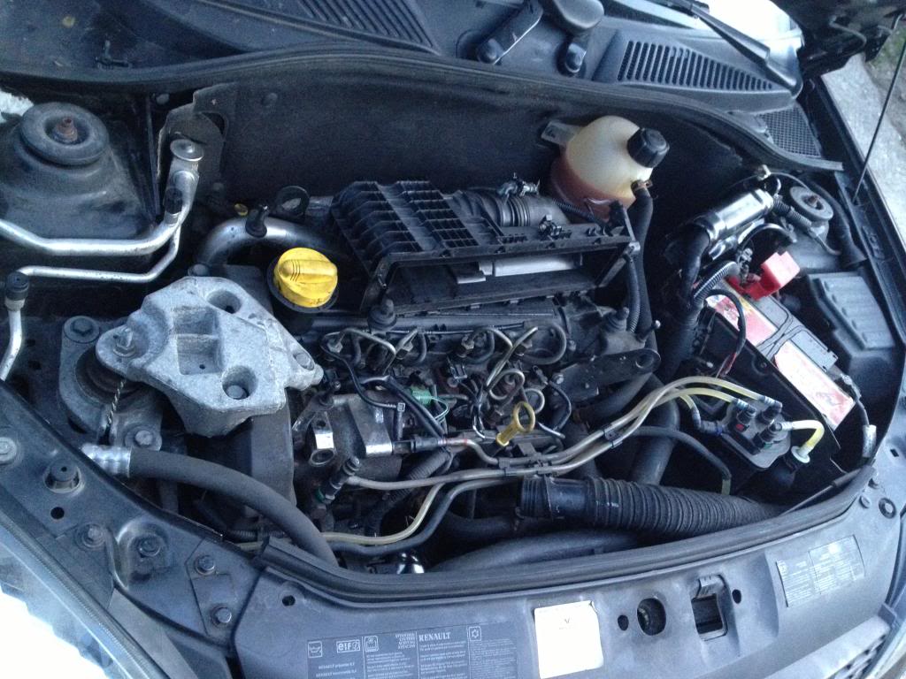

This has an oil leak now, but I suspect its just the drain not gone on properly, not a major issue yet. Still have a few jobs left.

Mirrors are indeed heated, I actually only replaced them because my new drivers mirror has a broken heating element. Won't find out how good they are until Winter really lol.

My drain for the oil leaks aswell, new gaskets / pipe and new bolts torqued up, still leaks a tinny bit.
I might out high temp sealant on it when I put it back on

This like pisses out, I built up oil pressure and it left a puddle of oil lol. I don't mind a very very minor leak, but this is badd lol.

Just a idea Alex but are you sure its leaking out of the return ? reason I say is that I noticed you took the turbo off with the oil feed pipe & were it fits in to the head there is a rubber o ring that falls off or self destructs & with it being on the pressure side oil pisses out , worth a look ;)
  Many.
I'll check that out, but I think its return. Although it could be the feed out of the head, I've not actually looked at it yet lol.
I think the O-ring is still on it, maybe I'll pop it off and replace anyway.

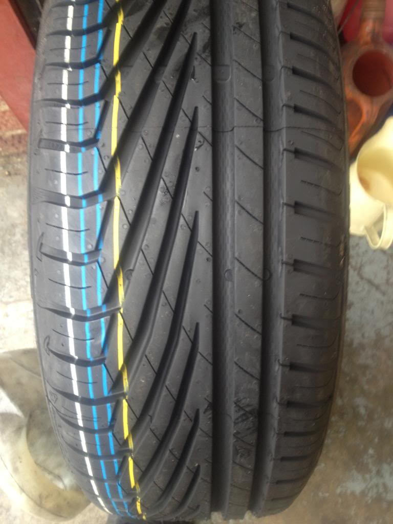

Also some Rainsport 3's for the Black clio, Tread looks funky.

those tyres are epic. Had a set on mine. Pisses all over rain sport 2's!

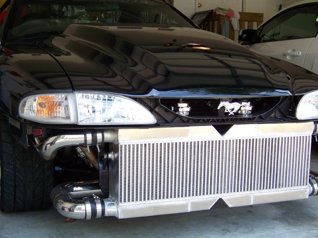

(Terrible Intercooler pic)
Those tyrez iz mint to be da ntz like. Were out of my budget, maybe next time
Shhh you. What cooler? lol.
These were like £7 more than cheap s**t, so figured I'd go for these. Unfortantly these are only for the back of the Black 80, So won't feel the advantage. I'll change the fronts to match once its on the road and I've felt some understeer lol.

The mirrors are not perfect fitting? I'll leave it then as Im a picky f*cker! ;)
Look next time you see my car. You could probably do it perfect if you didn't rush it like I did, but I was eager to get them on, and try my boost gauge up the road lol.

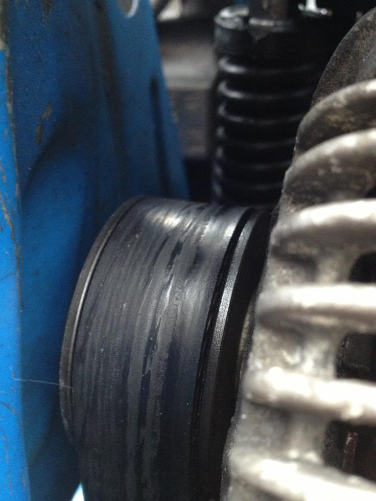

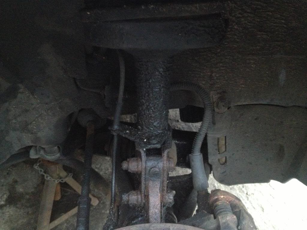

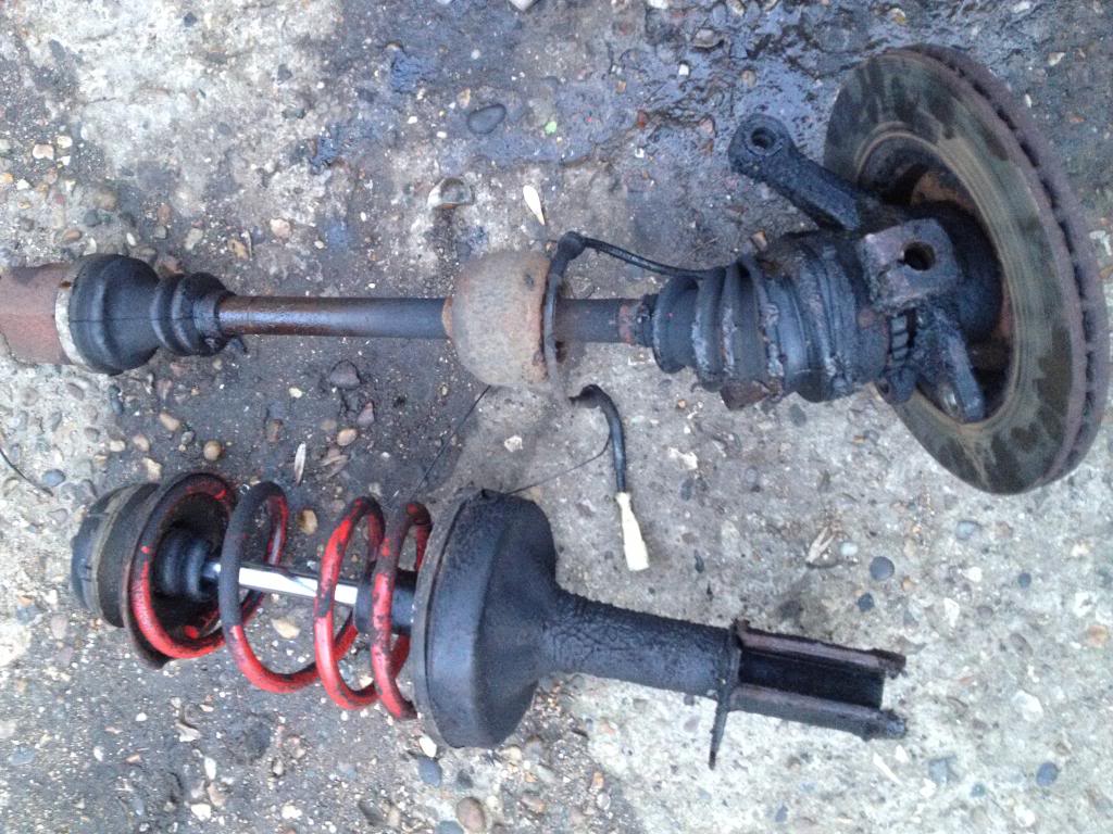

I already knew the problem, but apon removing the wheel it soon becomes very clear.
That is lovely shock oil, and CV grease.
Took the whole lot off, will clean it all up, replace the bits I need to and get it back together tomorrow hopefully. Its having a new shock, standard springs refitted, new track rod ends, new lower balljoints and a bloody good clean.

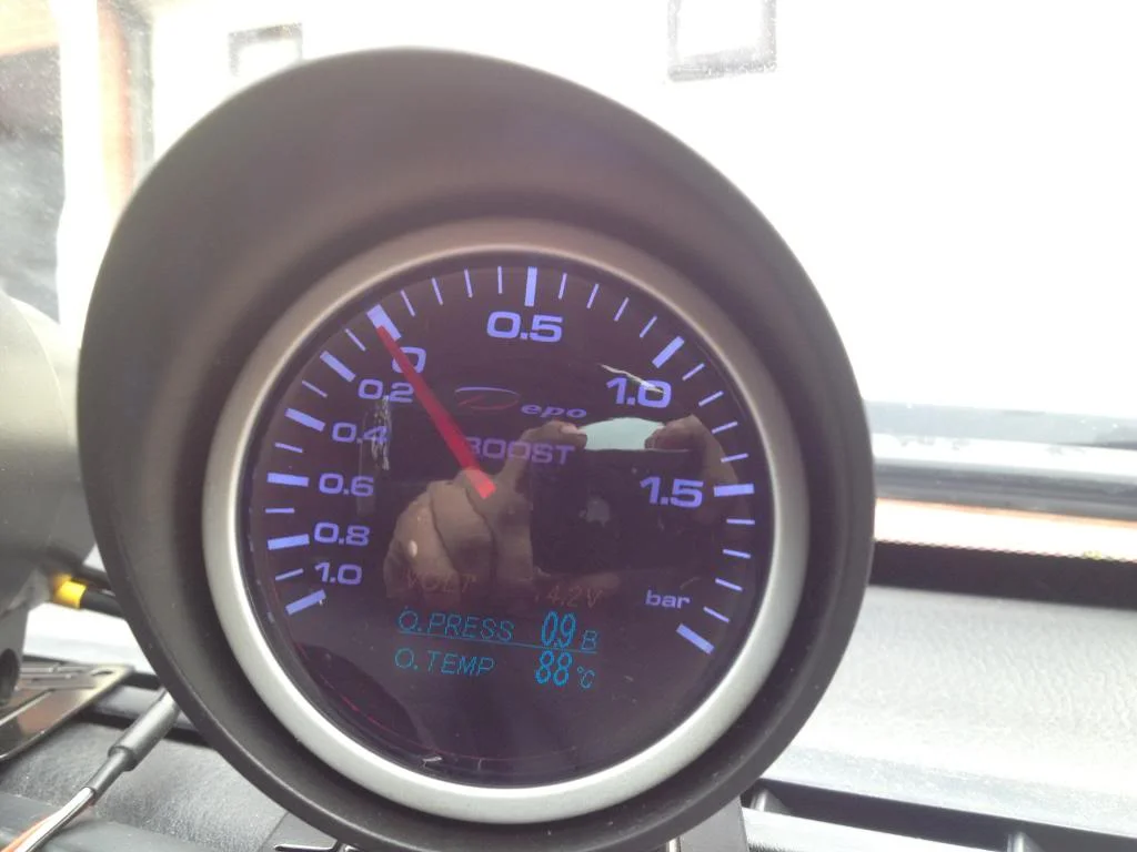

Also, fitted my sandwich plate Friday night, so have working Oil temp and pressure on my gauge now.
Pressure seems good, temp is good too, max I've hit so far is 99 degrees with a bit of a rag. Will see how it fairs on track.

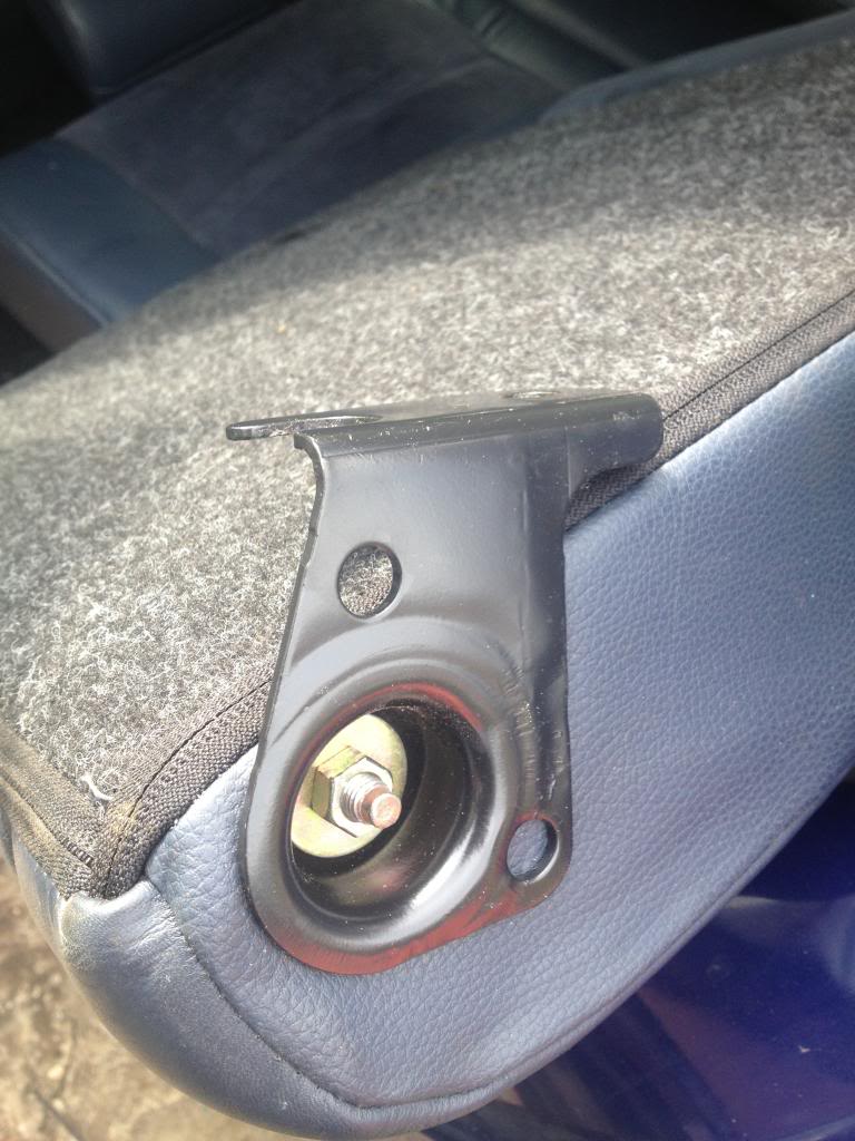

I desprately need these, the two halfs that hold the centre of the rear seat to the floor, on split rear seats.
Anybody?!!

Fixed the oil leak on the Black DCi, as RenMatt said, was indeed the O-ring missing on the oil feed. I owe you a beer.

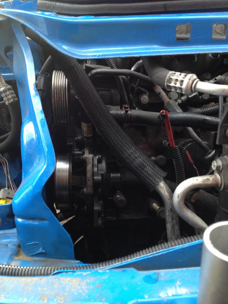

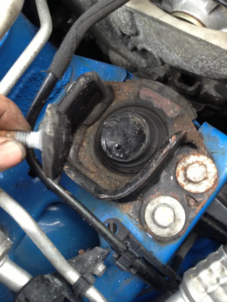

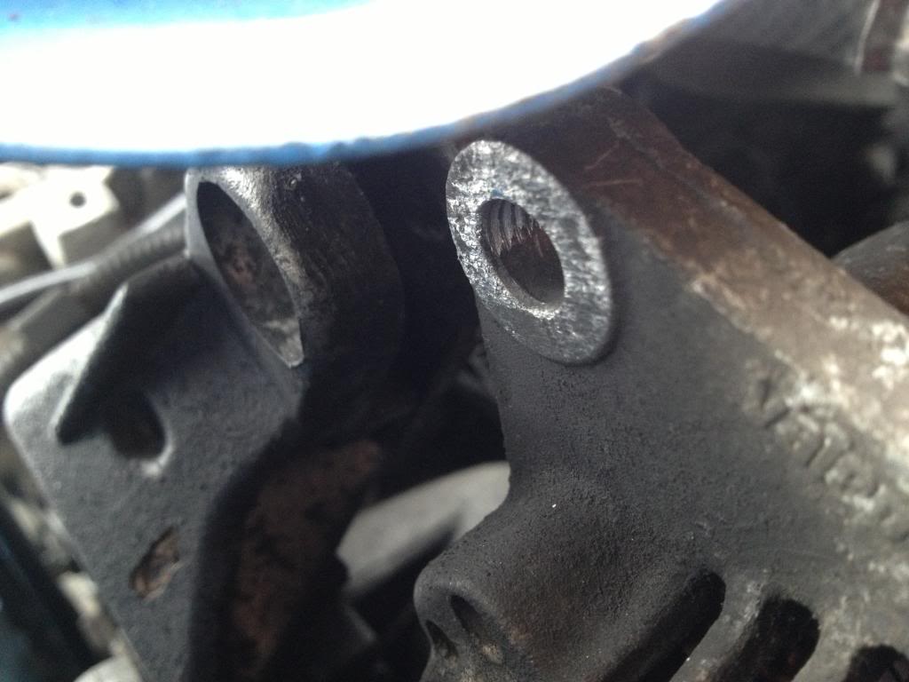

Started stripping it, Firstly found a broken engine mount...

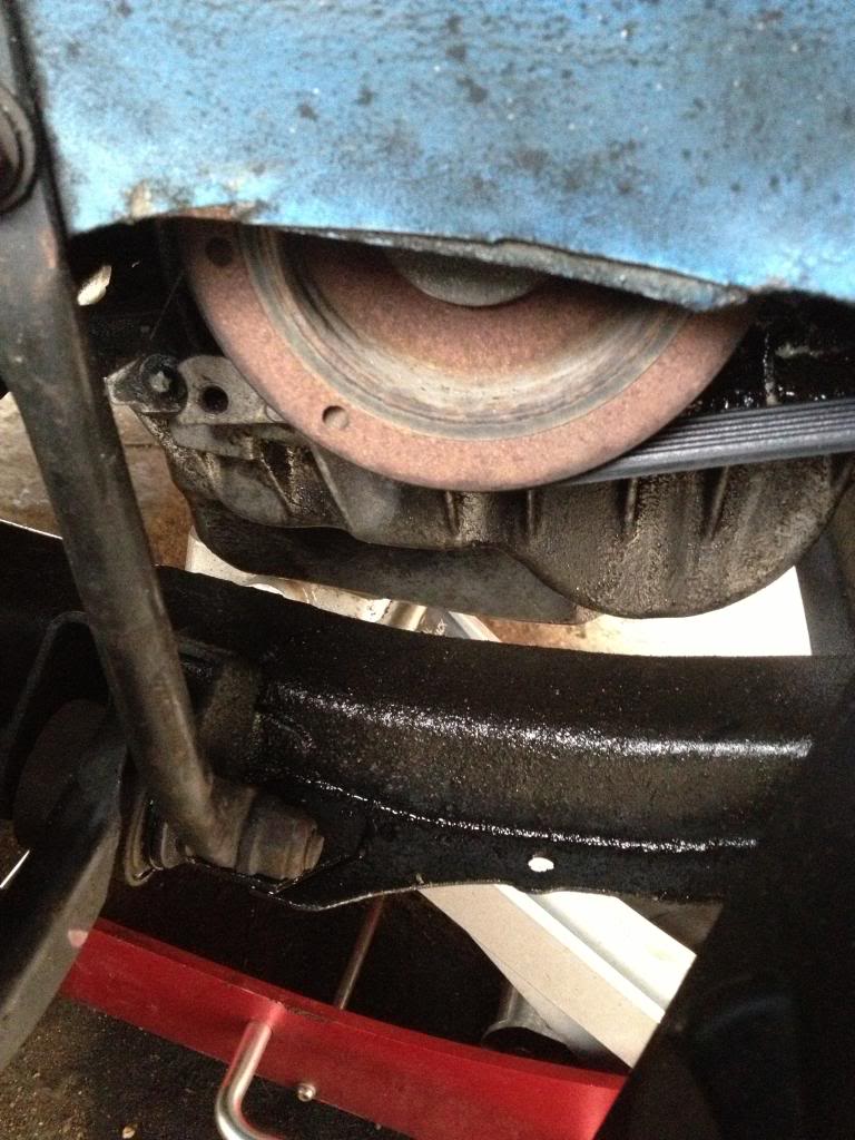

Looking a bit wet, over by the PAS pump...
Looking even worse down here

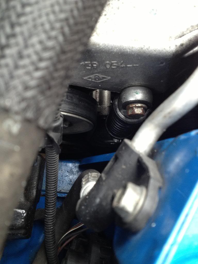

Oh look, a bolt missing!
Nice aux belt...

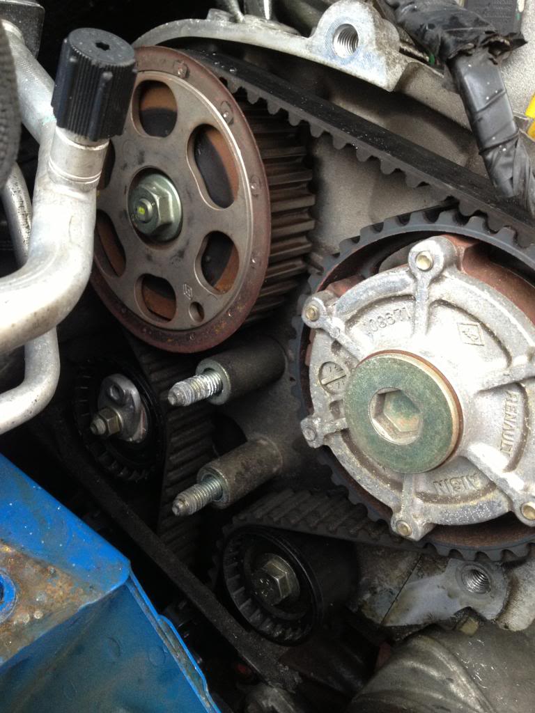

Just confirming its not cam seals, lovely and dry. Belt was done 2 years ago, with dephaser, looks like it was done right and looks in good condition still. Will give it a proper check before I put everything back together.

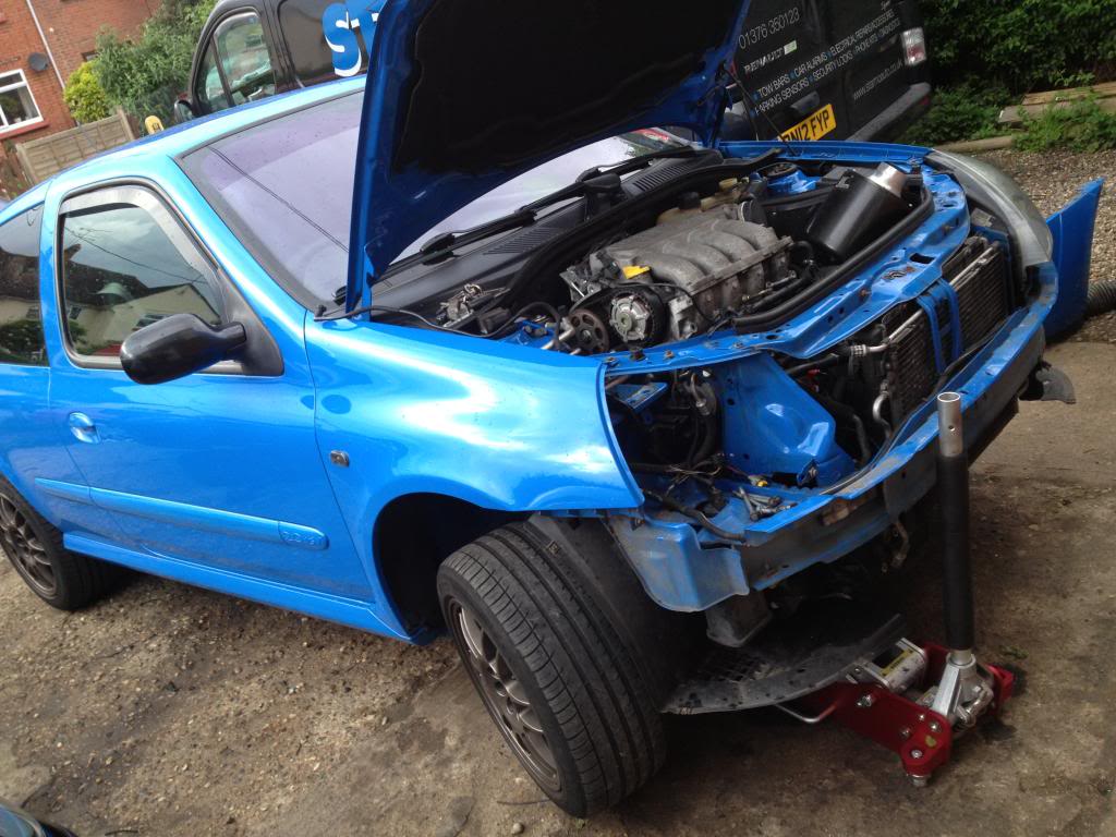

So stripped everything out the way so I can change PAS pump, and aux belt kit.
Poor car

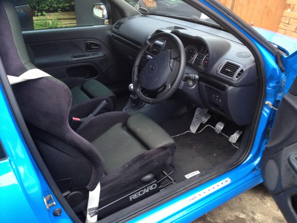

Quick interior pic, it is a very nice car.
