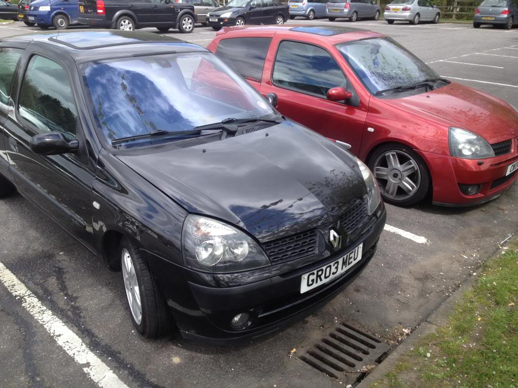

So, its a completely standard Ph2 DCi 80. Has Climate control, Electric Sunroof, Auto wipers/headlights and leather steering wheel. Would have preferred a Ph3, but this will do.
It needs a turbo, as its smoking like a bugger on boost, but drove home lovely (hardly smoked when taken easy!), Plan is to tidy it up a bit, then give it to my mother as shes in need of a car.
Can't complain for £600!

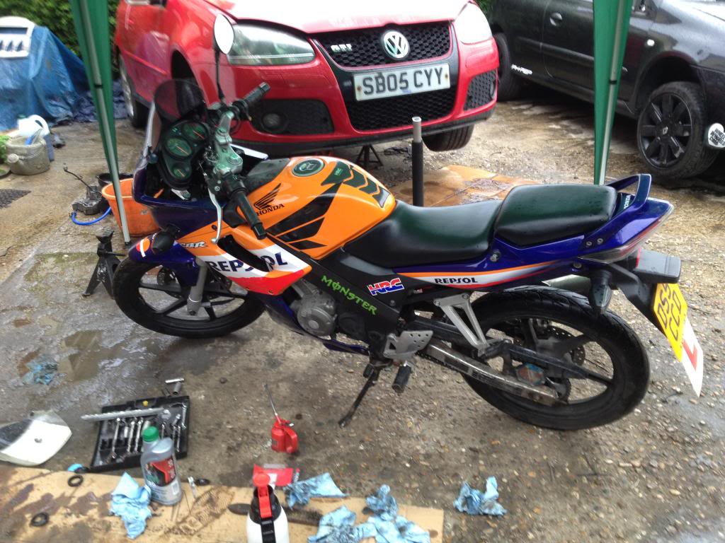

Then used it to work on this, Its my mates. Changed fork seals, fitted new screen, tightend chain (and lubed) plus some other small bits.
Rode it around the block, the want to buy a new motorbike is once again strong. Need to get these Clio's gone!

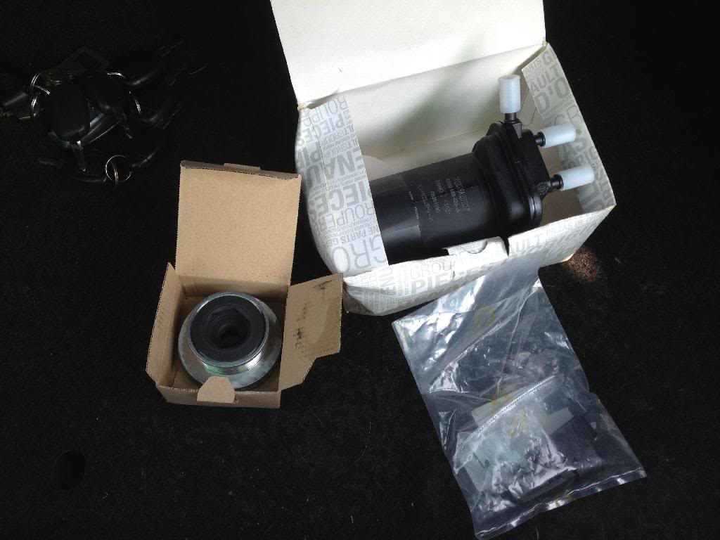

New alternator pulley for my flamer as the old dampened one died, new fuel filter for the new black one, and a number plate light, for one of them. All brand new Genuine Renault.

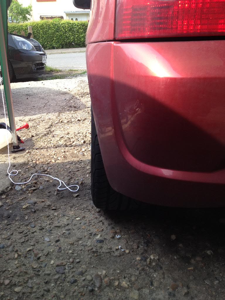

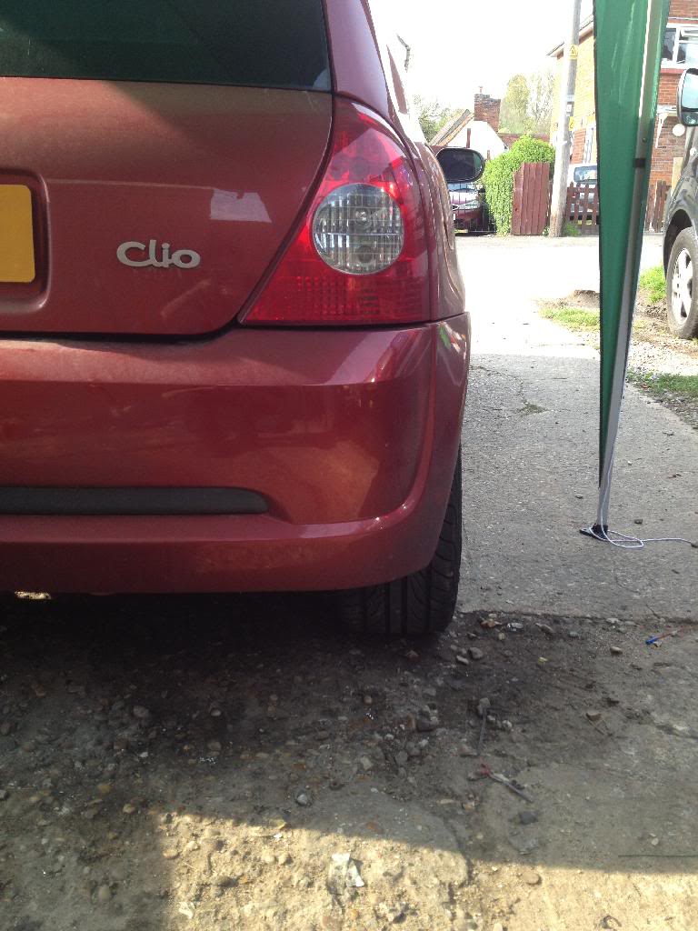

Heres before, circa 3degrees negative.
Still looks okay in here considering it was probably 10k ago I fitted all the rear beam etc

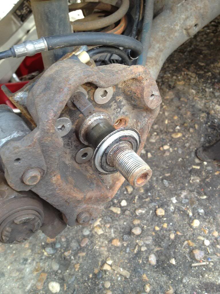

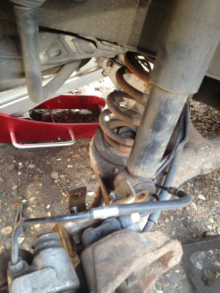

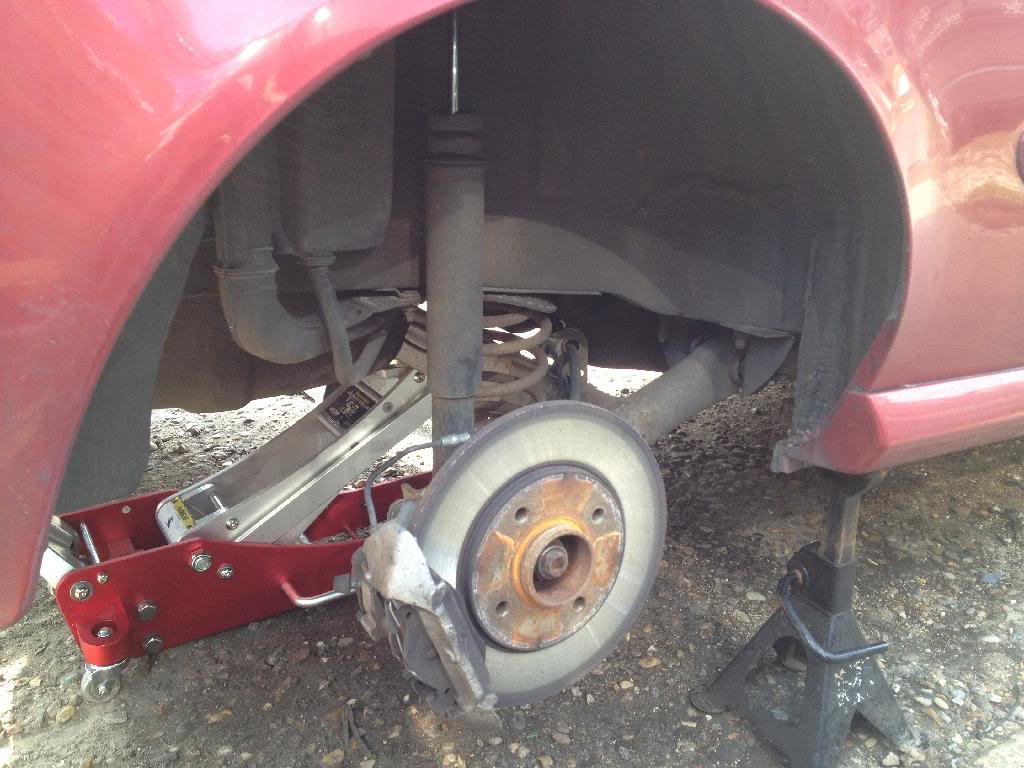

Carrier off
Disc off, not forgetting the little washer
Shock un bolted and wedged out the way
Stub axle etc removed, shim fitted, new bolts fitted (because the M.A.D. ones are soft as s**t)

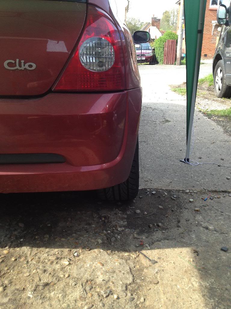

After
Should be circa 2degrees. Much better. I was conviced it didn't drive right for the first mile, but seems fine now and handles alright too.
Rear end seems a lot more planted, could induce oversteer before, now it feels a lot tighter.

Looks a lot better. Need to see it in person to clarify but is 2 degrees still a bit much?
I had a look when I parked it somewhere. It probably is a bit much still. I need like half a degree I think, but thats such a small amount. These black shims were 1degree were they?
Its taken me months to fit the shims, so it'll take me even longer to change it again.
