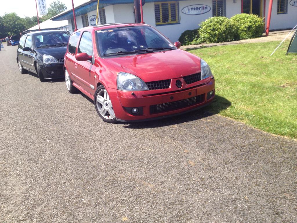

Got one pic from FCS, Haven't seen any track pics of it, not that it surprises me tbh. Just before I left, looks much better with no front plate. Full lock is due to feeling the driveshaft lol.

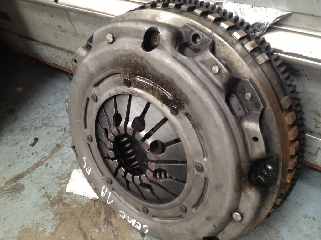

Today had this huge fucker turn up... Single Mass conversion flywheel & clutch for the 1.9. Its used, but it cost me £40 delivered! Will find out what the clutch is from, and then order up a new one.

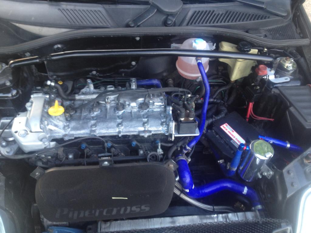

In other news, Ventura's Ph1 passed the MOT the other day, and I've finished removing the blue paint from the rocker cover & breather plate. Will be painting silver soon.
Excuse the terrible pic, I was holding the bonnet at the same time!

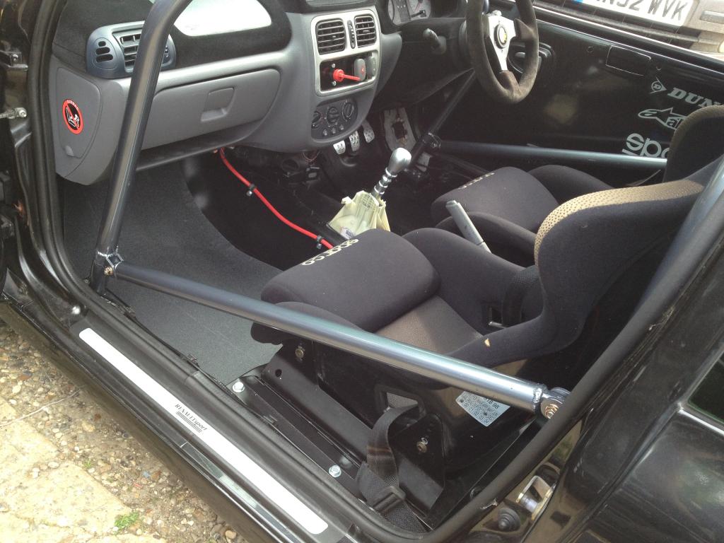

Feels like some real progress today, brilliant day, helped by Dr Blast @Dr Jekyll too!

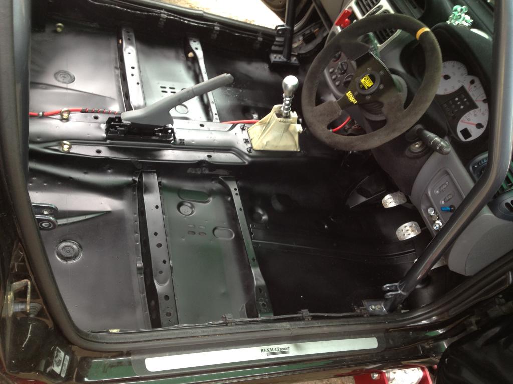

Started at 9AM this morning, With this.

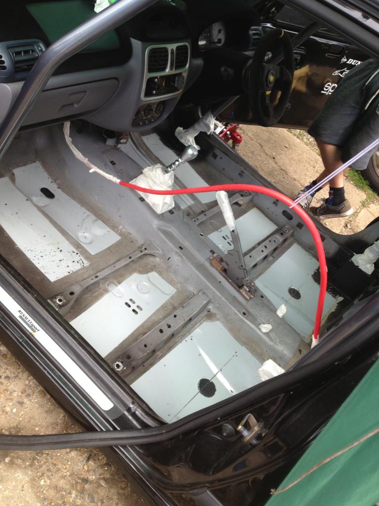

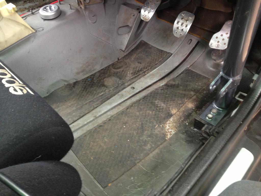

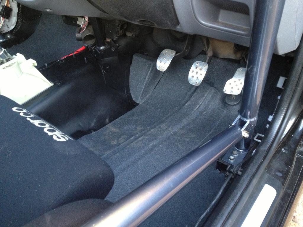

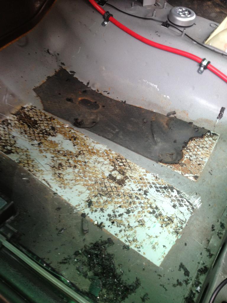

Started removing the sound deadening tar on the passenger floor....

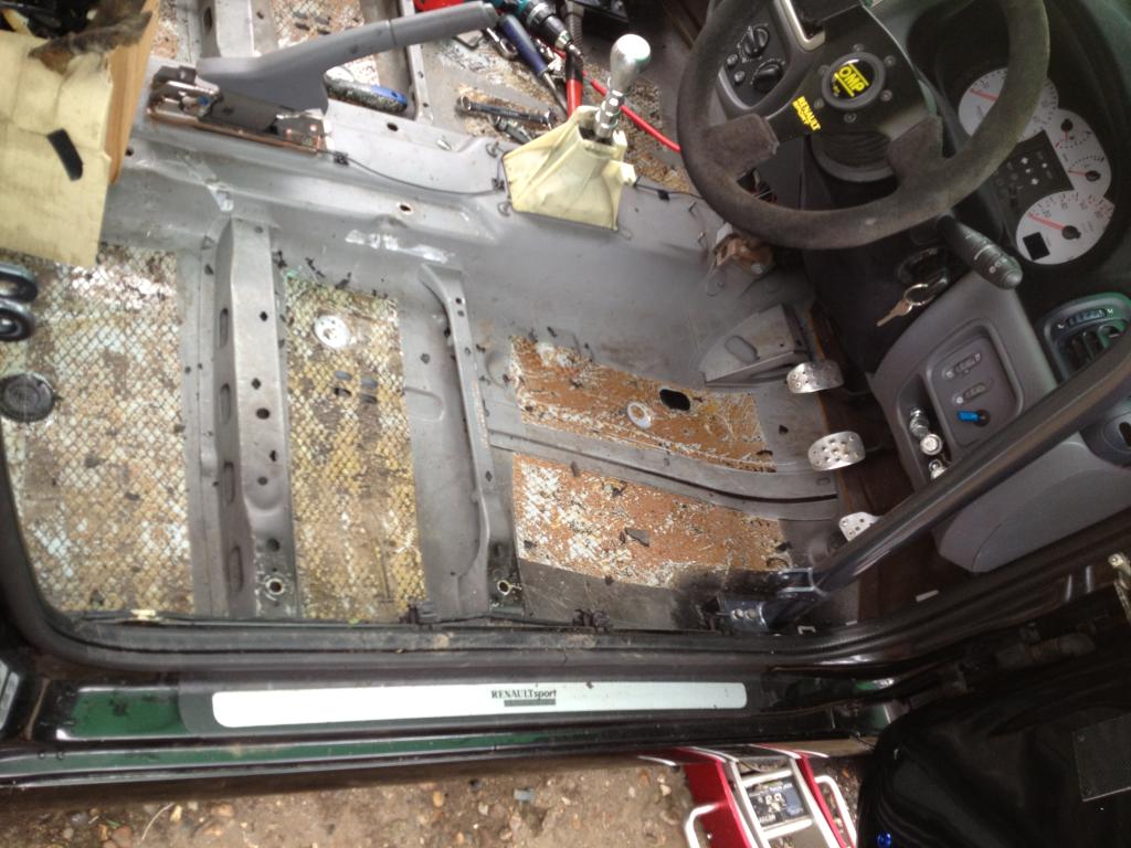

Got the seats out etc, started removing the rest of the sound deadning
and then the sticky stuff left.
Once all that was gone, masked up, prepped and ready to paint!
Two coats of Satin Black later.....

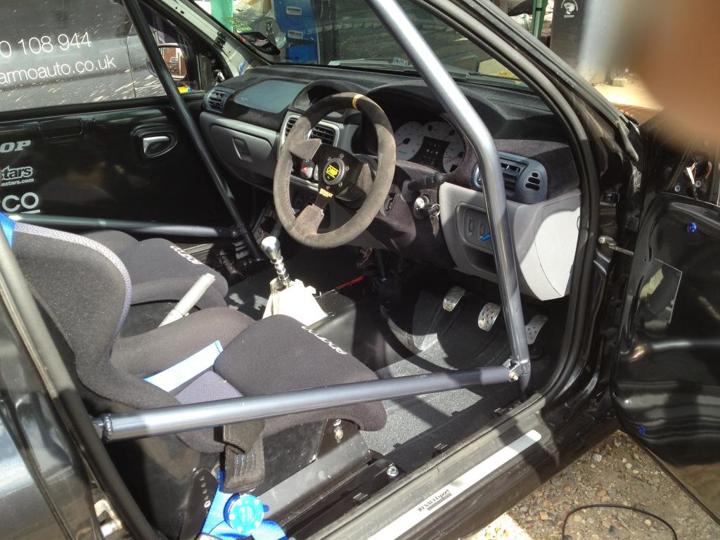

Chilling in the rain/sun/clouds...

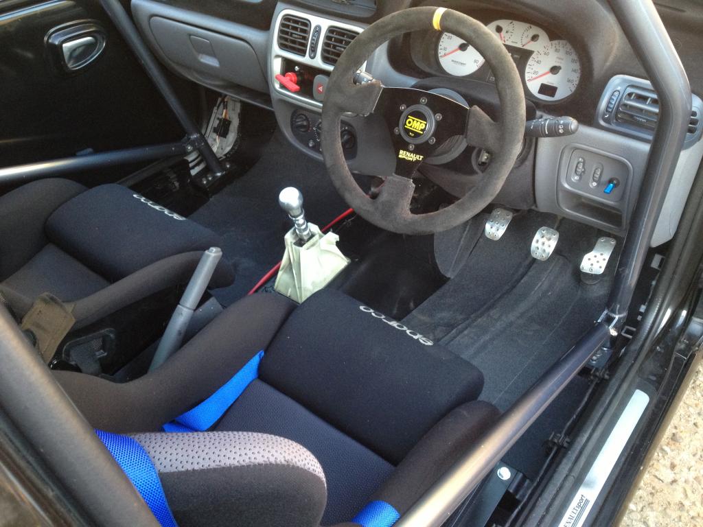

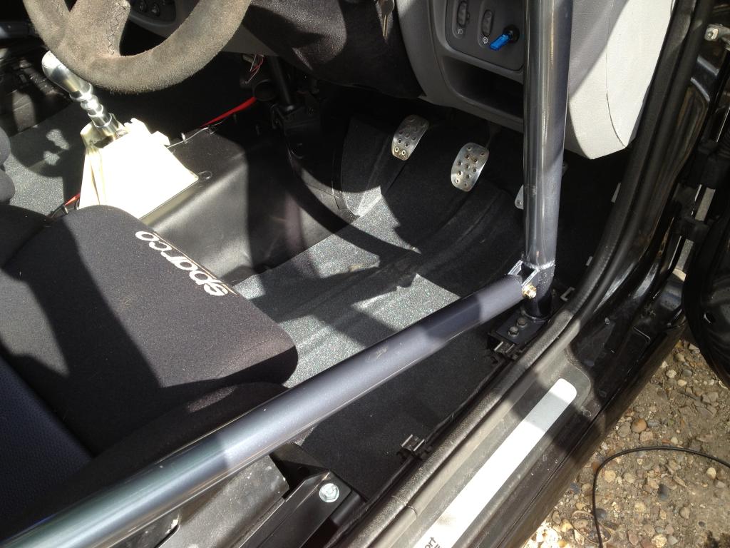

Everything back together, and then skateboard grip tape fitted to the high traffic area's
Drivers side too
Looks much better!

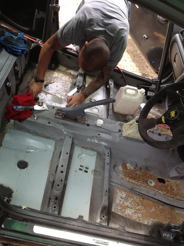

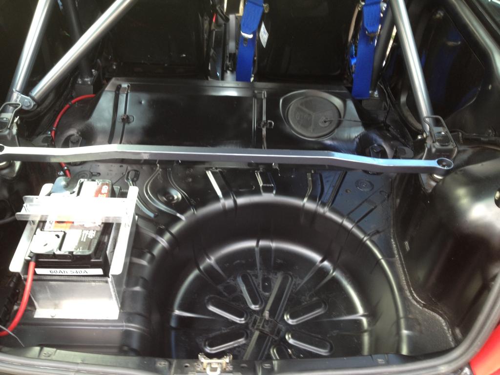

I felt the rear was looking a bit tired vs the front, so painted that too! Finished job...

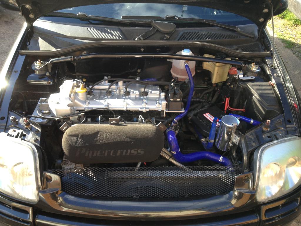

And Dr Blast painted the rocker cover too.

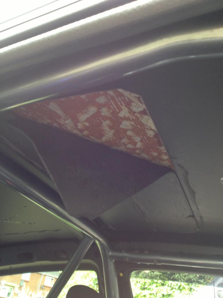

Started pulling the tar crap off the roof too, got half of it off before I got bored and fed up with it, so will finish that tomorrow.
Big up to @Dr Jekyll for helping me today, Helped a lot.

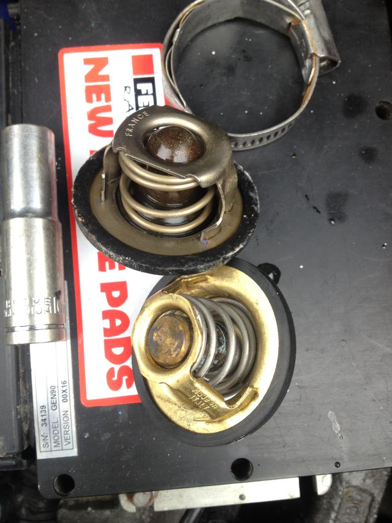

Drained the entire coolant system and flushed as much as possible, then replaced thermostat

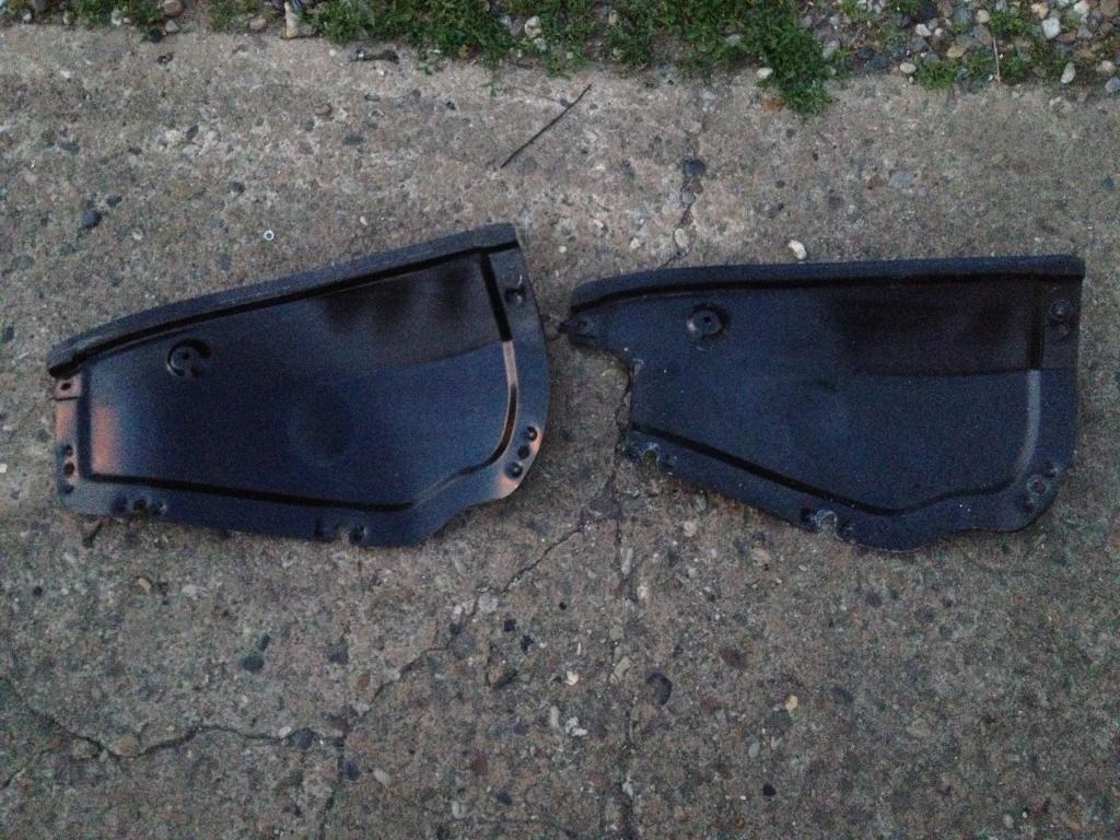

Tonight I swapped the bulkhead panel from AC, to non-AC, fills the hole and looks much better.
Few more bits to be done still. Need to spend some time on my own car, as I need to temp fix it, as its just fucked to be honest.

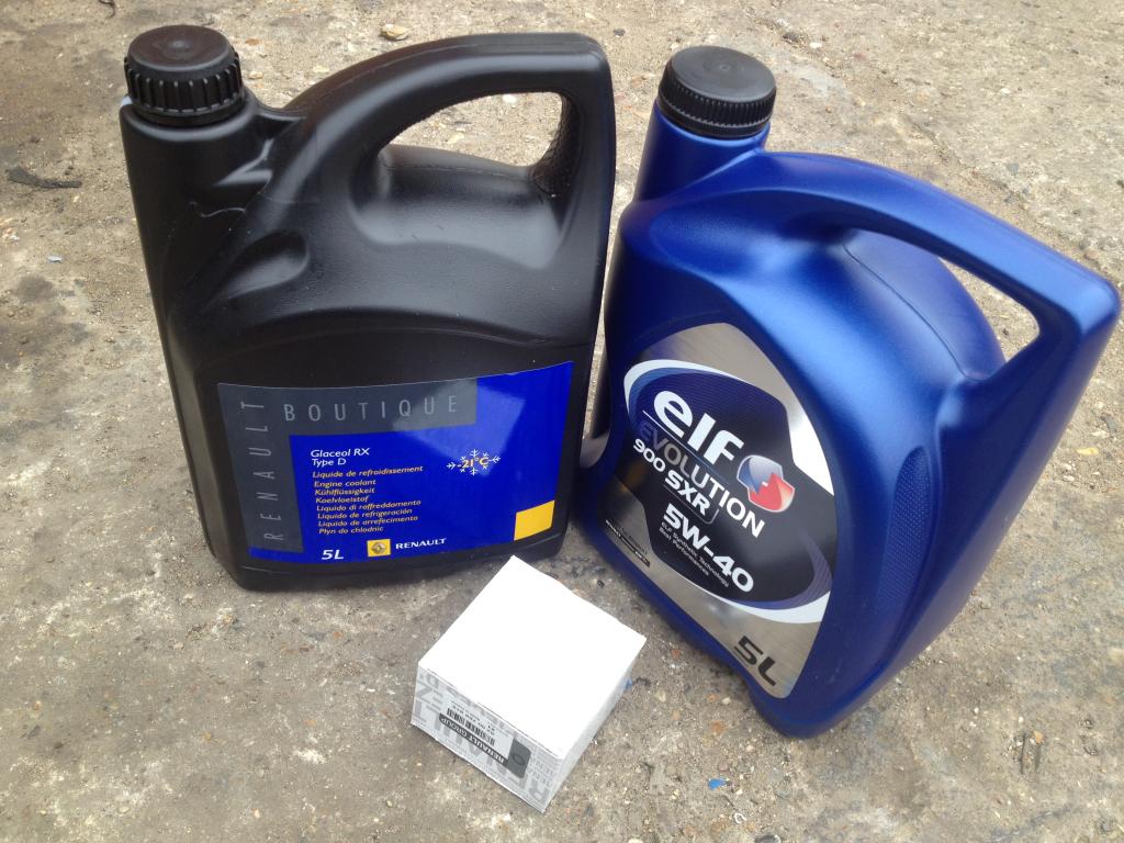

Genuine stuffs used

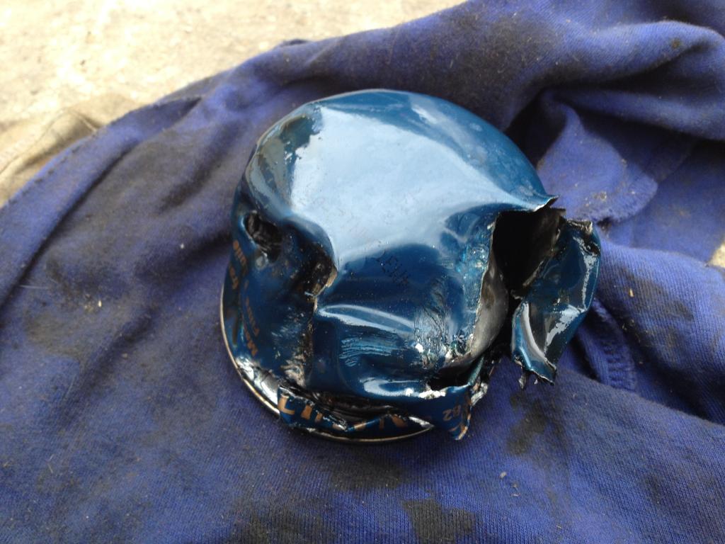

Mashed the oil filter getting it off, it was f**king tight.

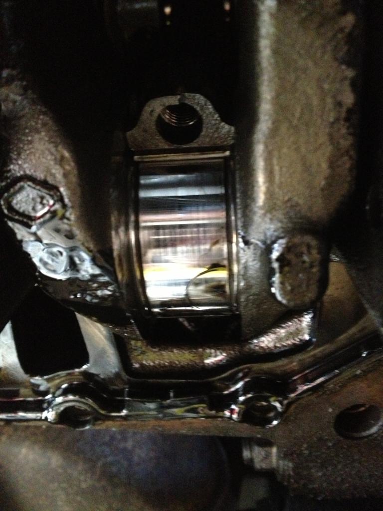

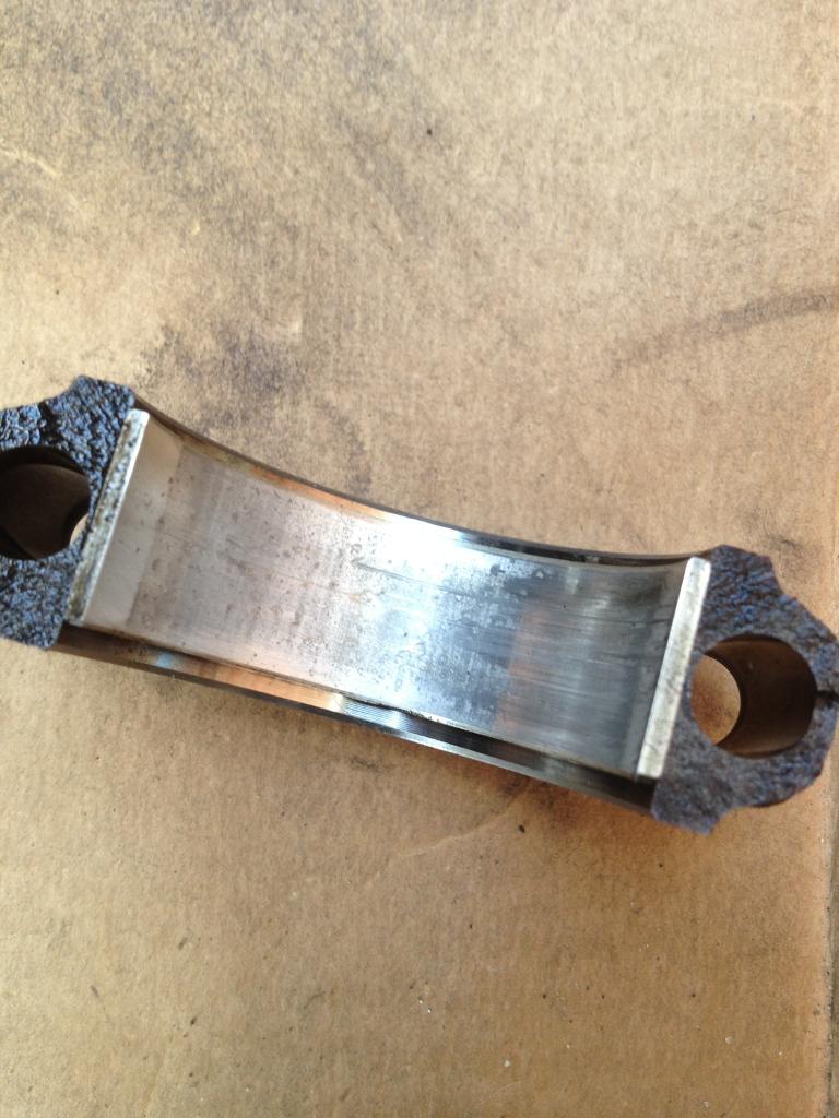

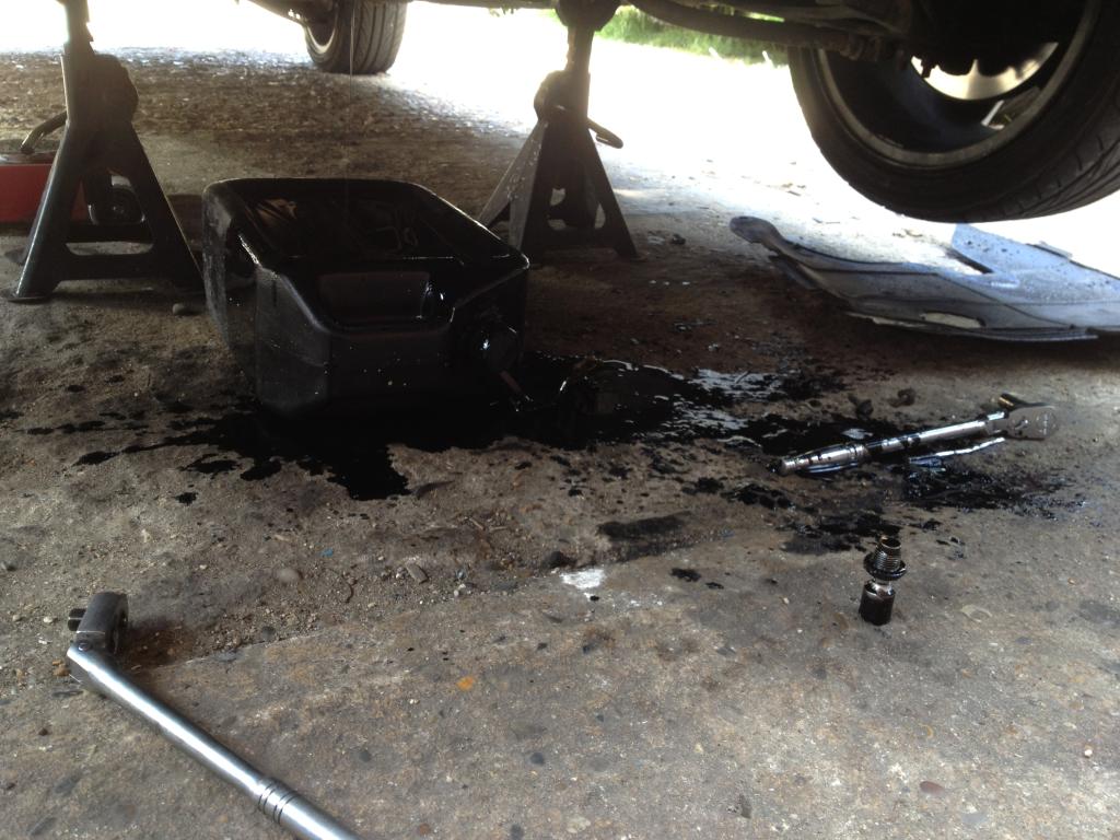

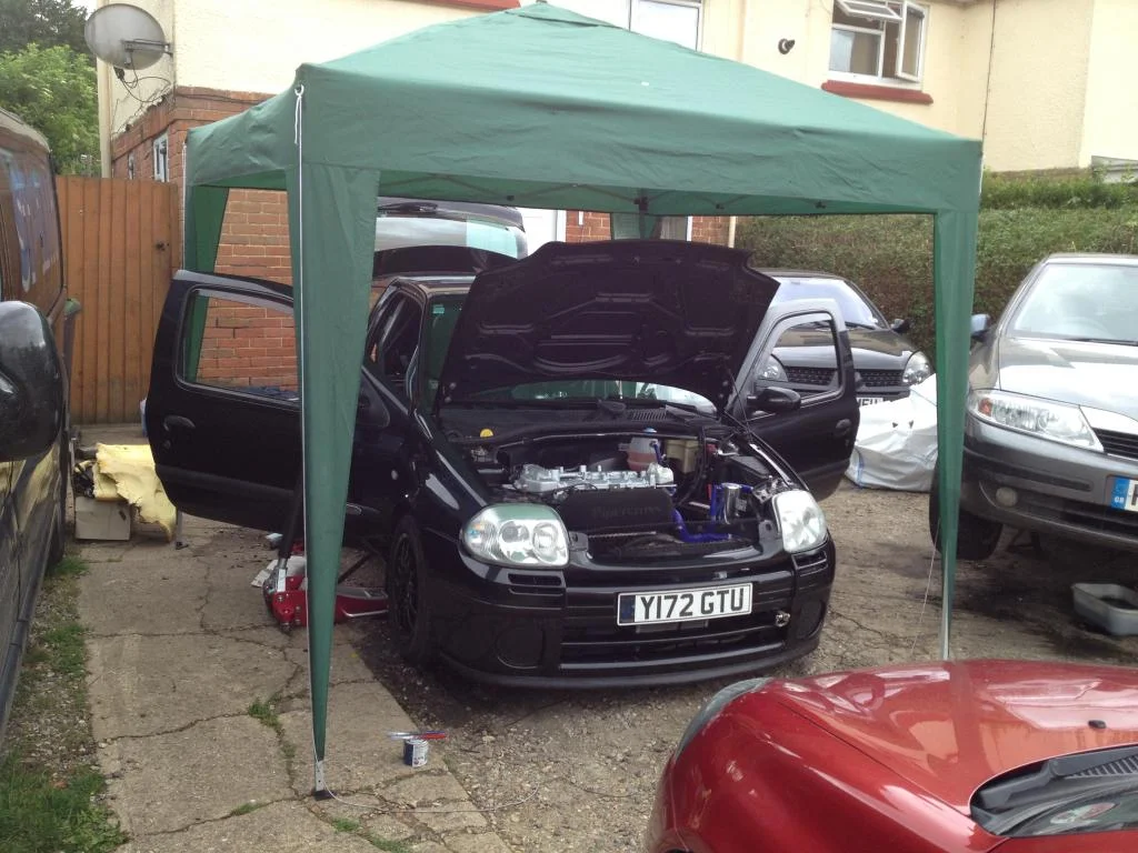

Engine has been knocking for ages now, but last night, it got real bad. So dropped the oil this morning, finding out how bloody thin it was, with it spashing f**king everywhere

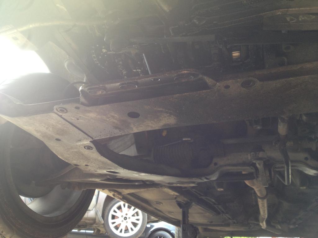

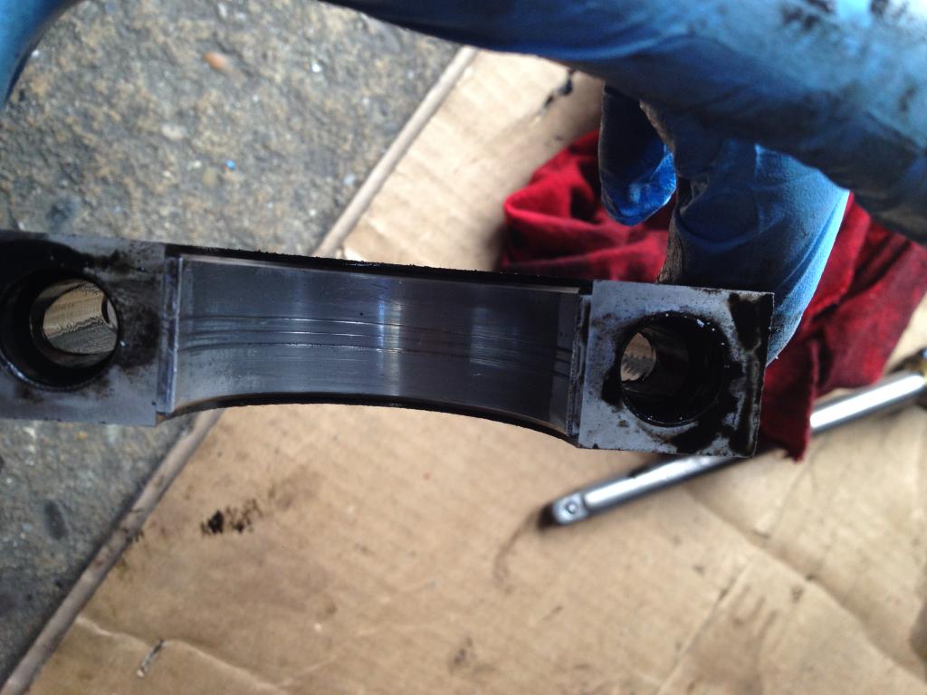

Terrible pic, but I then dropped the subframe, and removed the sump...

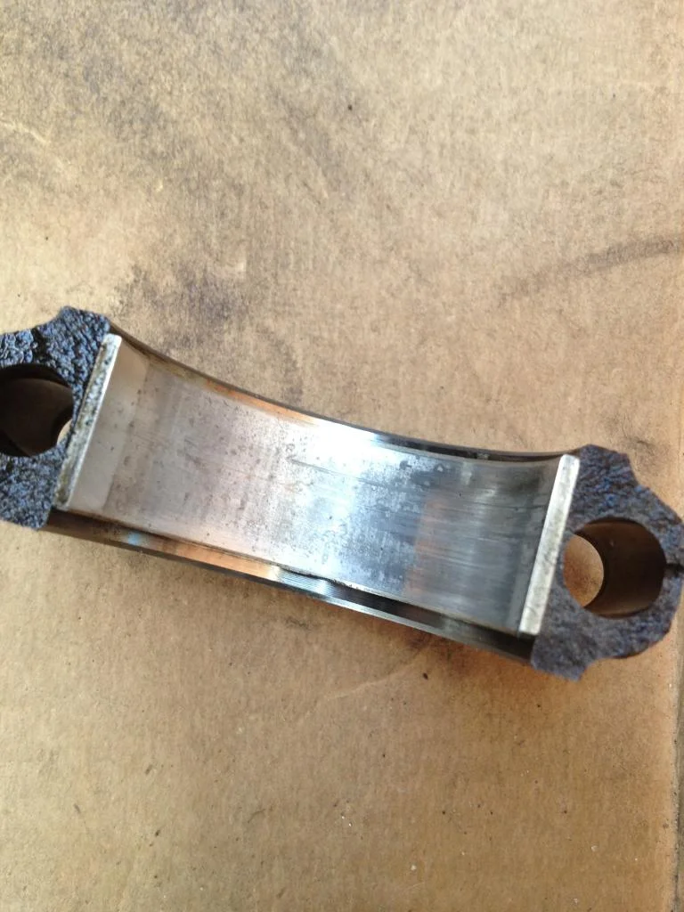

To inspect the big end bearings... Not as bad as I was expecting TBH
Crank is good too
However its a different story for the mains...
I think I'm going to chuck some big end bearings in it and see how long it lasts. I don't have time to do anything else.

I'm sure it'll be fine, aslong as the shells fit nice a snug in the caps and block.
Got away with one like that before. Some of the cranks are so badly done from factory it's unreal!
You made sure the pump strainer is clean and free ?
Yeah I'll make sure its all sweet.
I haven't cleaned anything yet. Lost interest. Will do tomorrow evening.
  Many.
Its not that sorta noise. It also started progressively, and that wouldn't explain the knocking on cold starting for about 5seconds.
If it still knocks after this, I'll just wait for it to blow up.
