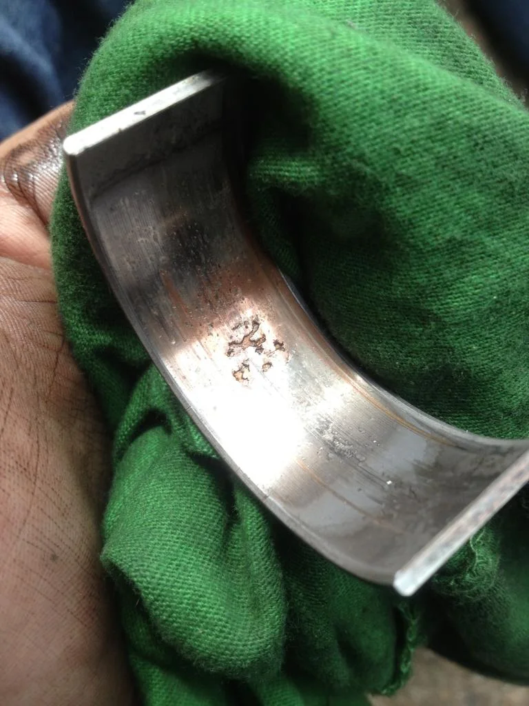

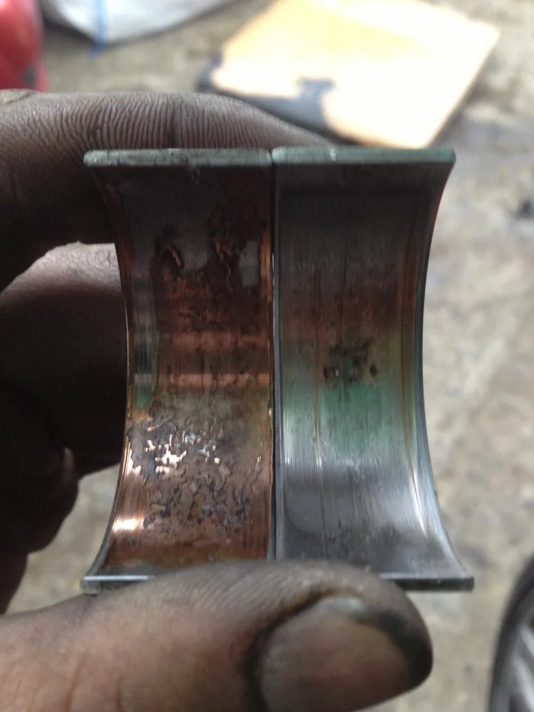

I hadn't removed any of the rod side of the big end bearings, until today...
First one I removed was number 1
Then I removed number 2
That'll be the cause of my knock then.
Started pissing it down while I was putting it together too
Got it all back together, along with fresh oil & filter. Its so much quieter and seems to run cooler.

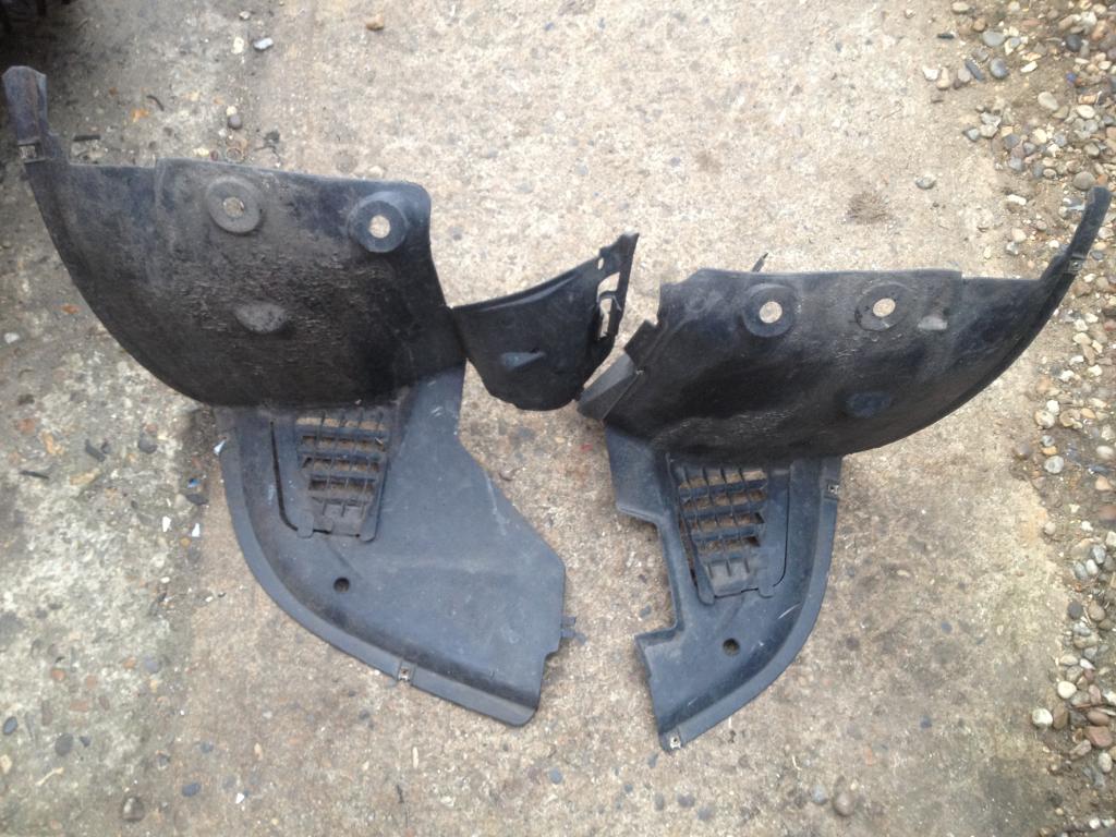

Last night I got some front arch liners off RyG, fitted them tonight, along with my undertray again after I removed it when changing big end bearings.
See how long these last!

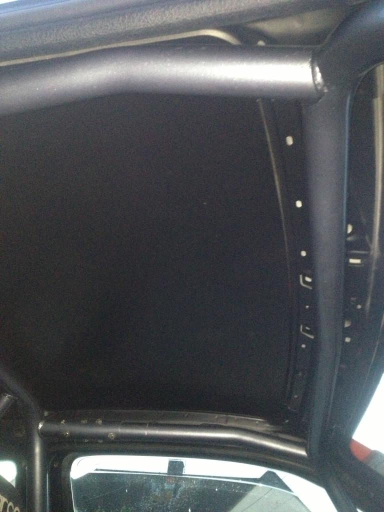

After a lot more pain than I expected, roof is now sound deadening free, and painted up nicely....
As you can tell, it was dark by the time I got these pics

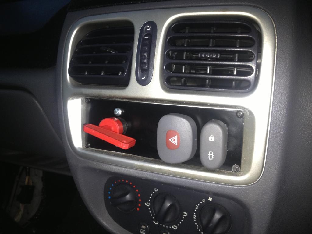

But I also got the switch panel sorted, I wasn't happy with the previous one, finish was terrible, so this one is much better, moved the hazard switch closer to the right, to aid reaching when in harnesses.
Just needs a hoover now, quick wash, and its ready for Bedford on the 11th! I can't wait!

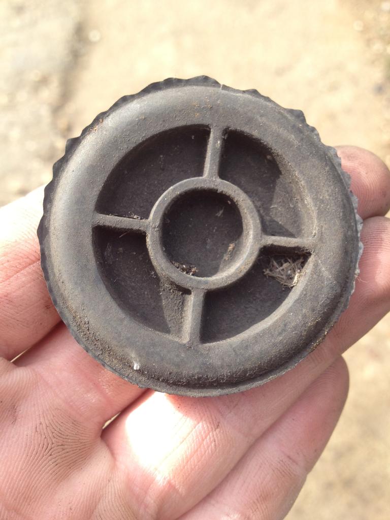

Also, has anybody locally got one of these? Its the seat bolt blank from underneath, I only need one?
Or if somebody wants to post me one for very little? :p

I have several, but ill have to check. Be late today/tomorrow as im off to goodwood soon.
if your this way you can have it, if not ill post it

I'll have a look too. Pretty sure I found one after we swapped the seats over but I'm not sure if I chucked it or not. Will check today.
Cheers dudes!

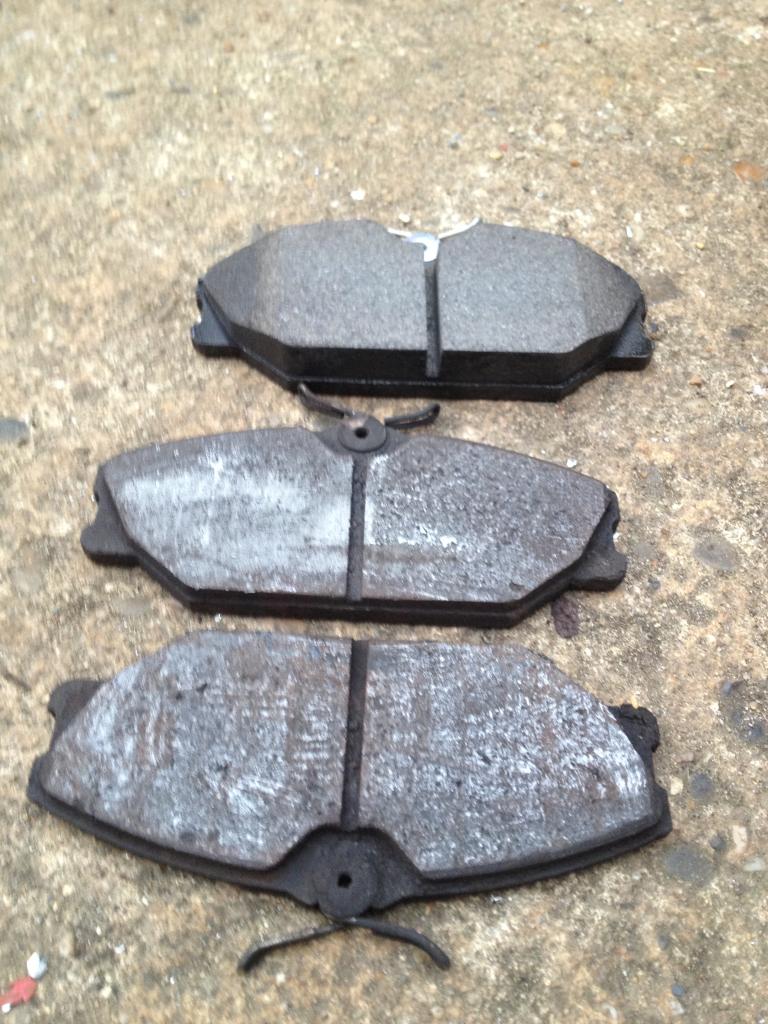

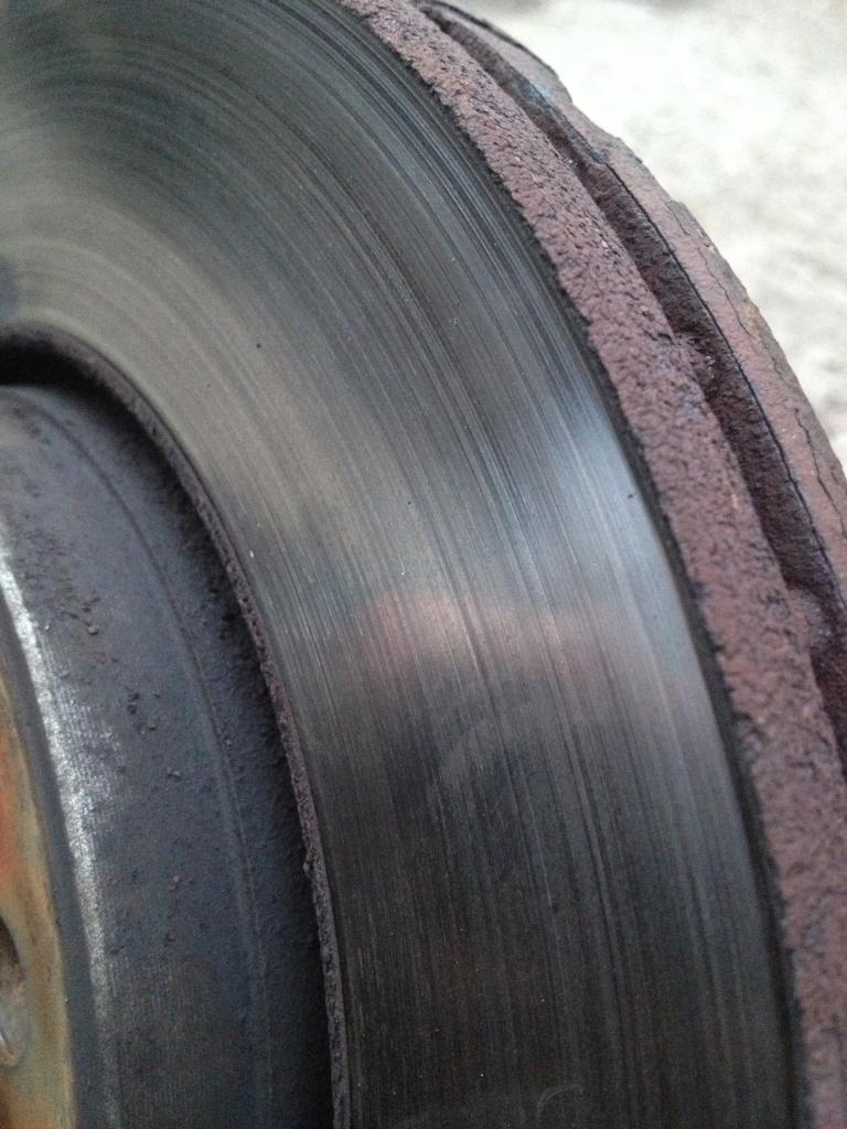

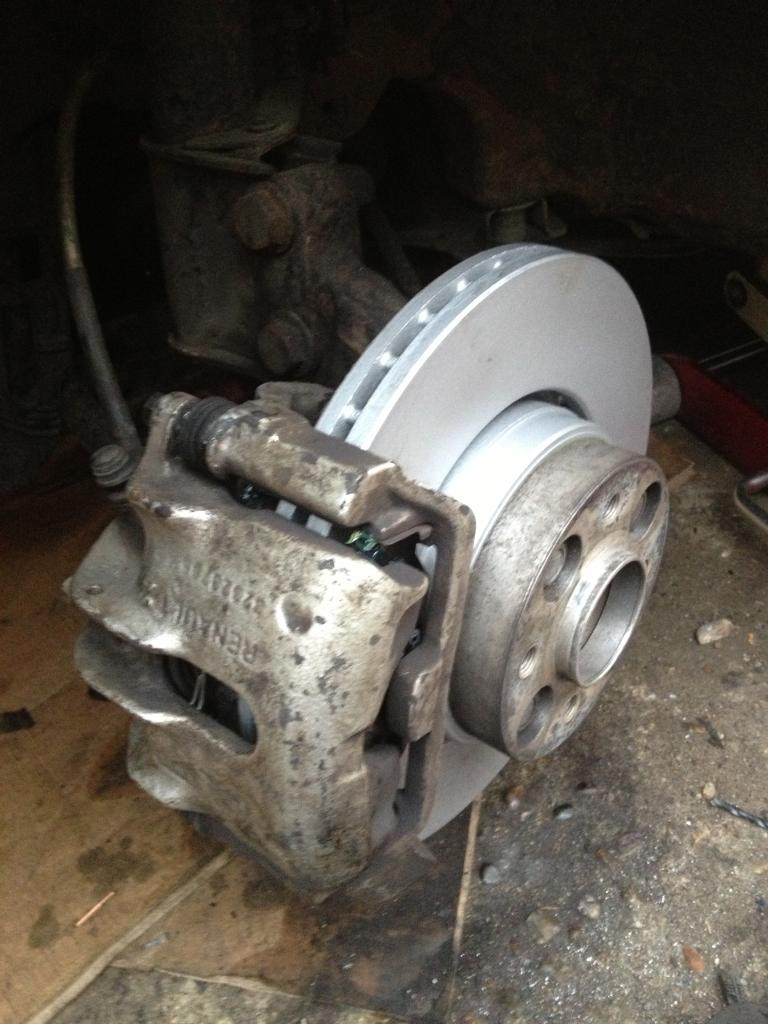

Anyway, Yesterday I ordered new front Discs & pads from g172, Top service as always!.

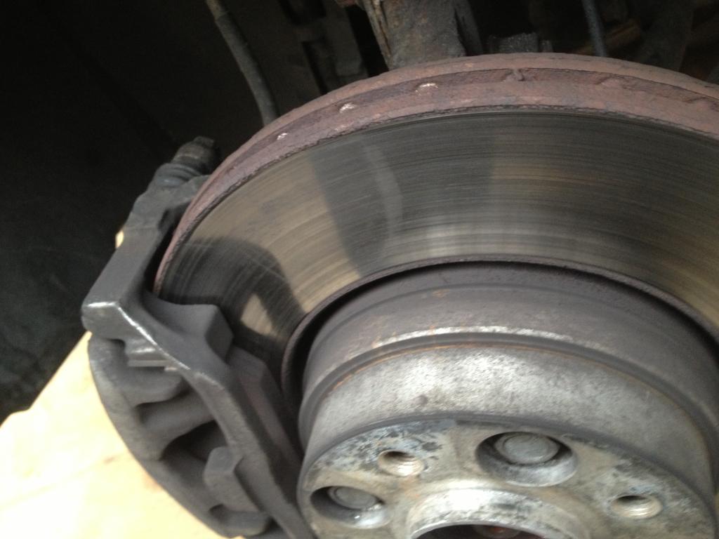

Old ones weren't that bad as you can see...
Minor lip on discs, pads mostly worn, but I'm not the kinda person that waits until they are metal on metal, I keep an eye on them and change way before they get bad.
New vs Old, Old.
New stuff on, Annoingly, I would have liked to change the shims, but I forgot. I did paint the discs for cool points.
Discs were a pointless change
Oh well! Pedal feel is much better now, really pleased, and theres nothing like turning up to your girlfriends with brakes smoking like fuckery, I lol'ed hard.

You want one of them rubber bung things still?
Obvioisly have missed how s**t my car is lately.
Yes please, no rush now, worry about it next time I see you.

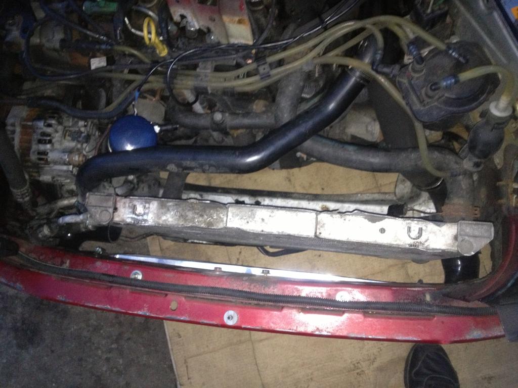

First up, bought all the pipework to finish plumbing up my intercooler at last.
So f**ked off the old 80 intercooler, and the factory rad fan, as its massive and I've always hated it.
I then failed to get any pictures, but its all nice silicone now.
Done.
Seems much faster due to the lack of boost leaking, and I then, after somebody saying you could wind up the boost slightly, without issue, Wound the boost up to 1.25 Bar. Its cooled the running temps down a bit, and stopped as much smoke, running sweet.

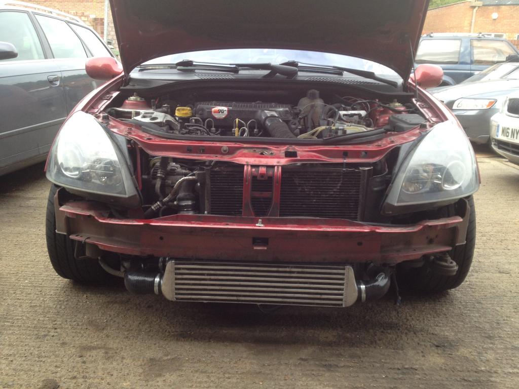

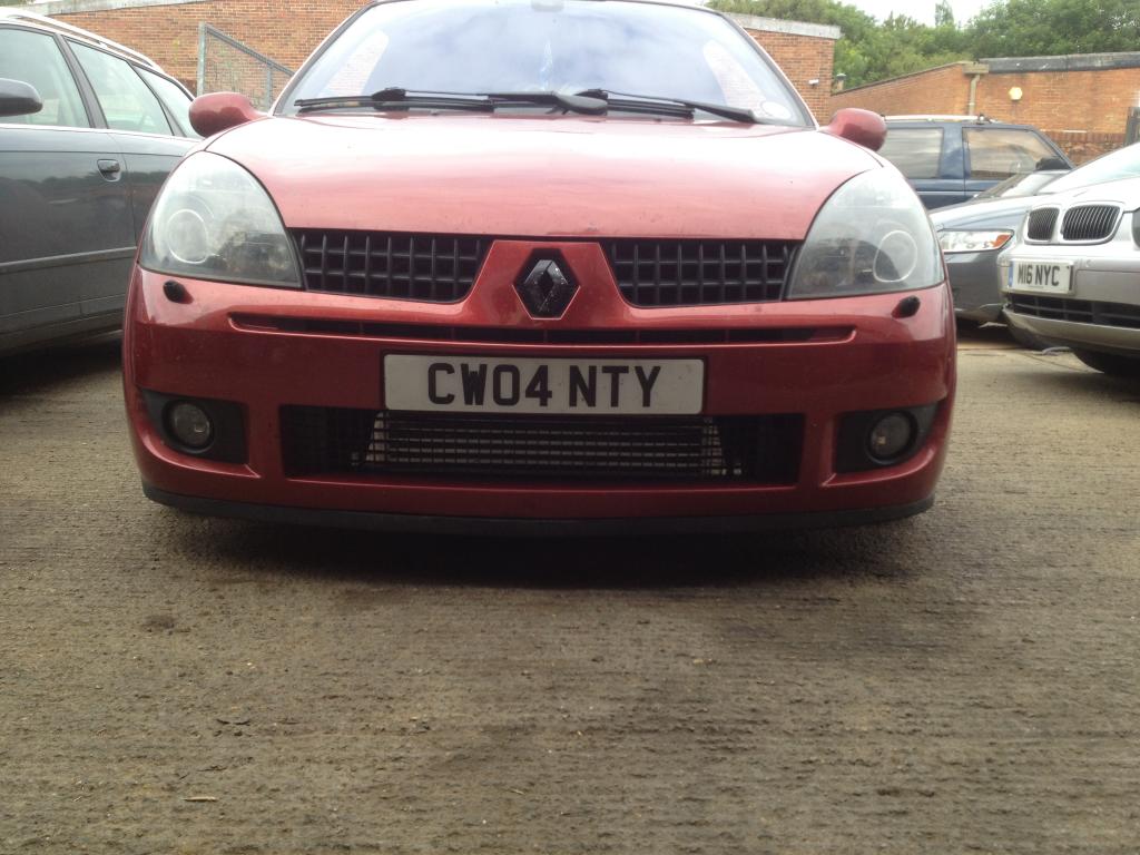

Just been having a little skim through this thread and noticed this. What intercooler is that you've got on there? Looks bigger than the dci 100 one. Looks better. Looks like something I want on mine lol :rasp:
Toyosport, eBay circa £50 I think. Yours being a 100 should mean the boost pipes required to link up to the existing pipework should be cheaper, I spent a fair whack on that.
Cheers mate! Have you got a link by any chance? Had a look there on ebay and can't find anything, although I found various different sized ones on toyosports website

My size is...
550mm x 140mm x 65mm, Overall length: 690mm.
2.25" (57mm) Inlets
You'll probably need reducers etc for your boost pipes too, I did.
I drilled the crash bar to mount, used some studding, used some rubber washers aswell, to mount the IC.

Ahh typical! Ta for the sizes, i'll have a little browse around ebay with those and see what I can find. I think I will need reducers too, the standard piping is around 50mm I'm sure.
Love being able to see an intercooler at the front. Mines is so old and s**t looking I'm sometimes not sure it's there LOL.
