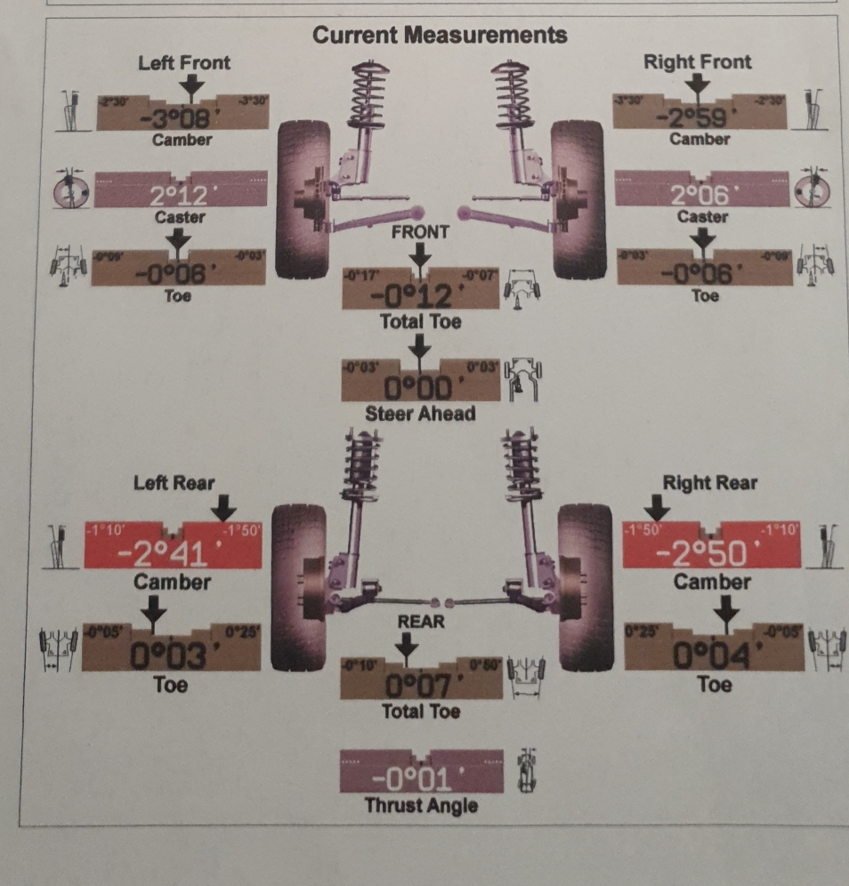

I've just set mine as below after many searches
Toe for each side (please state this, not total)
' = min (please specify units used, thank you!)
Clio 182 Trophy
-2degrees camber
10' toe out
Daily with some track intentions
Powerflex arb bushes & camber bolts only
172 CUP
•Ast5100 coil overs 550lbs springs all round
•Northloopcup Roll centre correction
•Black series bushings all round
•Epas
•Brt Motorsports Quick rack
•Pure motorsport Strengthening plates
•K-Tec solid top mounts
•Forge motorsports Strut brace
My car is road legal but I only use it on Track..
