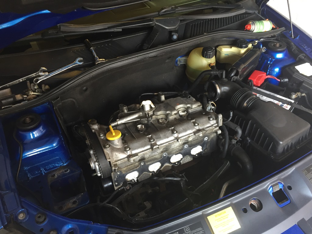

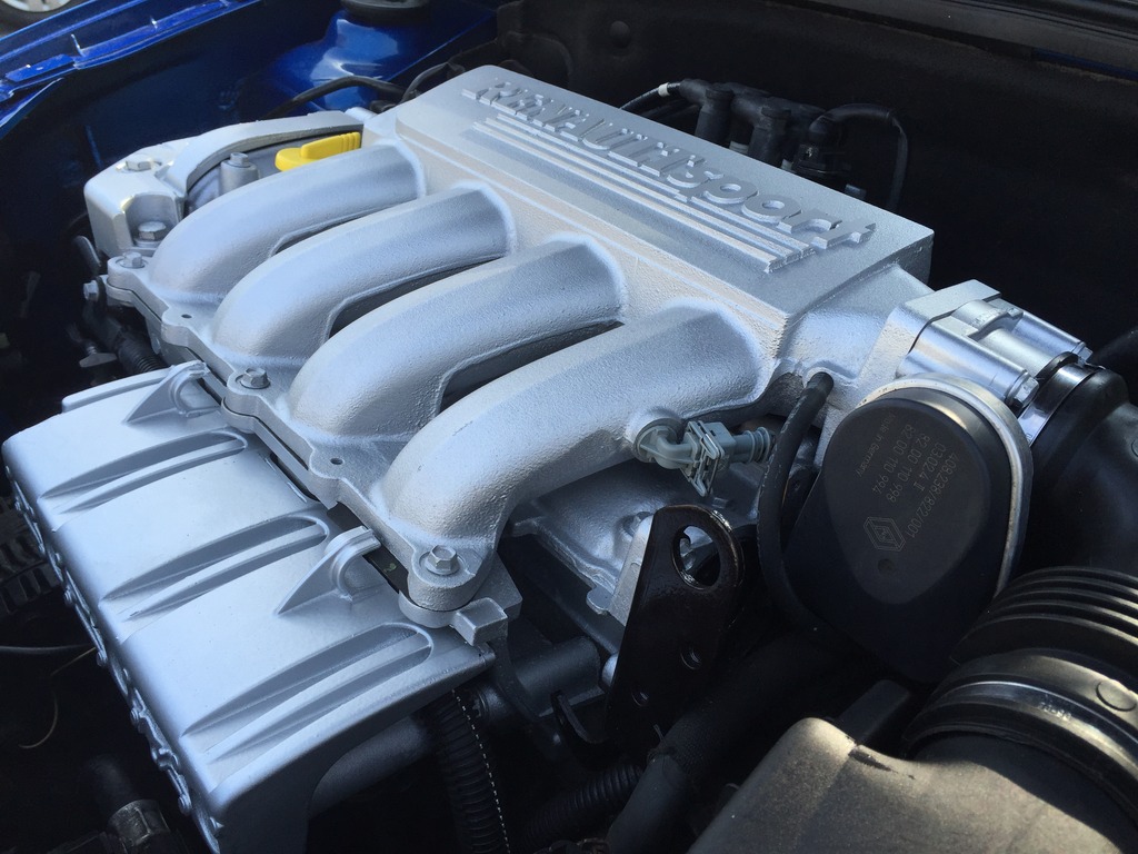

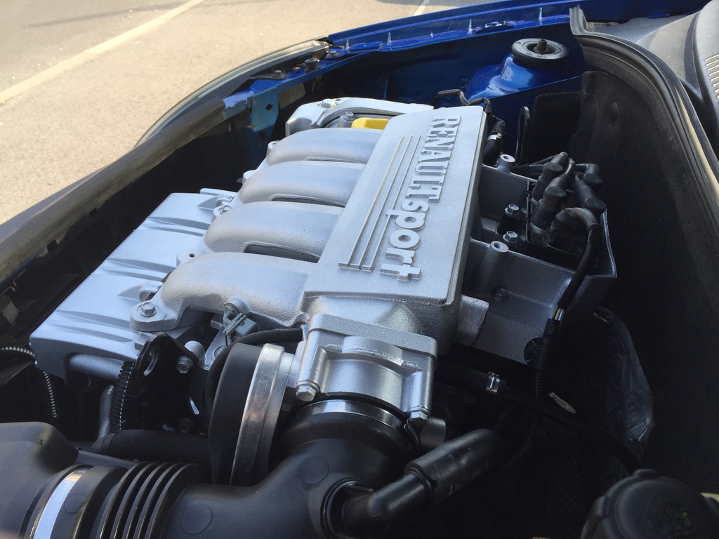

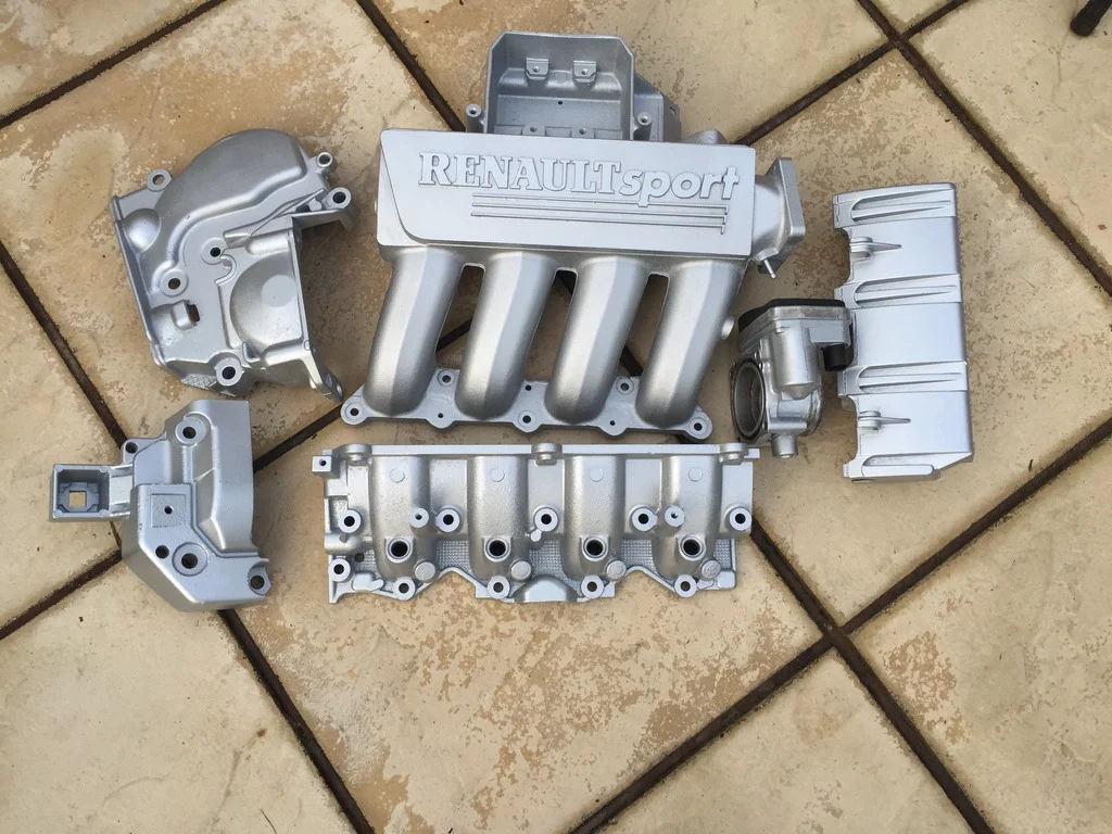

Sorted the engine bay out over the last couple of weeks after @Daniel said to get spraying with the Autoglym alloy paint, so much cleaner now.

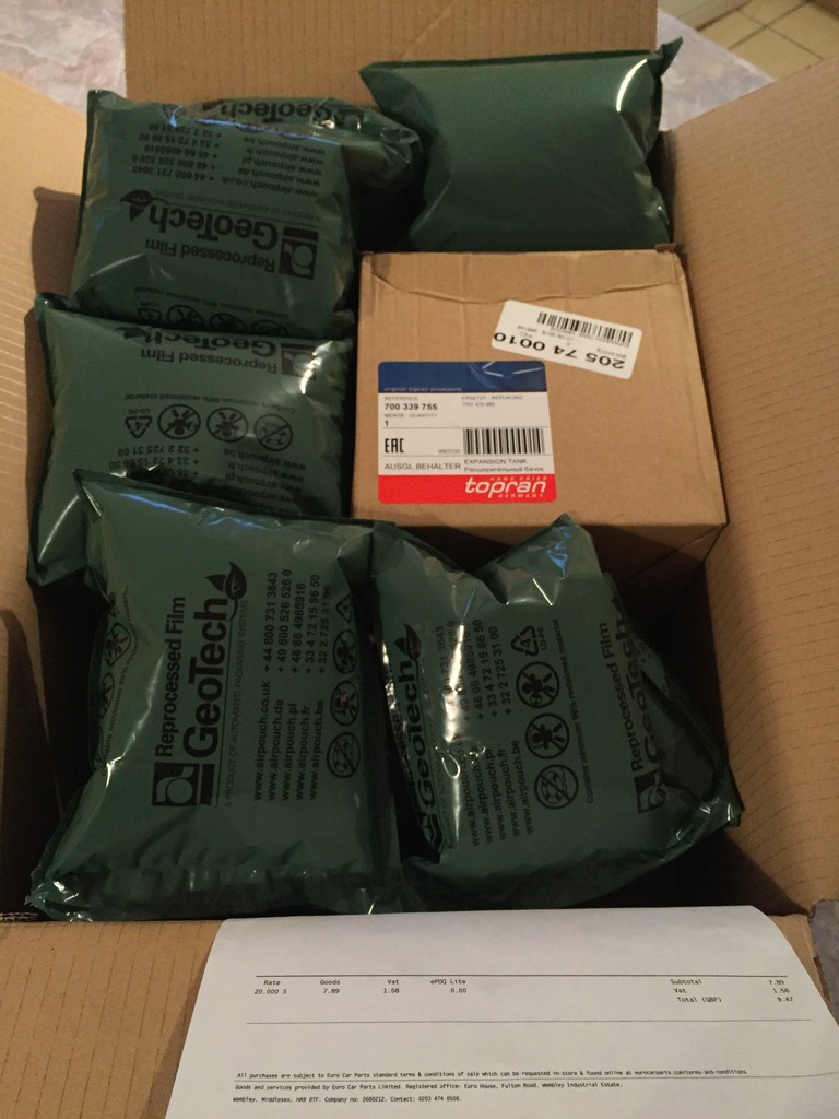

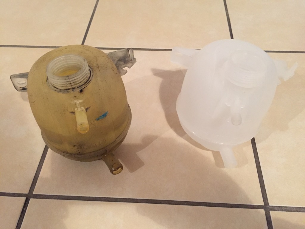

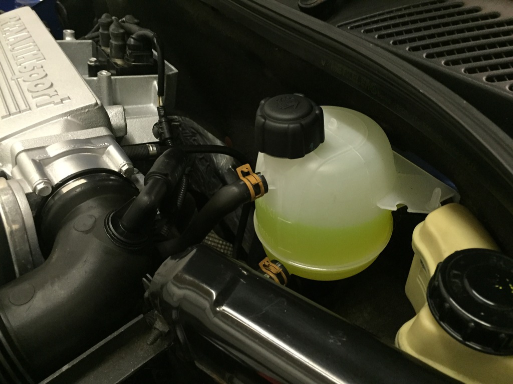

New coolant bottle next!

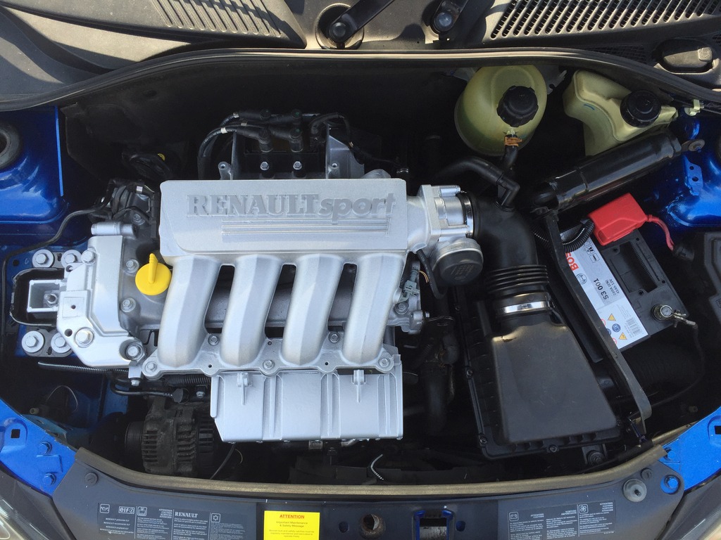

When i first got it in March.

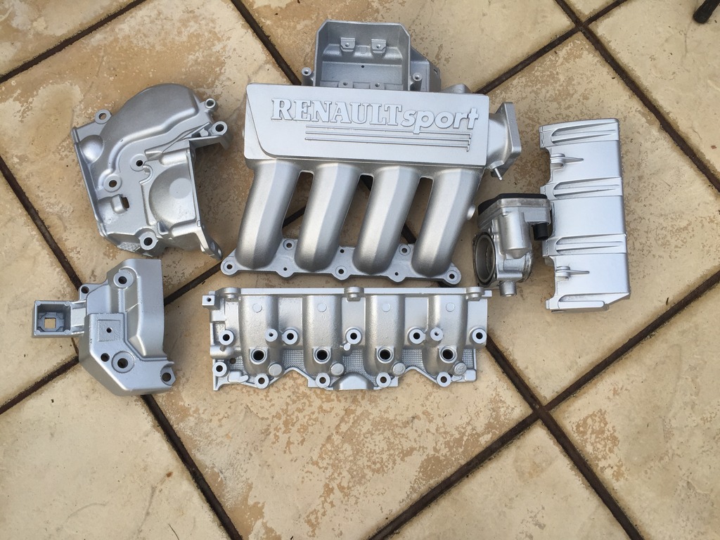

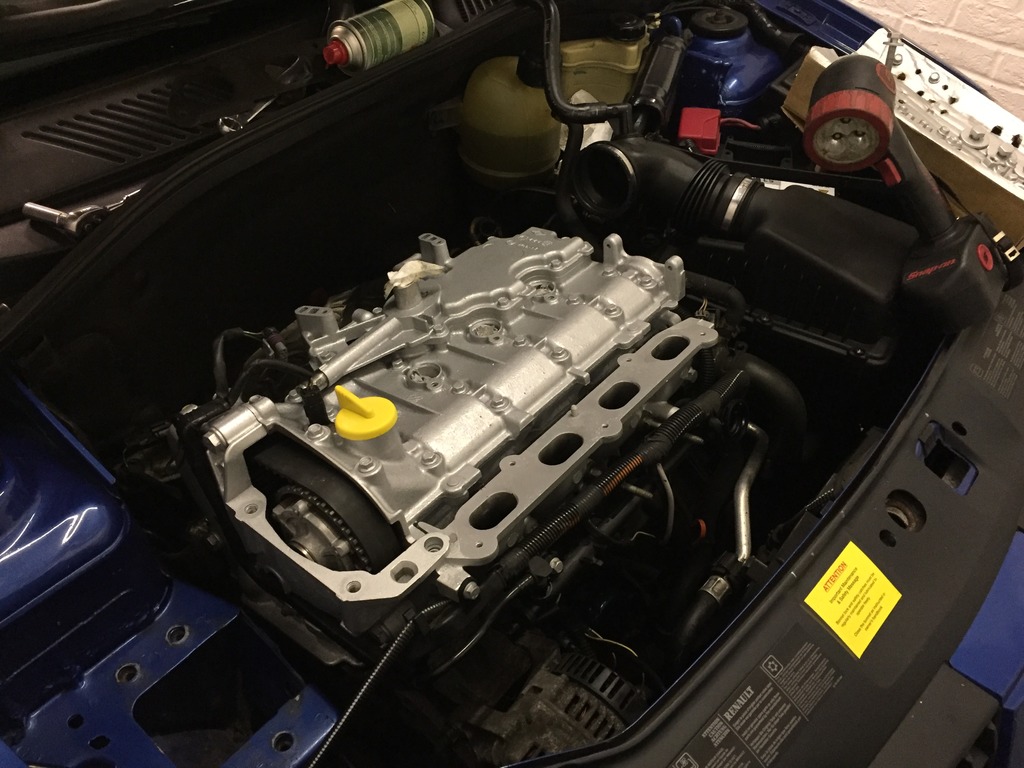

Stripped.
Painted bits. (bolts etc painted as well)

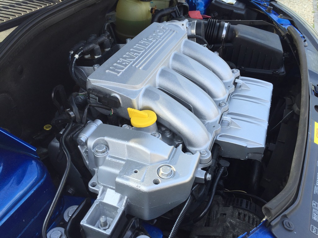

Rebuild.

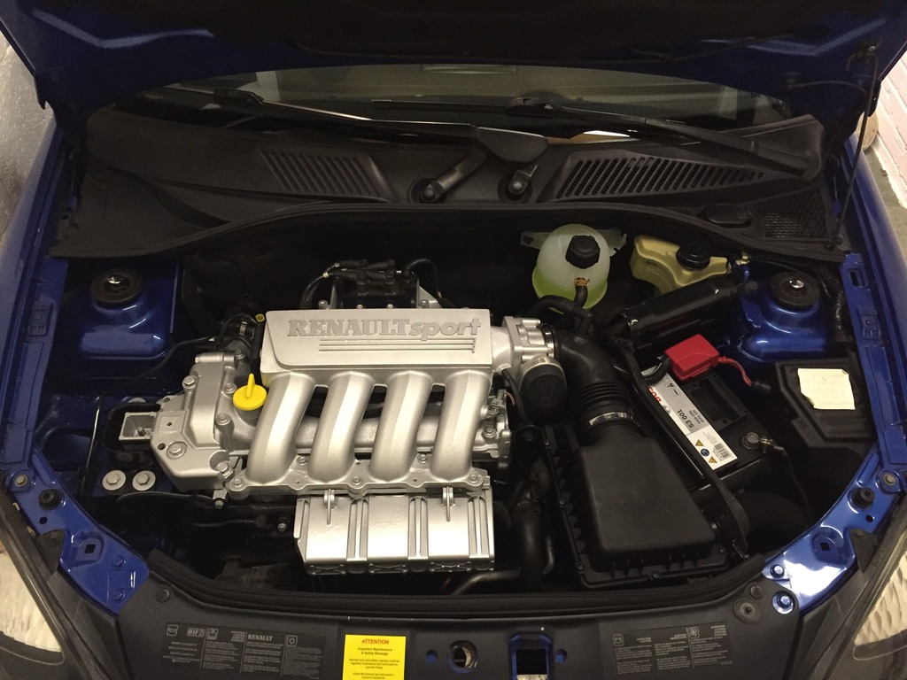

Done.

Have you got a link to the coolant bottle, I could do with one to

Is there any chance you'd be able to give me a few products what you used to do your engine bay mate please?
What spray you used, cleaning products etc? Got my heart set on doing it now after you've done that!
Auto glym alloy wheel paint x2 http://www.ebay.co.uk/itm/AUTOGLYM-...588205?hash=item20c830b2ed:g:E7oAAOxyBotTYix1
Hammerite silver metal paint x1 for the rocker cover (i was going to spray mine but it would have been a pain masking everything up. http://www.ebay.co.uk/itm/New-Hamme...096051?hash=item1eab11e6f3:g:41cAAOSwJb9WsnKJ
Wire brush to get rid of all the powdery bits on the alloy parts. http://www.ebay.co.uk/itm/Hand-Wire...829120?hash=item5d5f2e4fc0:g:Y08AAOSwsFpWTHBw
Couple of cans of brake cleaner to degrease everything before paint. http://www.ebay.co.uk/itm/Sovereign...hash=item3ac2d7ffdc:m:mSt31DZV2cgtEHD9Kou9zfg
