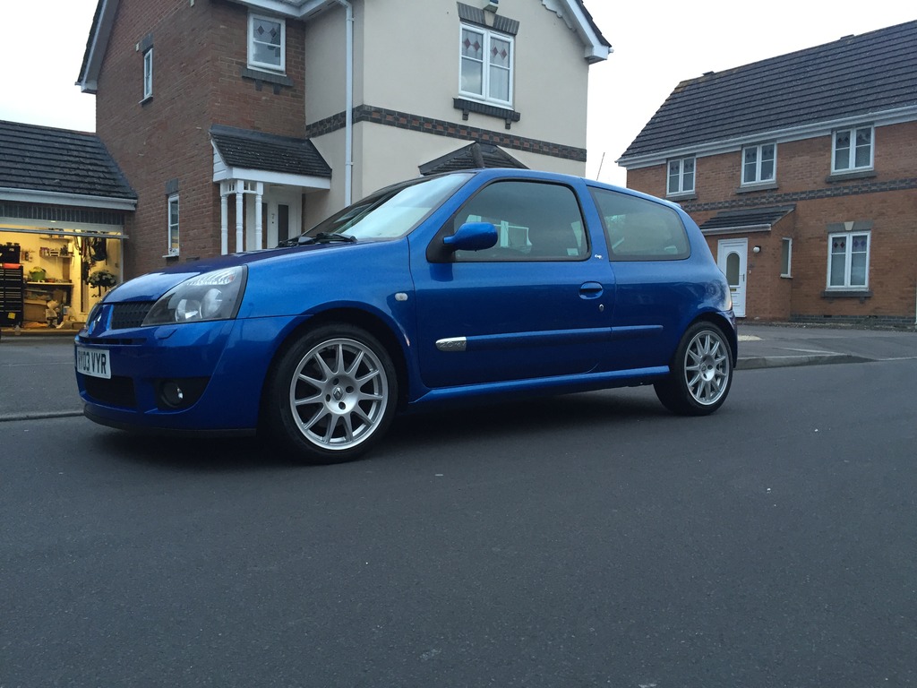

Hi all, haven't been on here properly for the past 18months, but im back with a new toy, a Clio cup 172.
I've been after a Clio cup or a ph1 for a short while now, went to see a few but they were all dogs, literally couldn't believe some of the states the clio's are in now.
Anyway after seeing Robs @rob893 Clio cup for sale i had to have a look. A couple of days before viewing Rob messaged me to let me know that the cup had started to feel a bit lumpy on idle, i decided to have a look anyway and quickly established that it had a slight misfire.
We ended up agreeing on a price that reflected the issue and i picked the car up today.
On the drive home the engine was was very strong and pulled really hard, it drives surprisingly well considering its done 125k, Rob had definitely looked after her going by the service history and general condition of the car.

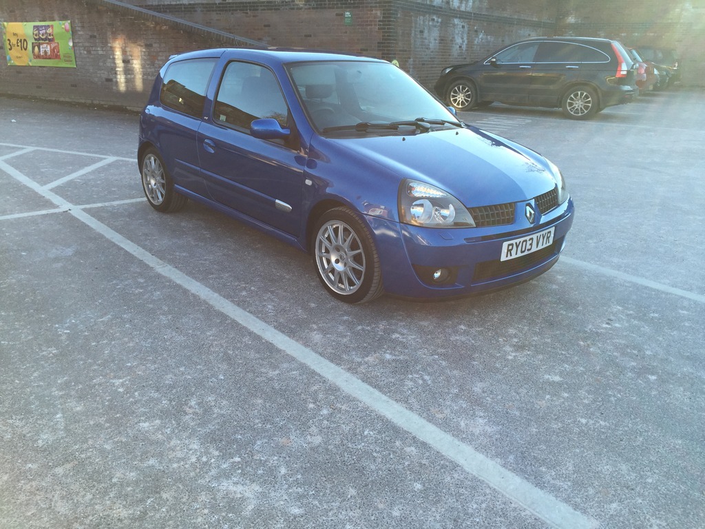

On the way home i snapped a few pics.

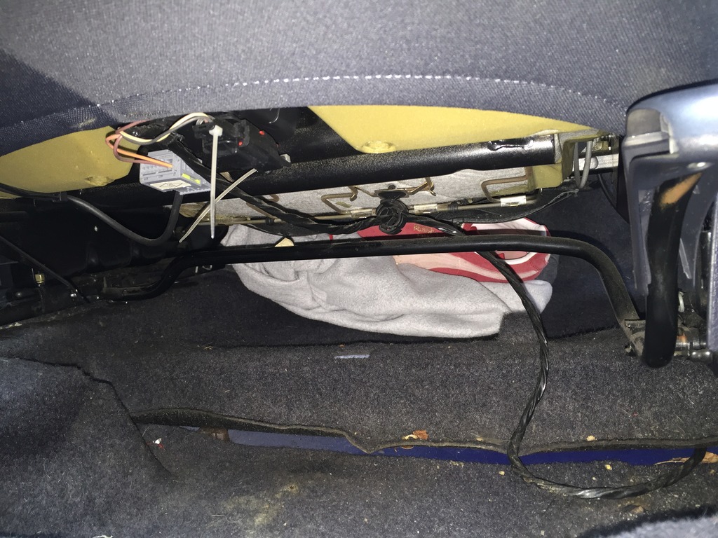

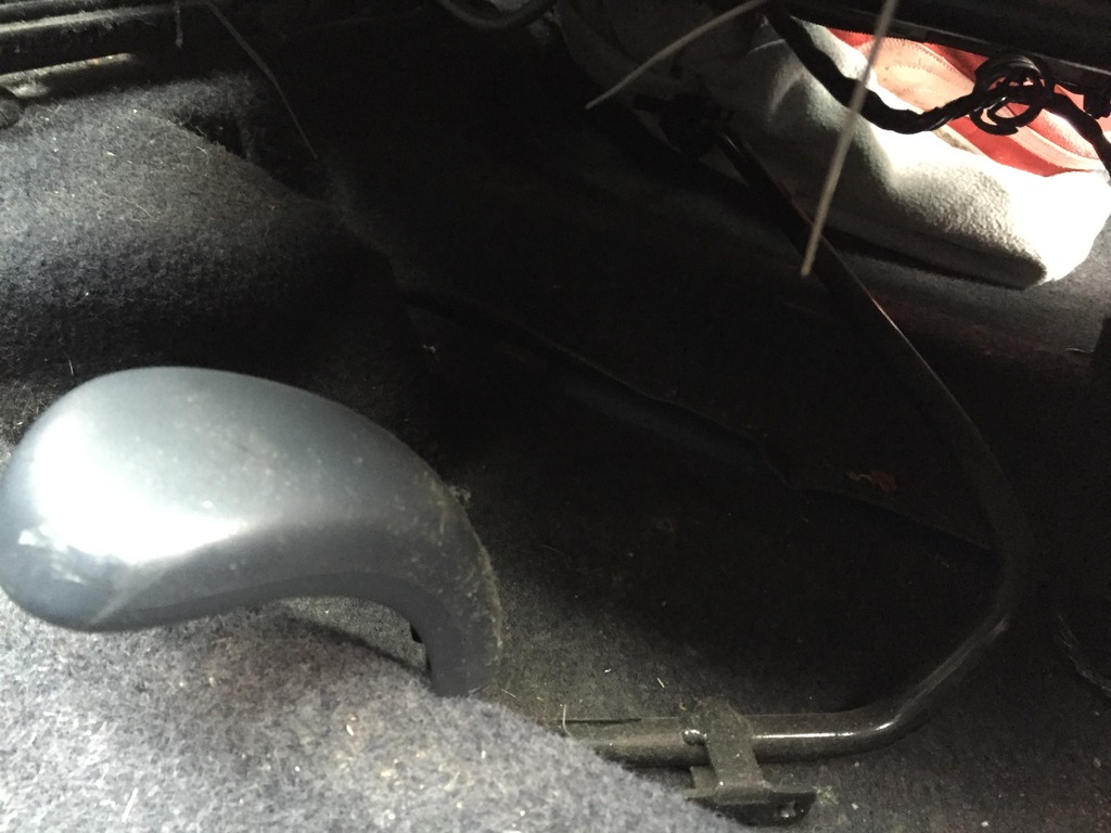

Sorted the passenger seat whilst at work today, quick 2 minute fix, the bar had come off, refitted all ok.

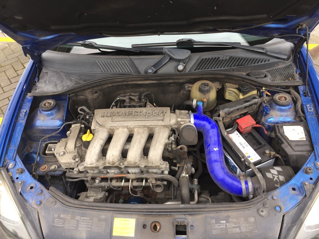

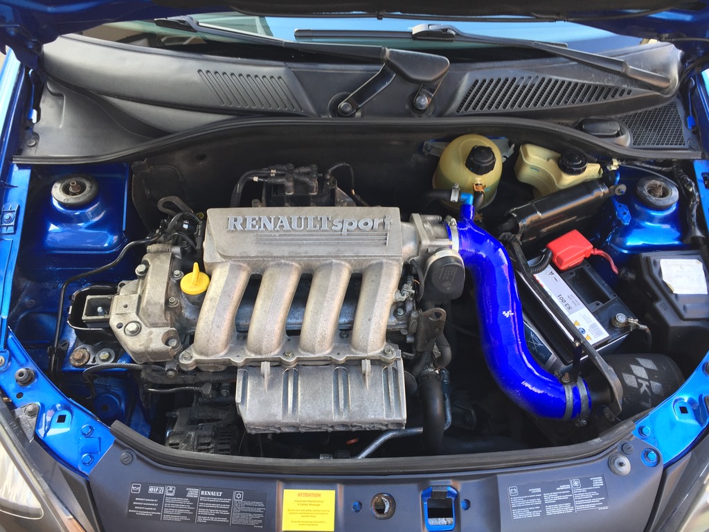

Engine needs a clean, (fuel rail guard at home)
Well spotted, makes it easier for me to take the interior out tomorrow for a deep clean. No wire chopping!!
That engine bays a mess! Car looks good though, I considered it myself but it was far too far away and bit high on the miles.

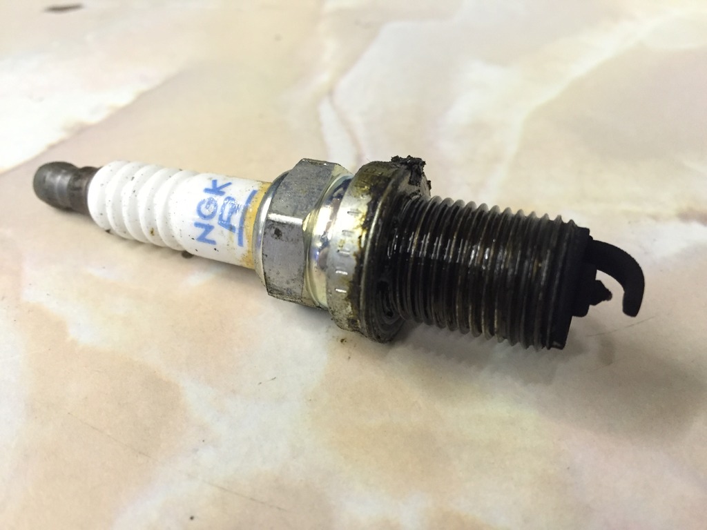

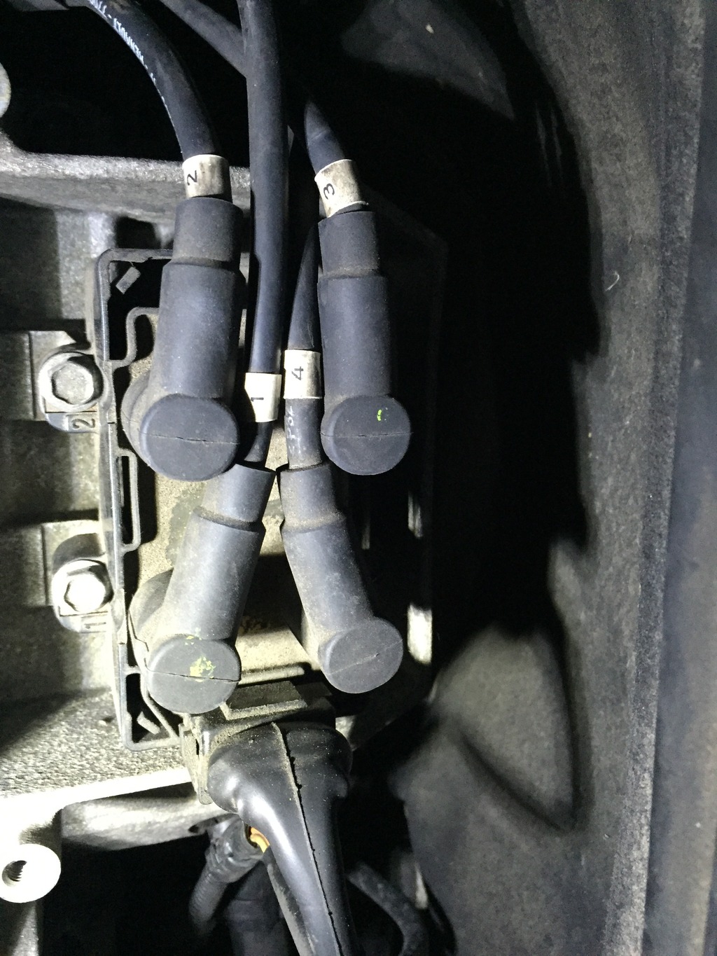

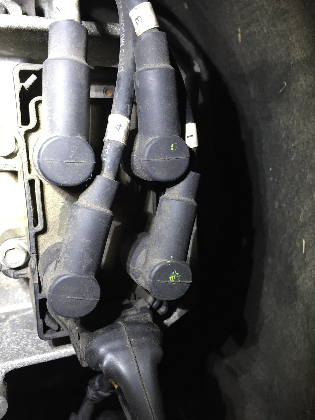

First up the misfire was still there, i dont think it ever went. I pulled the plugs and number 4 plug (cambelt end) was black and sooty. Spoke to @baysthebest me brother and went to his house to borrow a fuel injector from his 182 track car. Fitted it and instantly purring with no misfire. Happy days, just need to get another to replace his now. Oh yea the HT leads were fitted incorrectly, 1 and 4 were round the wrong way.
Engine feels super strong and there's no hesitation what so ever.
Plug.
Leads, wrong way.
Sorted.

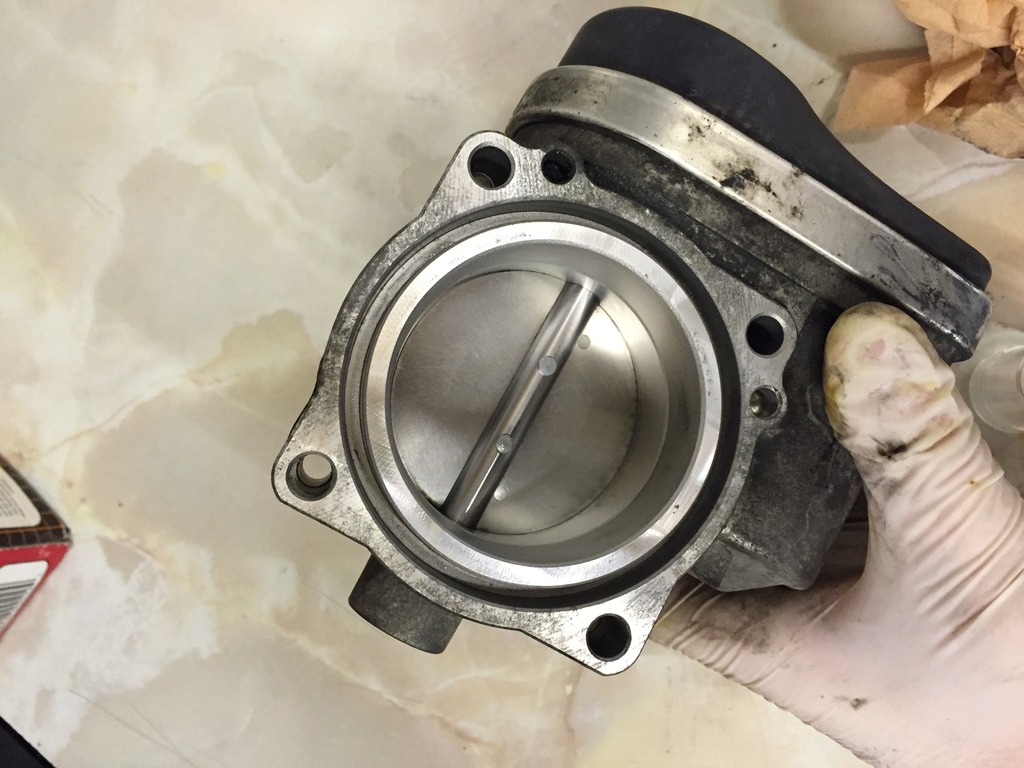

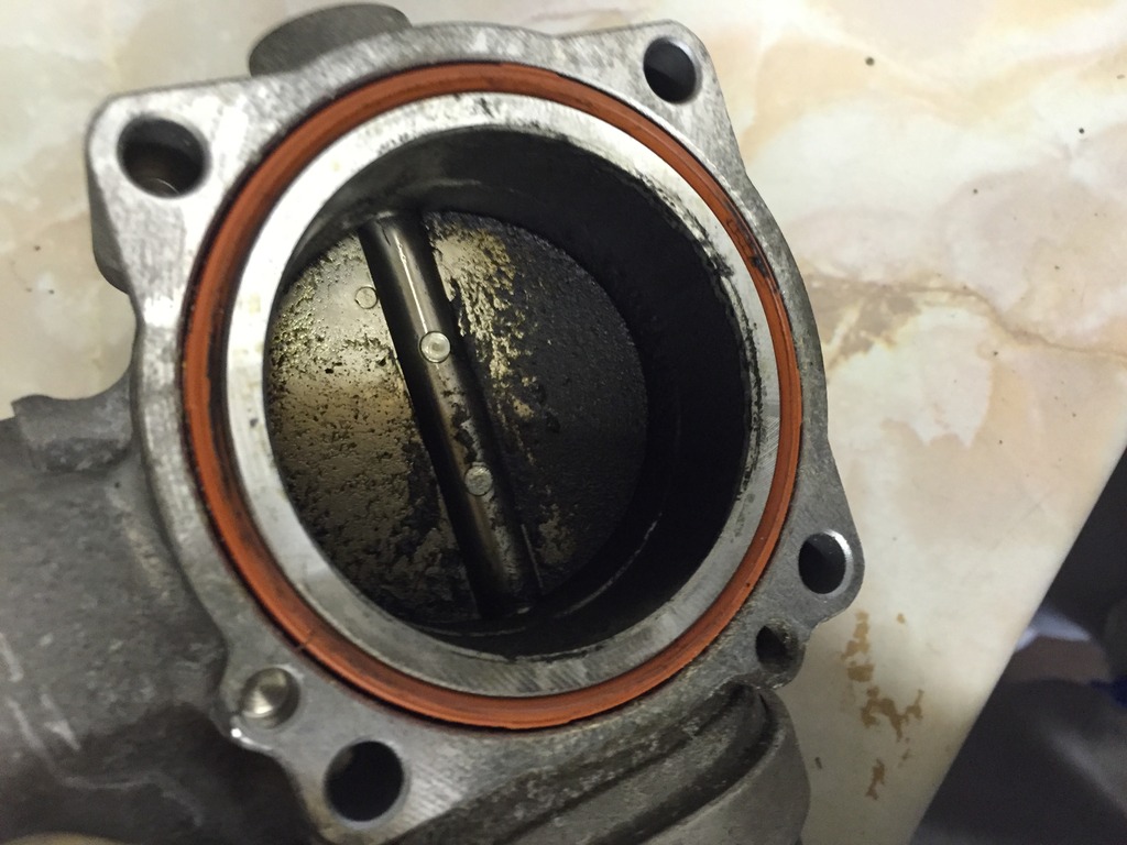

Also cleaned the filthy throttle body whilst i was there.
Done.
And then i cleaned the engine bay up.
Before.
After.

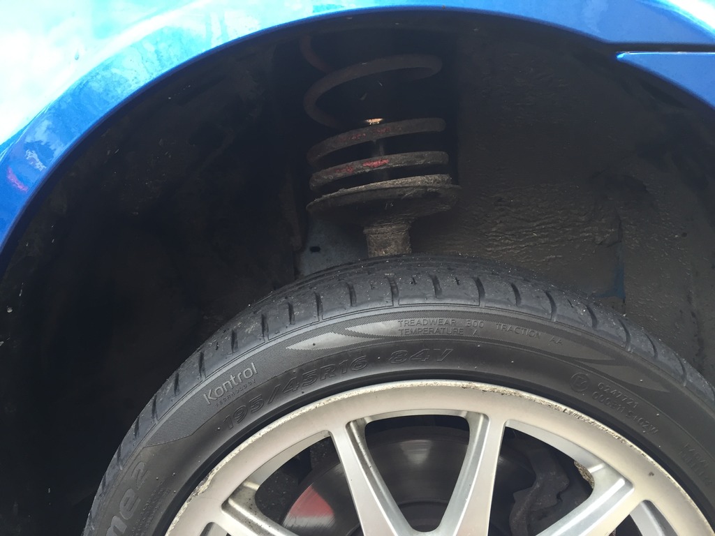

Jacked her up and cleaned all the arches out with G101 and my Nilfisk, also did the door shuts.
Arches, before.
After.

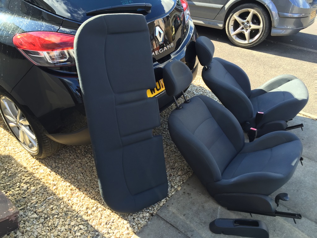

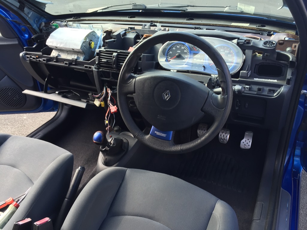

Next up was to clean the interior, seats out.
Done.
Seats back in.

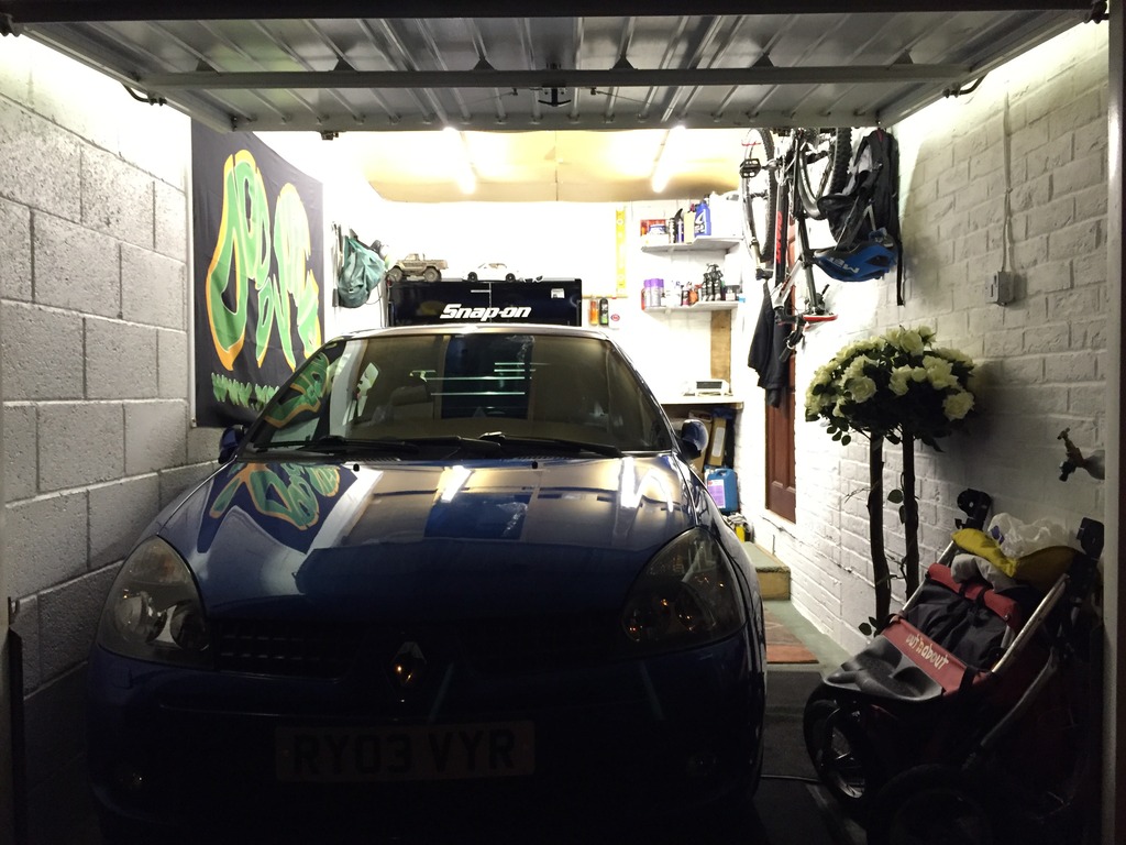

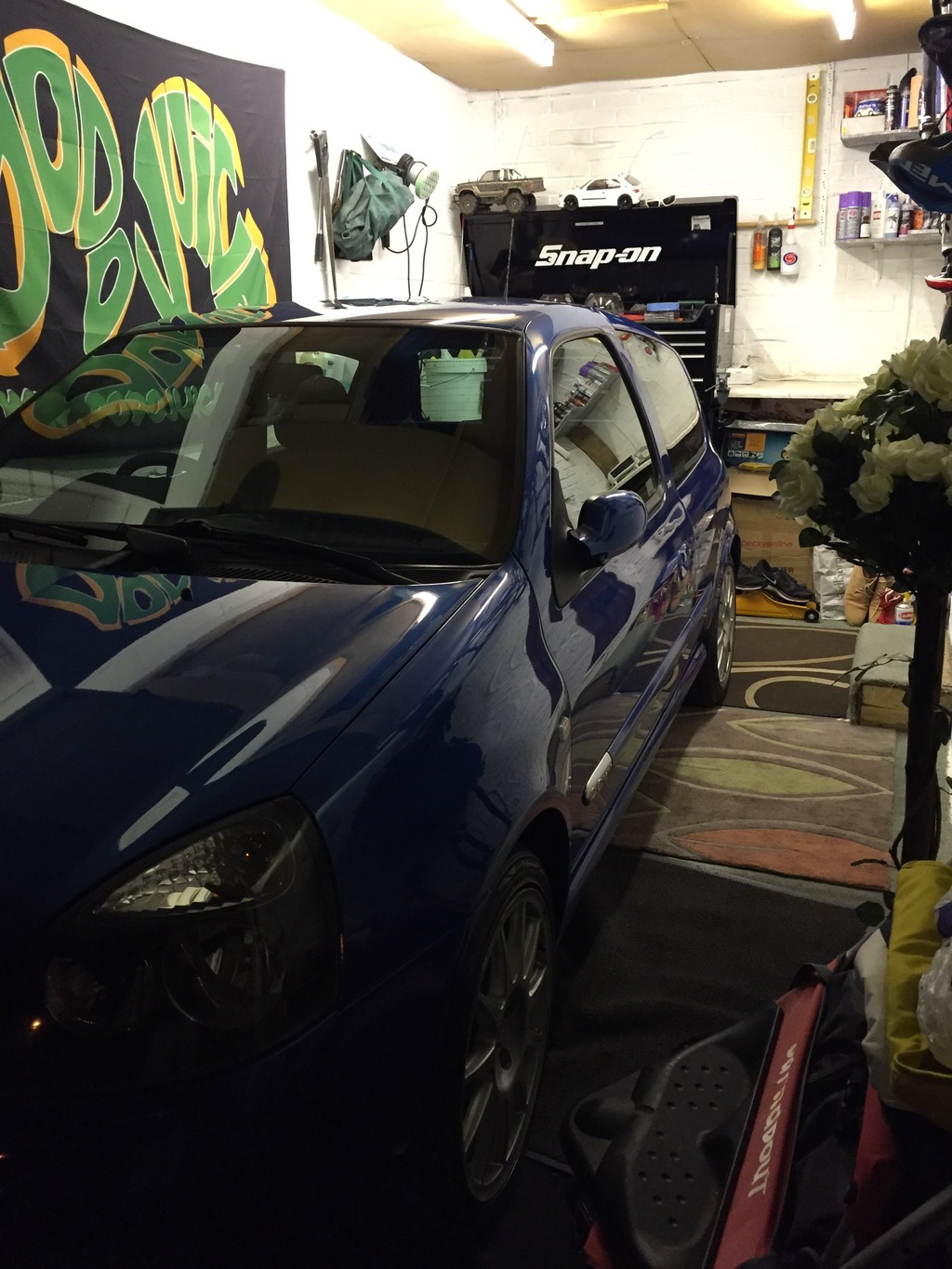

Got back, sorted my garage out so i could keep it in there as im only get a chance to use the cup 1 day a week really.
bob on, nothing like a deep clean to make it "yours"

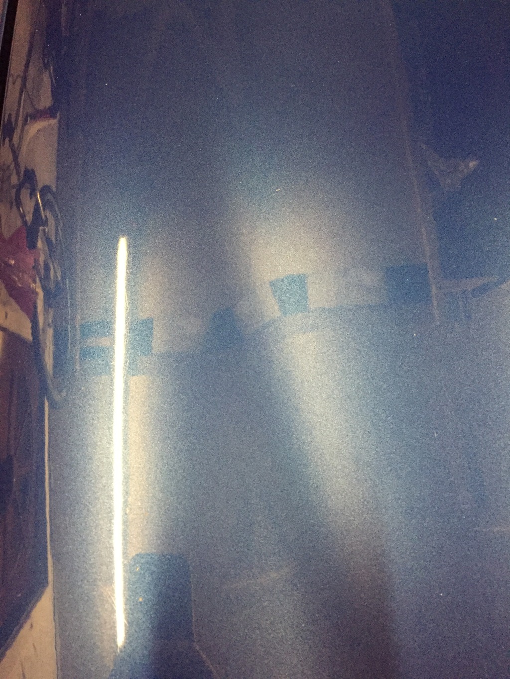

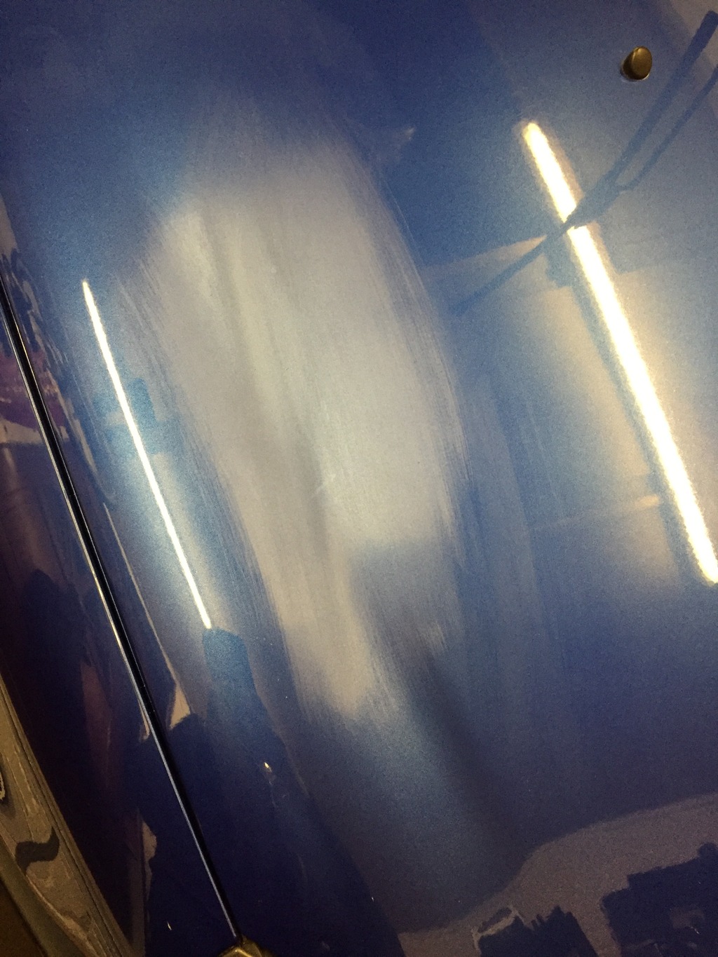

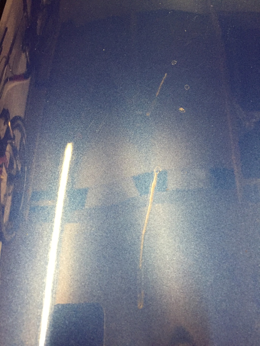

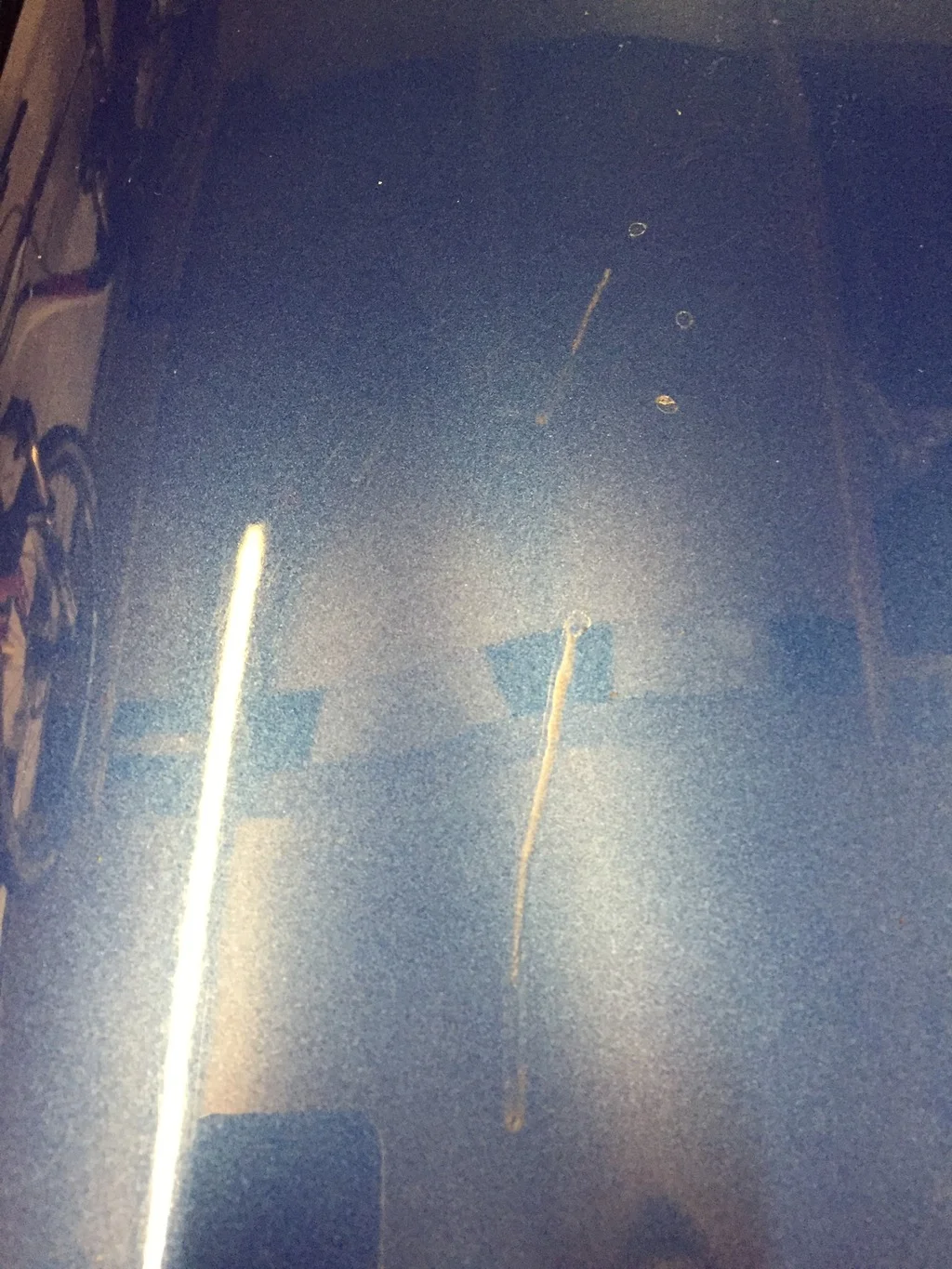

Removed super glue from the bonnet, tried everything, last resort was a light wet sand and it has all now gone.
Before.
Sand.
Done.

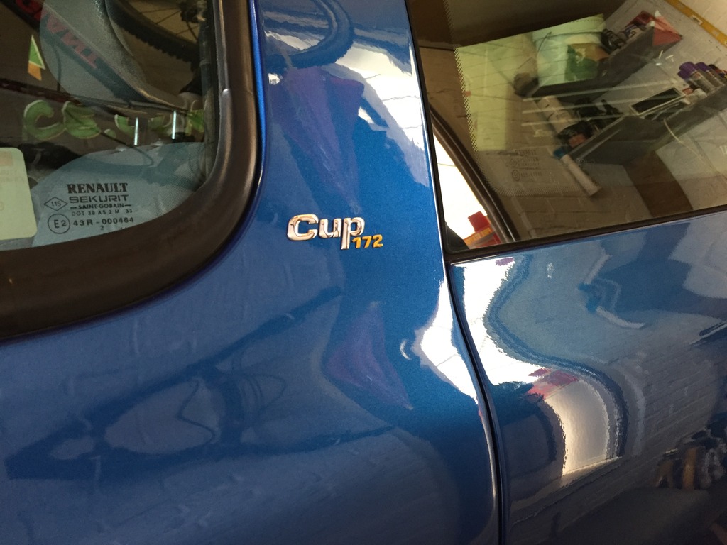

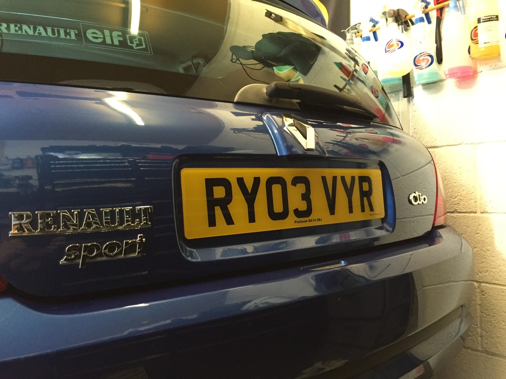

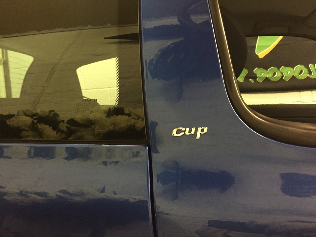

Next up was new number plates, i replace them on every car i buy and i have to stick them on, hate screwed on plates, they only cost me £7 for the pair. Also got some new 172 cup badges, £10 each from work, bloody expensive!
Old badges were missing the 172 bit.
Done.

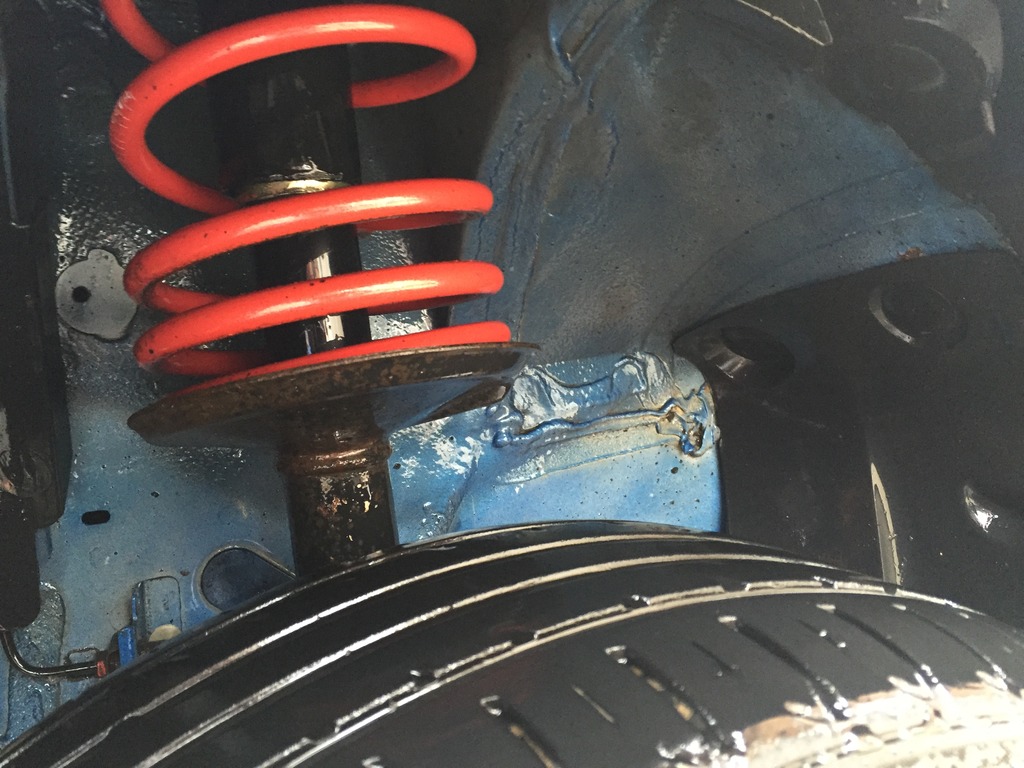

Sorted an issue that @rob893 mentioned in his advert. Exhaust was banging under-load. When under full throttle in 1st and 2nd you would get a horrendous noise through the cabin, Rob had the car looked at and know one could find the problem, i believe K tech fitted a new polybush dog bone and top engine mount (cambelt side) but that didn't sort it. So today i thought i would investigate as it was pissing me off. Fixed the issue within 30 seconds, undone the top engine mount and pulled the engine forward, it looked way to far back before hand. No more horrendous noises now.

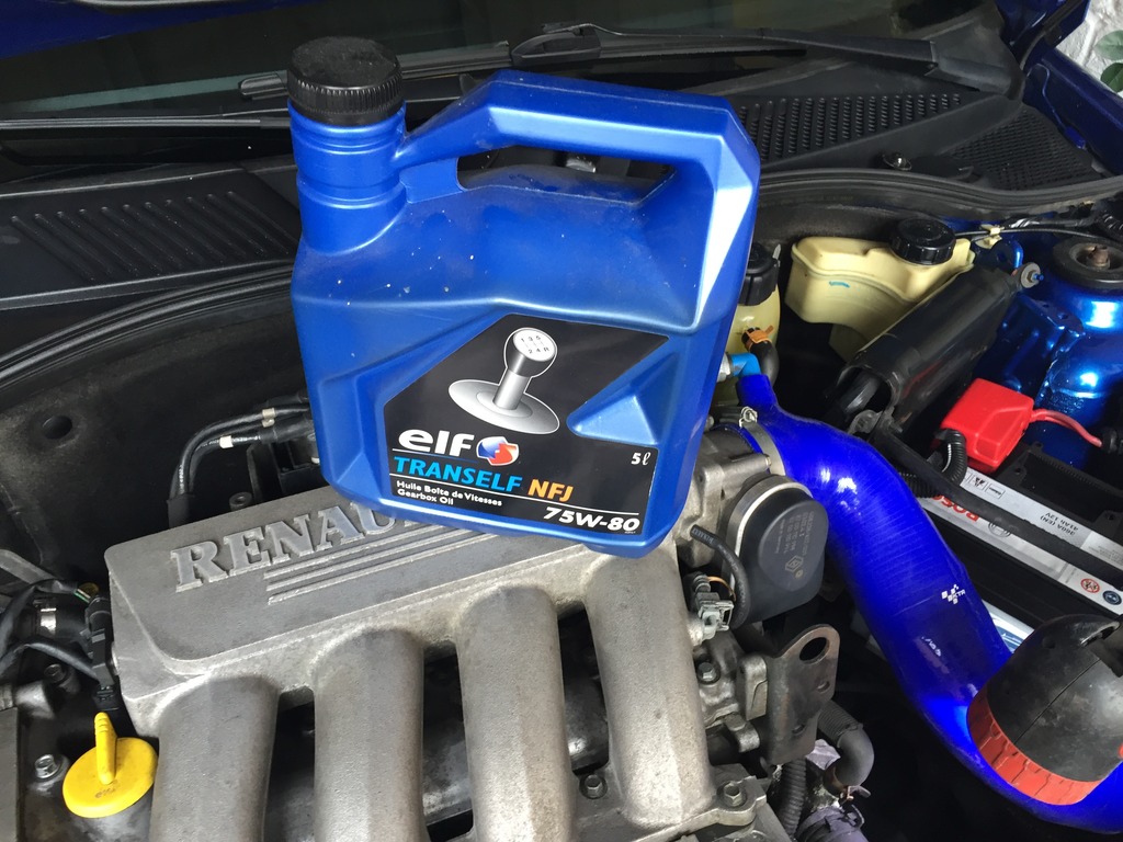

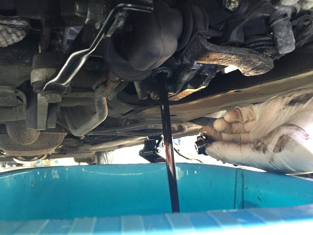

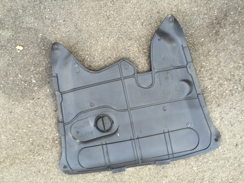

Gear oil change was on the list so i got that done.

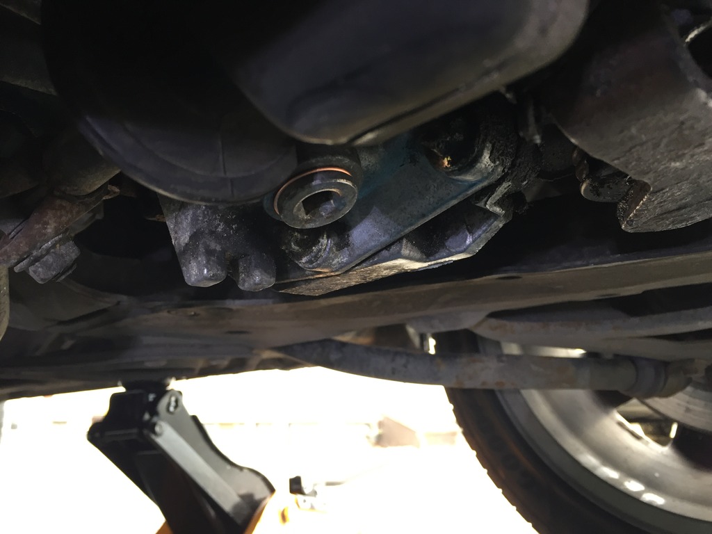

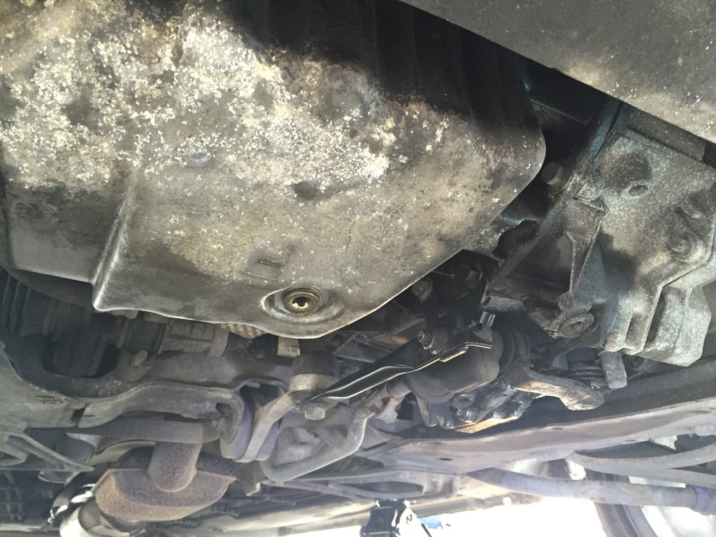

Removed the under-tray expecting to find the usual dripping/soaked sump and gearbox but to my surprise it was looking very dry, haven't seen one as good as this for years, and considering its on 125k im well happy!
Left the gear oil to drain for 1 hour.
Refitted plug with new genuine copper crush washer.
Refilled gear box with Renault elf Tranself NFJ 75W-80.
Cleaned the under-tray whilst it was off.
Gear changes are really nice and slick now, amazing how something such as gear oil can make such a difference.

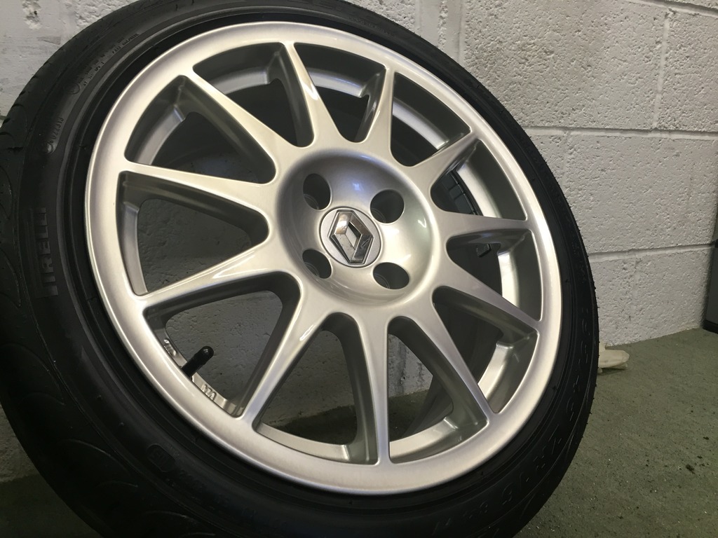

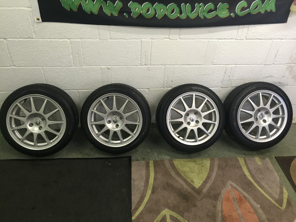

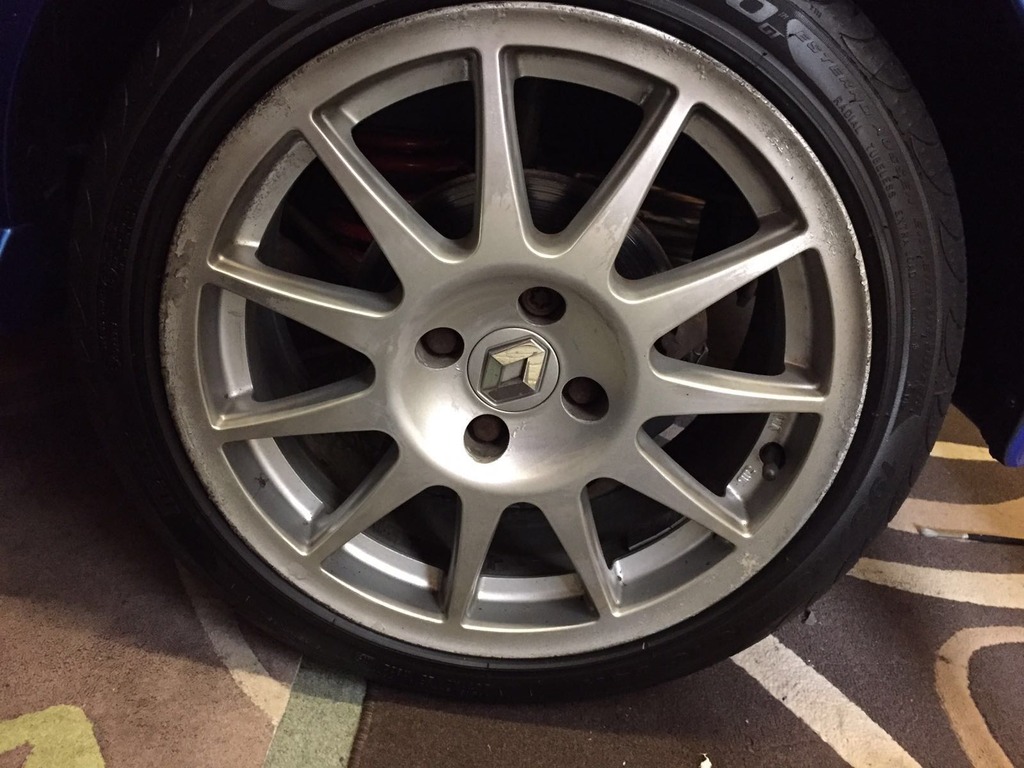

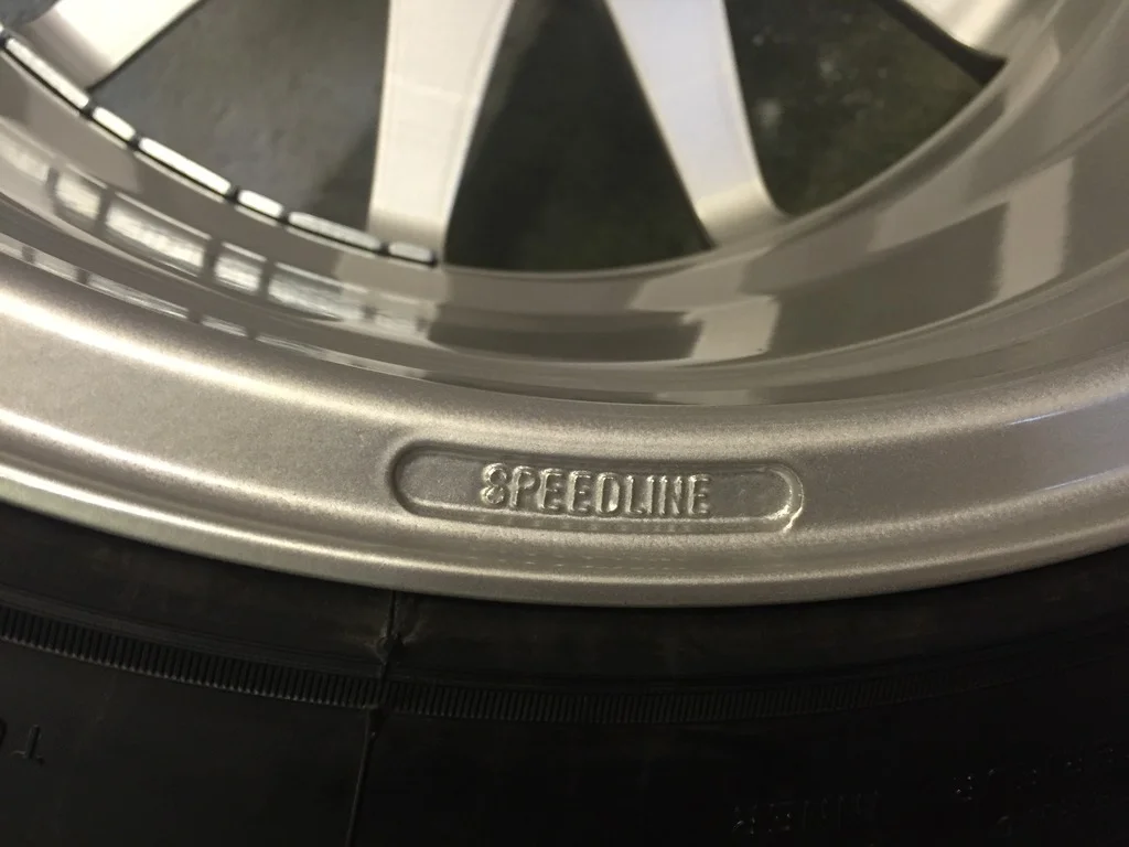

Wheels have been sent off to my local alloy wheel powder coaters for a full refurbishment, will be silver again.
The state of them now.
Currently on 182 wheels for a week or so, forgot how heavy these wheels are compared to Turinis.
I had that knocking noise looked at by 3 separate mechanics and no one could find an issue! Pretty depressing that it was something as simple as that.
The car looks great too!
It was pretty horrendous the noise when you nailed it in 1st and second, was like a grating vibrating knocking noise. Glad I sorted it easily. I think it was the exhaust touching the subframe.

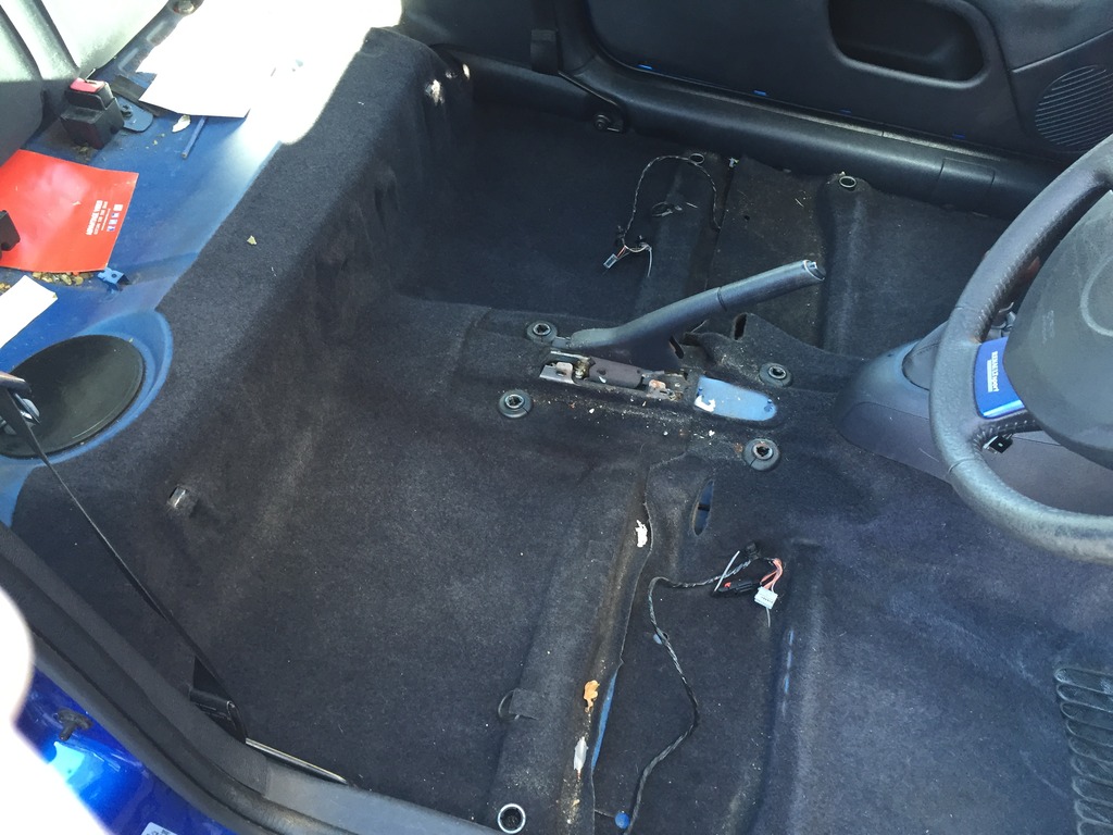

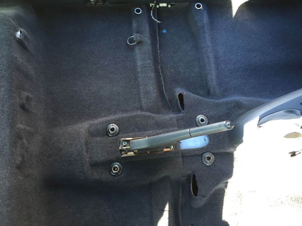

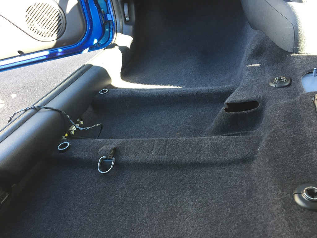

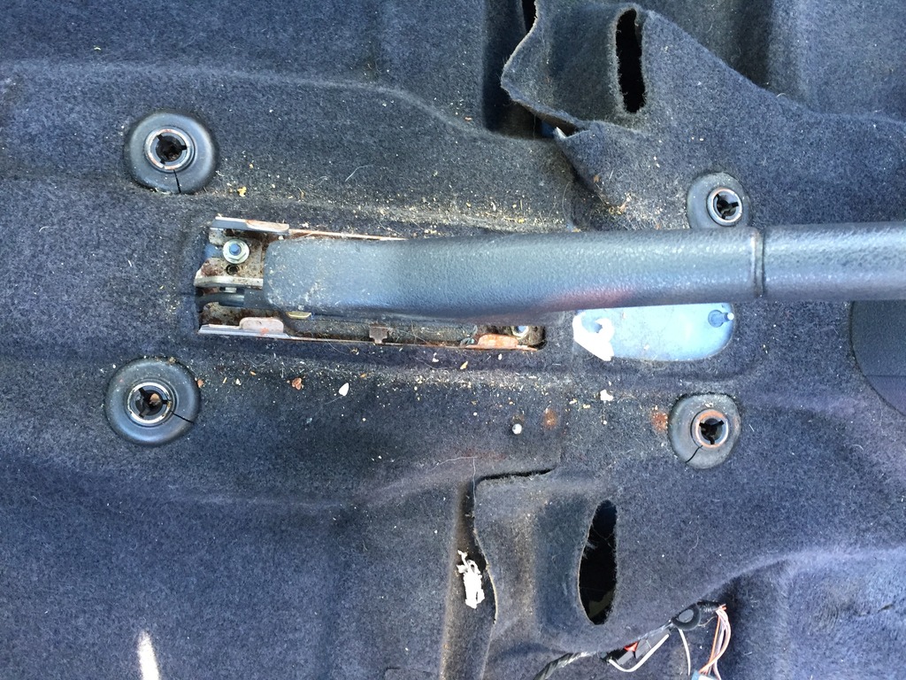

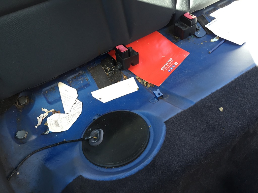

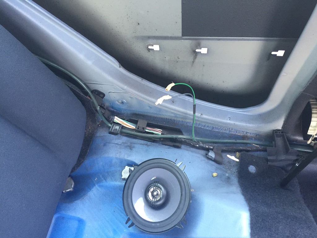

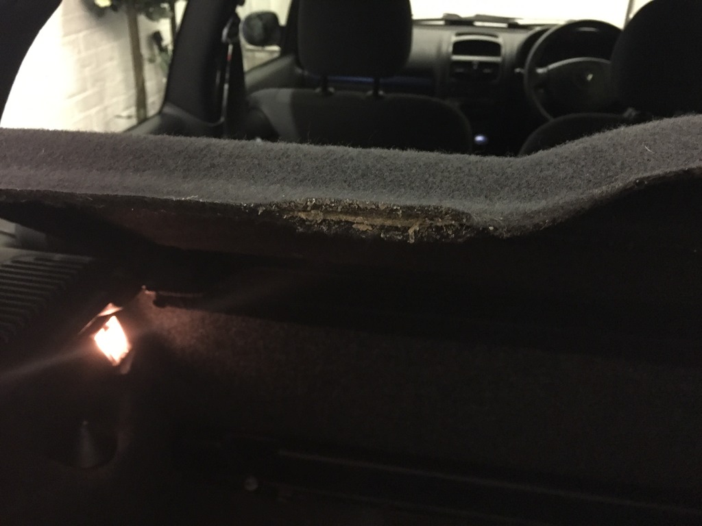

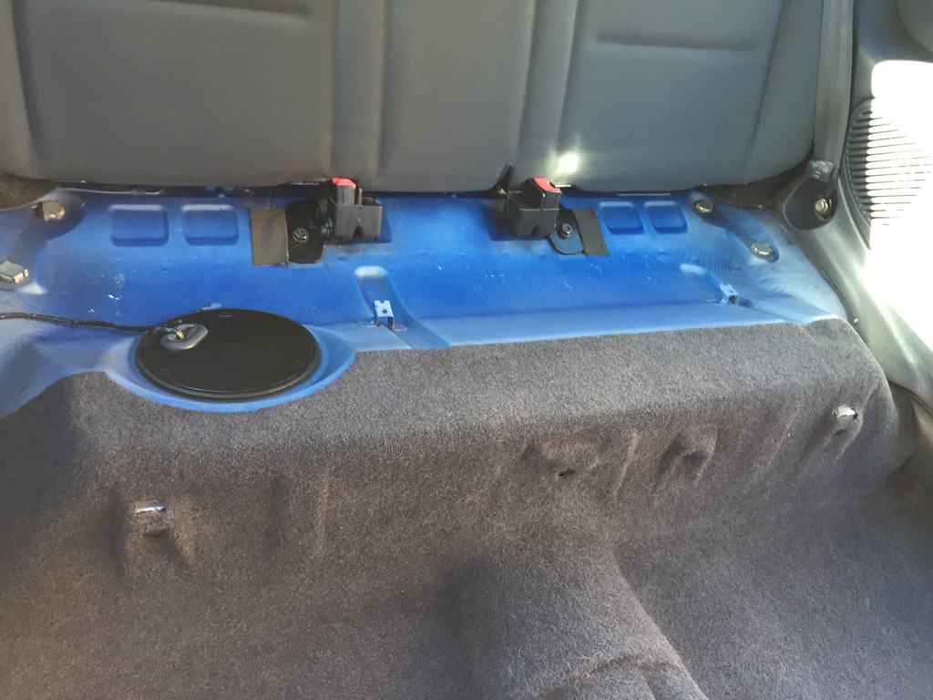

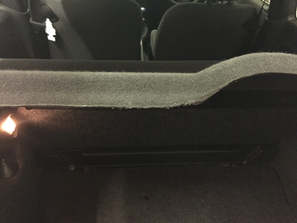

First up was to remove and refit the rear quarter cards correctly as the didn't sit properly, found some speakers in the back, binned them and refit the speaker wiring back into the loom. Cards got a good scrub whilst they were off.
Cut taped and tucked the wires away back into the loom.

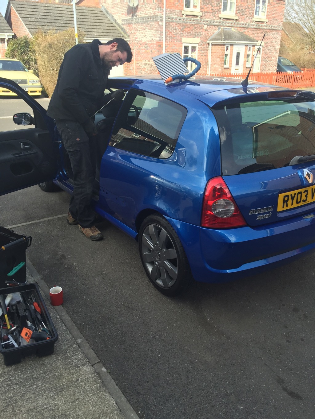

Then my dent guy came round and removed every single dent for £30, i use him alot and im always amazed at how good and quick his work is.

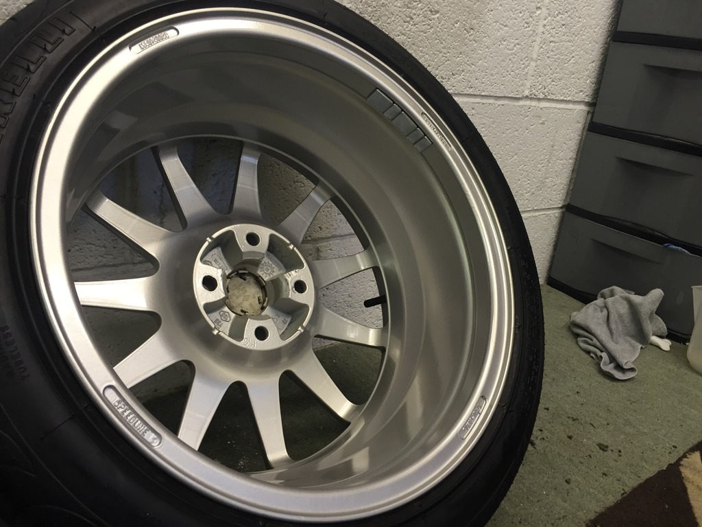

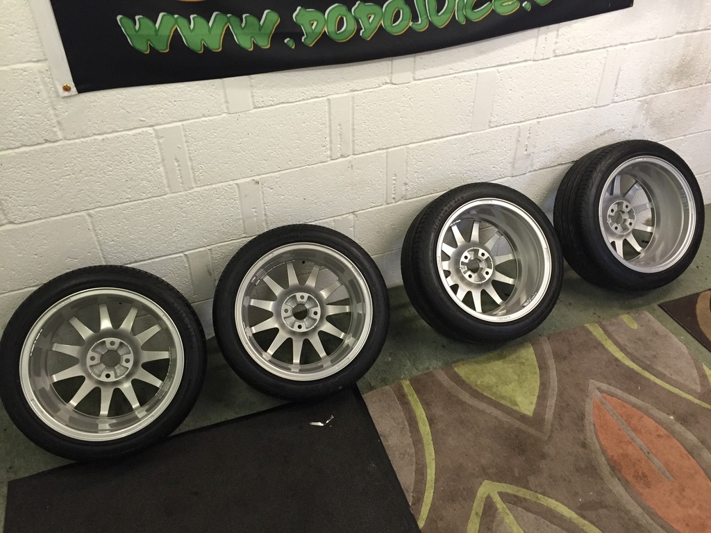

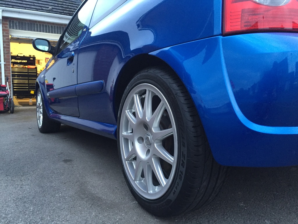

Went to pick my wheels up from proalloys.co.uk, had 2 new tyres fitted at the time so i now have 4 matching Pirelli P-zero Nero GT tyres!
They look fantastic! and for £180 it was an absolute bargain!
Fresh silver Turinis, love them.
